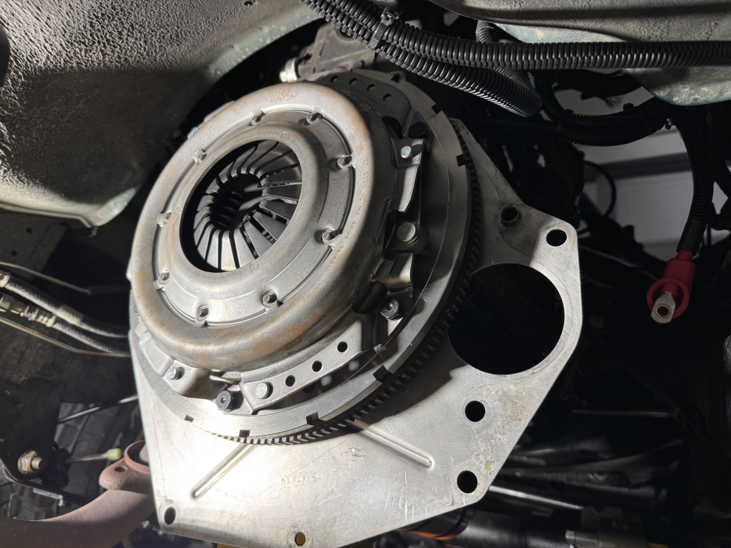

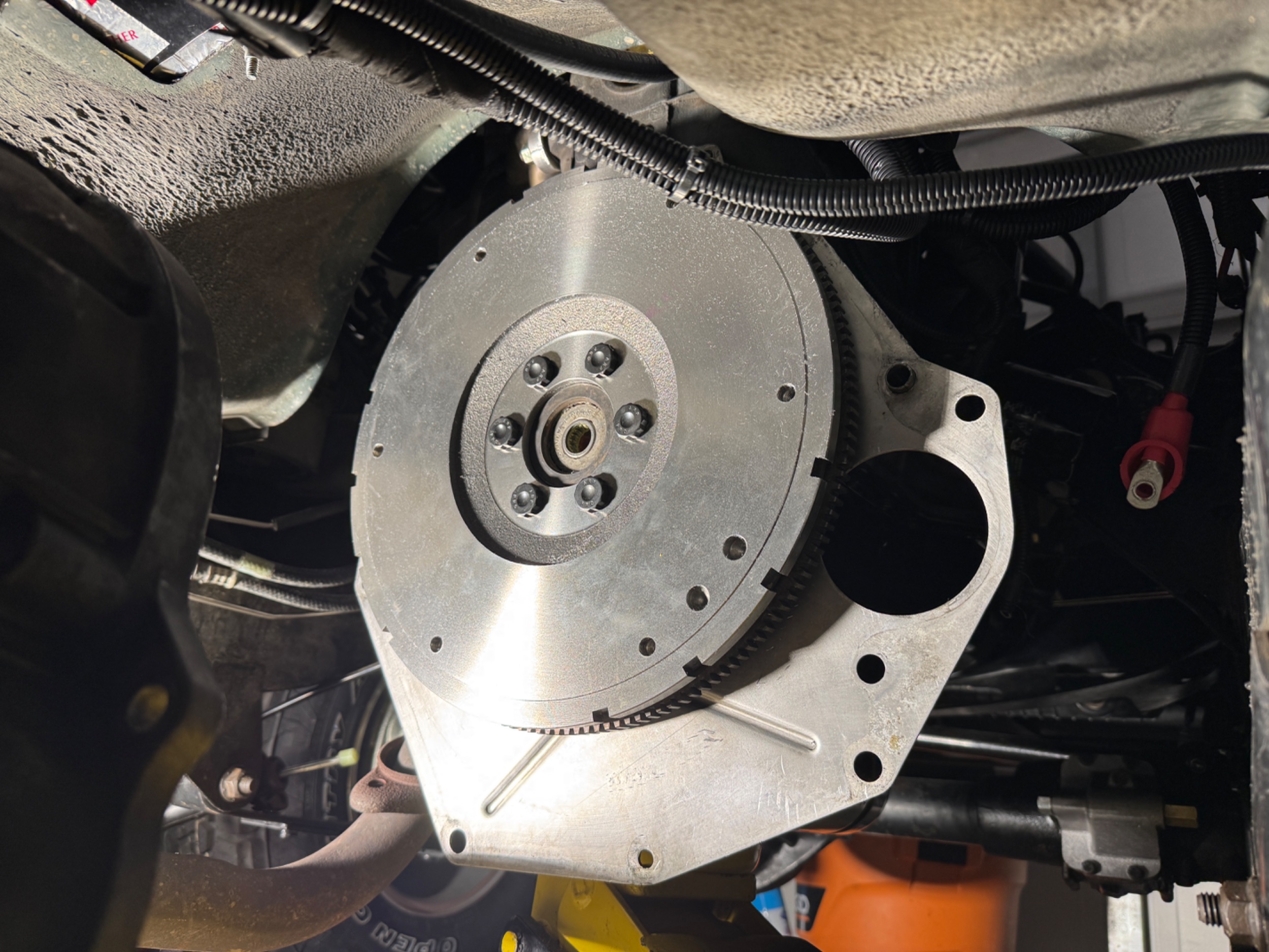

Made a tiny bit of progress. Finally got the flywheel bolts, but the day they were finally delivered I had a killer headache, and the next day I was busy. I have another headache today but not bad enough to not work so I got the flywheel and clutch hung.
Even though it hasn’t been long at all, I am always unpleasantly reminded what a non-fun job this is. The flywheel is just uncomfortably heavy for how you have to handle it and since the trans is in the way, I pretty much end up working one handed. It also takes a while because the bolts want lube on the heads and loctite on the threads. Doing that per bolt takes forever and holding the engine is also tough. I use a breaker bar on the crank pulley and it catches the frame on the left side. Works well enough.
Glad that stuff is on now.
I'm thinking I'll save the rest for tomorrow unless I decide later in the night that I'm bored enough to go back out there. Otherwise, tomorrow morning should start reassembly, and hopefully I get it all done by noon or mid afternoon.

I have used a length of chain from the rear head bolt stud to one of the pressure plate bolt holes. I use a longer bolt in the pressure plate bolt hole and the chain keeps the engine from turning while torquing the bolts. Still have to get the flywheel up on and bolts started, and that sucks.

That’s a good idea and I may use that next time. At least this time it wasn’t the Centerforce heavy flywheel. That thing was insane to get up there and lined up. 41 lbs. (stock is 27).

Last night I did get bored enough to go back there and try to do some install. Installed my dowel bolts and got it up there, but the last inch or so didn’t want to go. Finally got it to go and was about 1/4” out all the way around due to the dowel sleeves that line up the bellhousing and engine. For that last 1/4”, I feel it’s safe to use the bolts to pull it all together, although many will disagree with me on that. You can’t be that close without having the splines engaged, so I wasn’t too concerned.
However, I should have been more gradual and only done a thread or two per bolt at a time. I went too hard on one and got the whole mess crooked. Had to remove all the bolts and pull it back out and start over. Gave it a rest at that point last night.
This morning, with a fresh kind and strength, I gave it another go and got it to the same 1/4” point. Using the bolts and some up and down with the jack, I easily got it fully installed. Bolts are tight, starter is back in, crank sensor is back in, and now I’m starting reassembly. Light at the end of the tunnel!
It’s a bit cold and rainy so I’m not sure I’ll be finishing up today. Maybe in an hour or two I’ll feel like it again lol.
Good news! Got the important stuff hooked up starter, CPS, exhaust downpipe, O2 sensor, and fired it up. It starts perfectly!!
Cold and rainy out (I’m in a garage so the rain isn’t that big a deal but makes it more depressing IMO), so I’m working slowly. T-case is back in, need to install the trans mount, fully connect the downpipe (loose currently), plus in everything and hook the hose up, shifters, etc. Still got a job to do, but getting close. So satisfying that it starts how it should now that I got a properly made flywheel.
I've done this multiple times. Never screwed anything up. If I can move the flywheel with the transmission yoke, I'm using all the help my skinny butt can take by drawing it up with the bolts. And yeah, just a turn at a time, alternating like I'm torquing lug nuts. Glad you are in the home stretch. Haven't been driving mine much due to temps being in the teens after work, so the FSJ has been pulling daily duty for 4 out of 5 days. This week, I should be able to rock the YJ all week again.
Reactions: machoheadgames
Yeah, I never can get it that last 1/4” or so. I’ve always had to use the bolts to some degree. I’ve never broken anything. Where I’d see screwing it up (pun intended) would be you’re an inch or more out, clearly not even into the splines yet, and you use longer bolts that pull it from way too far away. That will probably screw up the clutch bad because it would be too hard to control alignment.

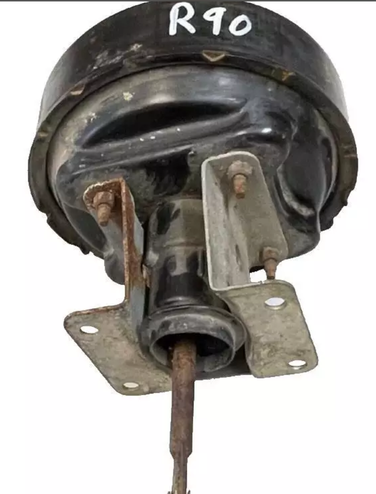

  • Raybestos MC was leaking fluid out the back
  • Reman booster pushrod was adjusted too short - measured with a booster pushrod adjustment tool
  • Reman booster didn't seem to be built correctly, the pushrod piece was able to easily pull out, unlike other boosters.

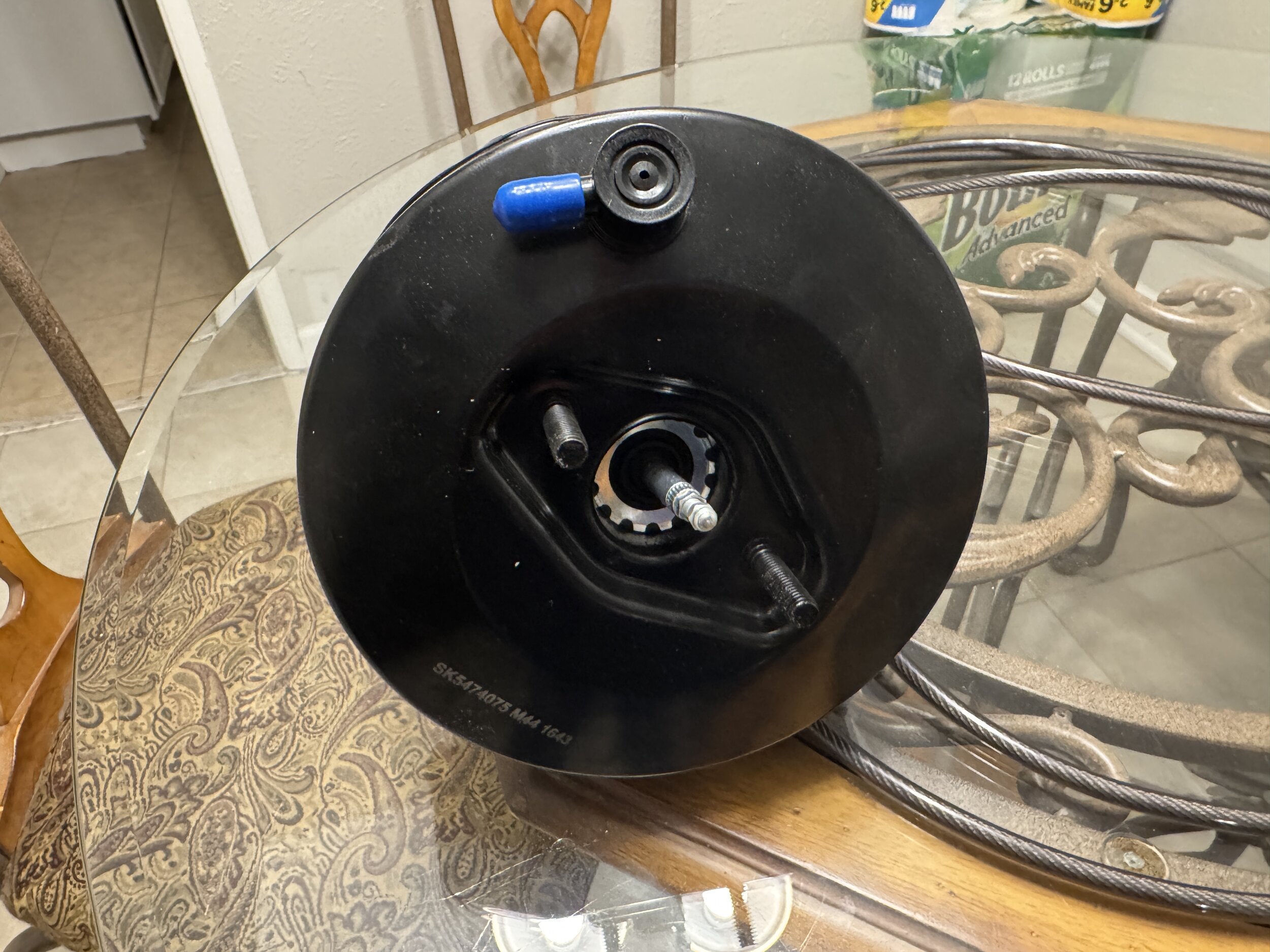

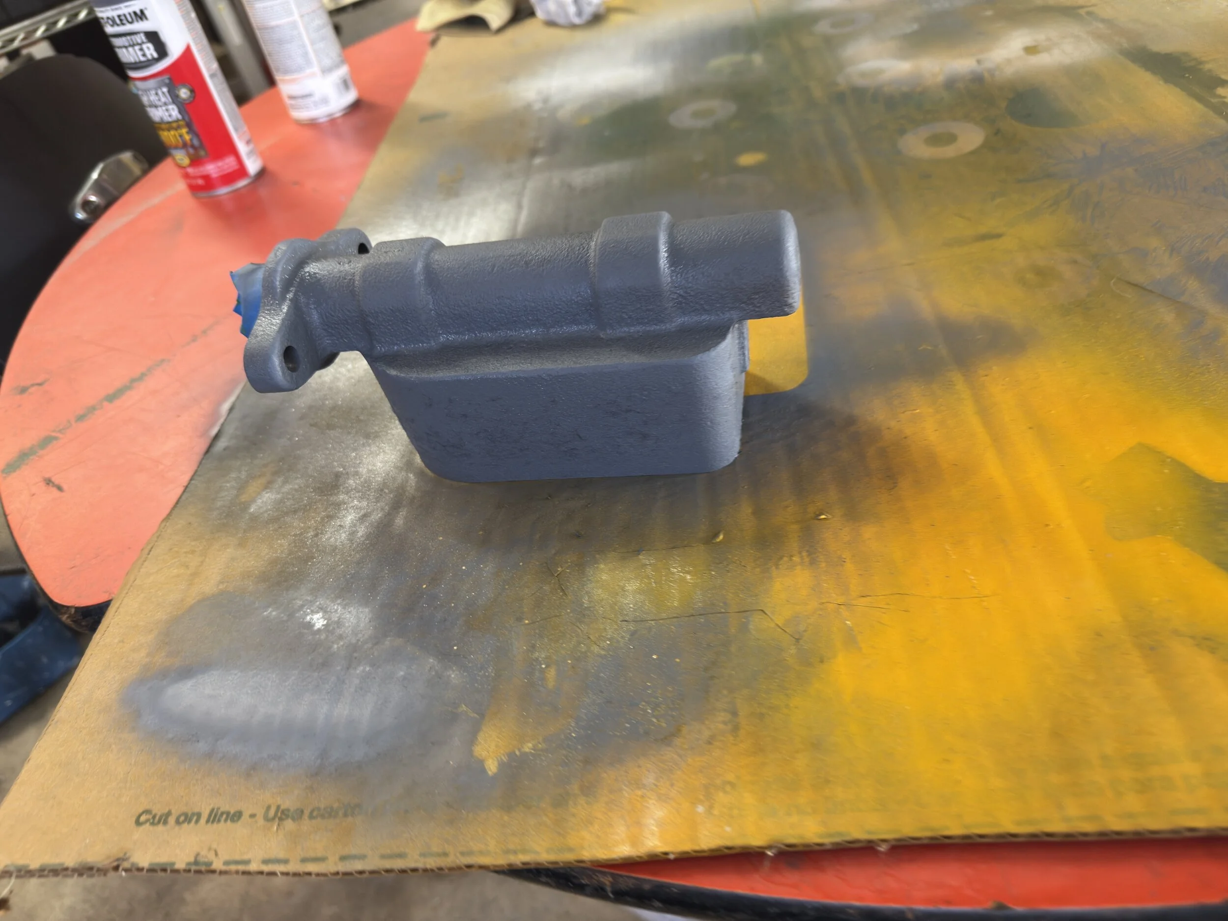

SKP is now offering brand new boosters for the stock application, so I decided to pick one up, along with a Centric stock master cylinder on RockAuto. The parts arrived and look good. The SKP booster appears to be nice quality. It's very similar to stock, and a bit different in some areas. Overall fitment was good, quality seems solid.

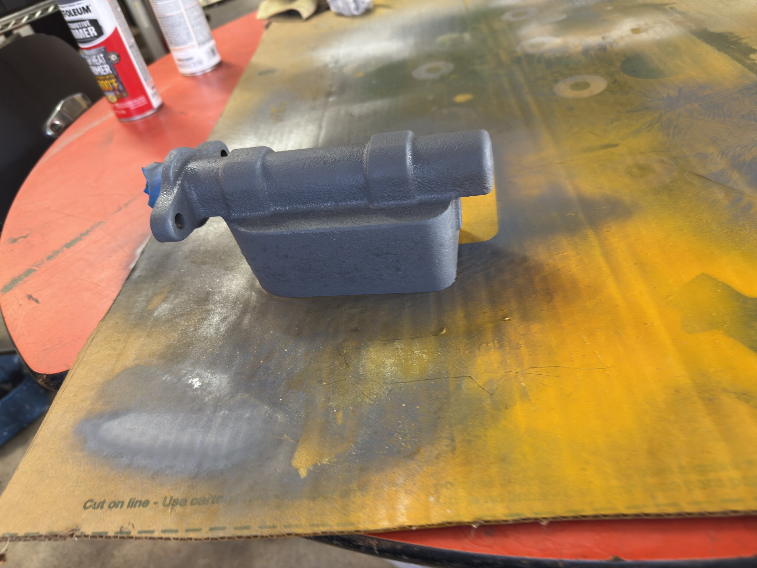

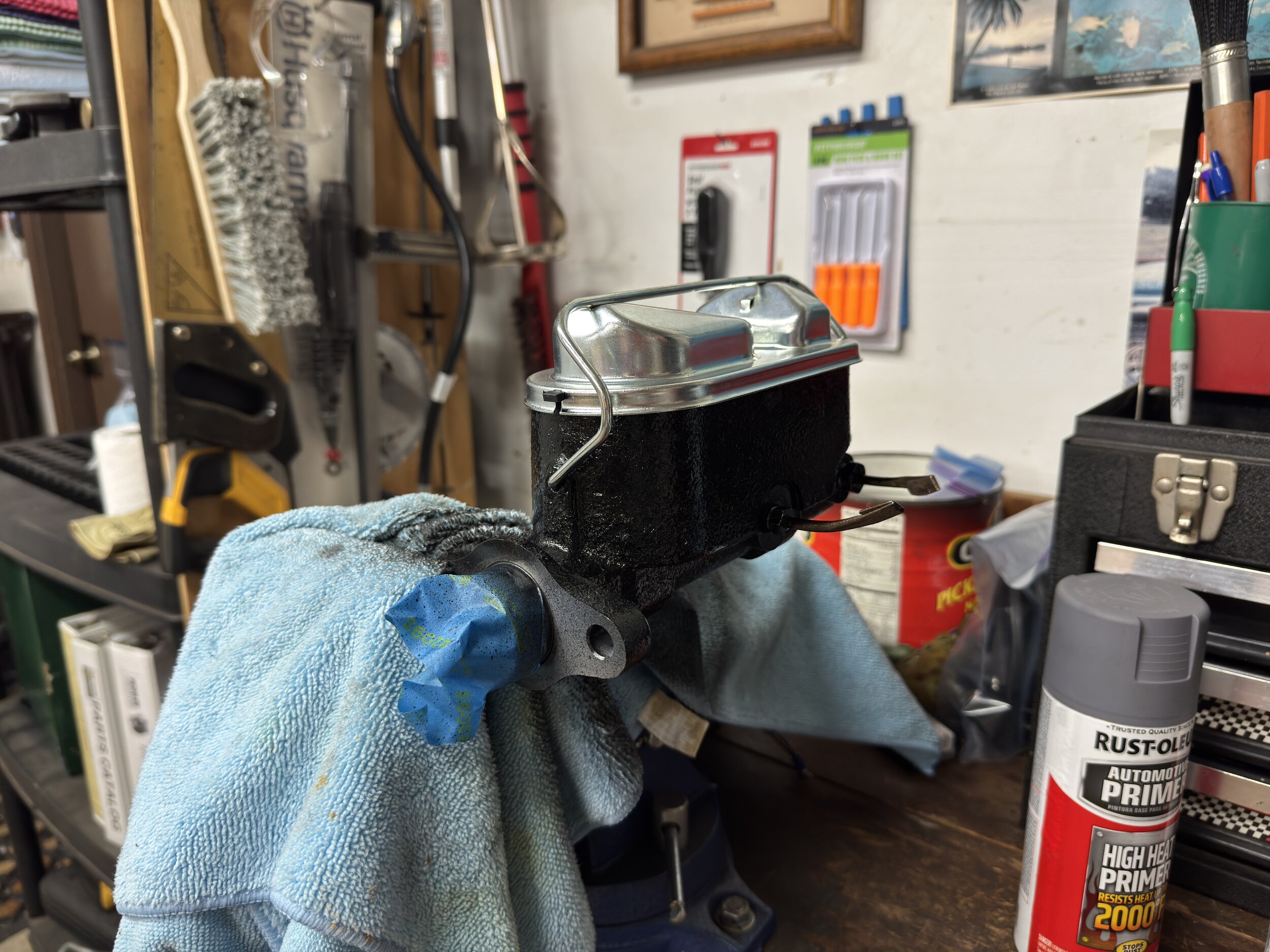

I painted the MC, due to them being well known to rust. My paint job is not pretty, but it works. Mainly just wanted to keep it from turning rusty brown. I knew that as soon as my brake fluid covered gloves started touching the paint, the paint job wasn't going to be perfect anyways, so just the fact that it's covered in paint is good enough to me.
New booster:

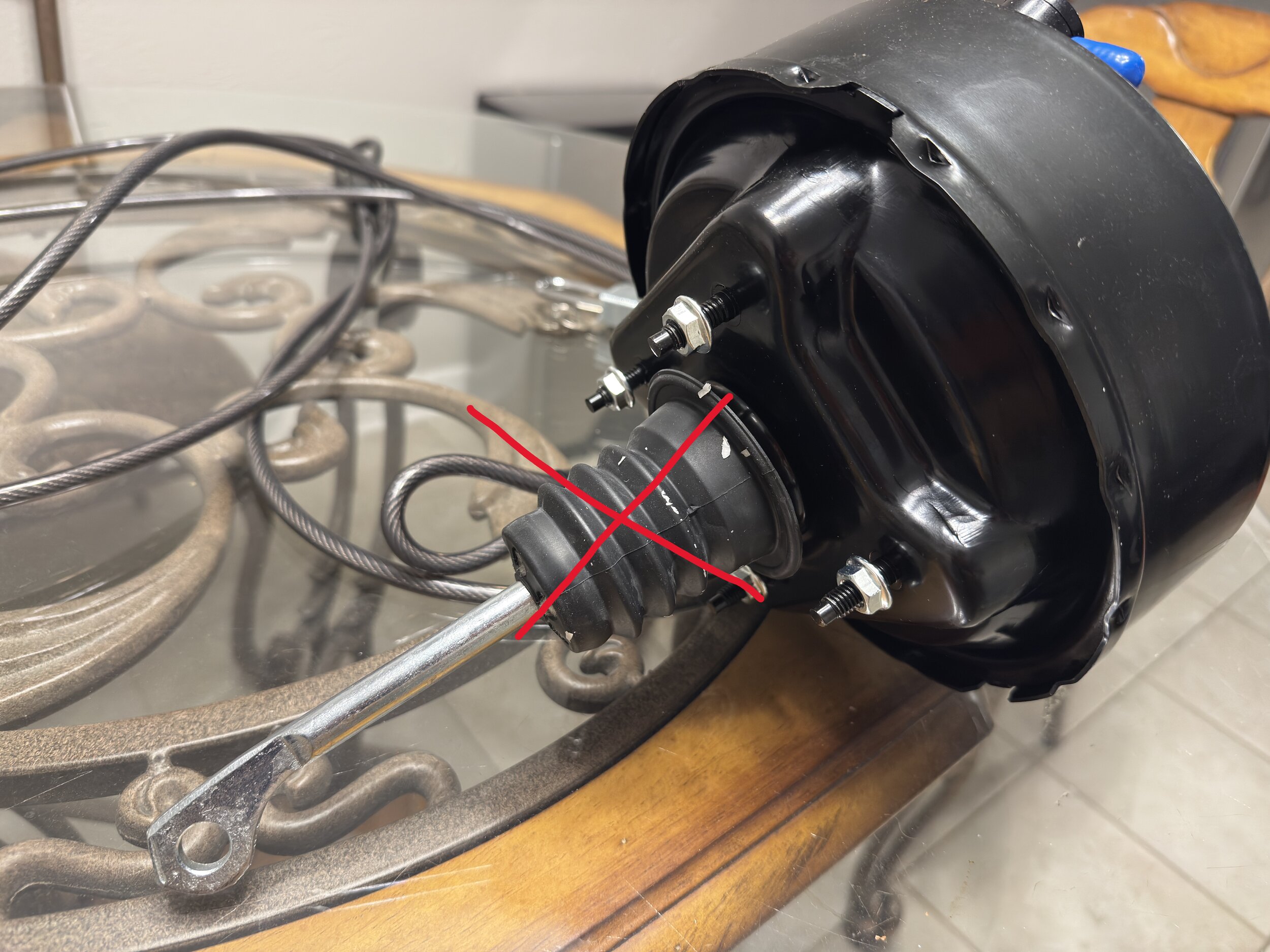

The SKP booster comes with a boot on it that does not work for the YJ single diaphragm booster application. The rubber boot that comes installed is more for applications like the dual diaphragm boosters in the 1995 4.0 YJ or any of the TJs. The single diaphragm booster in the 87-94 YJs uses a plastic guard that slides over the booster tail housing, and butts up against the firewall.
I removed the plastic guard from the reman (which came from my original stock booster), and installed it onto the SKP. I don't have any photos of mine, but here is an example from eBay. Essentially, the booster has a felt pad as an intake filter on the pedal pushrod. The guard goes over the pushrod and slides onto the tail end of the booster, and compresses the felt filter to hold it in place. The guard then mates up to the hole in the firewall to keep the guard secure.
I removed the ACDelco reman booster and installed the new SKP. Things were uneventful for the most part. The booster went right into place and hooked up without any drama. The brake light switch did need slight adjustment. The brake lights were on all the time until I adjust the switch closer to the pedal. All is good now.
The master cylinder pushrod was a bit weird. The pushrods on all boosters including stock are adjustable. They usually have resistive threads so that the adjuster doesn't unthread and create a gap between itself and the MC, or so that it doesn't thread outwards and push against the MC. The problem with the new booster is that it used a jam nut to secure the adjuster, and that doesn't work. The threaded sleeeve is longer than stock, putting the correct place for the adjuster with the jam nut, to be basically all the way threaded in. Well, then there is no way to secure it. I removed the jam nut and secured the adjuster with Loctite 609 on the threads. The green stuff. Should hold well. I adjusted the length using a brake booster adjustment tool. Hopefully that makes it idiot proof for getting the length correct.
I bench bled the MC and installed it. Then allowed the calipers/wheel cylinders to gravity bleed. Doing a pedal test, the brake pedal feels MUCH more normal now. It is still relatively easy to get the pedal to the floor if I push hard on it, but I think that's normal? It's been a long time since I had stock brakes.
Planning to fire it up this evening and go for a drive around the block and see how it does. I can keep tinkering with bleeding and such if needed, but at least I think the booster and master cylinder can be left alone at this point. In reality, the only unknowns at this point are how the pedal will feel once the booster is boosting, and if the brakes work "properly", meaning the ability to lock the wheels at speed.

Glad to hear there is a new booster available. My 2006 LJ has never been able to hold vacuum more than a couple minutes after the engine shuts off. The check valve is fine so I assumed it was the booster. Not noticeable once driving, but having no boost when starting the engine on a steep shelf road has been unpleasant a few times.
FWIW, my YJ brake pedal firms up quickly; I couldn’t get it anywhere near the floor, even when I push hard enough to lock the wheels.
Unfortunately the 1995 4.0 booster (dual diaphragm) is different from all the other YJs, and there is not a new one available for that application. Only reman's, with questionable availability.
It has been a while, but I had the 1995 4.0 booster from 2015 to 2019. It worked fine in operation, though I want to say it didn't firm up much when engine was off either. So that is interesting that you can't get yours near the floor at all.
I may still have some air in mine, hopeful to see tonight. I have not done a 2 man bleed. I simply hooked the bench bled MC up to the lines and then gravity bled each wheel for a few minutes. Maybe that isn't enough, but I did get all the visible bubbles out and closed the valves when the fluid was solid. So it's hard to say.
I do know my 95 reman booster I had for that time period did not really firm up much with the engine off. But it was a reman, so maybe poor quality. The vacuum check valve was fine, so it wasn't that.
I guess at this point, the only thing to focus on is starting up the engine and seeing how the brakes work, and go from there.
I’d bet you still have air in the lines somewhere. Have the pedal person push vigorously, and your caliper person tap the caliper with a wrench to jar loose bubbles that can be stuck inside the caliper.
Got the engine started. Definitely lots of air still in the system. The brakes are as bad or close to as bad as before. Definitely more work to do.

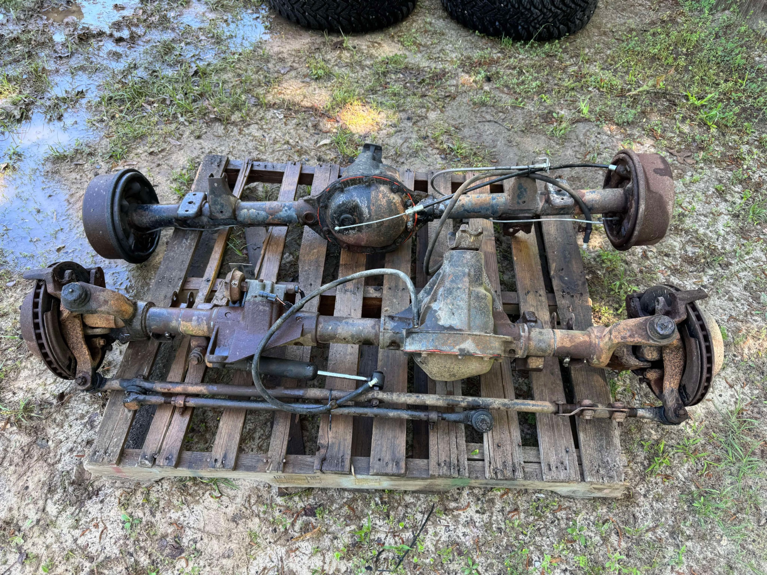

I’ve probably said it a few times, but what I have looked for for over 10 years is a set of stock 4.11 axles. Mainly because it’s easy to replace bearings and keep them original, and you know they will run well and be problem free. I’ve looked for sets of these axles, or even singles to pick up one at a time from junkyards, but I never really found anything. A couple of weeks ago, I spent a Monday night searching for about 4 hours and again, came up with nothing. I was at work the following Tuesday and happened to stumble my way onto Facebook and saw a 2 hour old post with a guy parting out all of his YJ except the frame because he got a new tub and was going to do a V8 and D44 build. His 1995 4.11/4.10 axles were available for sale for $750 and came with a set of 5 wheels/tires.
I had no room for the wheels in my truck, so after he sent some confirmation photos for my approval, we worked out a deal and I agreed to take the axles for $600. Drove 6 hours (3 each way) the following Saturday and picked them up.
They’re a little rusty, but nothing worth turning my nose up at. They are still 100% original, and I got a free tie rod and drag link out of the deal with tie rod ends that are still usable.
I’ll go into more detail later on the building of each axle, but essentially, I finally found what I wanted for axles. Yes, I’ve already spent a fortune on numerous other sets of axles and gears, unfortunately. I wasn’t really happy with how I set the gears up in them. It was a good learning experience, but I got frustrated during the process and while I got the pattern right, my carrier bearings are probably tighter than they should be and I really didn’t like the shims I was using on the rear axle. So I wanted to find a stock set still and just run those with new bearings. I’ve finally checked that box.

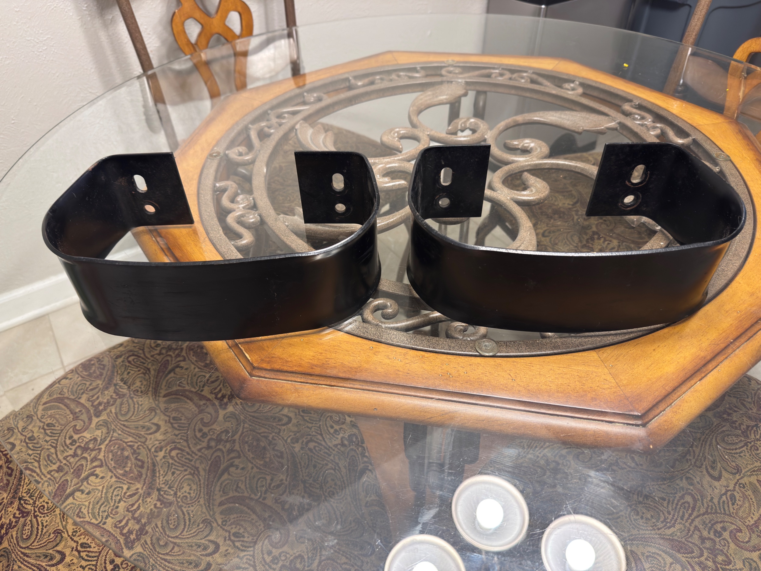

  • Ordered a very nice set of bumperettes and new bolts, finally found a set that weren’t bent, rusty, nasty, beat up, etc

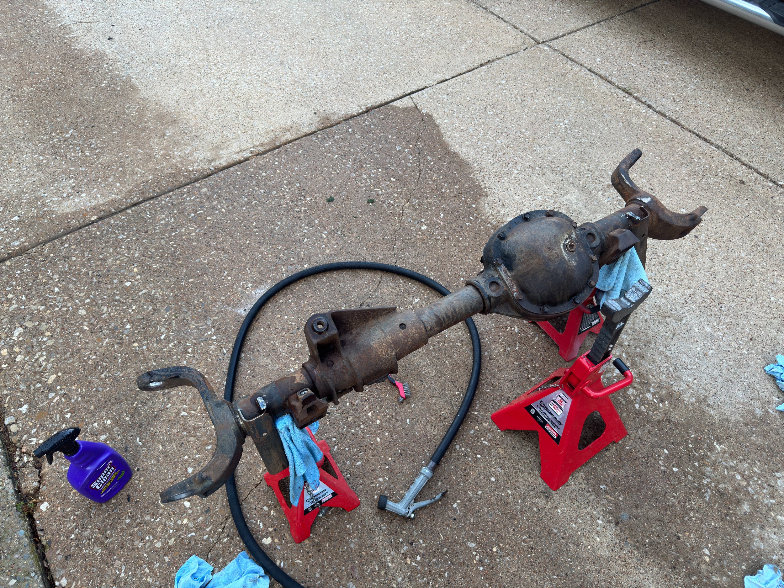

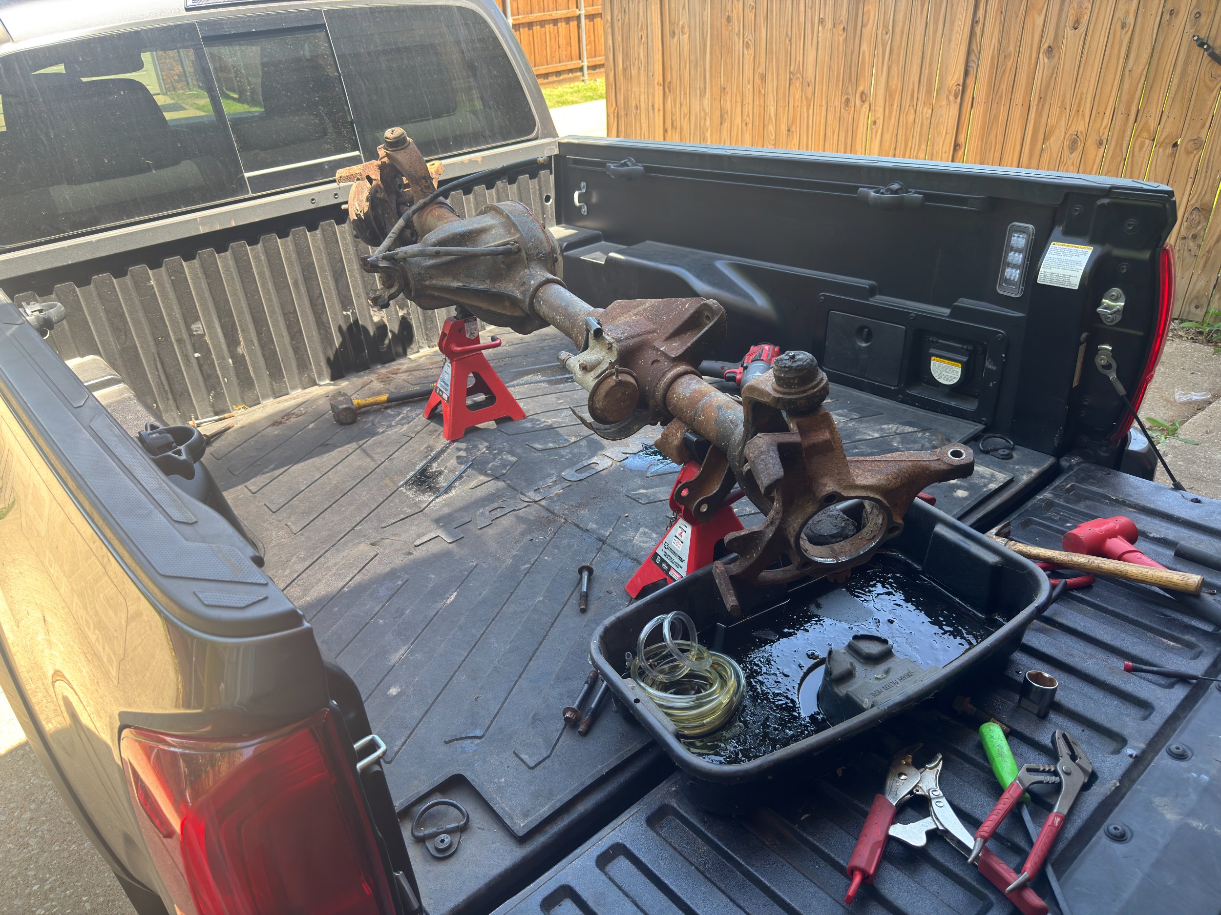

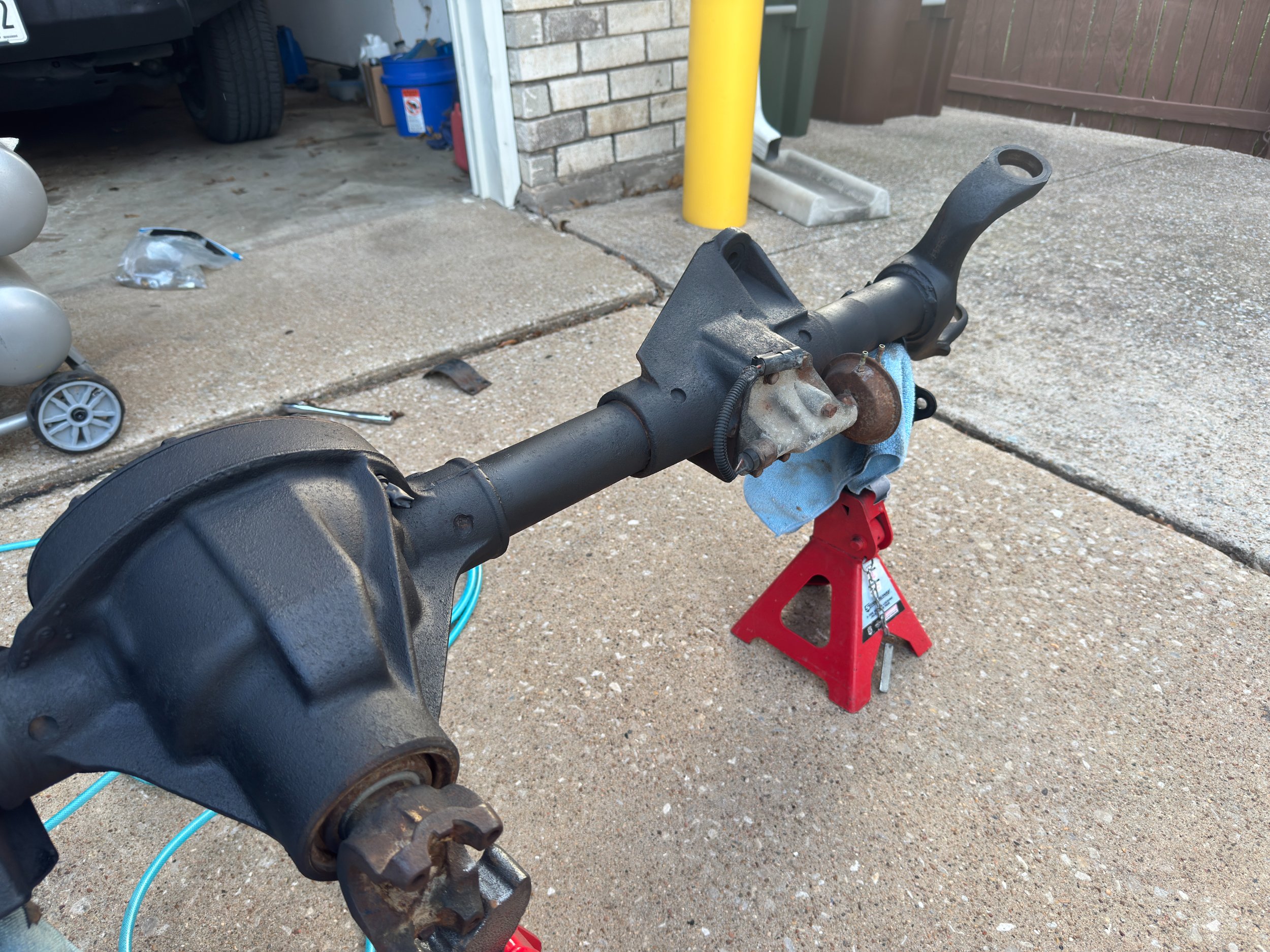

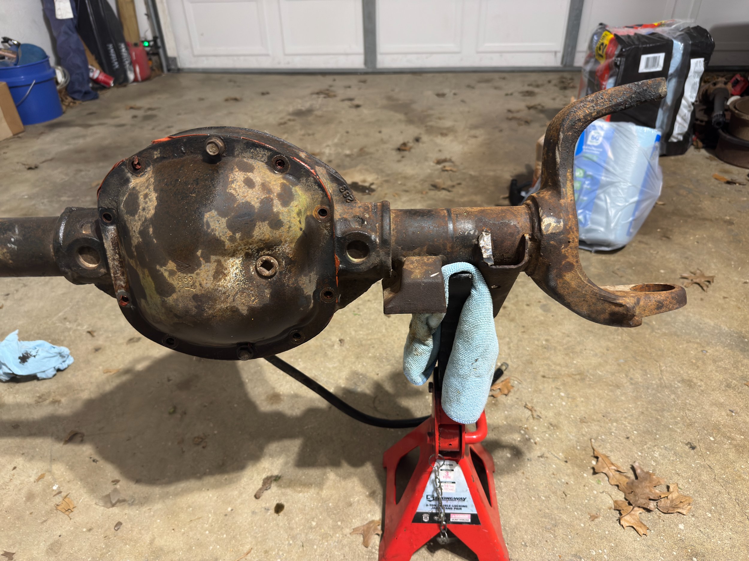

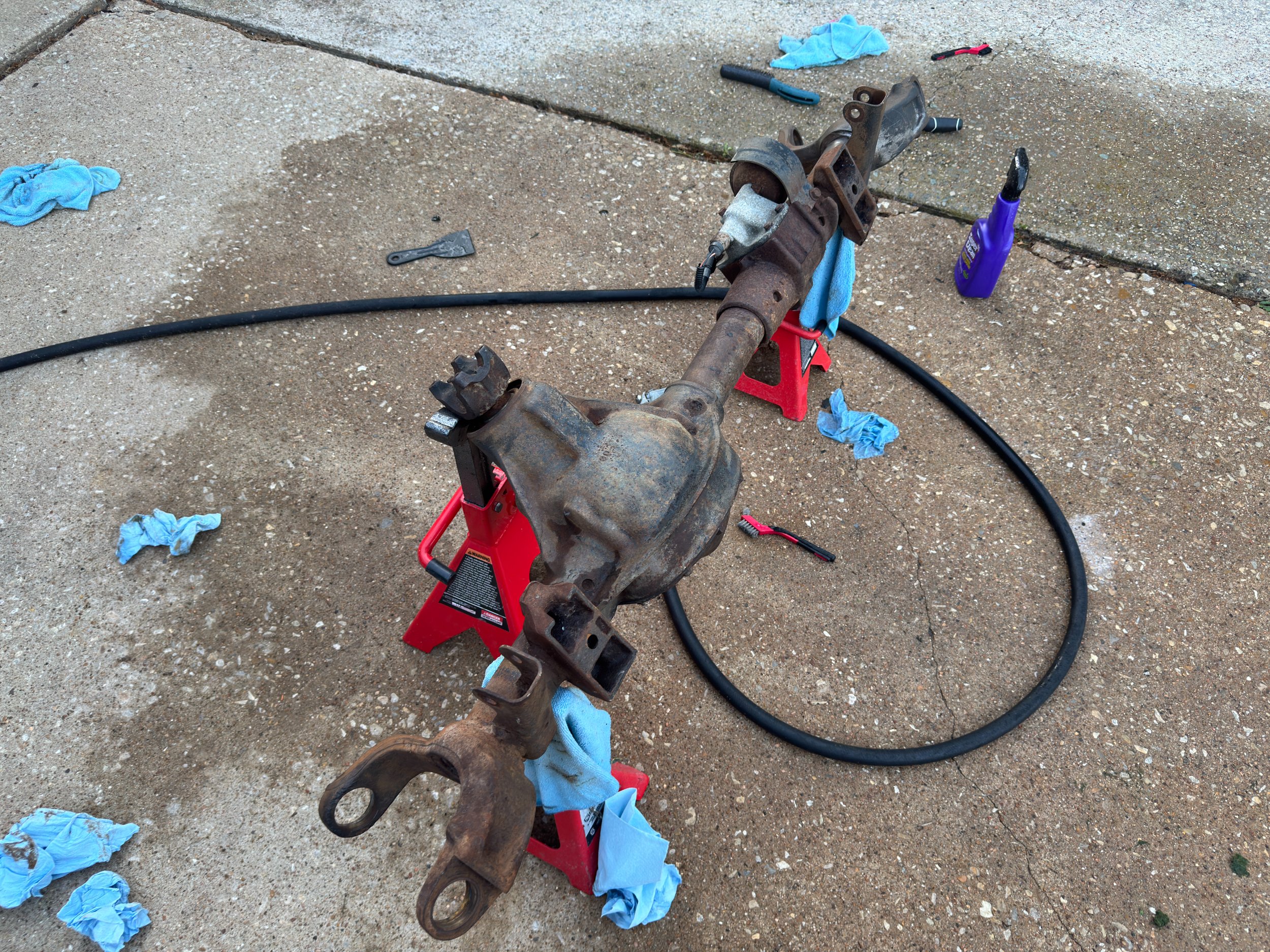

Dana 30 4.10 Rebuild

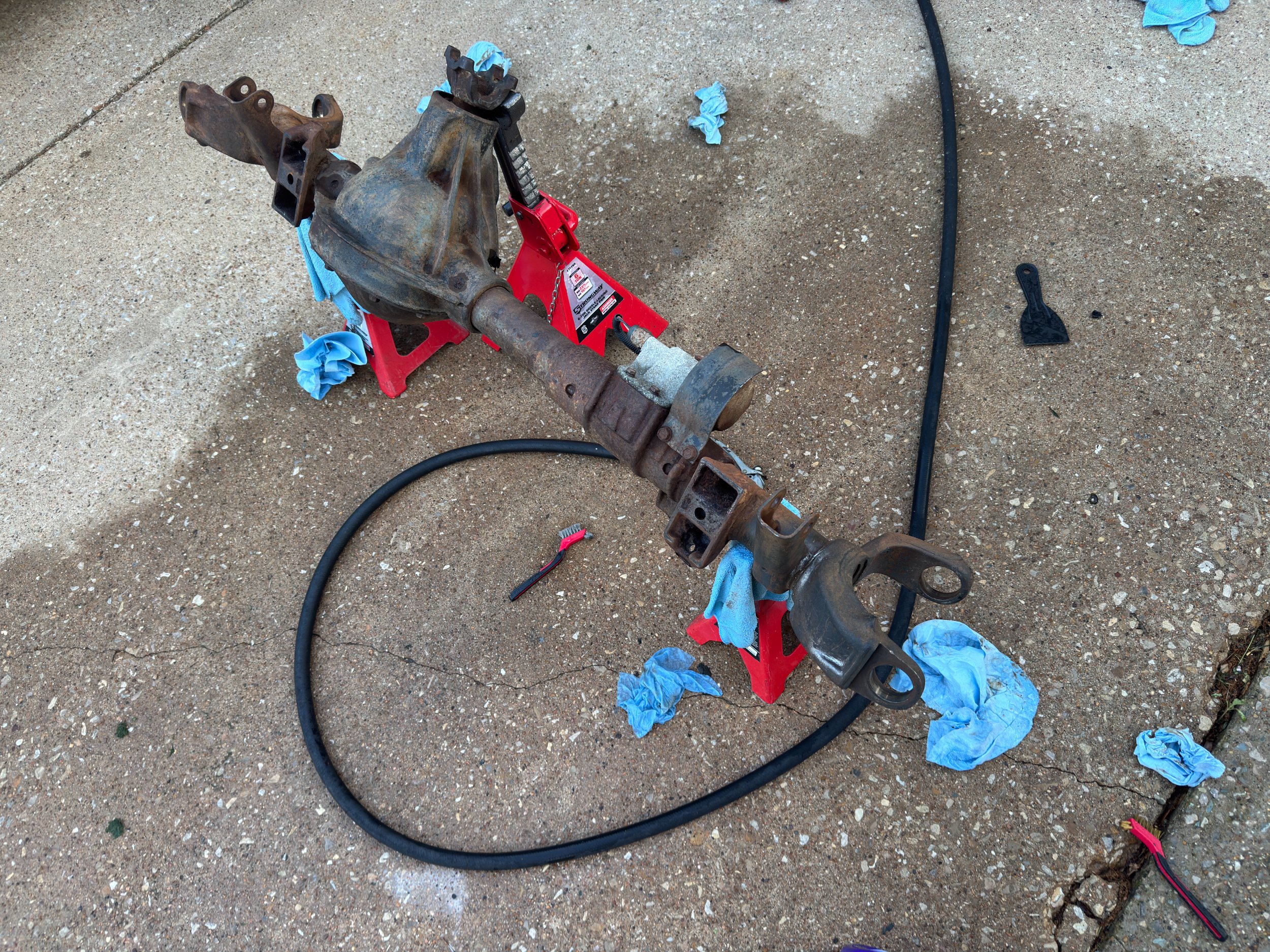

Like I mentioned in the previous post, I picked up a Dana 30 and 35 axle set (factory 2.5L manual 4.10/4.11 ratios) to rebuild and install into my YJ. They were located out North of Longview TX, a few hours away. I picked them up for $600, ordered a bunch of bearings, seals, ball joints, bushing, etc to bring them back to new running condition.
As always, they are heavy and a pain to move around. I got home with the set and had to get them out of the truck by myself. The Dana 35 isn't too bad, just remove the drums and while it's still probably 130 lbs, I was able to muscle that out carefully. The front, however, is a pig. The housing is heavy, then it had knuckles, rotors, calipers, a tie rod and steering damper, plus all the internal stuff. I had to disassemble it halfway just to get it out of the truck.
I got the axle shaft out of one side, removed the tie rod and steering damper, and then it was manageable enough to muscle it out. Still very heavy and uncomfortable.
Since I had to begin the teardown to get the front out of the truck, it made sense to proceed with working on it first. I continued teardown on it that afternoon. My hands were nasty, so I didn't take too many photos, but overall, the inside of this axle was perfect. The fluid looked brand new, the gears and bearings were in excellent shape. The nastiest part was the inside of the axle tubes, outside of the seals. Thankfully those are no big deal really.
Outside didn't look too bad either.

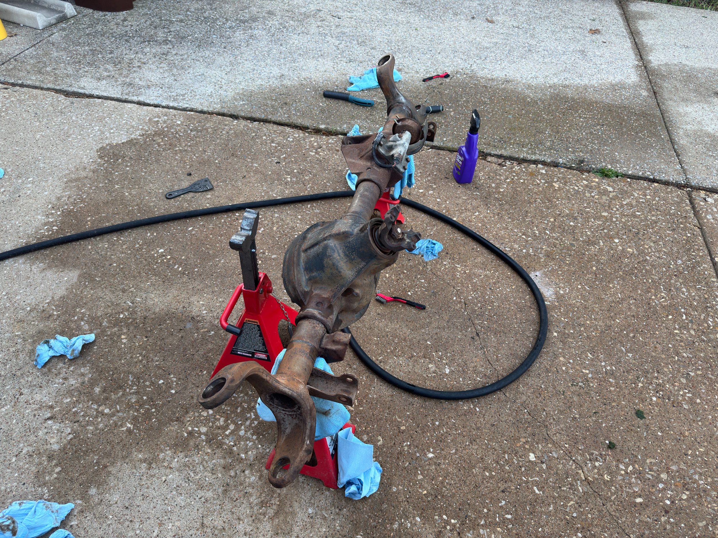

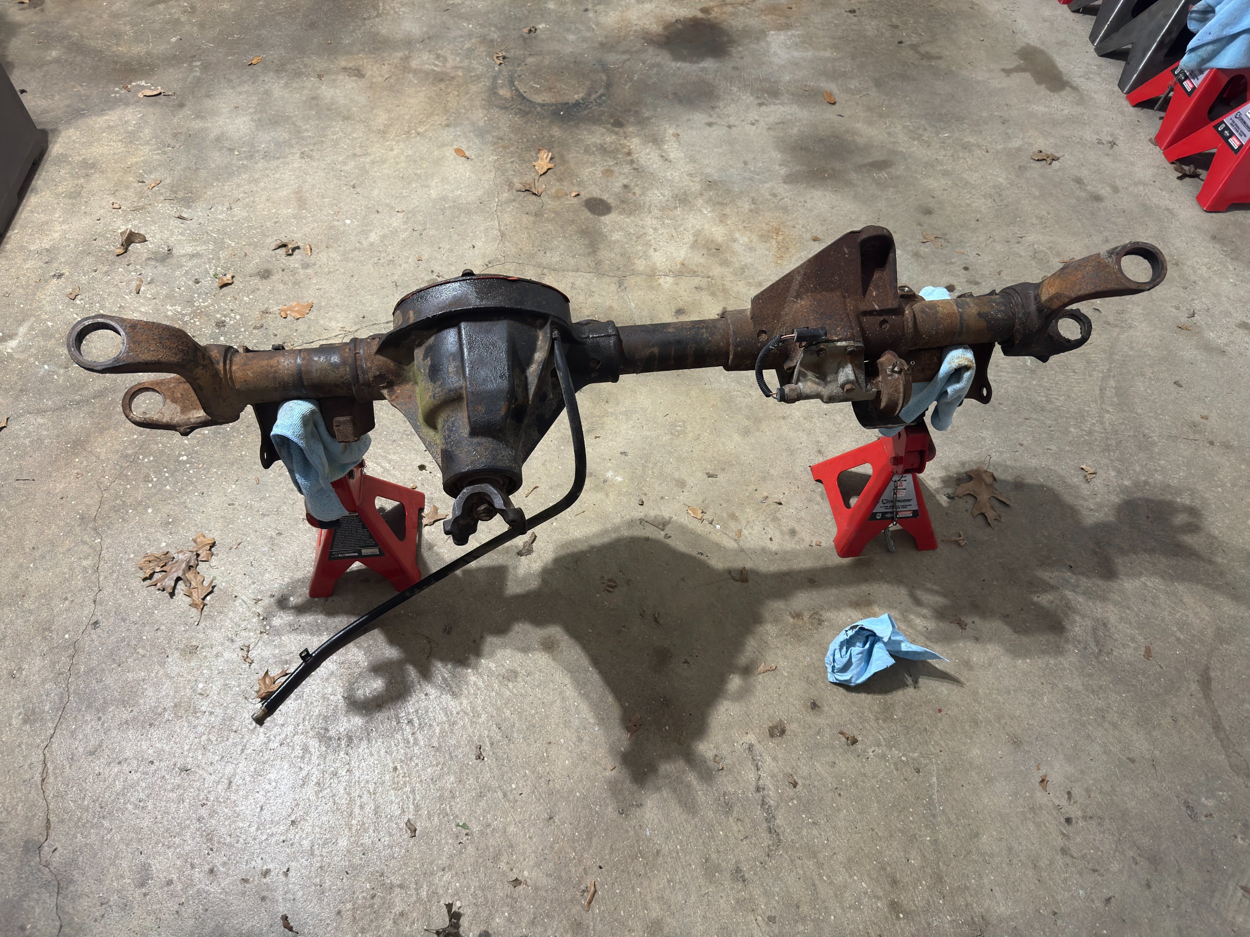

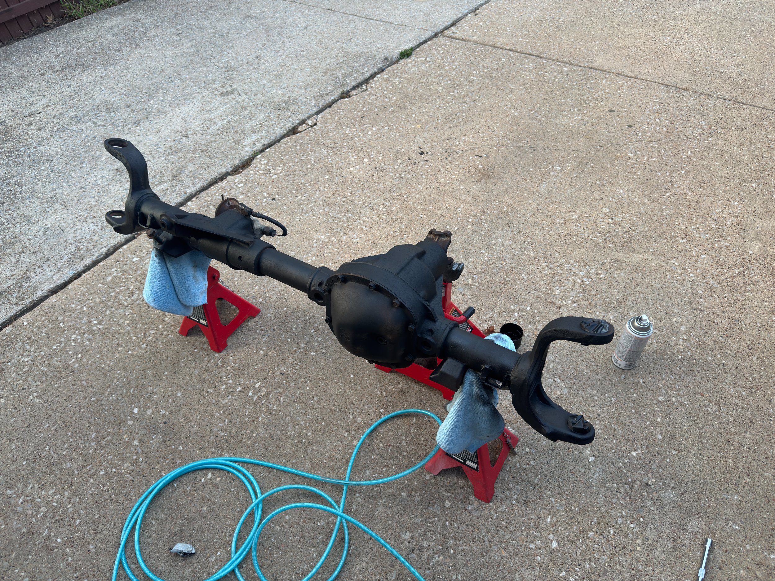

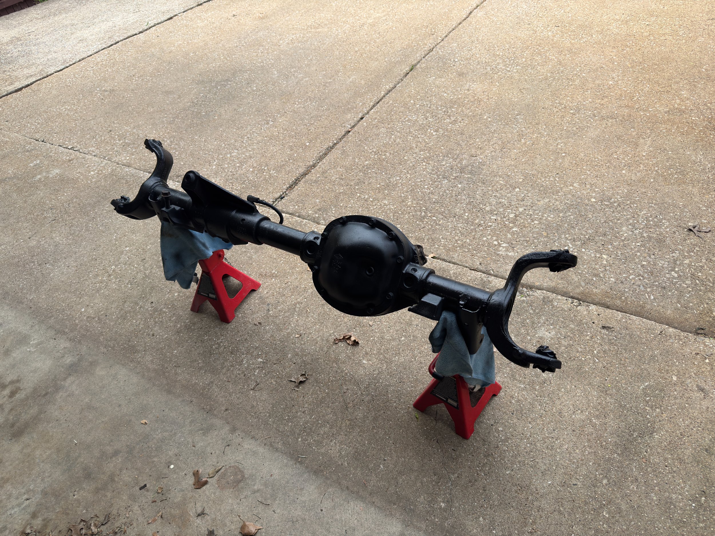

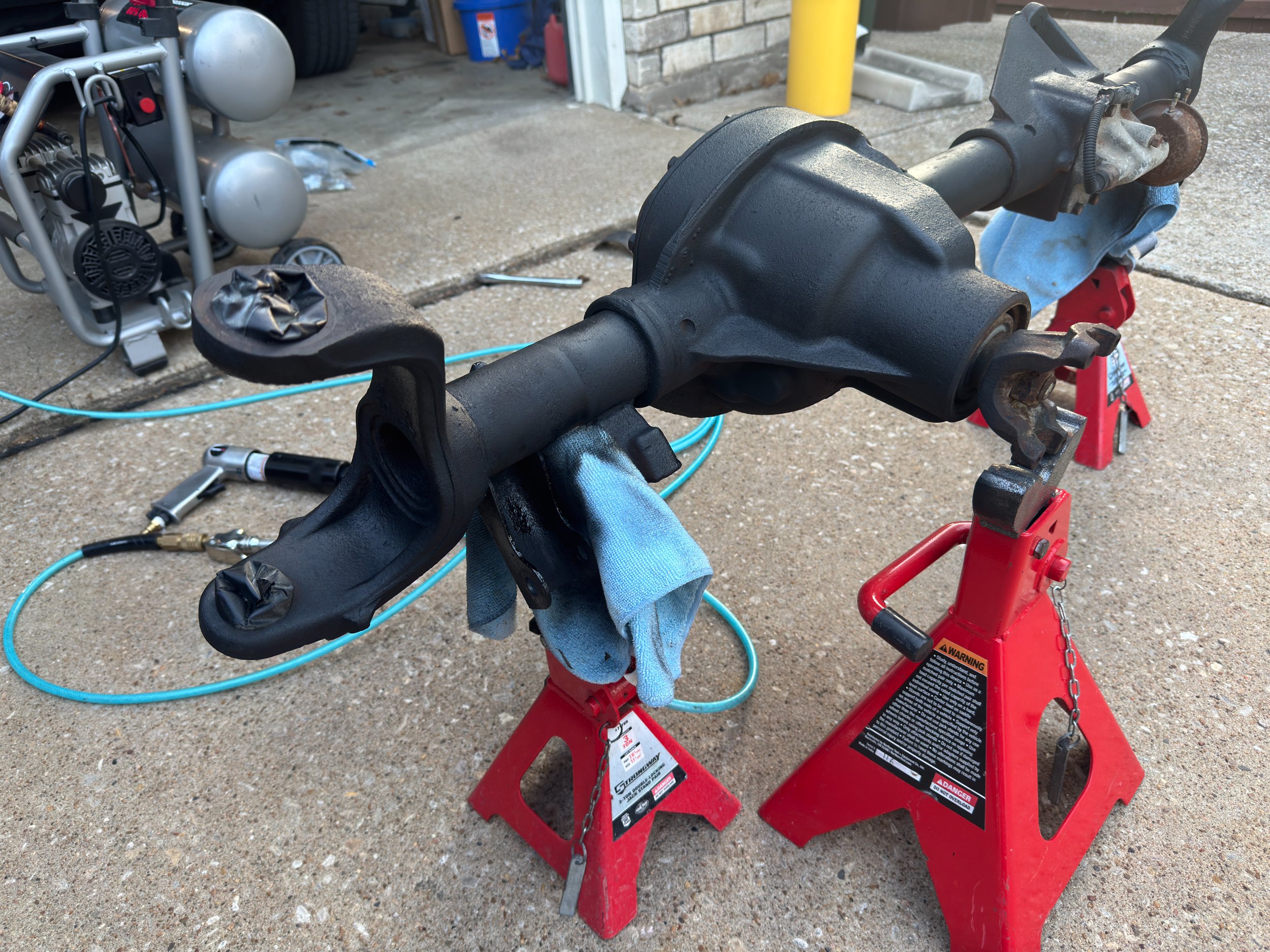

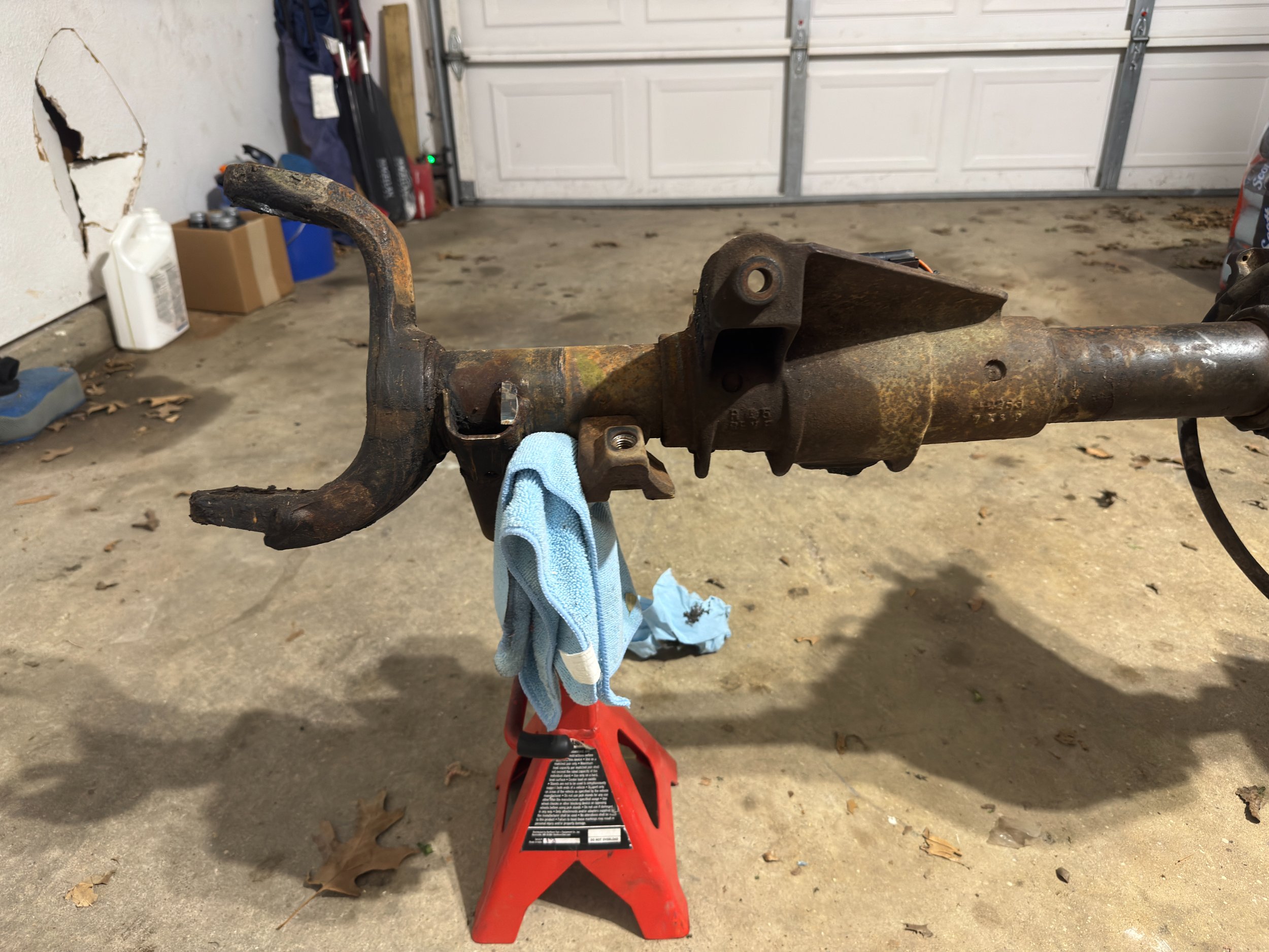

Last week, I took it out to the driveway to clean it up. There was a decent amount of gunk in the inner C area, so that's where I spent most of my time. Lots of Super Clean, scrubbing, scraping, and rinsing. After a few hours, I had the housing as clean as it would be.

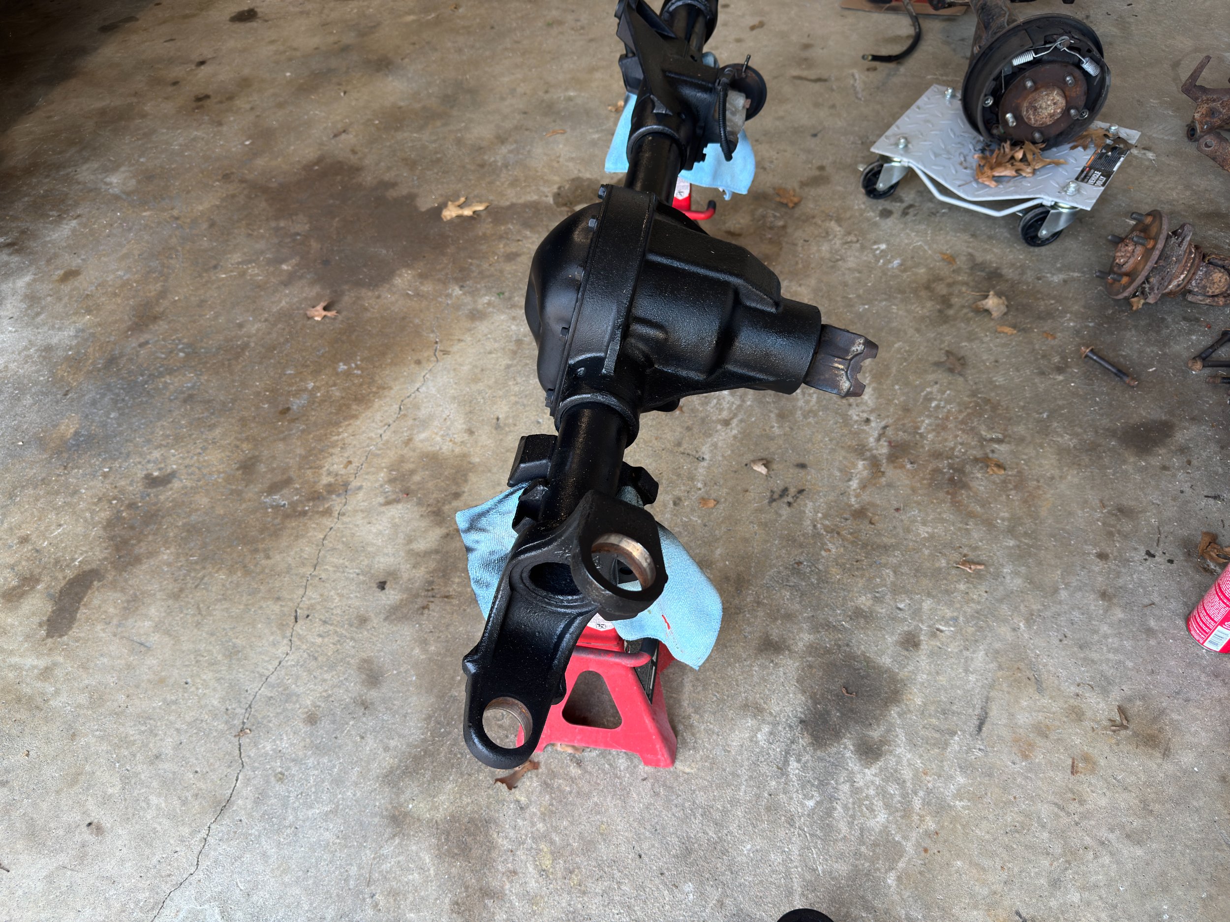

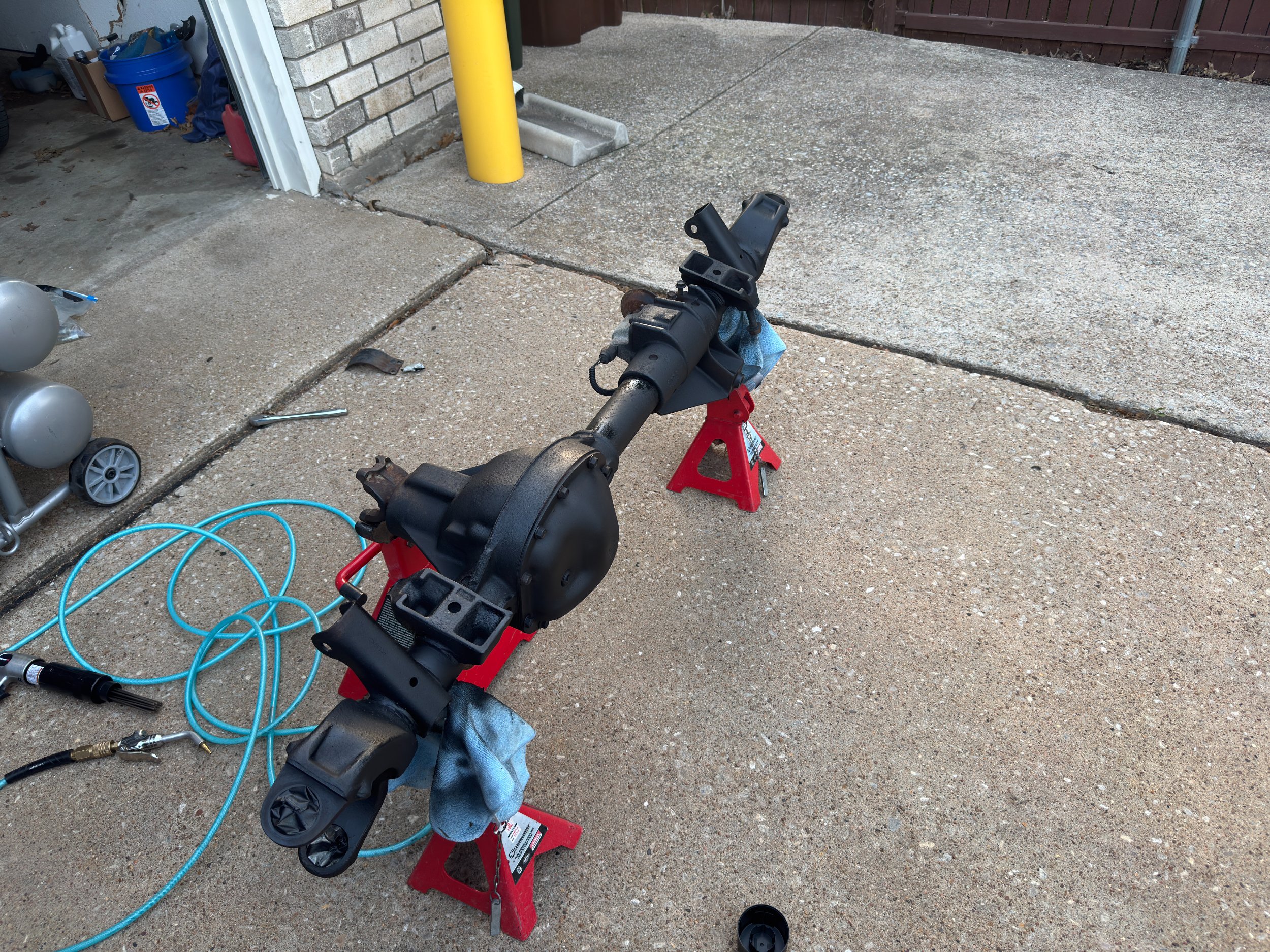

The following day, I took it back to the driveway for some needle scaling treatment. I didn't take any after photos. because I wanted to beat sunlight for rust reformer painting. Overall, I removed a decent amount of scale. Then I shot it with a coat of rust reformer. This was on Wednesday.
Thursday was a start to the weekend (had Good Friday off), so I shot the coats of actual paint (VHT epoxy gloss) earlier in the afternoon. While that paint dried/cured, I got started on the swap work, which carried through Thursday evening and all day Friday. I got the old axle out from under the YJ, and put it on stands next to the new axle. I then tore it down because I wanted to use the spider gears, intermediate axle shaft, and pinion yoke that were installed in it.
Final painted photos:

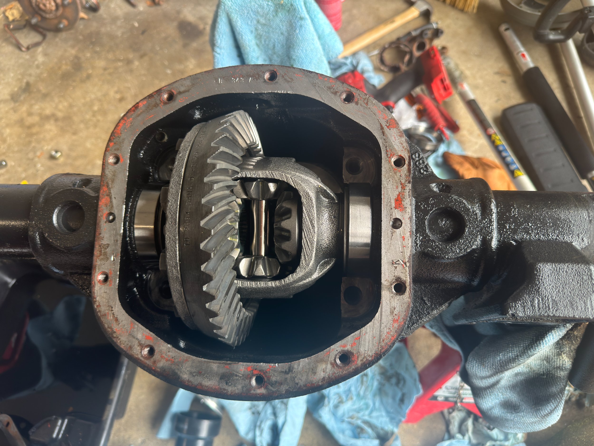

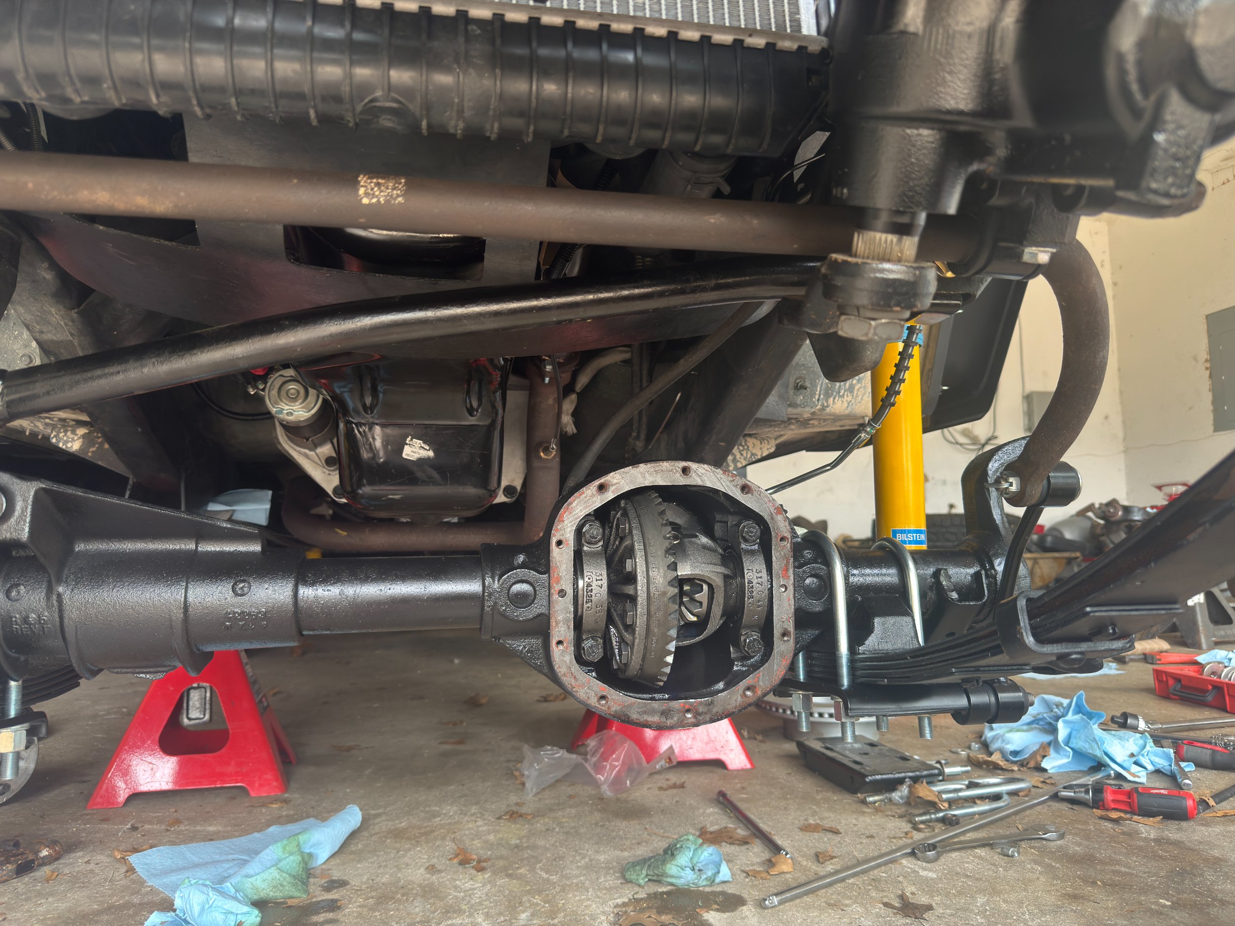

I didn't take many photos during the swap/rebuild process. Just too busy, hands too dirty, mostly stayed away from my phone and just worked.
Overall, the new axle tore down pretty easily, after all, the only thing left that was not removed before painting was the pinion. That was not difficult to remove at all, but the old seal was really stuck in the housing. That took me some time to work on, probably 30 minutes.

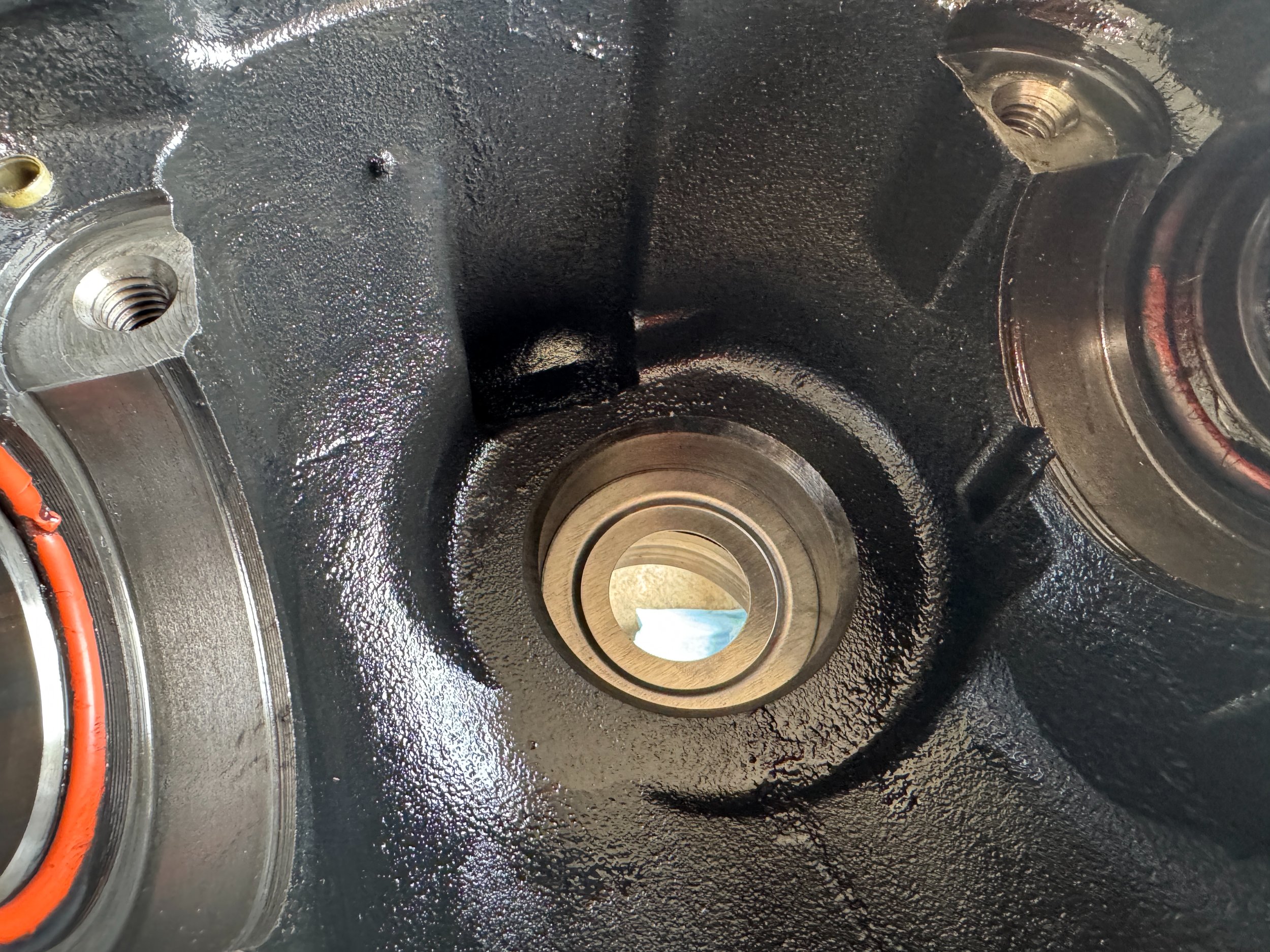

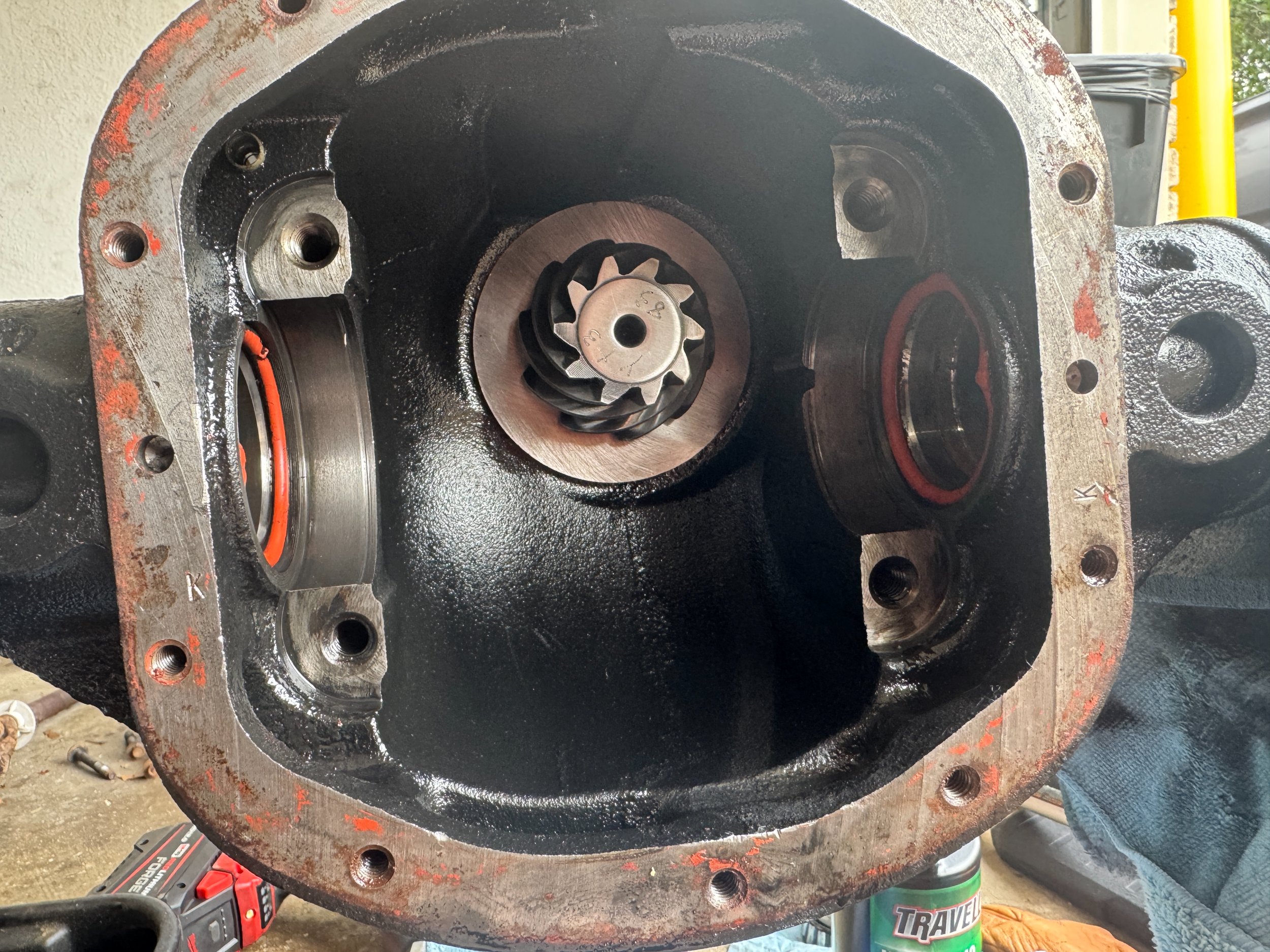

Got the races out, everything looked good. Destroyed the oil baffle, so I set a new one in place:
The factory sets the pinion depth with a custom thickness oil slinger, which is located between the pressed-on inner pinion bearing and pinion head. I measured my oil slinger at 0.057". The baffle also factors into the pinion depth, but they only make one baffle part number, which all axles receive. It is 0.020", for a total pinion depth of 0.077". After setting the baffle in place, I Installed the inner and outer races. The inner race sandwiches the baffle in place up against the housing.
I pressed on the new pinion bearing with the old oil slinger and set the pinion into the housing (housing facing down at the time). I then slid on the pinion preload shims, followed by the outer bearing, and then installed the pinion seal. Pushed on the yoke and tightened the nut to 200 ft lbs.
Pinion ran nice and smooth. Some resistance, but not too much. Not tons of pinion preload, but this is how it was stock, so I'm sure it's fine. Maybe 5 in lbs. These end up having basically no preload once they wear in with some miles, so I have to imagine it was very similar to this same result when it was new.

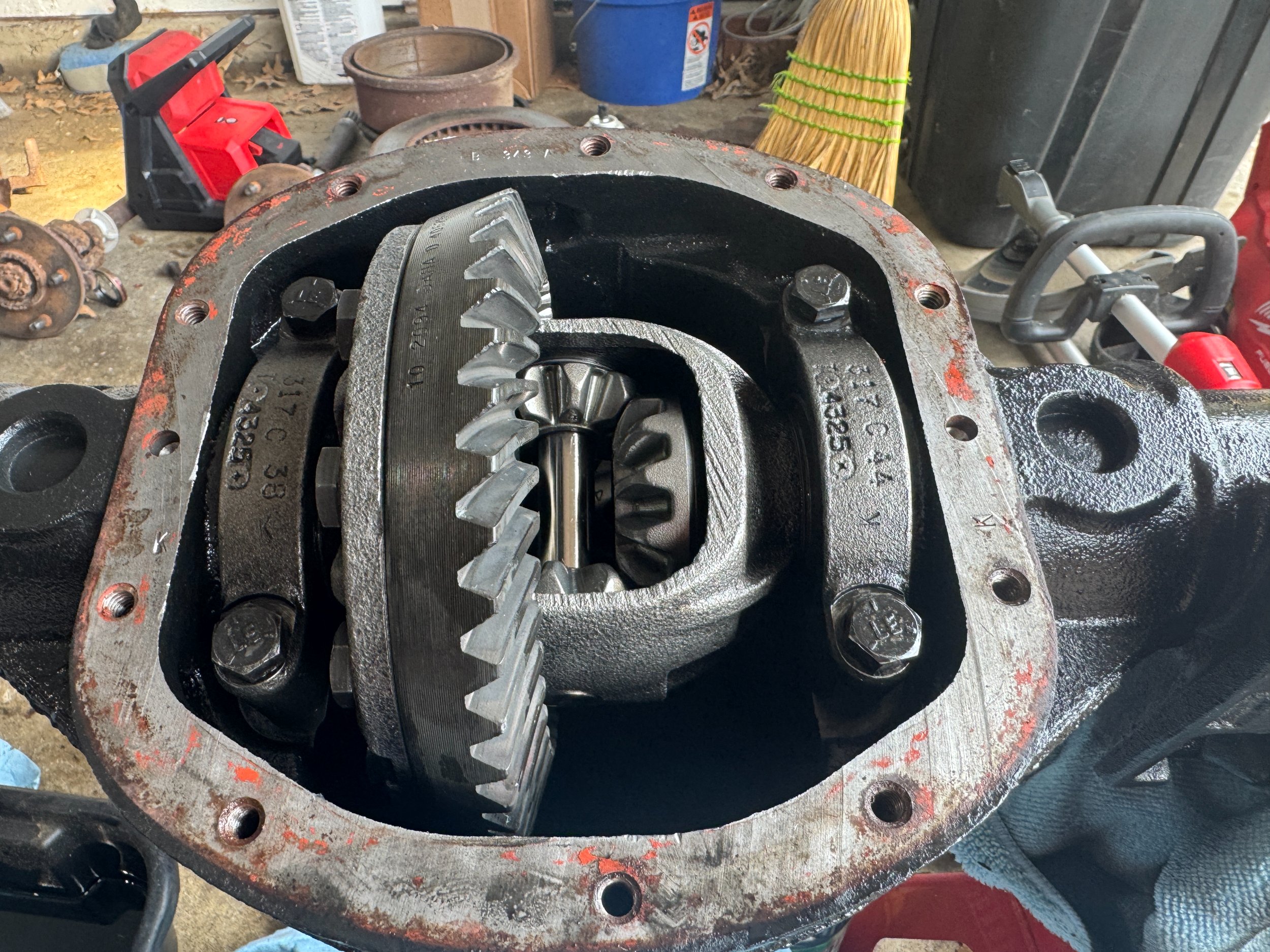

Next up, was the carrier. I had previously installed Spicer net forged spider gears. They are stronger than stock and resist pitting, chipping, etc. They are an upgrade that Spicer offers for some of their diffs. They are unnecessary for what I'm doing, but I like the idea of them anyways. To get the cross pin out, I had to remove the ring gears from each carrier, so I did that and swapped the gears. Installed the ring gear back with the new gears.
One thing to note: the factory service manual recommends 70-90 ft lbs for the 3/8-24 bolts that the ring gear uses. This is much too high for a bolt of this size. More ideal is around 55 ft lbs, and red loctite. Be sure to clean out all oil out of the bolt holes when doing this.
Spider gears installed in old carrier, ring gear back on, sitting in the housing. New carrier bearings were installed as well. Everything cleaned up and shiny.
Carrier bearing caps installed and torqued to spec, 45 ft lbs. Make sure to flip the caps the correct orientation, matching the letter stamp to the housing. In this case, "K"

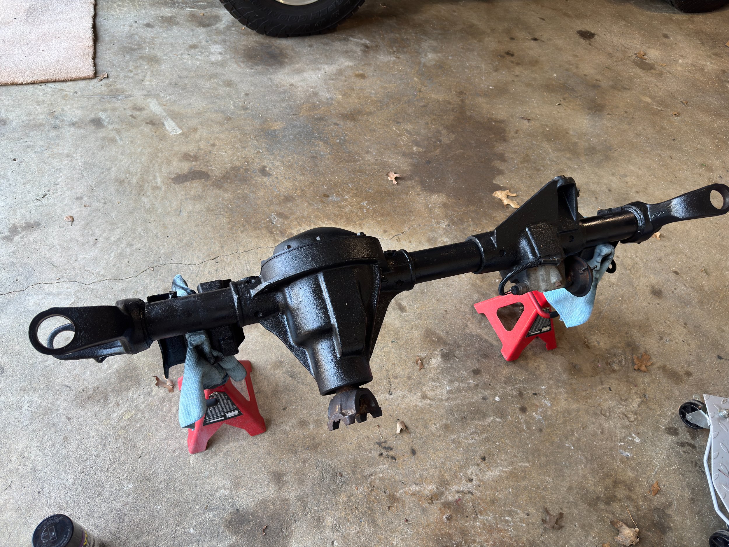

At this point, the axle was ready to install. I muscled it over to the Jeep, and underneath. I set it on the leaf springs that were sitting on the floor, and then lifted up one end at a time and put jack stands under the inner C's, to hold it higher than the springs. I then hooked the springs back up to the shackles and let the axle back down onto the springs.
Don't have many photos of the install, but I used all new u-bolts, nuts, spring plates, etc to reinstall the axle.
Following that, I installed Bilstein 4600 stock length shocks to replace the Old Man Emu shocks.
I didn't take any further photos beyond this point. The rest was installing new Spicer ball joints, the knuckles, axle shafts/unit bearings, brakes, diff cover, tie rod, track bar, and filling with fluid. Nothing crazy, just a typical front axle.
I got it buttoned up the rest of the way and put it back on all fours and went for a test drive. Since the knuckles, tie rod, and axle all come from the same setup that was stock and known to be aligned correctly, I know my alignment is now good. Of course, I will need new tie rod ends at some point, and new knuckles would clean things up nicely. But in the meantime, it handles much nicer now with the tires toe'd correctly. It returns to center somewhat, which seems about normal compared to how it used to be long ago. I recall it always needing some help to return to center, even when it was bone stock. Smaller tires will help push it back to center as well, due to the scrub radius change in the positive direction.
That's really all there is to say about the front axle. Now I'm working on the rear. It's torn down but sealed off so I can work on cleaning up the exterior. I'm going to cut off the broken track bar bracket and start working on cleanup, painting, etc here in the next few days.
