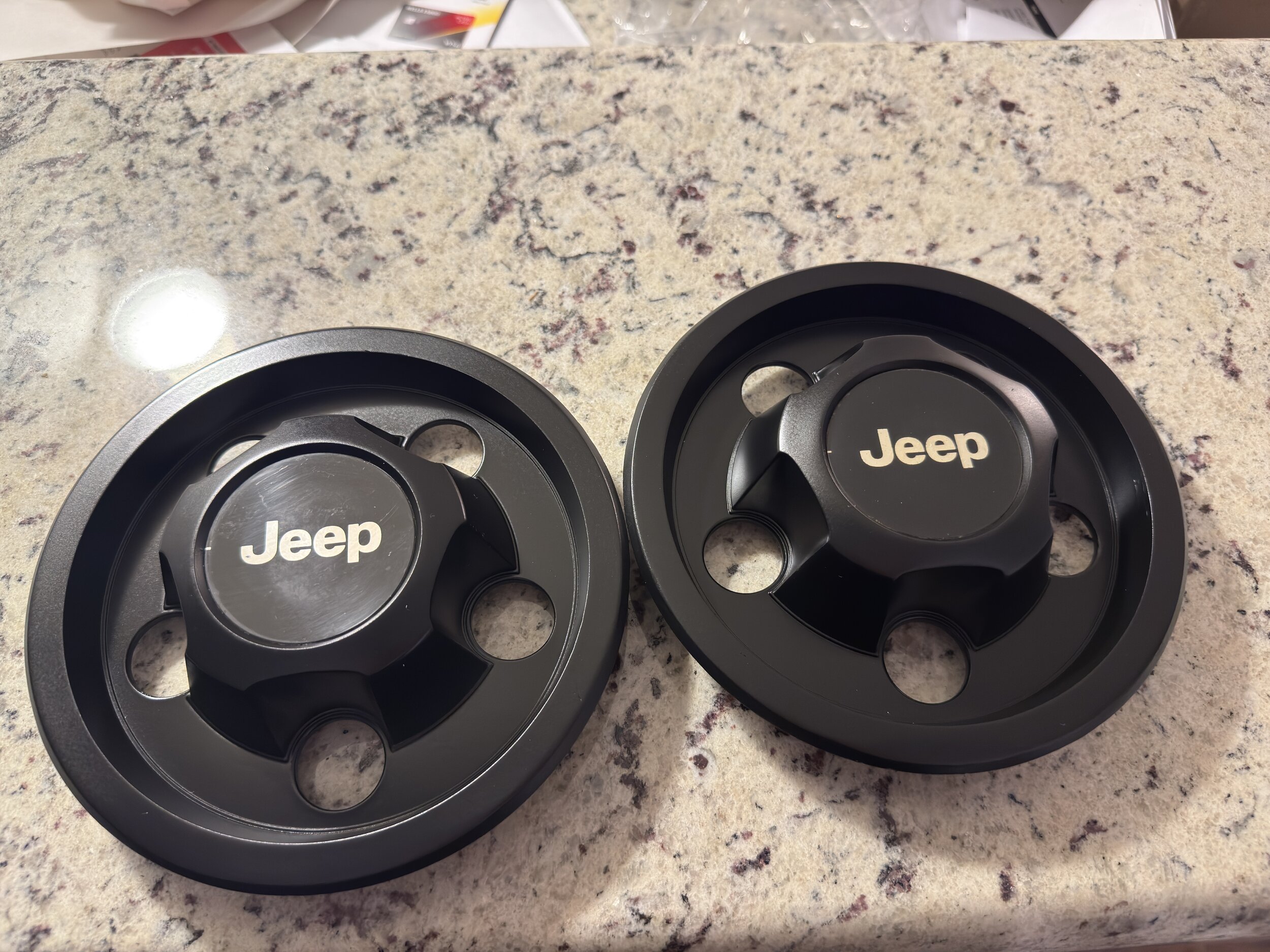

I got the center caps from hubcaps.org. We will see how they look today. The OEM screws for them that hold them to the wheel from the backside are impossible to find, but I found a YouTube video saying that #12x1/2” stainless screws with a slotted hex head will do the job. So I ordered a box of those screws from McMaster and today will see how they do with the caps when the caps come in. As long as the caps and wheels are in good shape, I’ll be real happy with this swap. Thing is going to look fully original when I’m done. Didn’t think I’d take it this far honestly.
I like the steel rims as well. Mine came with TJ Canyon wheels, painted dark. They’re ok, but i like the originals better. Where did you find the center caps for sale?
The center caps look fantastic. Very little evidence to say they were used. They are definitely used, but the paint job is great and the Jeep stickers in the middle are in good shape. So I recommend these for sure.

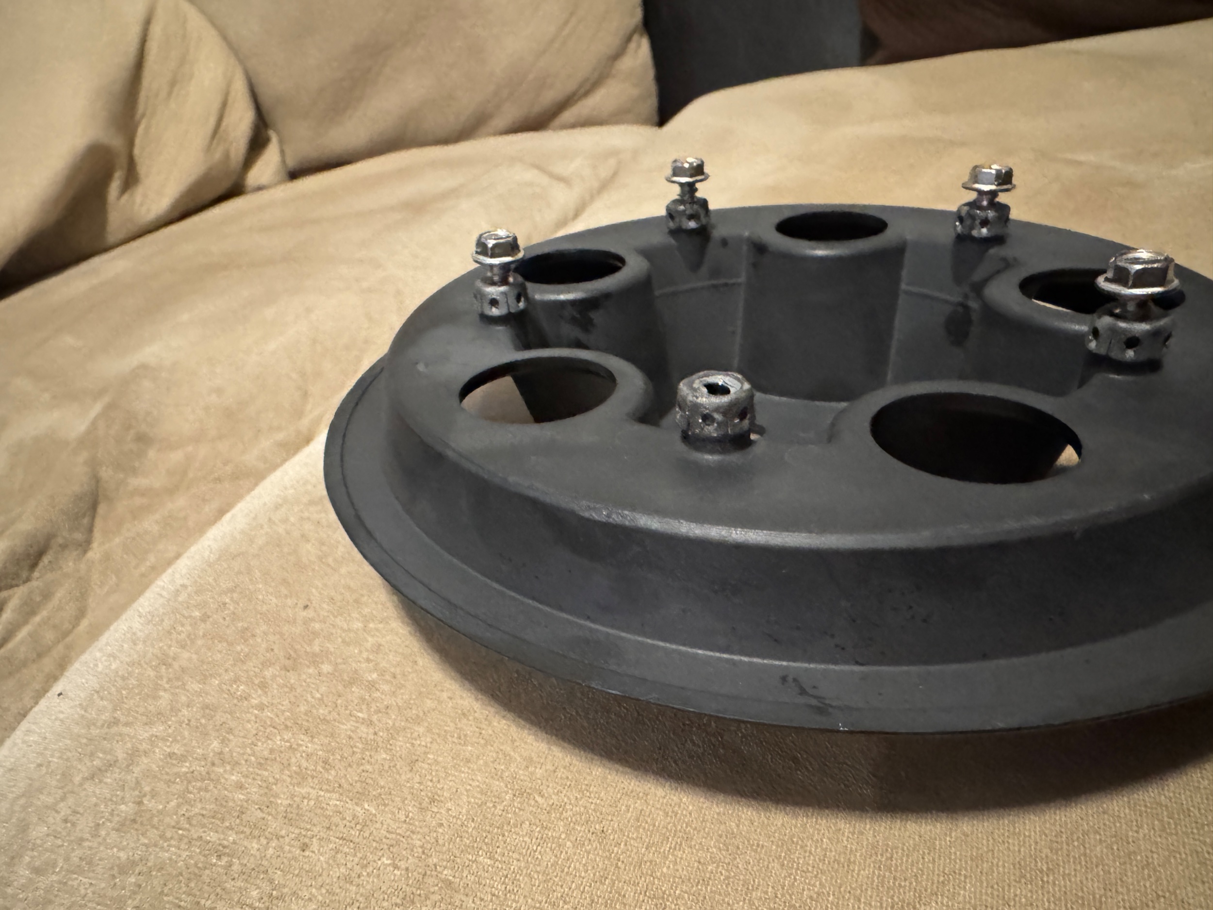

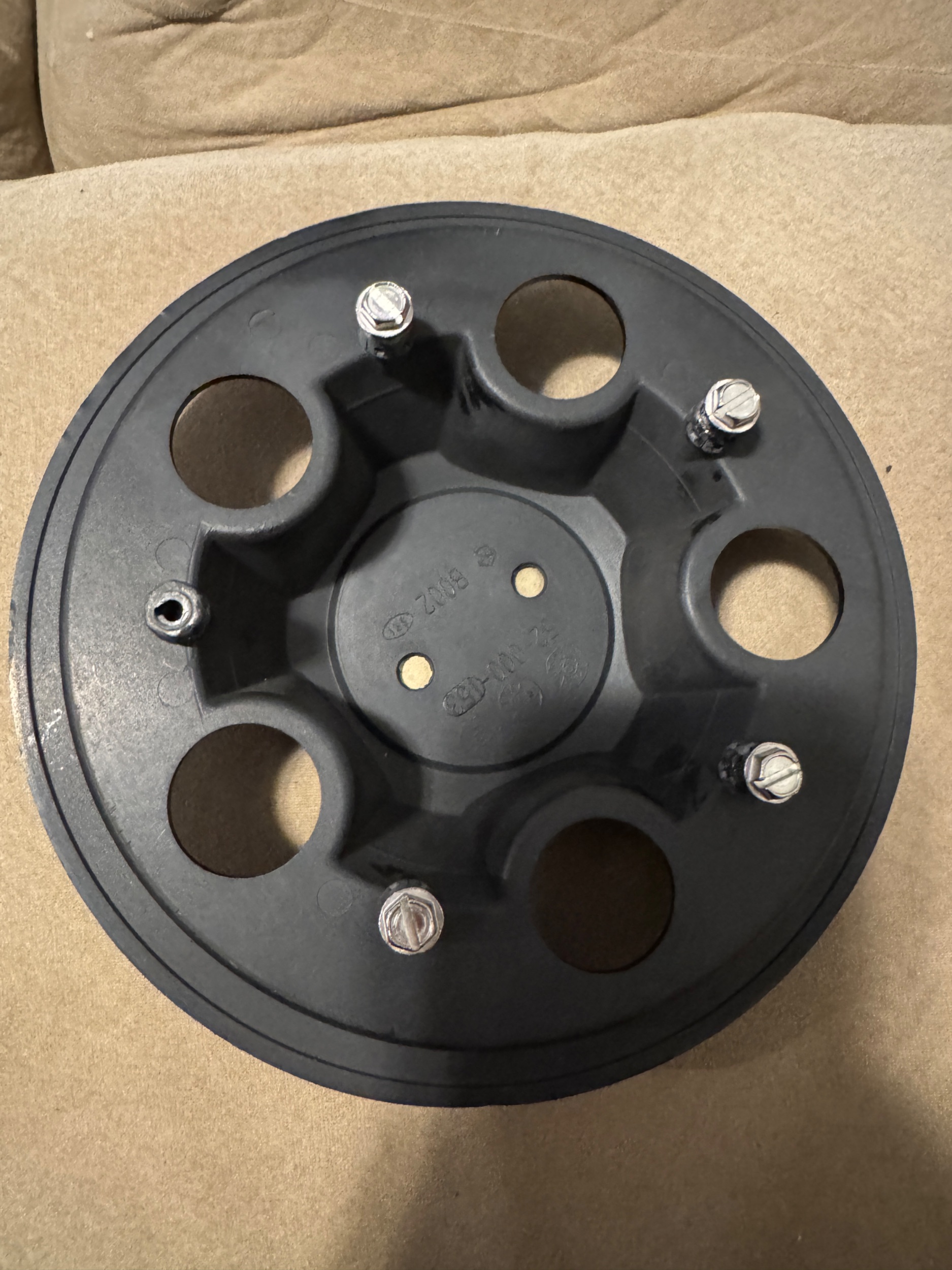

One snag though is that the fastening method for them are built in plastic posts with little sheet metal threaded caps crimped on top. Eventually the plastic wears out at the crimp and the caps spin. No bueno. Most of mine are holding firm, but a few of them spin.
Part of the problem is the screws I’m using. A YouTube video recommended using #12x1/2” sheet metal screws with a slotted hex head. I think #12 is too large. I think the resistance of the screw threading in helped to spin the caps. #10x1/2” holds the cap perfectly firm to the wheel and doesn’t offer much resistance to thread in, which is good. #10 is also ideal because #12 is close to the same size as the wheel holes, so the screws have extra stuff to thread through before they even get to the cap. Makes it difficult to remove the screws from the wheel even when they are clear from the cap. I suppose that could be good or bad. Anywho, I will be going with #10s unless they prove too small in some locations. I doubt that will happen.
For the ones spinning, I will pop them off and adhere them back on with a strong super glue and see how that holds. If it doesn’t, I’ll try a plastic to metal epoxy. I think the super glue will be good enough for what we’re doing though…I sure hope so anyways. These need to be removable for future tire installations.
I picked up zinc ones from Home Depot for testing, but to prevent any future seizing, I’m going to order stainless from McMaster Carr. It’s worth doing right.

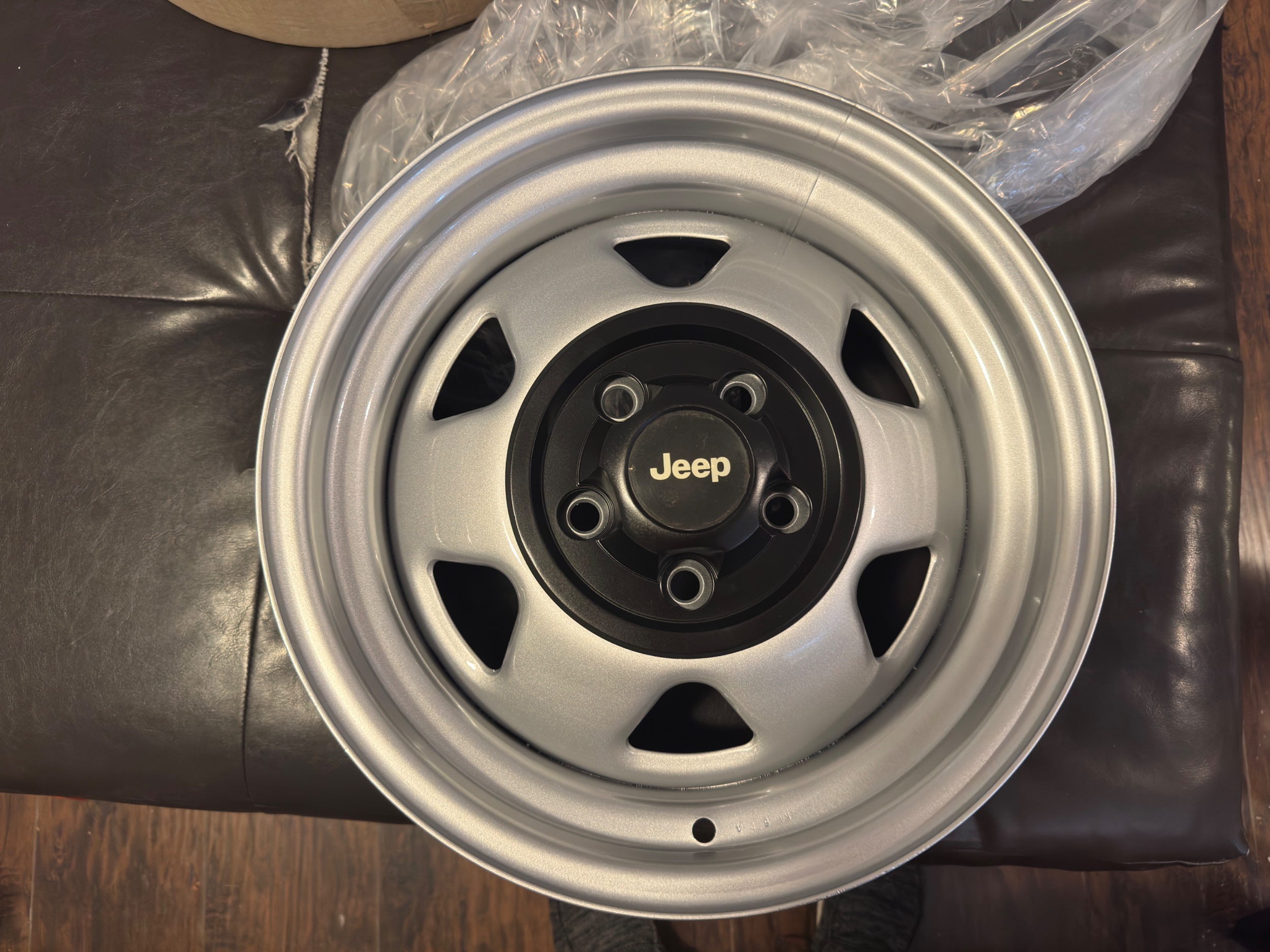

Wheels finally shipped, so hopefully once the KO3s come out in my size, I can get those mounted quickly. Like I said, I ordered from OriginalWheels.com. Based on my initial impressions, great place to buy from. They called me to let me know that my 5 wheels would ship from 3 locations and might look slightly different shades of silver. I could return them if unhappy but I would end up eating all shipping costs including shipping originally paid. I expressed concern with this and so they started a hunt for 5 wheels not already finished, which they could gather up to one location, then do their work on all at once so they would all look consistent. They located 5 wheels within a few days and refinished them over the last 3.5 days. All at no additional charge vs what I paid originally.
They shipped today and I'll get them Sunday. Not too bad at all. Hopefully they look good.
Reactions: Plastic Fury
Are they painting them silver or putting a clear coat on the steel?
As far as I know, they strip them down and repaint them silver with clear. The styled steel wheels are originally silver (or really called Argent) from the factory. My understanding is this company restores them back to that the best they can.
I just hope they do good work and that the paint holds up. If not, I'll probably get them powder coated in a similar color later down the road. Also probably keeping my TJ wheels just in case, but will sell the tires off of them at a minimum.

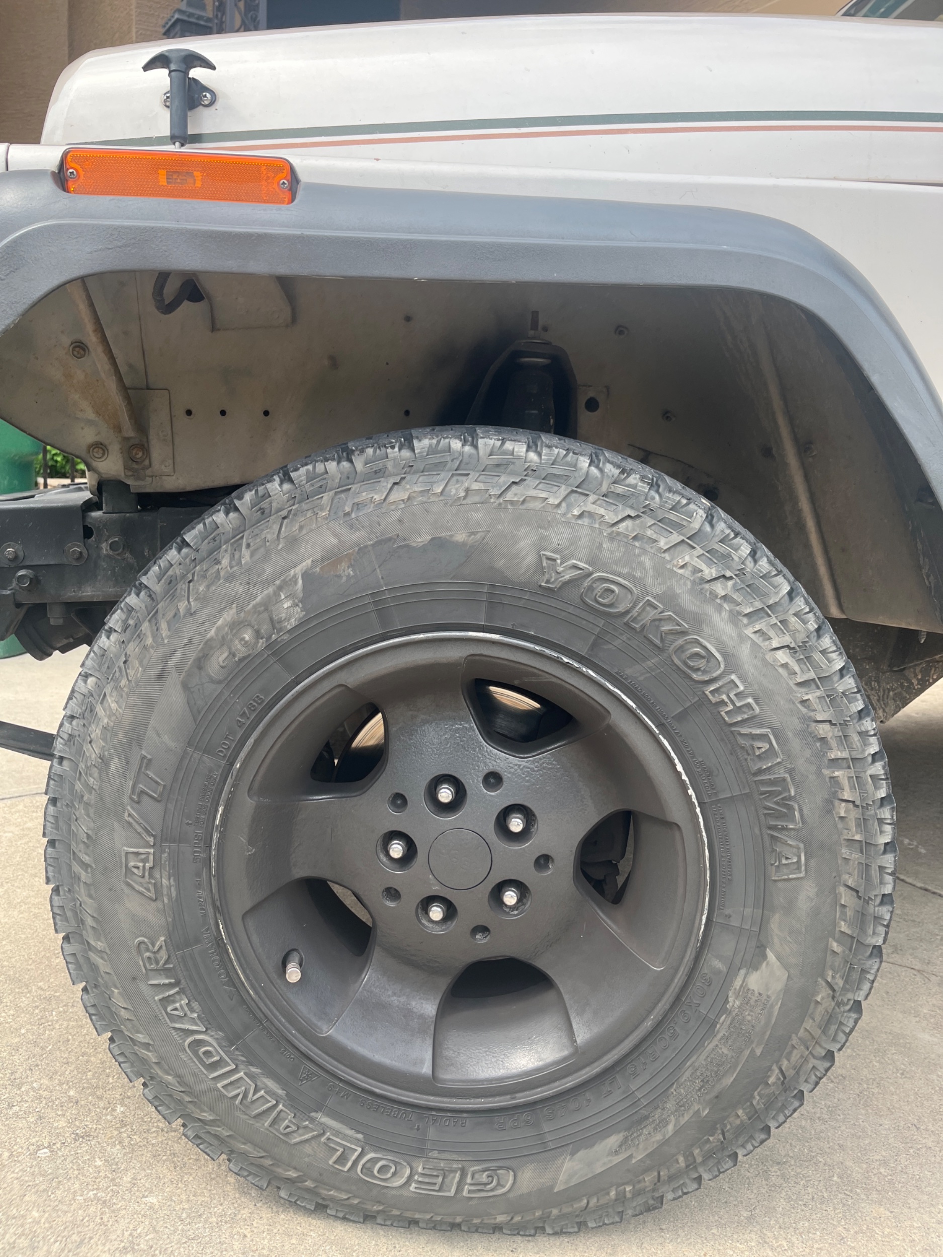

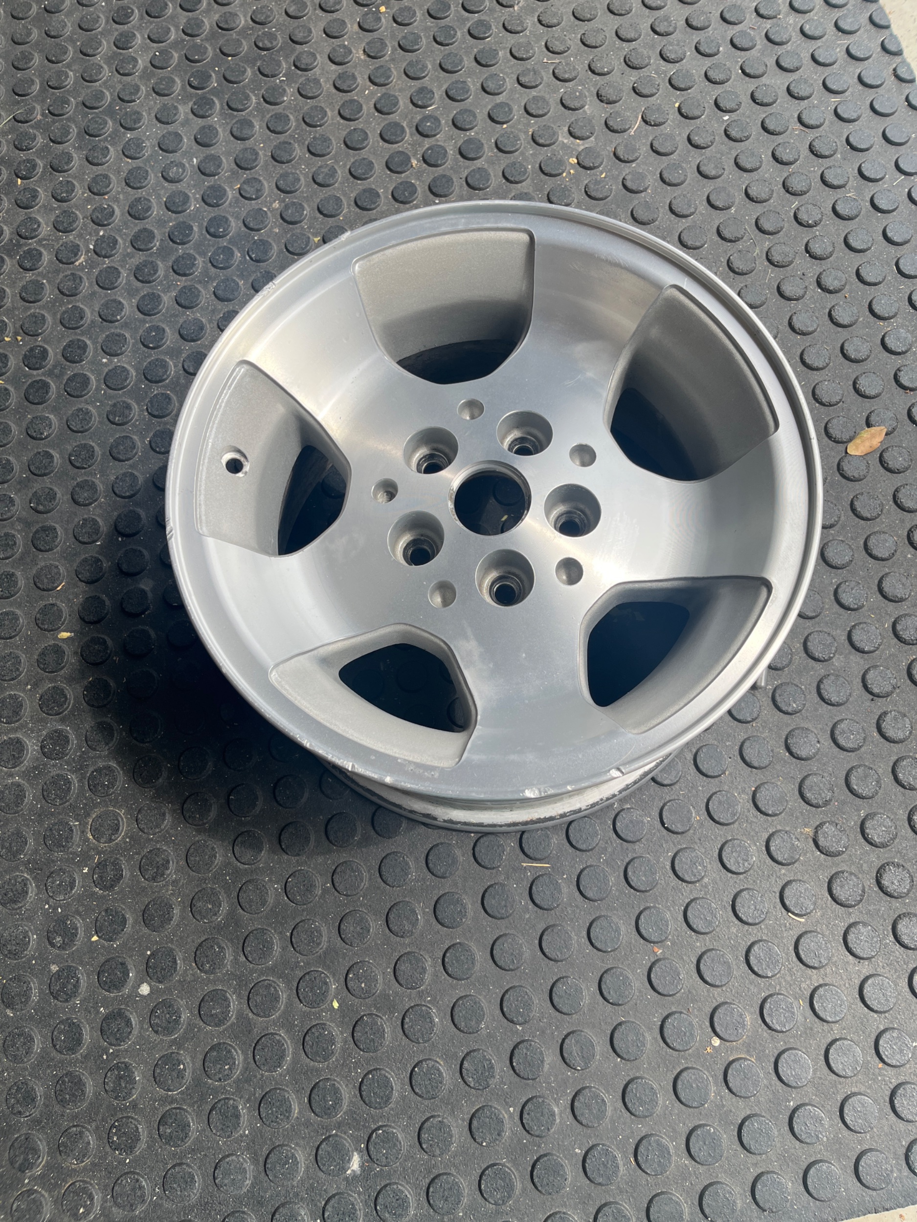

My Canyons came to me like this:
It looks ok, but I stripped and refinished the spare with clear only. Getting a new Geolandar A/T4 on the rim tomorrow.

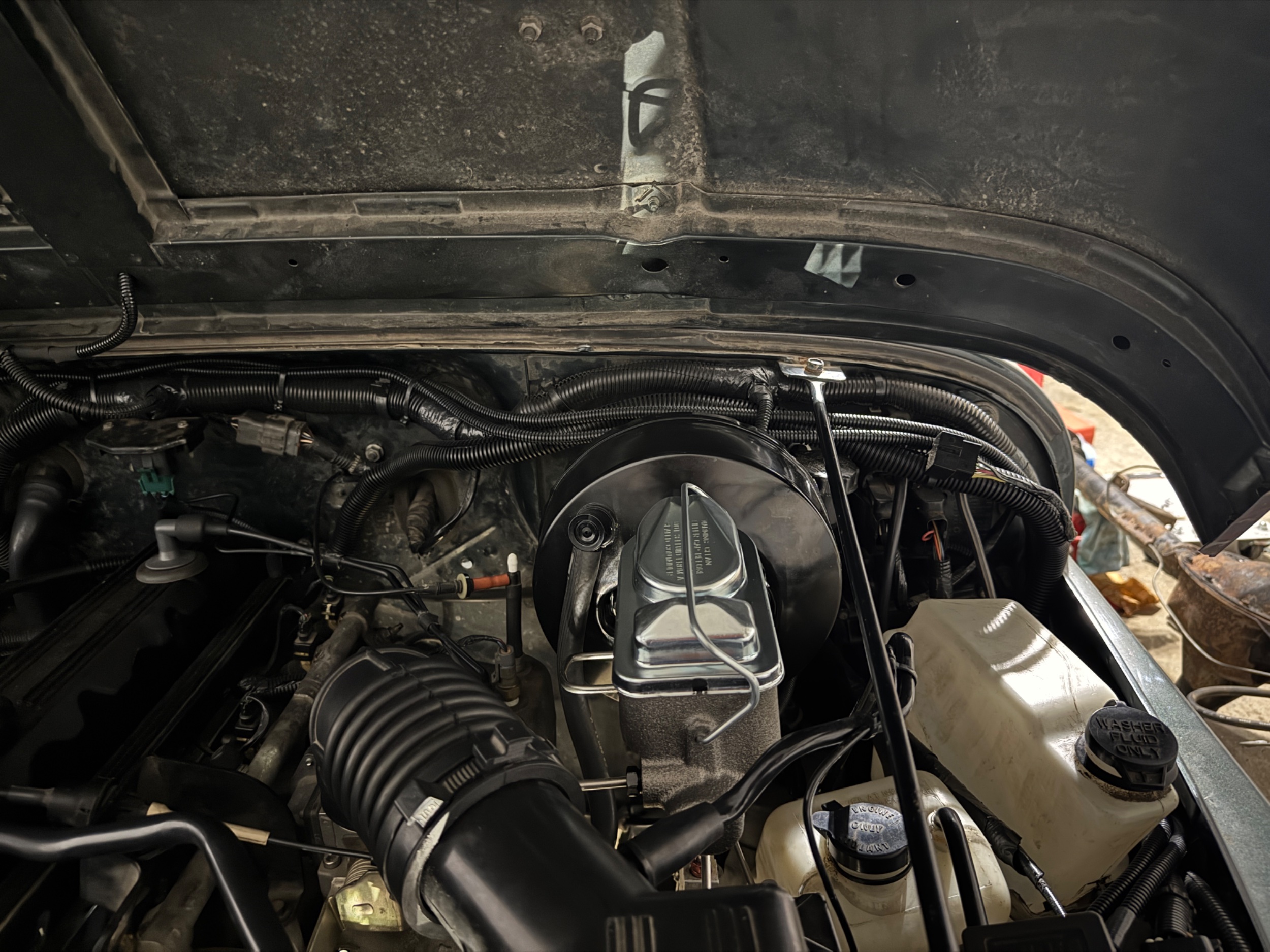

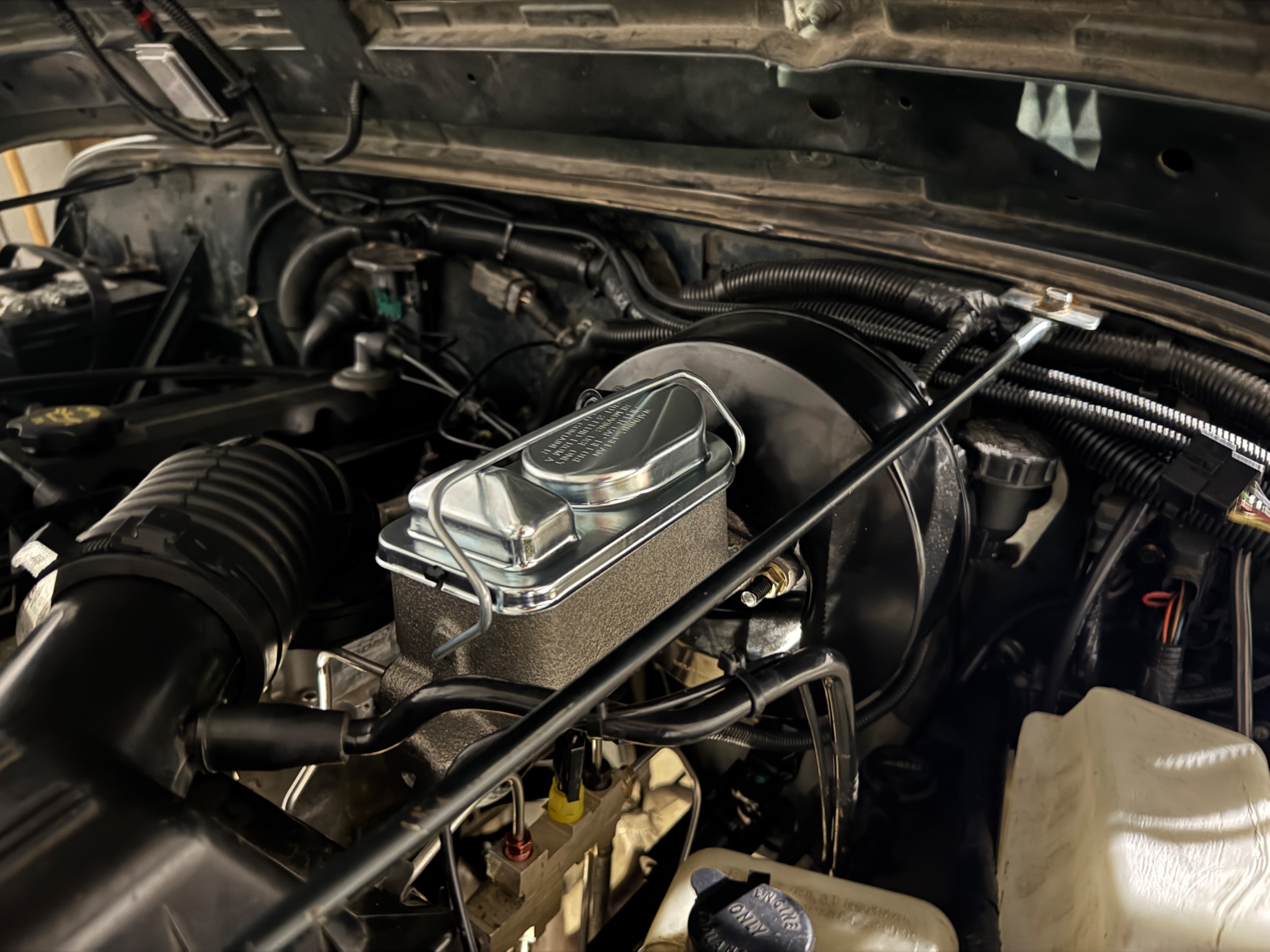

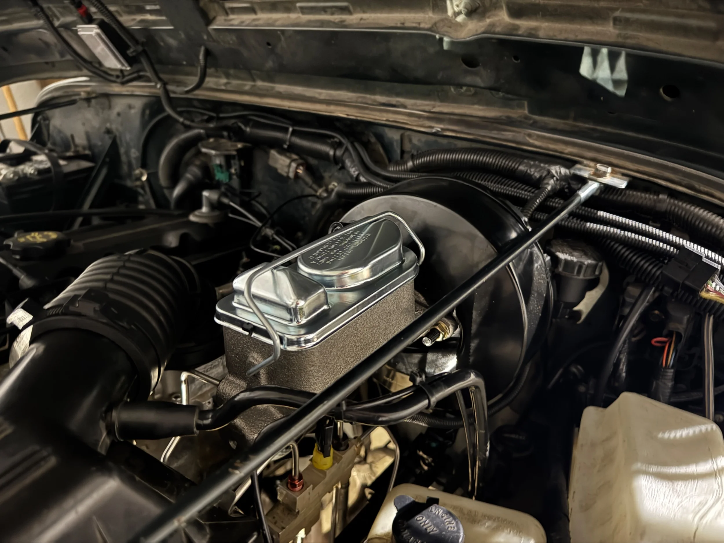

Worked on my neighbor’s dodge today, which was a new brake booster and master cylinder job. Not fun, not terrible. It went well enough that after the fact, I felt motivated to bleed the brakes on the YJ, so I drove it into the neighbor’s garage and had him help just as if it was a continuation of working on his truck.
Afterwards, the pedal felt better, but still not right. I could stop with some enthusiasm finally, but it definitely still was nowhere near where it needs to be.

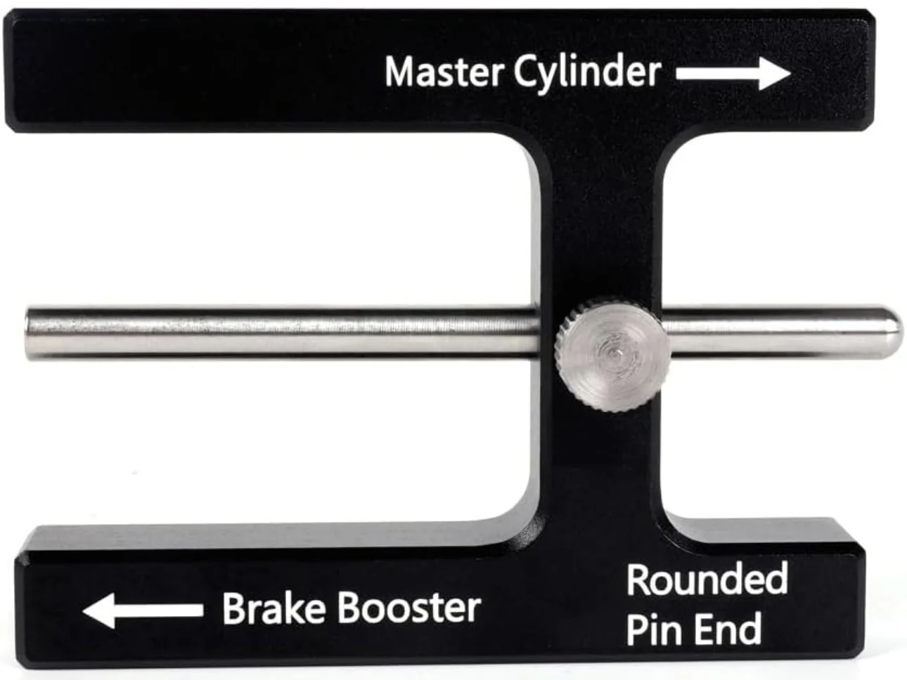

I learned that my brake booster pushrod adjustment tool is junk. It’s the type that you butt up to the MC, set depth, then put it on the booster and adjust booster pushrod until it fits the tool setting. Problem is, the center adjustment piece is too long, which is inevitably making the booster pushrod adjusted too far inwards.
This leads to lots of pedal free play and wastes precious pedal travel. Set up this way, the pedal didn’t do anything at all for over an inch of travel.
I didn’t like my painted master cylinder…the paint was proving to be a mess. I should have known better since brake fluid is at a high risk of running down the sides during service, but I painted it anyways. Wanted that out of my life and so I bought another MC from AutoZone, and bench bled it and installed. Now, my neighbor and I will bleed it again, maybe tomorrow. The pedal seems a lot more firm now with the engine off than it was before. Maybe now I’m finally in business, once the wheel brakes are bled? We will see.

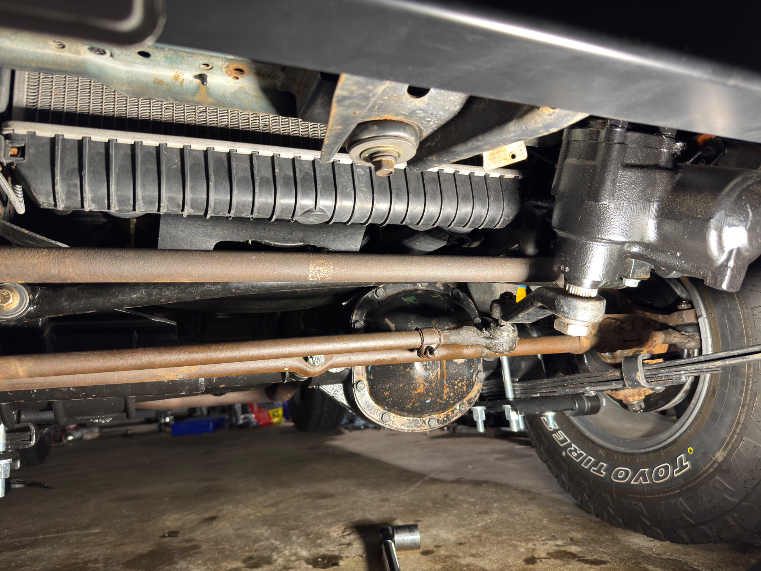

One other thing new is that I learned the TJ pitman arm I’ve been using is actually not the correct height. It has about 1/2” less drop than the YJ model, so it was holding the drag link up a bit. Dug my factory pitman arm out of the bucket of old parts and reinstalled it. I don’t remember why I even am using a TJ arm, I think because at one point when I deleted the lift, I needed a new stock one and couldn’t find mine anymore. Well, now I found it and so that is swapped back. Drag link is nearly 100% flat now…nice. Matches the front track bar perfectly.
The drag link is part of the linkage that came on this front axle I bought, which the guy had installed a 4.5” Rubicon Express lift. So, the drag link is too long. I think that is part of the poor handling, because when the steering gear is not in the “steering-wheel-straight” position, it wants to provide assist. I’ll try to adjust that tomorrow, hopefully that helps tremendously with poor handling feel. Which again, isn’t too bad, but it still doesn’t feel right. I really don’t think I’m expecting too much. Mainly, it’s still a bit of a handful to drive, and I haven’t even taken it up to decent speeds yet, so I feel it’s reasonable to say it’s still not right.
I am hyper sensitive to poor steering…it is my number one complaint over all the years. The initial lift is what started it all, years ago. Getting back a normal steering feel is a huge part of why I’m going back to stock, and doing so with very little leniency. I’m really hopeful all the little things truly make the difference and bring this thing back to life and not be a handful to drive.

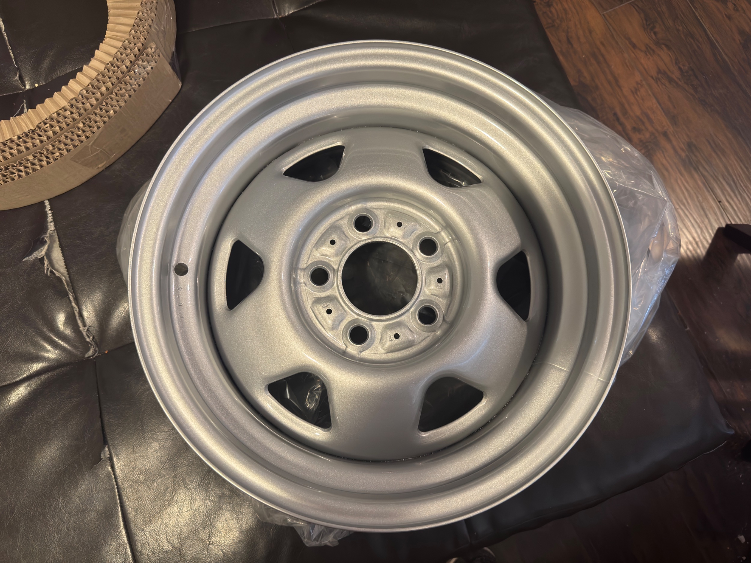

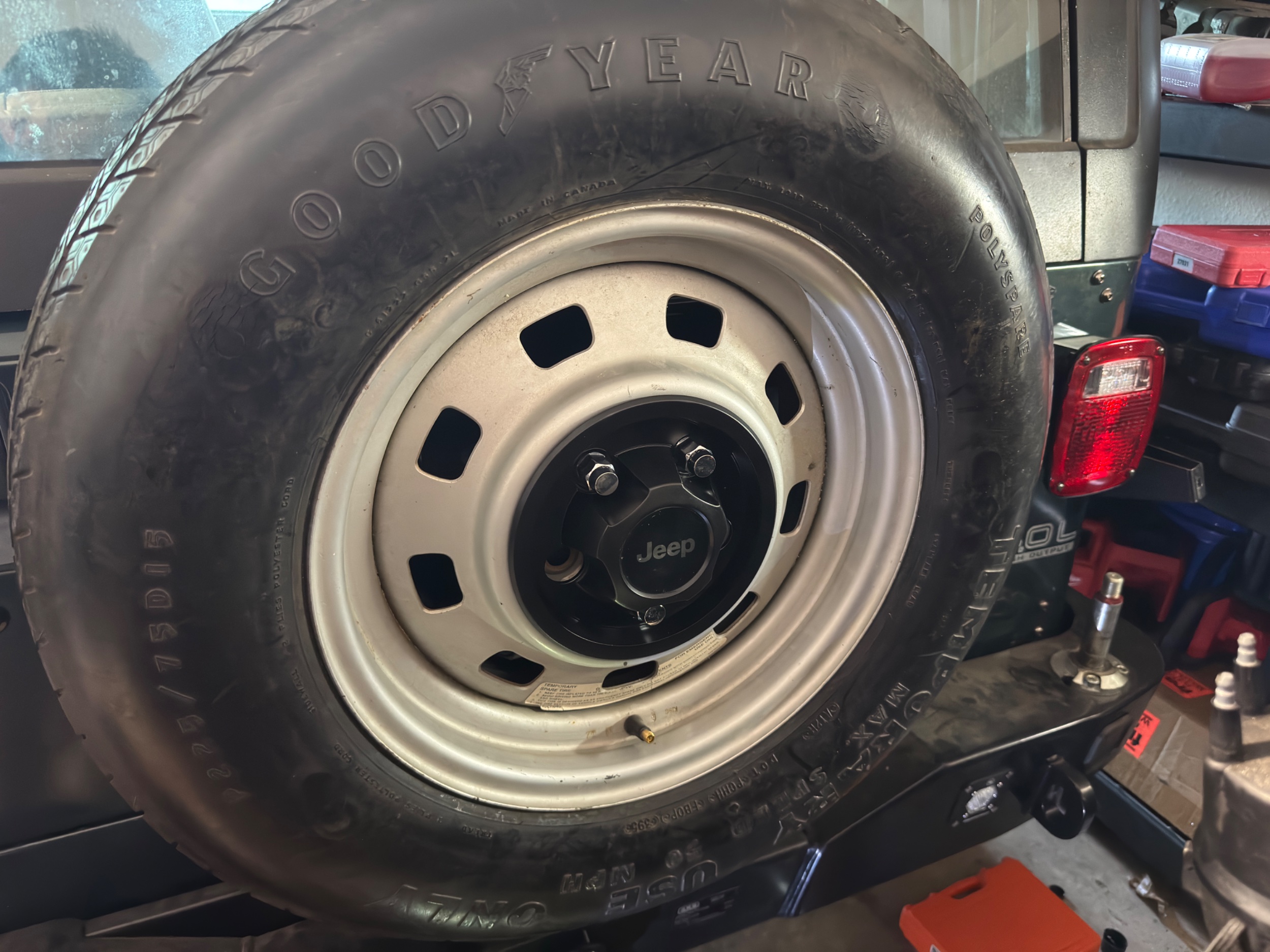

Wheels have arrived. I think they look fantastic. Paint quality seems good. Obviously we have yet to know how it holds up to brake dust and being washed off, but we’ll see.
They’re heavier than I expected. I don’t know what I expected, it’s a steel wheel. They are about 24.5 lbs, about the same as the 15x7 alloy equivalents. I guess just based on the lightweight 15x6 9-slot steel spare I bought, I was expecting these to not have any heft too. The extra inch of width must add some weight. No big deal. Overall with the 32 lb tires I plan to run, it will be right at 56.5 lbs.

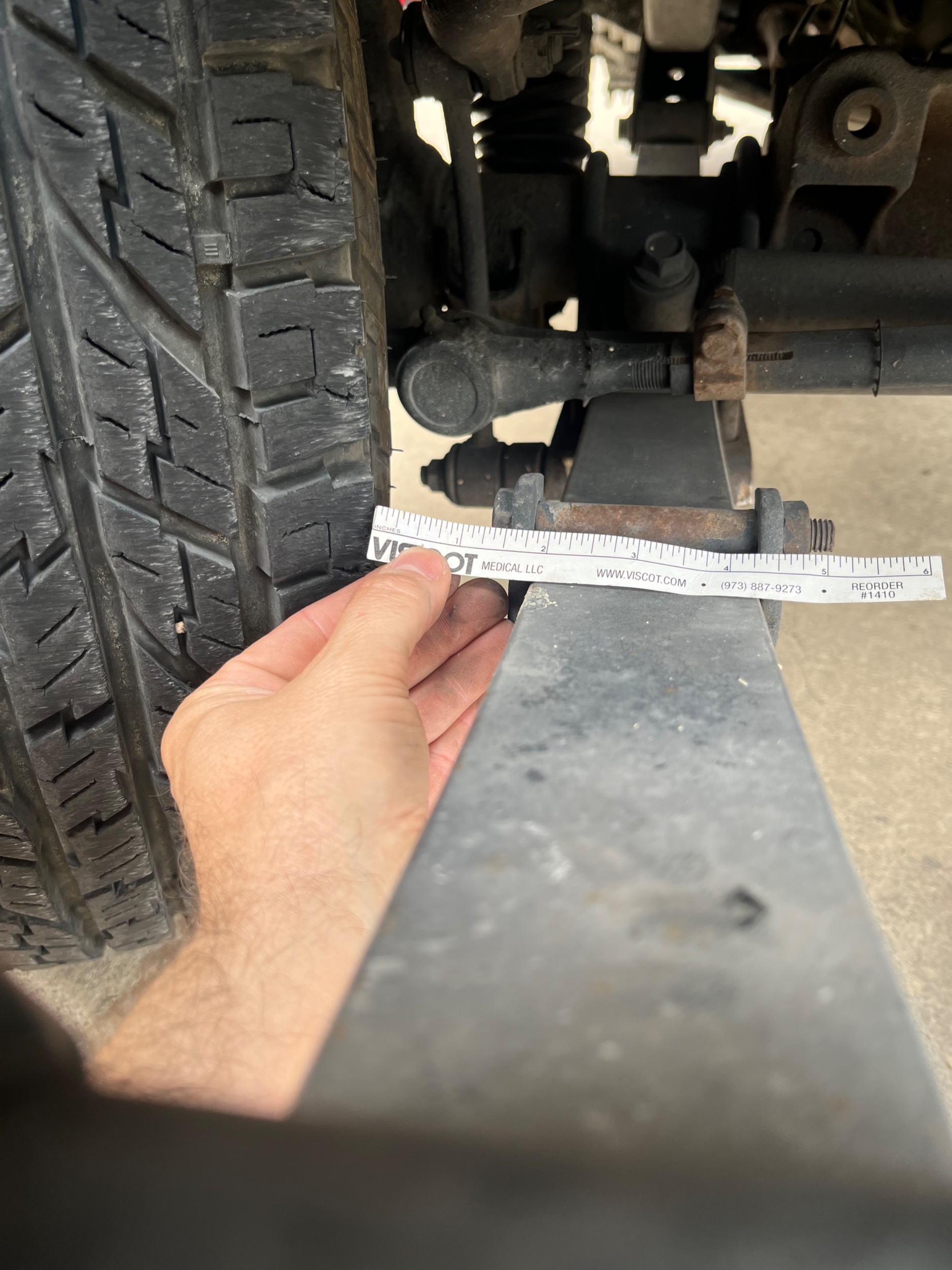

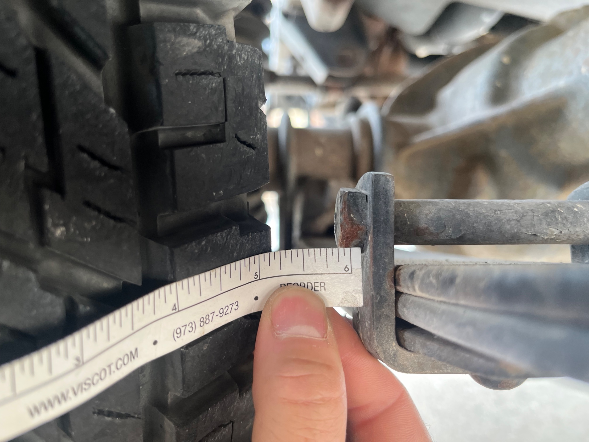

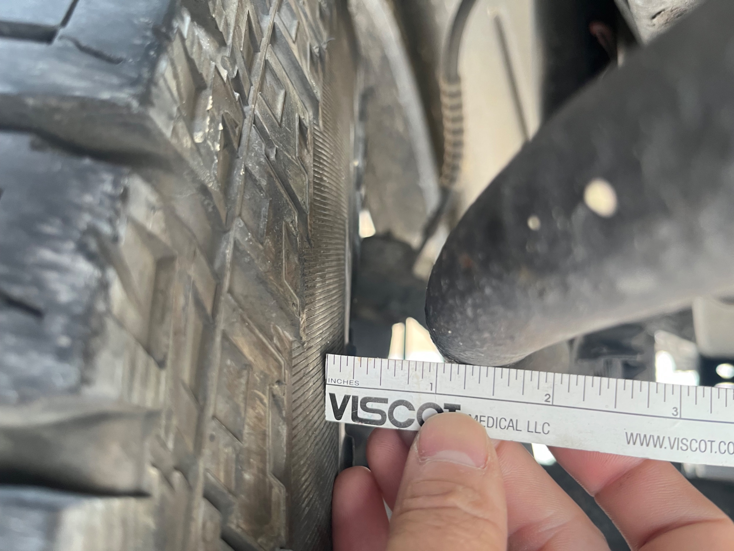

At full lock I have almost an inch clearance from the rear of the tire to the spring and well over an inch from the front of the tire to the spring. About 3/4” to the sway bar.
Yeah, seems right since you have the wider wheels. I rub the right leaf with the back of the right tire at full lock.
I used to hear that 30x9.5 would hit the sway bar, and so I repeated that, but that was without context. Turns out that happens when using the stock 9 slot steel wheels, which are 15x6. They have the same 5.25” backspacing as the 15x7, but the tire bulges much more with the 1” narrower rim width, and so it hits the sway bar and the leaf springs with those wheels. Even 235/75 will rub on those wheels.
