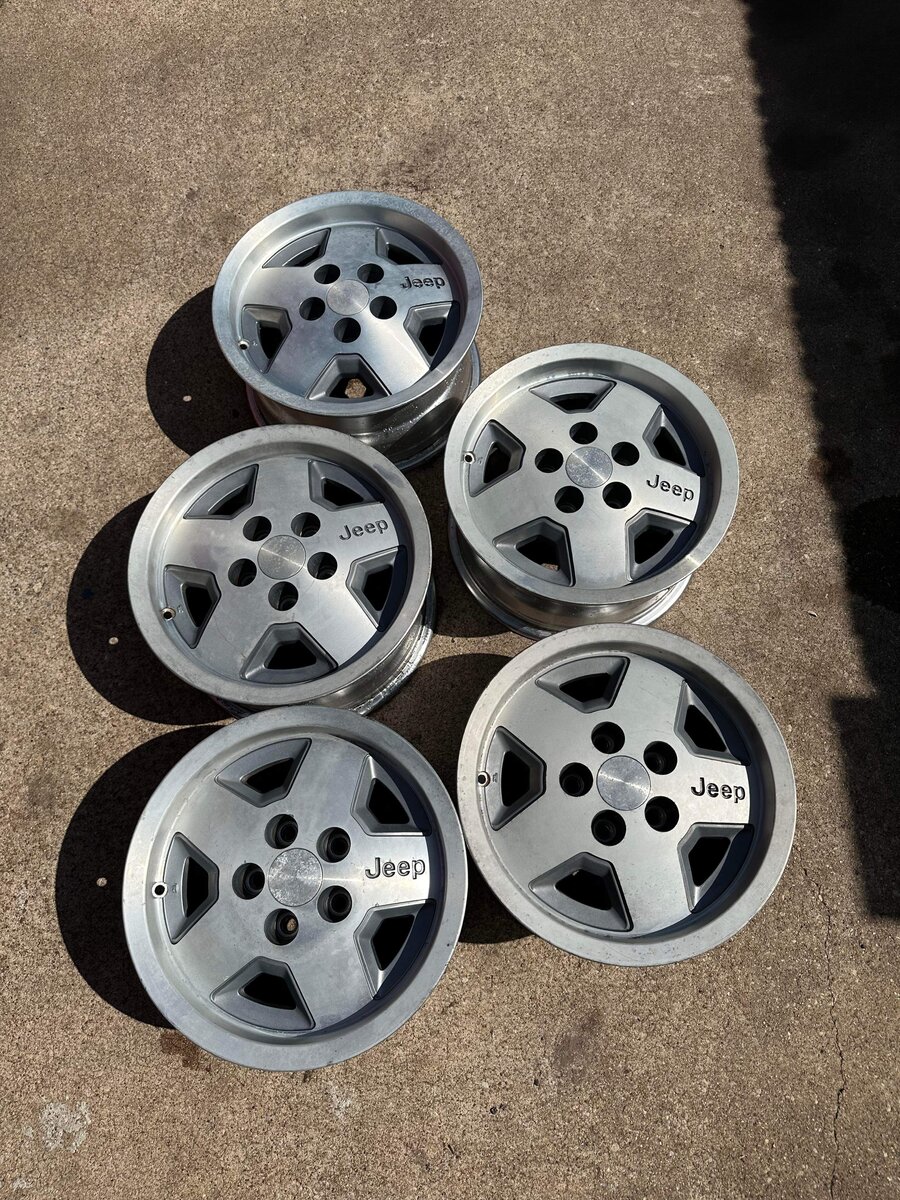

I had a tough time deciding on wheels. I definitely wanted a stock set because I think they look better than aftermarket, and I like the placement of the tire under the fender. I knew I was either going to run 215/75R15 (28”), 235/75R15 (29”), or 30x9.5R15.
I originally bought some of the classic YJ 5-Spoke wheels. I LOVE these wheels and really wanted to run them. I especially like that you balance them with the weights inside the wheel so you don’t see them. Most Jeep alloy wheels want you to clip on weights at the bead of the rim. Not a fan of that.
Unfortunately, the YJ wheels need to be refinished to look good, and the bigger problem is the center caps. You can’t buy them anywhere new, and used all look the same: bad. I refuse to not have center caps, doesn’t look right to me. So until some sort of option ever becomes available for center caps, these wheels will probably just sit in storage sadly.

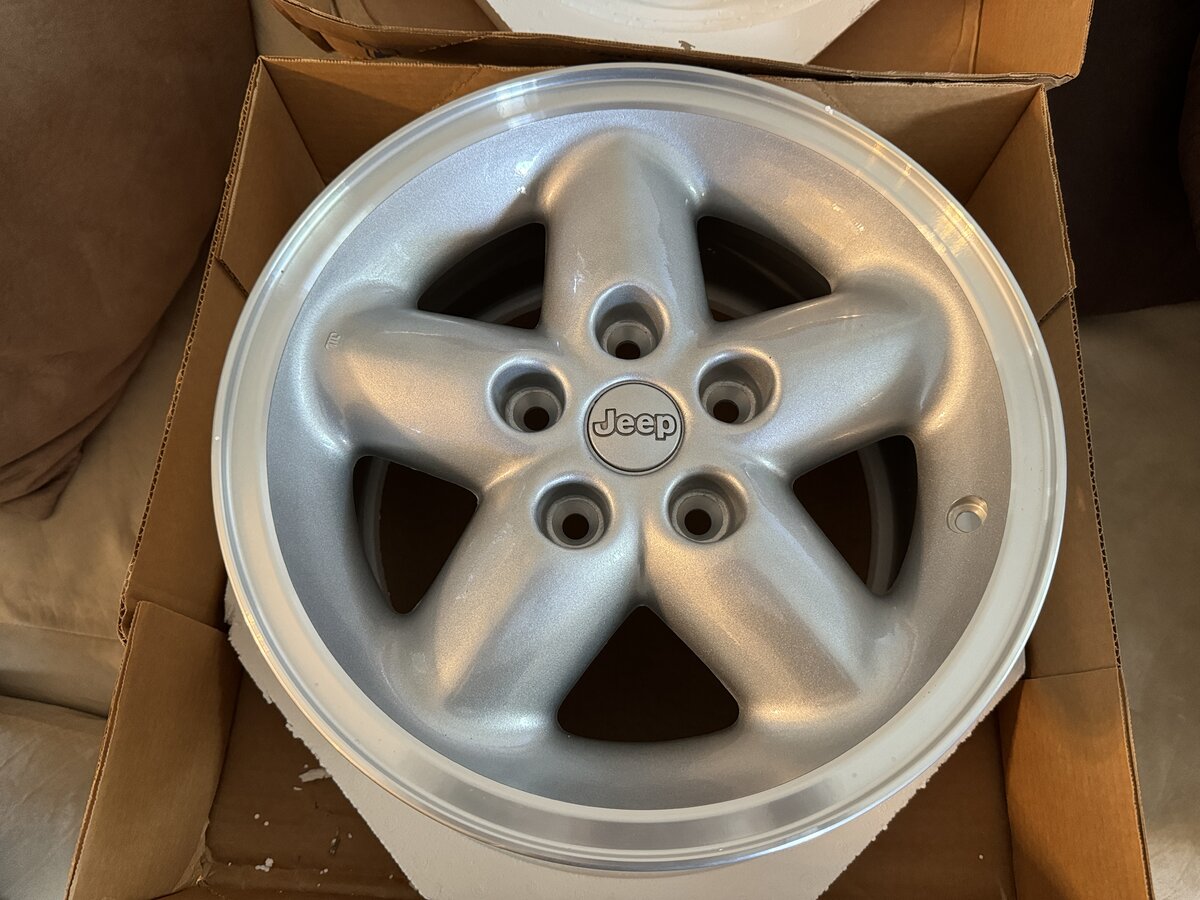

That left me to make the decision again. I always liked the TJ Grizzly wheels. The XJs had a cooler dark gray version with a shiny lip, but they’re harder to find. The all-silver TJ version was available as a set of 4 brand new on eBay for about $200, so I bought those and then ordered another one from Mopar (still available there also, but for more $) for a full set of 5.
The wheels did not come with center caps, so I had to buy those next. I found them at Hubcap Haven, where I placed an order for five caps. Not cheap, but they do the job. They matched pretty well, enough that no one would question it.
However, I saw a set of super clean used wheels from a 2001 go on sale near me, a set of 4 that had the caps. They were only $100, so I essentially got 4 caps for $100 and achieved a set of 4 spare wheels as well lol. I don’t need all these wheels but I’ll probably keep them because it never hurts to have extras. The caps were a perfect match, so I moved the 4 used caps over and used one of the purchased caps. The 4 other purchased caps will be installed in the old wheels in case I ever need to use an old wheel.

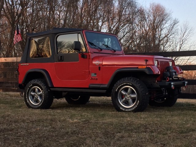

I’m going with 30X9.5R15. I saw this thread by @Chief Hof, which I thought looked really good (and would be functional):
So I decided on 30x9.5 like the photo above. The only difference is I don’t have any shackle lift and that one has a bit, but it won’t matter.
I’m leaning towards Toyo Open Country ATIII. I really like those tires on my truck, and probably going to use them on the YJ as well.
This will be the perfect wheel and tire option for me. It will keep the jeep looking cool but also being functional.

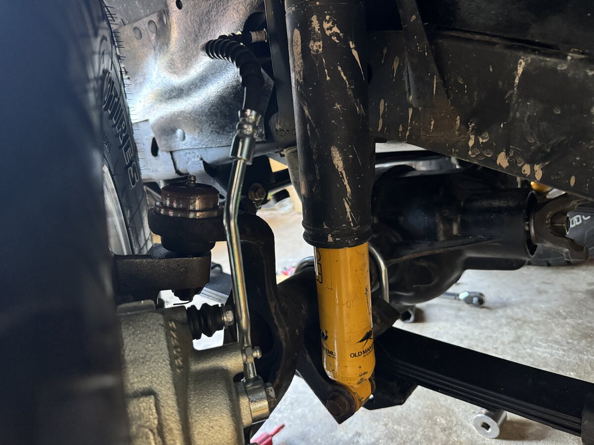

Brake Lines & Hoses​
Stainless Lines​

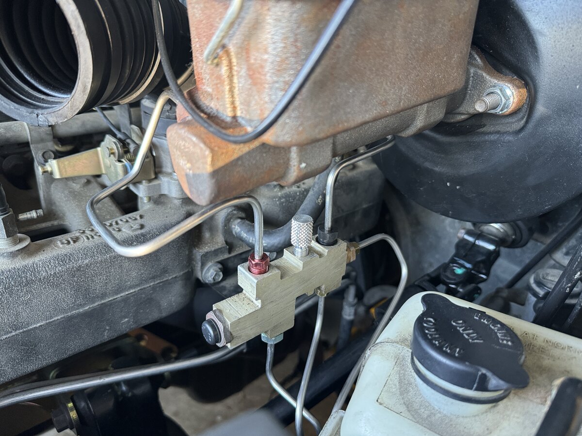

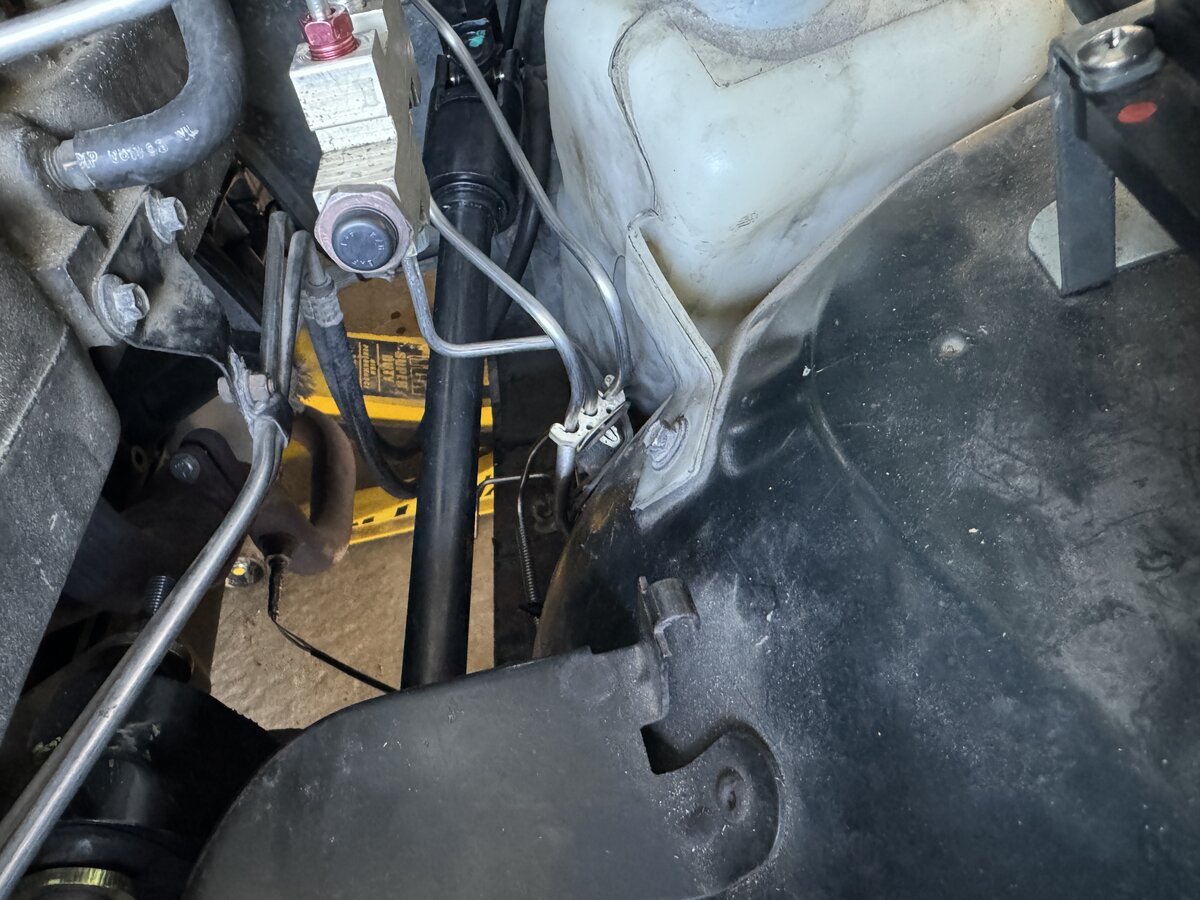

I bought a full vehicle brake line kit a few months ago from Inline Tube. I actually did all new stainless brake lines from Classic Tube in 2015, and the fit on that kit was not great. Almost all of it was too long which made cramming hard lines into place quite difficult.
I decided I wanted to refresh that stuff again and I had read a bunch of great reviews about Inline Tube, so I decided to try them over Classic.
The fitment was significantly better than what I used before. Pretty much every line fit perfectly with no extra work. Of course, there will always be some dangling as you try to snake a preformed line into its home between other lines. It’s not exactly easy, but wasn’t too bad.
One thing really nice about the kit was the long lines (passenger front, and the rear that runs down the frame) are broken into two pieces and they provide couplers to join the halves together. This makes getting a long line into place much easier because you only have half the length to deal with.
I also added to my order the 3/16” fuel vapor line. When I was removing the lines in 2015 to install the Classic kit, I cut the rear line for easier removal. Unfortunately, I accidentally cut the vapor line instead. I patched it back together with hose and clamps but it looked tacky and I got fuel smells at times. Always bothered me. I installed that now and all is well. Glad to have that fixed and it also fit like a champ.
I’ll add a photo of the rear axle lines once I have the axle project done and installed. Same for the rear hose.
Hoses​

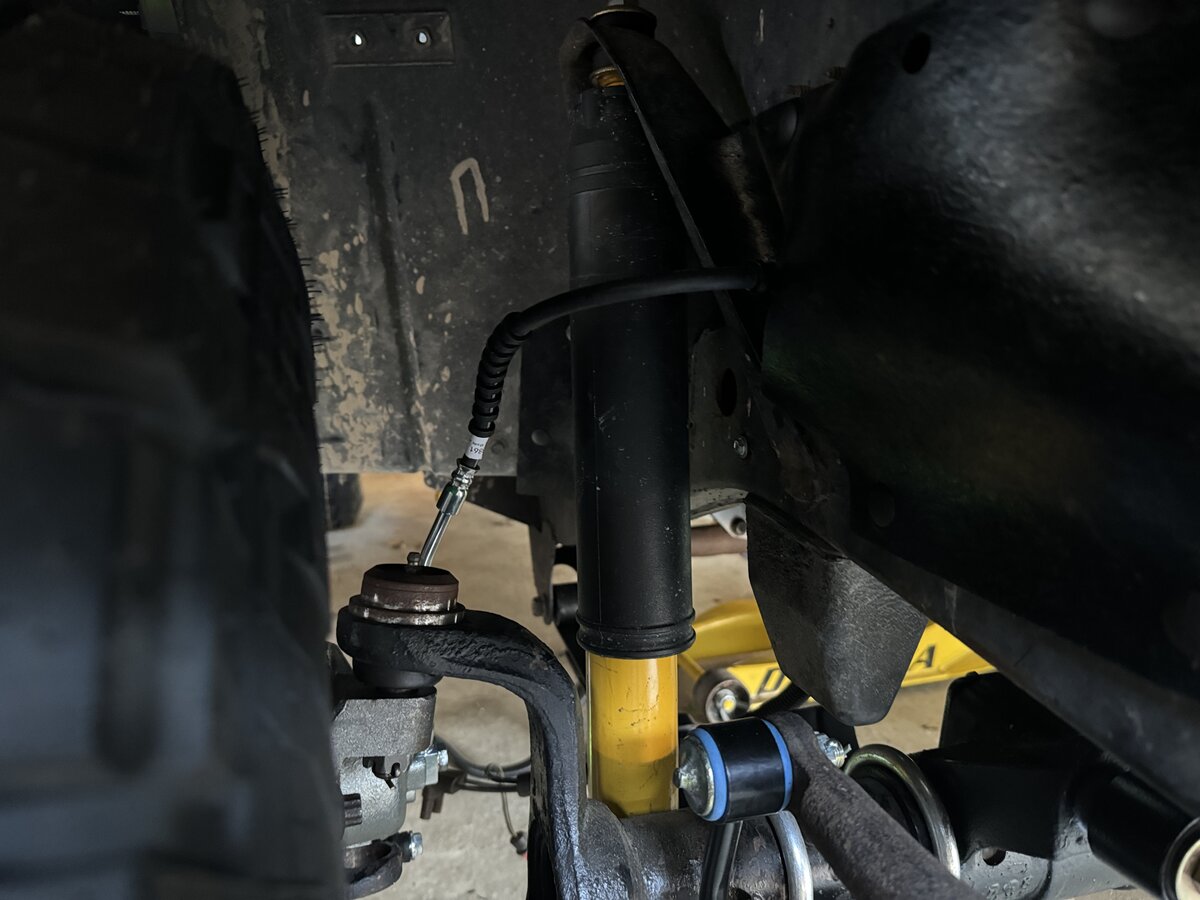

I also ordered some new rubber hoses for the calipers and the rear frame to axle. I used Raybestos brand. They were a perfect fit and look great. They uphold the stock design perfectly. I’ve used aftermarket lines in the past and I am just not a fan. They’re always universal fit so they never have the perfect bends and metal sections to form them to the path they need to take.

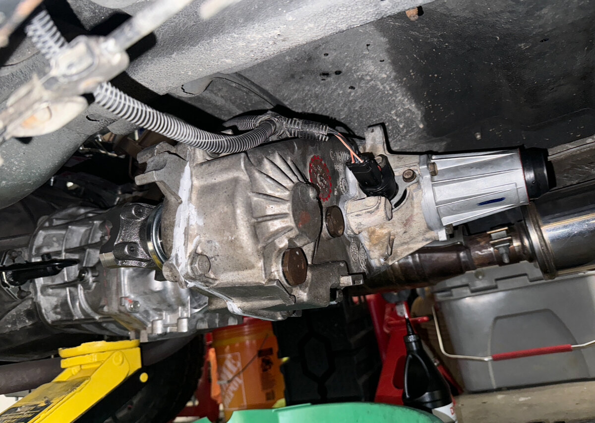

I still have my original 1994 transfer case that came in my YJ. The past few days have been spent getting it to where I need it to be now. It has been through a few projects over the years. When I first lifted the YJ with the Rough Country 2.5" suspension in January 2014, I initially installed a t-case drop. I was not really happy with the results of that and the still present vibes, so a few months later I caved and bought an SYE (Rugged Ridge brand) and had a custom double cardan shaft locally built. I was not too pleased with the Rugged Ridge SYE. The output shaft seal leaked right out of the box. The tail housing did not do a good job of supporting the oil pump like the JB Conversions and stock tail housings do. Next time I opened it up, the oil pump tabs were actually broke, so I needed a new pump. Overall it was just a cheap kit and the quality showed - sadly I didn't save all that much $ vs a standard JB conversions at the time either, so I should have just gone JB in the first place. Oh well, live and learn.
That was back in 2014, then in 2021 I bought a JB Conversions standard SYE and a JB rebuild kit. I also ordered a 6 pinion planetery, a wide chain kit, and a true neutral shift plate. I rebuilt the t-case with all the new parts and installed it. Funny enough, I still have not driven since then. Now that plans have changed and I went back to stock, it was the best course of action for me to return the t-case back to stock as well....so I did.
I picked up a 1989 transfer case off FB marketplace for parts. It came out of a 4 cylinder so it had the wrong input gear. I tore down the '89 t-case and set aside all the parts for future use. Mainly I needed the mainshaft with sprockets, the front driveshaft sprocket, the synchro, and the tail housing pieces.
I tore down my own t-case that had all the parts in it from a few years ago. I ordered another JB rebuild kit (mostly for the seals, I kept most of the (old but still unused) JB bearings intact and reused them. I removed all the SYE parts and the wide chain kit. I'm eventually going to build up the spare transfer case with these parts and sell it. Since I had the 6 pinion planetary and it requires no extra work to install, I reused it. I ordered a new Borg Warner chain, an aluminum range fork, a new tailhousing extension, and a new front yoke. I also picked up a new Mopar vacuum switch since I am reinstating the CAD system.

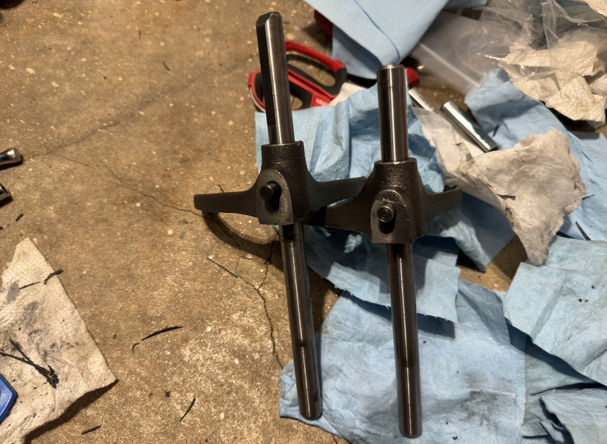

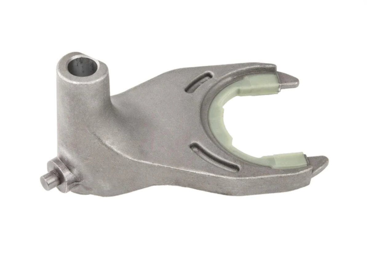

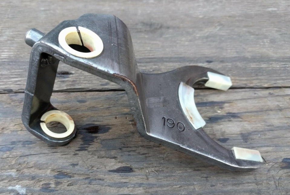

I spent the last two days doing cleanup of gasket and reassembly. One snag I ran into was the mode fork length. For whatever reason, early (88-89) YJ NP231s had a longer rod attached to the mode fork (the fork that shifts from 2HI to 4HI). This rod extends through the rear half of the case. In stock form, its length is no problem, obviously. With SYE kits, the rod needs to be shortened because the SYE kits are made to be compatible with the later shorter rod only. Since I am going to rebuild an SYE case and sell it, I decided to use my shorter 1994 mode fork rod in the spare case, and used the old rod in my case. Otherwise, I would have needed to cut the longer rod short to use it in the SYE case I intend on selling. They both perform the same, they're just different so no downside to using the older one. I'll post a photo to show what I'm talking about. Left is the one I'm using in the stock rebuild case, right is the one from my 94 going into the SYE case I'll sell.
I also did not reuse the range fork (HI-N-L shift) from the '89 transfer case. Early models came with a really crappy steel shift fork that over time can bend and stop shifting properly. My 94 fork was fine, but there is a newer version called 17833, which I bought from AllState gear. I used that one. Photos attached.
Finished the job last night and reinstalled. Not too bad, I just hate dealing with RTV and scraping old gasket. Time consuming, and makes a mess. I used liquid thread sealer on a bunch of the bolts - any bolt hole that reaches into the internal case, which is basically every single bolt except for the case half bolts. But all the tail housing, tail extension, and front input bearing cover bolts all reach into the oiled area, so they got sealer.

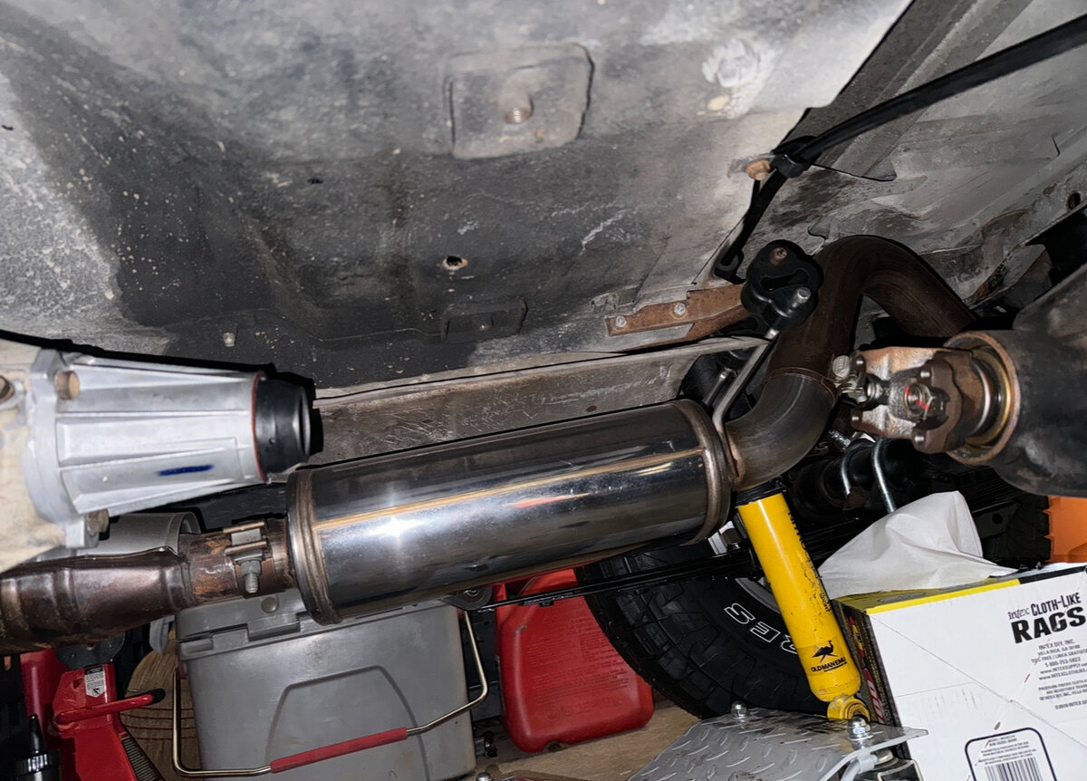

One thing is for certain - my driveline angles will be good! The pinion angle is high here, but that's because of my welded perches on the custom D44. The D35 will be at the perfect angle, just like stock, once it's back in. Just waiting on Revolution to ship me my 4.56 gears and then I can finally wrap that project up.
I have an all new slip yoke from Spicer, and I bought a stock 94-95 6 cyl manual driveshaft off eBay. That driveshaft has the 1330 rear axle u-joint as all 94-95s did, so I ordered a new 1310 and 1330 u-joint to rebuild the shaft. I'm going to hold off on that until the rear axle is in. I’ll build it up now, but not install until rear axle is installed. At that point, I'll install the rebuilt driveshaft w/ slip yoke into the Jeep and hook it up to the rear axle. I don't want to install it and then not have a yoke to bolt it to since my existing axle I’m going to remove is 1310.
I'm going to work on installing the vacuum harness, skid plate, and transfer case shifter today after work. Then once the driveline is back up in its normal height, I'll drain and fill both t-case and transmission. I'm going to run Driven Oil 80W-90 GL4 in both, as ATF is known to mist out of the t-case over time and the fill runs low. Gear oil will likely provide a bit of extra protection from wear anyways, and probably lower the noise too. We'll see.
Making progress!

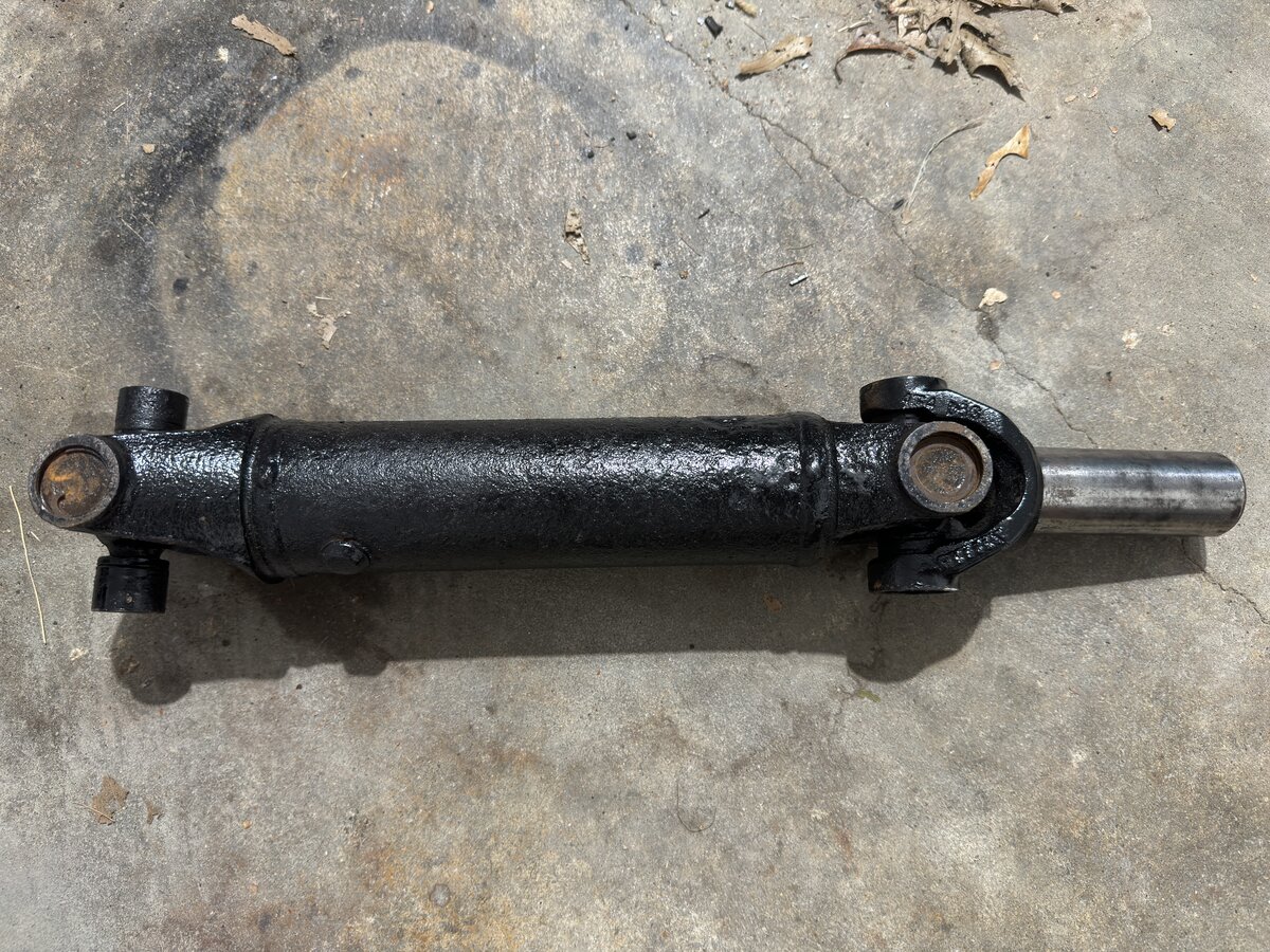

Now I need to figure out what I'm doing with my rear driveshaft. I still have the stock front driveshaft which I rebuilt and installed new u-joints in. No issues there, it has no slop and it won't be spinning often anyways due to the CAD. For the rear driveshaft, I bought one off of eBay, but I'm not happy with the quality. The tube is pitted/rough and clearly rusted away in spots, with a black paint job over it to cover it up.
Since my YJ is a 1994, it has the 1330 rear axle u-joint as all '94-'95 models did. I wanted to maintain the year specific change as part of my going to stock plan, so I bought a 1330 yoke from Denny's Driveshaft. Doing so means buying a driveshaft used limits me to those 2 years of production on eBay or similar...or I can buy from another year and use a conversion u-joint (1310 to 1330), which I don't want to do.
I was considering Tom Wood's for a stock shaft, but I think I'm going to go with Denny's. Denny's spins them crazy fast (machine goes up to 10,000 rpm) on the balancing which ensures they will have no vibrations at any point. Denny's takes into account your engine's redline, your axle gears, your tire size, your maximum governed speed, and determines where the max speed is the driveshaft could end up at, and they balance it to above that. I think TW puts out a good product but they like to see lower driveline speeds than I will be running and I don't want to put myself or TW in an awkward situation in case vibes do occur where I blame the shaft and they blame my driveline speeds. My driveline speeds will be 3200 at 60 due to 4.56 & 30s which is not negligible.
So I'm leaning towards Denny's. They'll build it with all Spicer parts, they'll do the 1310 and 1330 ends, they'll use whatever tubing I want (probably keep it 2.5" x 0.083" like stock), and they'll paint it a nice black to protect against corrosion. Seems like the best option overall and out of the 20 years of people posting on the internet about their driveshafts in various forums, I've only seen good results.
I did end up reaching out to Denny’s today. $425 plus shipping which includes a 3” X 0.083” tube as opposed to stock 2.5” X 0.083”. I think I’m going to go through with that. A local build with me supplying parts will cost nearly that, and the local dude only balances to 1200-1500 rpm. He maintains the “once it’s balanced, nothing changes above that so it’s still balanced” theory, which I guess is true except at higher speeds sometimes things could flex and no longer be balanced as well. Seems more proper to balance it beyond the speeds you know it will live at to truly guarantee problem free operation.
They are suggesting I do a 1330 at both ends instead of 1310 at transfer case/slip yoke and 1330 at rear axle. I already have the rear axle yoke so I’m definitely doing 1330 there. I’m probably going to let them do 1330 at both ends like they want to, but part of me wants to keep it originally sized. The only reason to keep it purist and stock would be so you can walk into a parts store and say “get me the u-joint for a 94 at the transfer case,” or similar. Obviously I know what will be used so really in my case I’d just walk in and say get me a 1330. But part of me wants to keep it stock anyways so that there is no chance of confusion. It’s not going to matter strength wise as either is fully capable. I don’t know why Jeep decided to step up the rear axle joint only for only 94-95. Then in the TJ went right back to 1310. Makes no sense and muddies the water.
