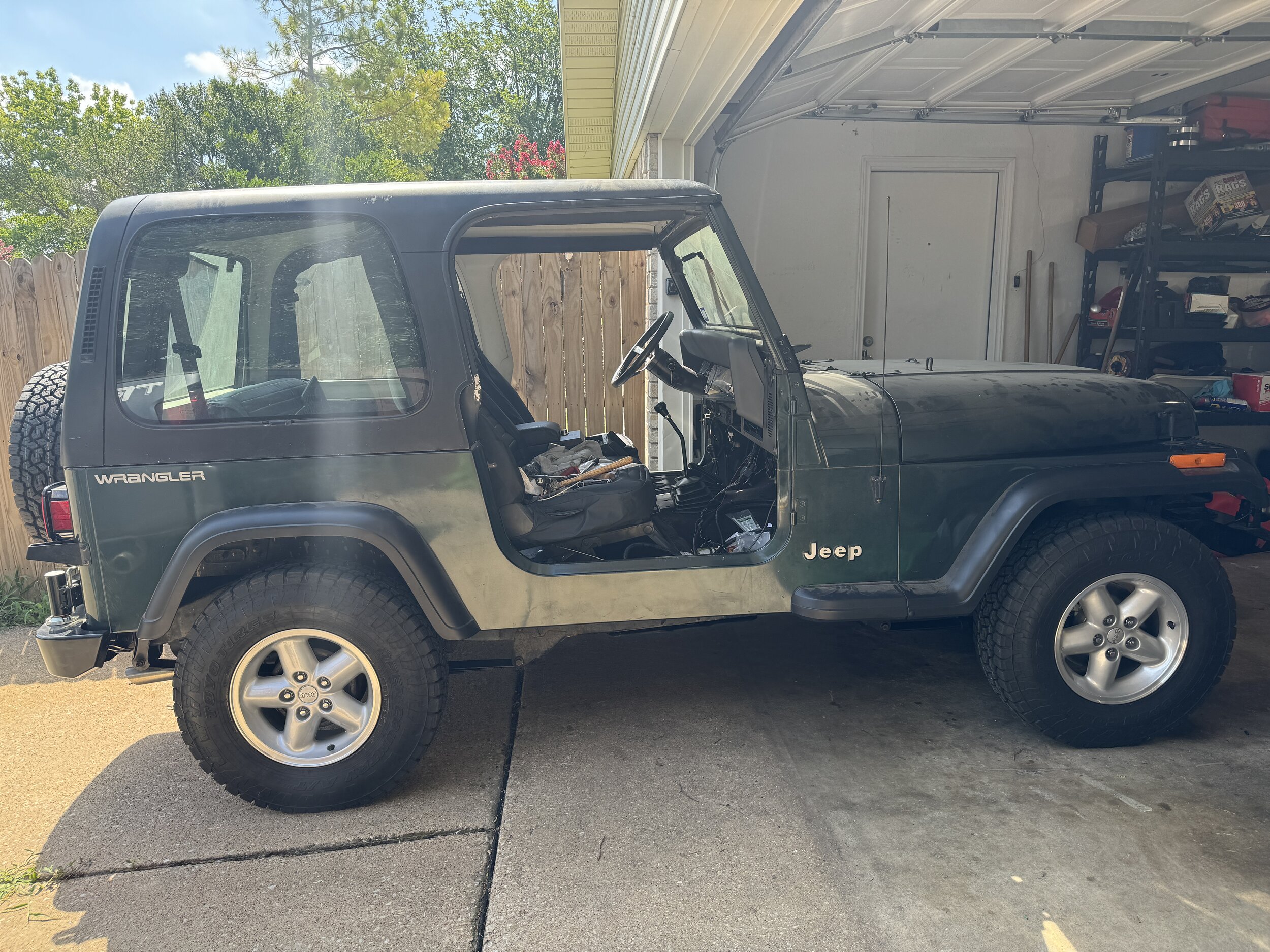

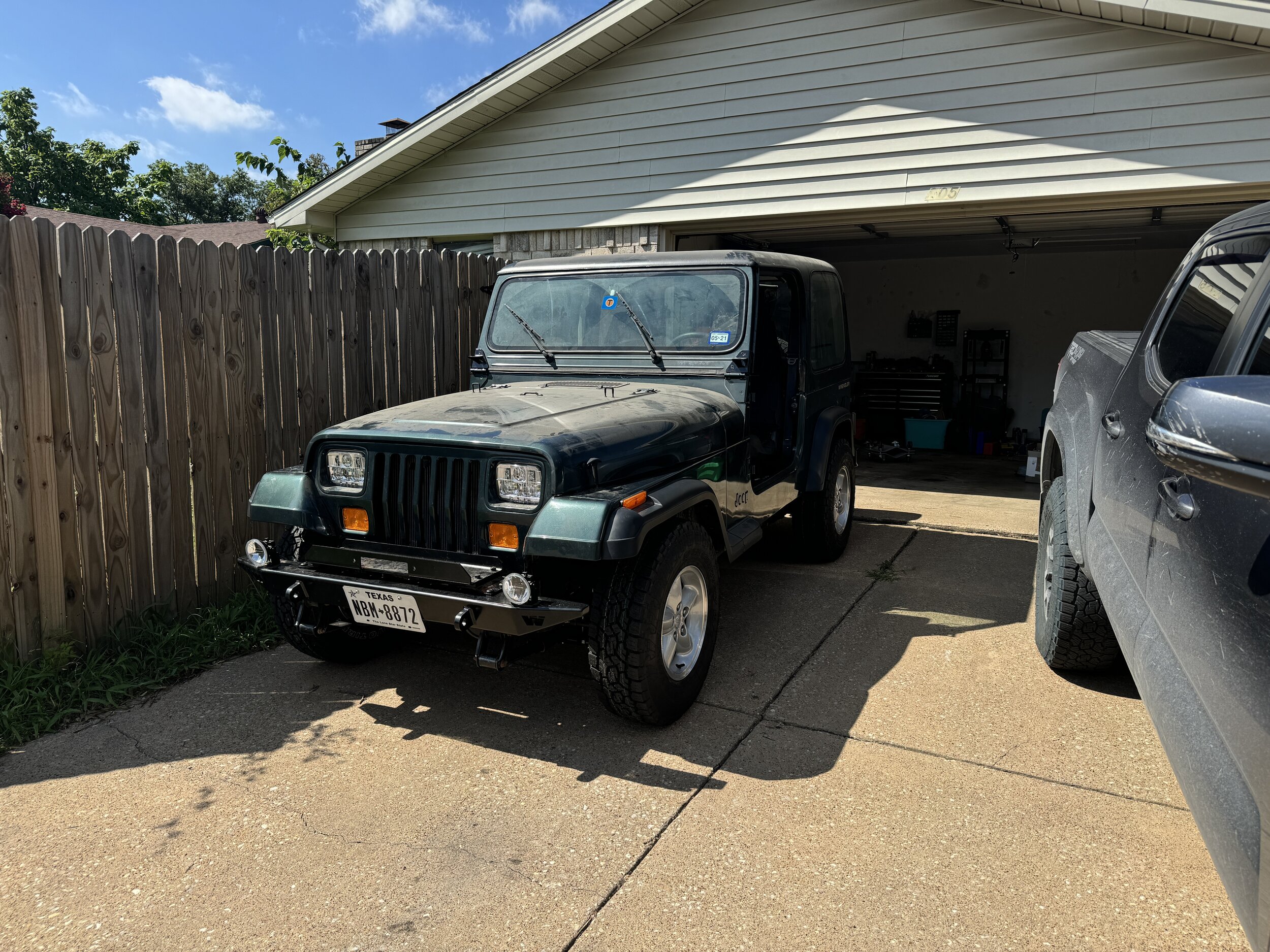

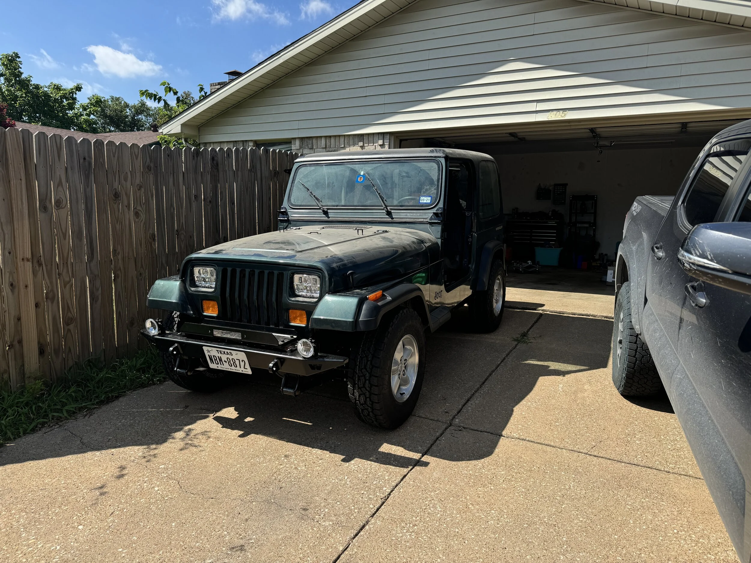

Well, I cleaned up everything from around the Jeep in the garage, buttoned up the windshield and fastened the hardtop, and took it for a very brief ride. It isn’t street legal so I can’t do much.
Very strange to be behind the wheel of this thing again. It definitely still has some quirks despite being stock again. The steering doesn’t return to center very well, and it’s a bit squirrelly feeling, but I need to give it more time to see what I really think. I’m so used to driving a nice Tacoma that I’ve kinda forgotten how YJs are. It is better than the last time I drove it, after all this work, that’s for sure.
The gearing is freakin amazing. 4.56 and 30’s is aggressive and just really wants to go. 1st and R will creep with barely any gas. Just awesome. Didn’t hear any weird axle noises but I also only went like 25 mph max and only for about 5 seconds. I heard some weird clanks and stuff but the jeep is filled with crap. I didn’t clean it out for the drive, since I wanted to go. So probably some stuff in the backseat moving around.
The brakes are awful. They either have a bad MC or lots of air in the system. The MC is new but old from the shelf so maybe something to look into there. I’ll get it fixed up eventually.
The new exhaust parts are smoky so have to ignore that as well. It adds to the experience of feeling like something is wrong.
Next steps are to clean out the interior and finally button the dash up so that I can minimize noise of things flying around and focus on the actual issues that remain.
It didn’t overheat at all, and I got it up to 210. It barely starts to creep past 210 and then the fan brings it back down. I need to do lots of cooling system flushing, another item on the list.
I just remembered my steering shaft bearing is a bit loose and taken apart currently so that probably added to the wonky feel. Need to address that.

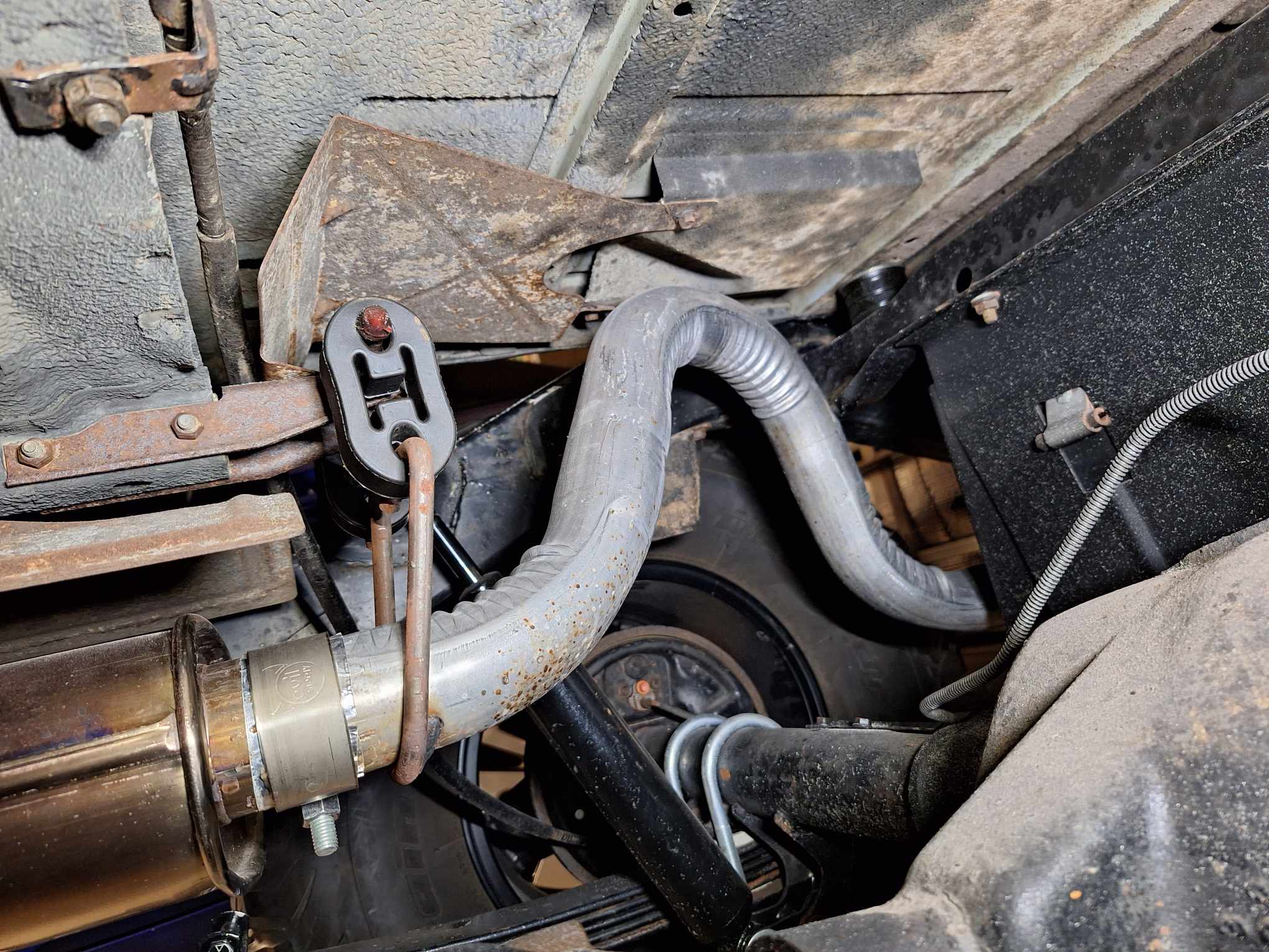

Exhaust​
Sadly I knew this one would be a problem. The new tail pipe is rattling against the tub. Not really sure what to do about that. The aftermarket pipes are pretty “tall” where they go over the axle and I tried every which way with pretty much no way to get it oriented to where it won’t hit the tub. I verified I did have a very small amount of clearance. That didn’t work, now I’m rattling. I might reinstate the Magnaflow, it had a much better tail pipe design. I honestly don’t even think the Walker is that much quieter, they both are pretty noisy seeming.
That is interesting. I am running a walker tail pipe and the same Walker muffler you have and I have no issue at all with clearance or vibration. It doesn't touch anywhere. I have a Banks header/JBA mid pipe/Walker straight section (where the cat would be)/Walker SS muffler/Walker tail pipe. I just used some Amazon exhaust band clamps and so far, it's done pretty well. I did buy new hangers but my OEM hangers were probably just fine and looked to be in decent shape. Without a cat and that Walker "quiet flow" stainless steel muffler (and of course the Banks and JBA have some effect), my 4.0 has a pretty solid rumble to it.
I’ll snap some photos when I get a chance. Your body lift may be helping. I am using a stock style Dorman exhaust manifold, and stock transmission hanger. Stock length cat and then the same Walker muffler. Everything bolts up but the tail pipe at its peak is extremely close to the tub and while it had maybe 1/8” of clearance, it doesn’t now and is rattling.
I had this problem with the Dynomax catback kit years ago too, and I had the stock (cracked) manifold at that time.
If I had a body lift I think it would clear fine, but would stretch the hangers at the muffler since that mount is on the body and would move up accordingly.
The magnaflow catback fit fine, the peak was much lower and nowhere close to the tub. I tried a Borla kit briefly and that one didn’t hit the tub, but it hit the gas tank crossmember…still not sure how or why. I returned that one.
Ahh yeah, good point. Could be that 1" difference for clearance. The hangers for the muffler were very easy to get on and don't seem stretched or anything. It all went together very well, just had to clearance the JBA with a hammer so it wouldn't touch where the bellhousing meets the engine lol.
Reactions: machoheadgames

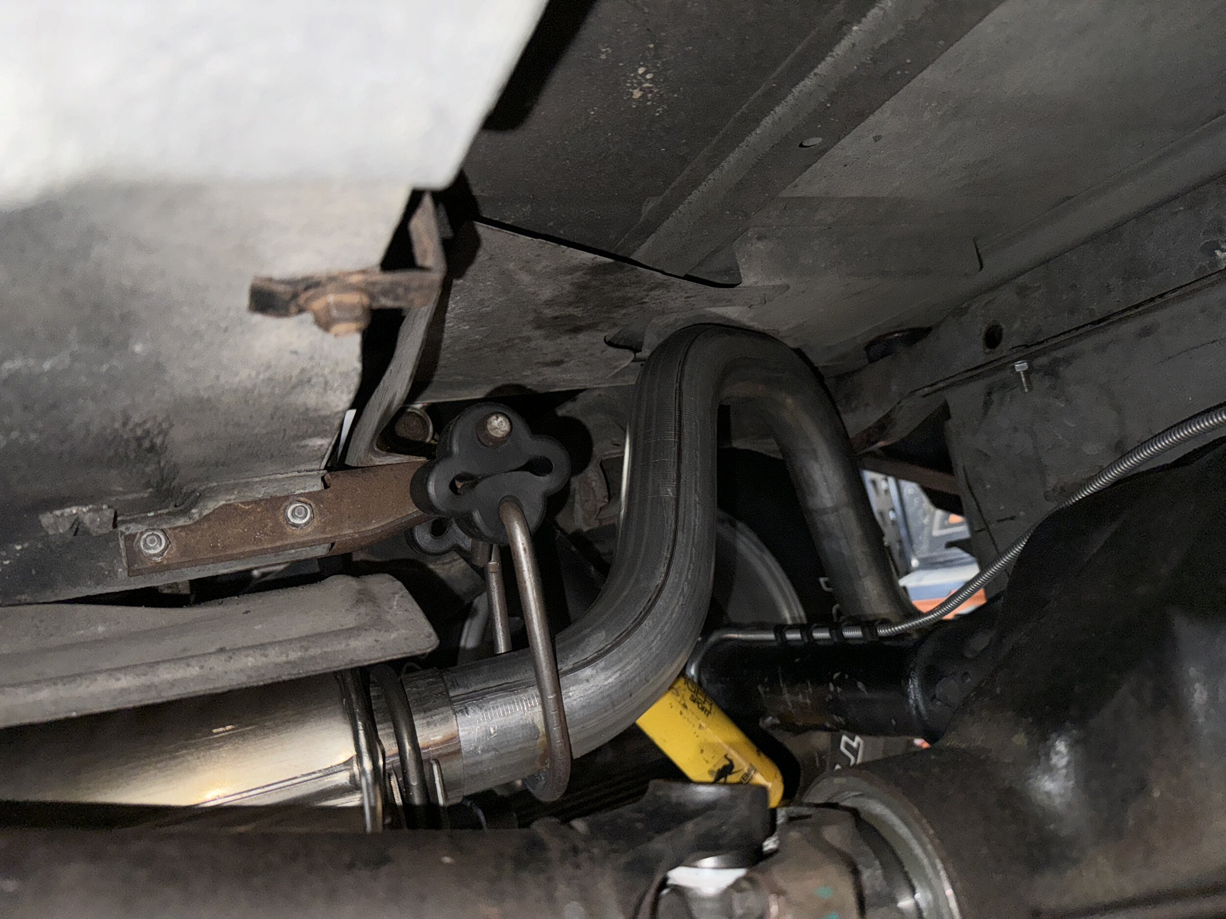

I grabbed a photo of mine tonight before I started taking it all apart. My hangers are honestly pretty smushed. Not sure why, but regardless there is no good way to get that muffler and pipe in there without touching the tub on mine.
And now of course I’m having a hell of a time getting it apart because the clamps for the Walker stuff are the type that crimp the pipe. I was trying to get it apart and still be salvageable, but I really can’t. I think I’m going to cut it out with a sawzall and install the magnaflow. So much for a $400 experiment…..
The walker tail pipe was pretty awful looking anyways. It hung really low and looked really cheap. It honestly wasn’t that much quieter than the magnaflow either so the MF is probably best. The only truly “quiet” exhaust I have had was stock. Too bad you can’t get those anymore, and too bad my original started rattling internally. That was the only reason I ever replaced it to begin with, otherwise I would have stayed stock there.
Wow, those hangers really are smushed. The Walker tail pipe end is certainly nothing fancy, I have considered cutting a more angled tip to it. With no cat and this Walker muffler, my Jeep definitely has a rumble, more than I had expected but not enough to bother me. I'd be curious how the Magnaflow sounds with no cat. I have liked them on previous cars I have owned.
I like the band clamps so far, they don't distort the pipe so it can be taken apart rather easily but they hold tight. The one in this pic is very short due to the short area available to clamp. The other two are better being longer. Overall I am happy with them and have been a inexpensive solution as I didn't want to weld anything that I might want to take apart at a later time.
I can definitely see how my 1" body lift makes a difference but it's still odd how your hangers are smushed as if the exhaust is being pushed upward toward the body.
Yeah, it’s very bizarre….at one point I wondered if my Crown skid plate was a bit flatter than stock, holding the drivetrain higher…but it’s not. The shifter, and engine are at the same angle as stock. Back when I had the stock skid still, I still had this trouble with the dynomax catback.
My pipe is actually dunomax, not walker, so it’s a bit differently shaped. I thought the dynomax looked better so I went with it. Axtuallt, dynomax is the only one I’ve ever had problems with. Stock rattled inside itself, not against the tub. The flow master and walker pipe that replaced stock rattled together, not against the tub. And that was only because the clamp wasn’t strong enough to crimp the flowmaster muffler to the pipe. Dynomax came next until it fell apart. Then magnaflow replaced that. It fit fine at the pipe to tub, but the hanger at the end is a bit fat and placed a bit too far back so it wants to hit the hanger bracket. But I got it to work when I had it installed. Borla like I said hit the gas tank crossmember.
I think the dynomax problem might actually be the hangers on the dynomax pipe being too long maybe. If you think about it, the height is pretty much already set by where the muffler is. If the tail pipe hangers are too long, they’re going to push the hangers up. That is probably what my problem is. Even though walker and dynomax are the same brand, they might not be perfectly the same dimensions.
I used Walker full replacement from the header back and used a........."catalytic converter"...........the over the axle section on mine rubbed the tub from the get-go. I was able to put my largest breaker bar in there and bend the part of the tub it was rubbing on (a cross member piece under the cargo area), and put a small dent in the hump, which fixed my clearance issue. Over this last weekend, it actually broke the farthest rear hanger off the tailpipe which fixed the clearance issue entirely even if I wouldn't have modded it a bit lol. I'll be swinging by Orileys and grabbing a new hangar and welding it back on where it needs to be.

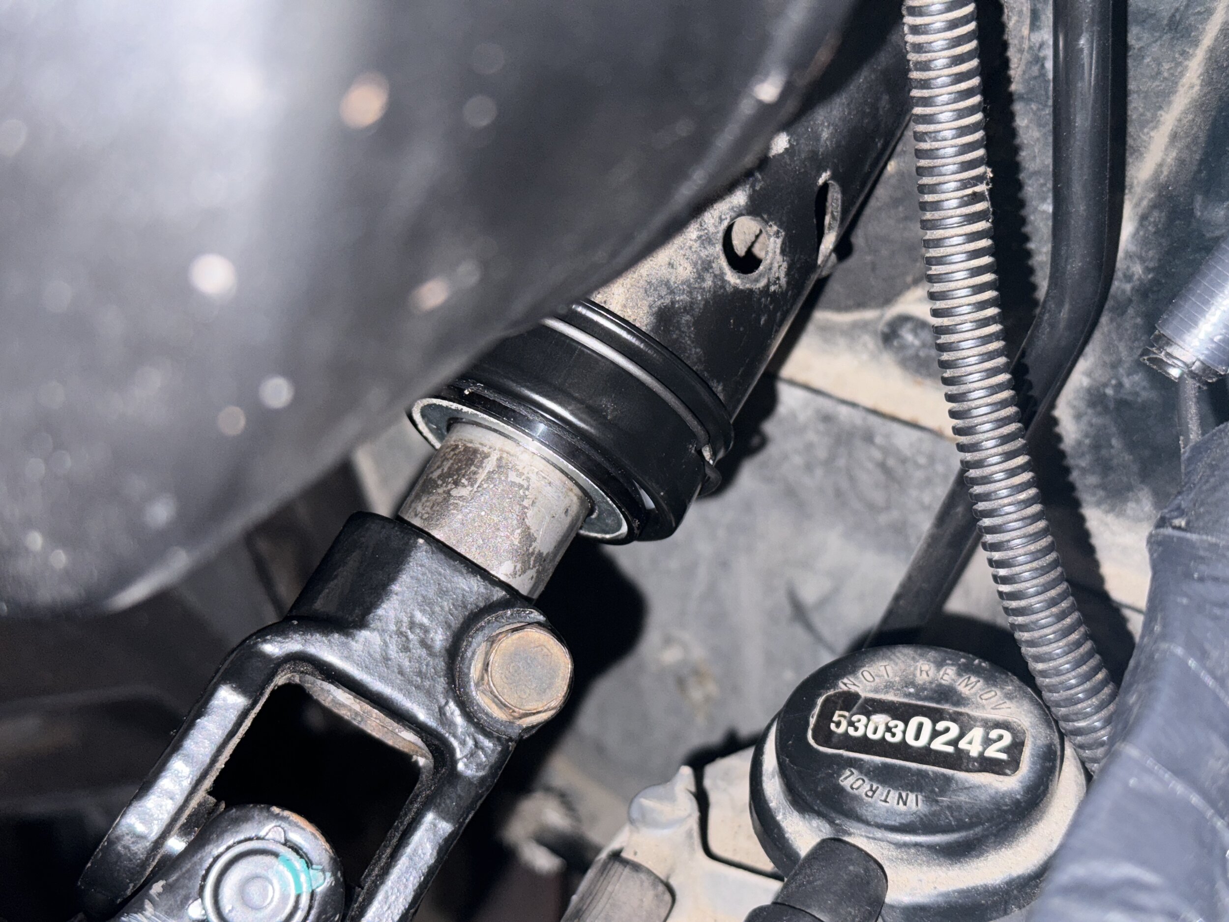

In the meantime, I changed out the lower steering column bearing. 5 years ago I used the “upgrade” bearing from Wolff engineering, which seemed nice but it didn’t fit my column without some slack. Maybe I installed the outer collar wrong, but it was plastic and so I don’t think so. Anywho, don’t want to speak too negatively, but I found a place that sells GM genuine replacement bearings (the column is a GM Saginaw column after all), so I ordered up a kit from Steering Column Services. It said 1969-1991 but it fit just fine on the 94 column.
That is now installed and looks good. Went on pretty easily, took me a few minutes to get the outer collar lined up - the brake booster makes it hard to see what you’re doing. Anywho, it’s in and done.

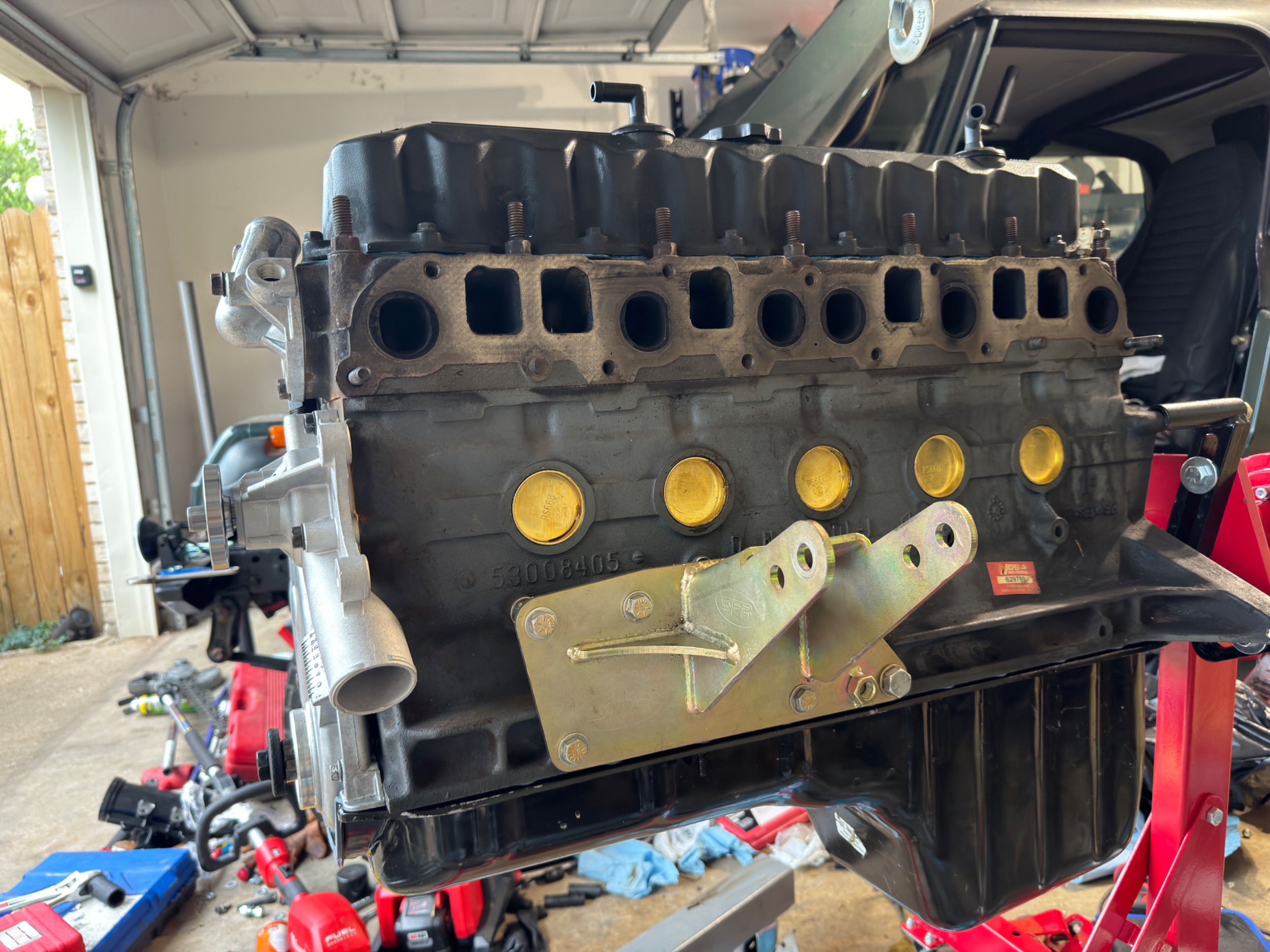

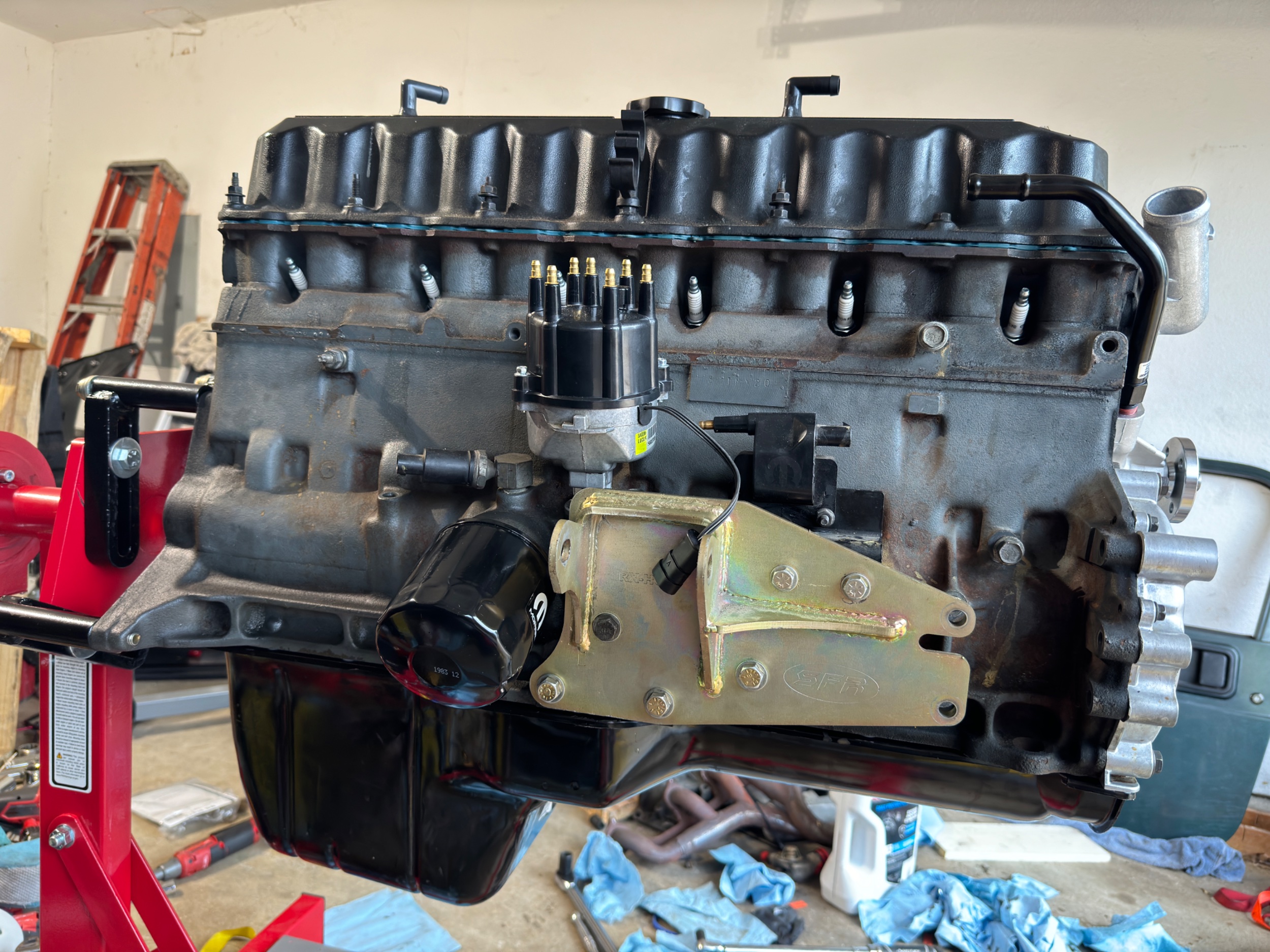

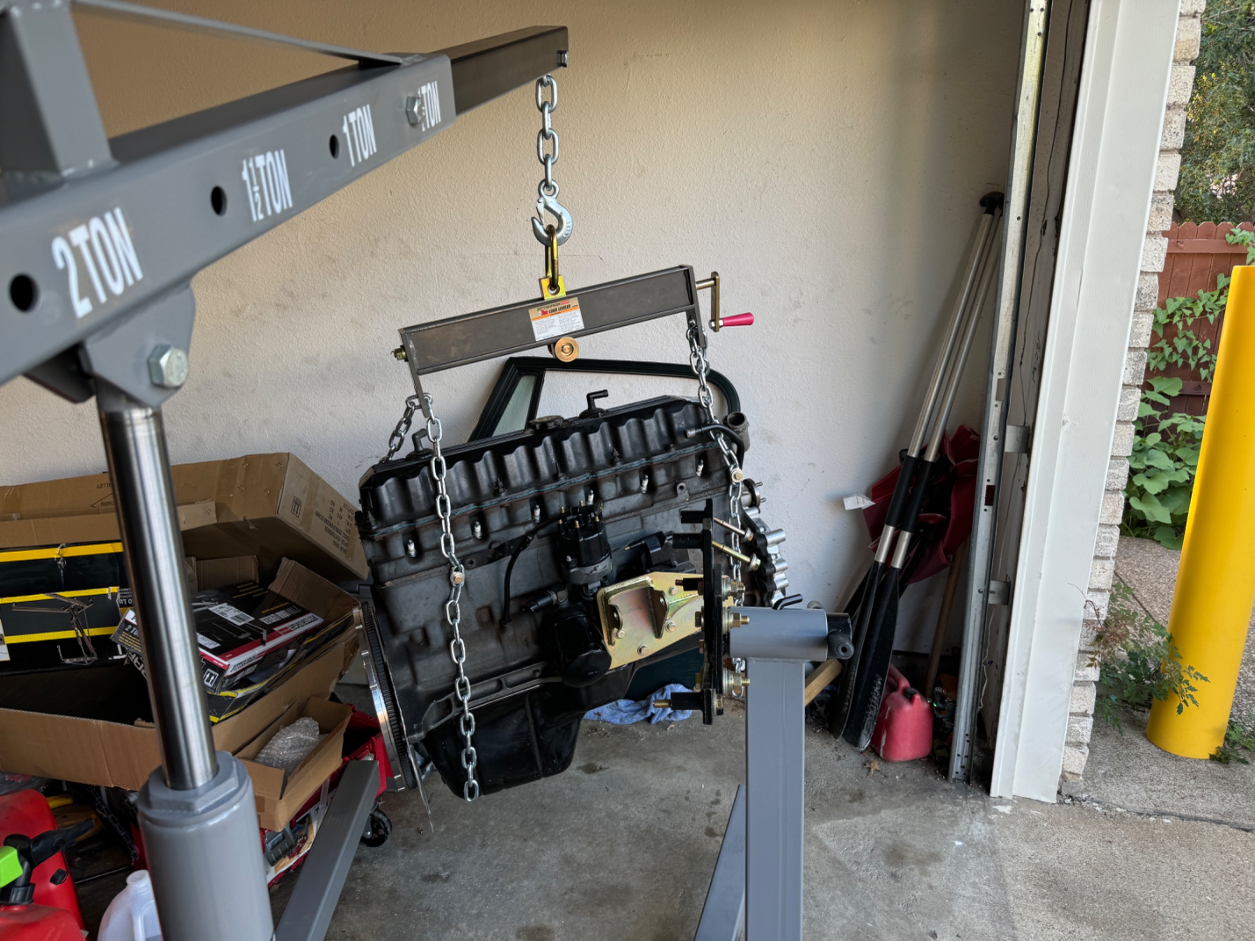

Like I’ve said before, I have this Jasper engine that I’m not exactly thrilled with, however it has run decently for the years it’s been in place. After the noise, I couldn’t get it to go away and so I bought a used engine that I intended to swap in. The seller seemed very honest, straightforward, etc. I hate to say he wasn’t honest, he truly maybe didn’t know, but the used engine that was supposed to have no surprises, was quite nasty down behind all the accessories, the block was pretty gross, and you could tell there had been some engine mount troubles because one of the bolts was broken in the block and others had grinding marks in the bolt bosses showing someone had worked in there before. Thankfully, with the beefy SFR engine brackets I have, there is no reason to be concerned there regardless.

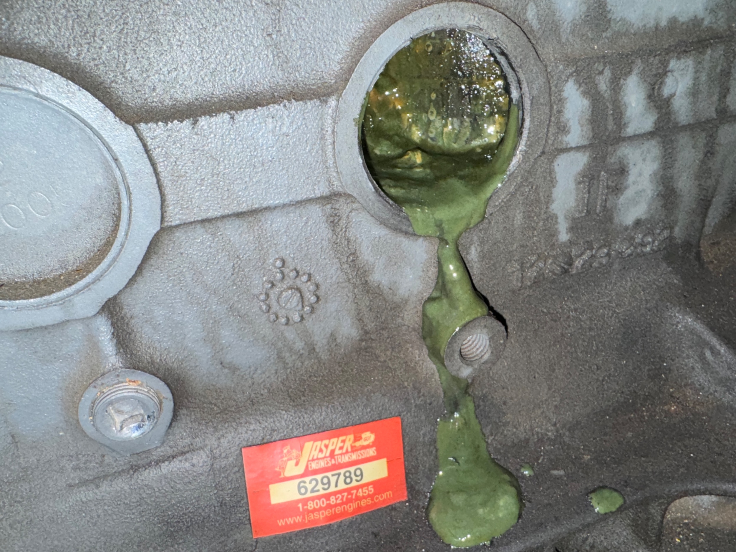

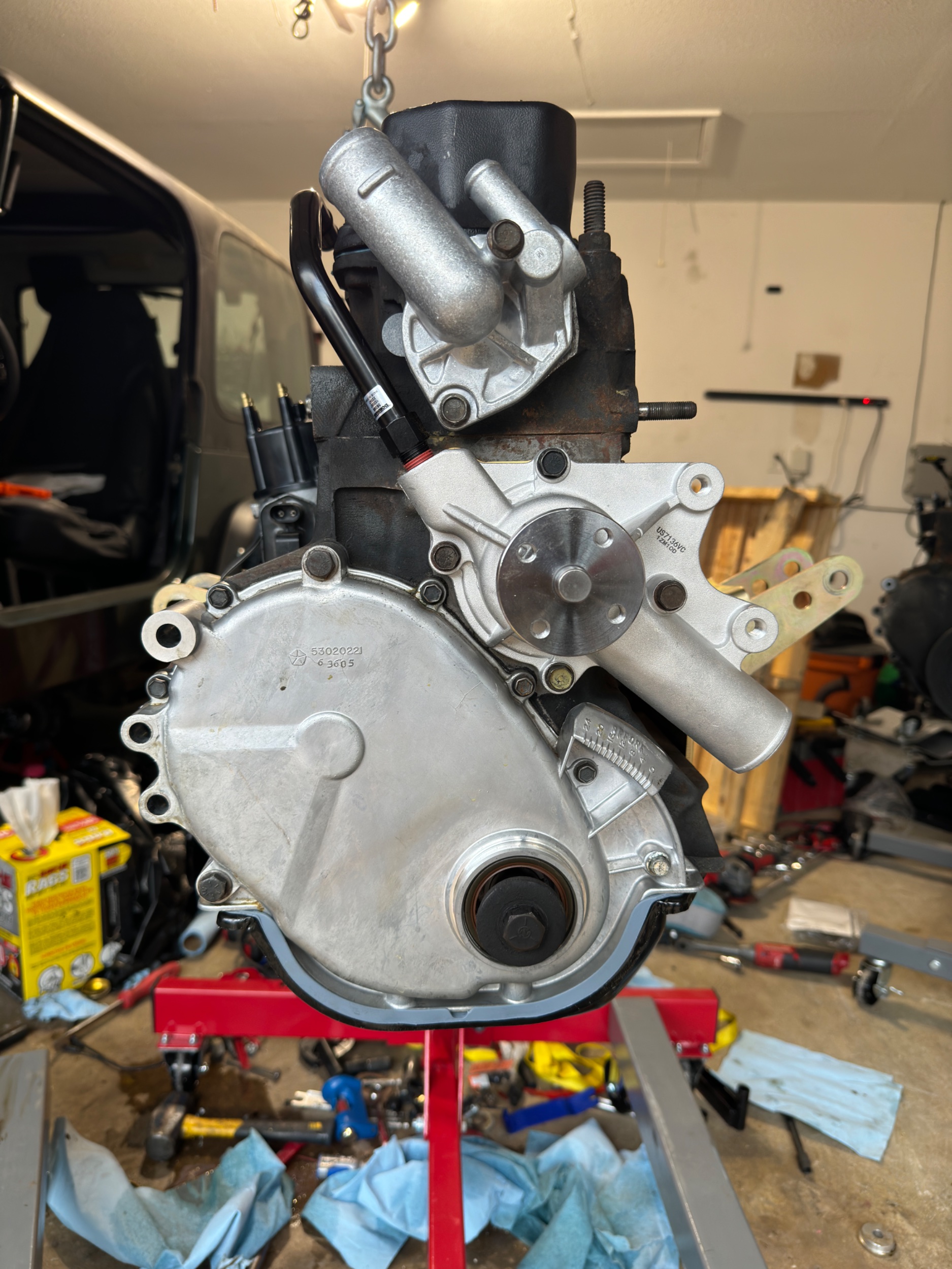

After finding out the valves leaked and that this engine overall was pretty gross, I decided to not use it. The Jasper was already pulled at this point, and I got to see what is probably the cause for the noise: coolant sludge.
Not sure why this happened. The only coolant I’ve ever put in there was conventional green, or Zerex G05 HOAT. Both are compatible, just the green doesn’t last as long. My guess is the years of sitting and about a year of the cooling system being open allowed things to dry up and create a nasty goo. I think this was the cause of the noise: poor cooling due to the sludge and probably some lifters getting hotter than the should.
I ended up taking the engine to the driveway and just blasting the crap out of it with a hose for about an hour. I got it clean enough for my satisfaction. Engine went back in, but first, new water pump and thermostat housing. Timing cover is a new Mopar from a few years ago.
Not really much to talk about beyond that, but my summer has been very busy since then and I am still not done wrapping up the engine stuff. In the process I did change the RMS again. I also got a rear oil pan support out of the new engine, so that’s nice.
For now, I am going to keep that engine and plan on rebuilding it. The physical problems with the block are not actual problems. Engine plates will take care of that. I want to do a clean stock engine build with minimal overboring and as stock as I can make it, for reliability and smooth performance. The main thing is I don’t have the time or money to spare in a project like that, not so I know where I’d want to get the work done. So for now, the Jasper goes back in and hope that the ticking is gone.
