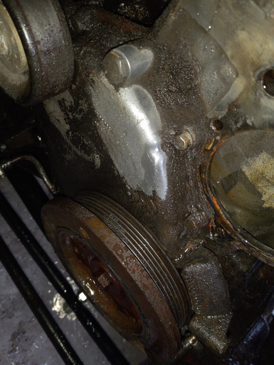

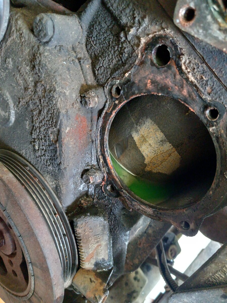

Barely any gasket left on it.

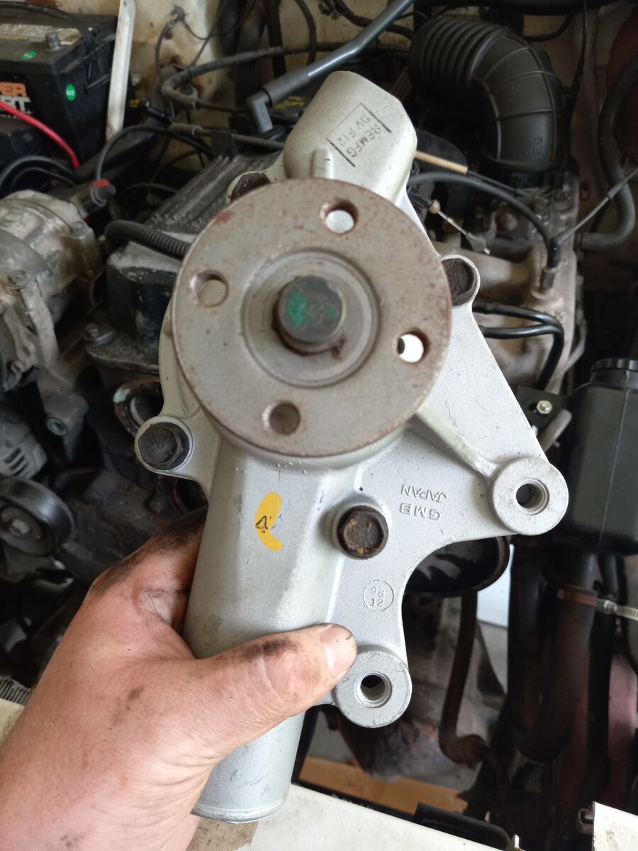

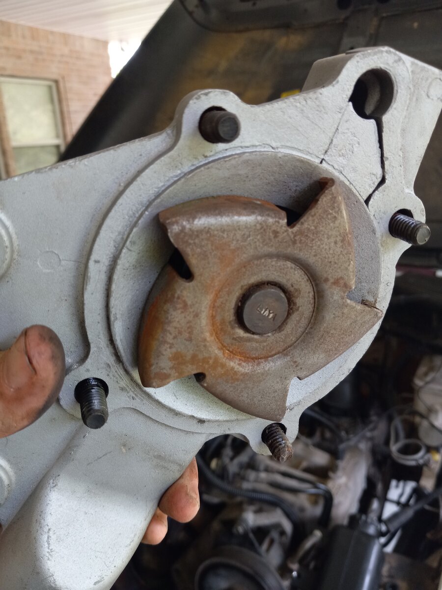

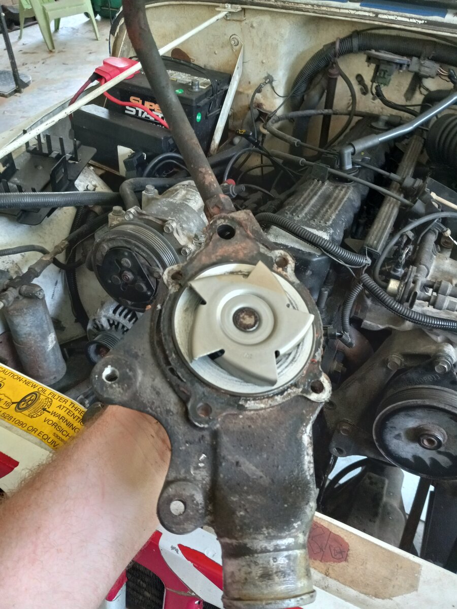

This is an Oreily water pump my boss gave that he never used for his TJ. Has been sitting on a shelf, but the impeller has rust on it. I was going to use this and save my Mopar water pump for when if I ever rebuild my motor.
I think I should probably go ahead and use the Mopar onr, unless that surface rust is not a big deal.
I always get the block surface clean and then install the thermostat or water pump with a dry gasket. Always worked for me. The block is cast iron so scrape at as much as you need to to get the old crap off.
Oreilly looks fine. maybe sand the rust off real quick but I'd run it especially since it could be temporary use for you. If the bearing spins freely I'm sure it's probably fine.

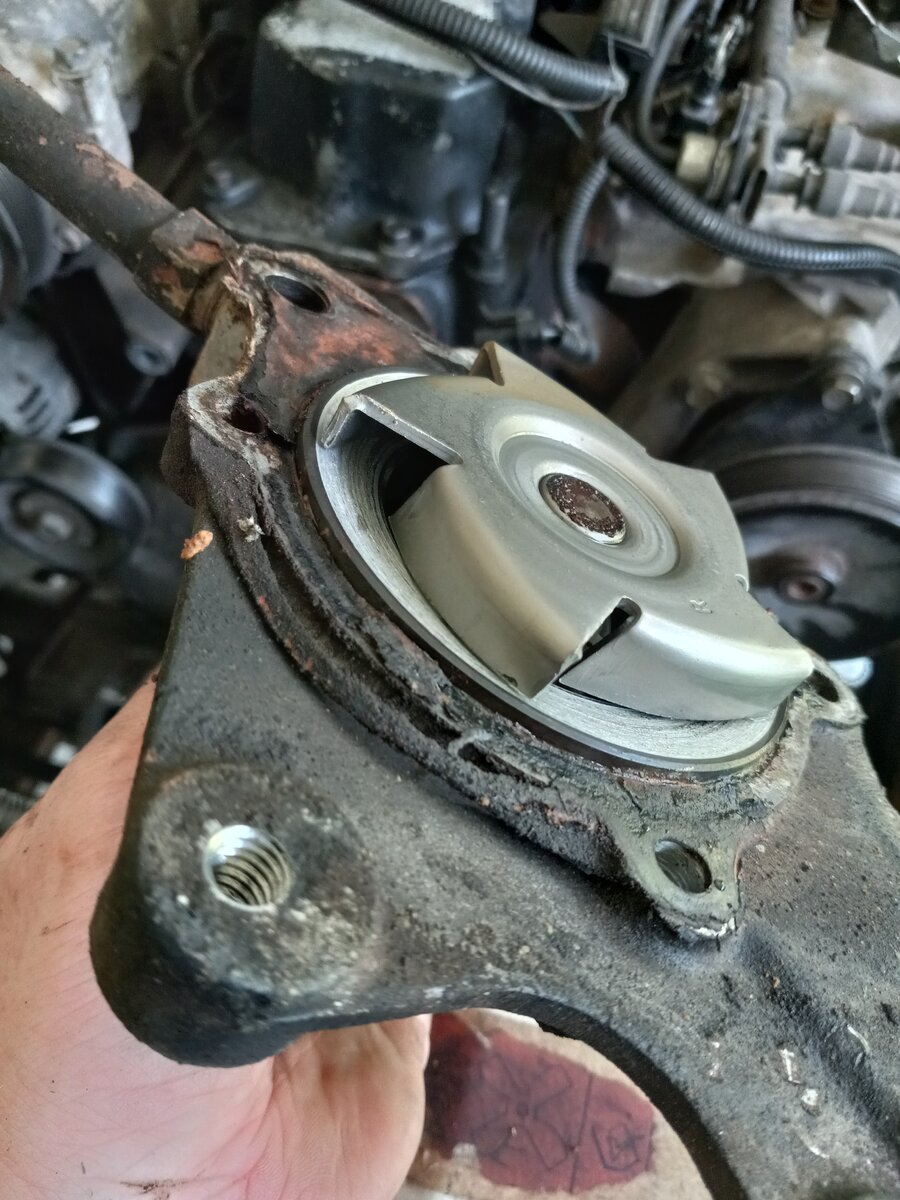

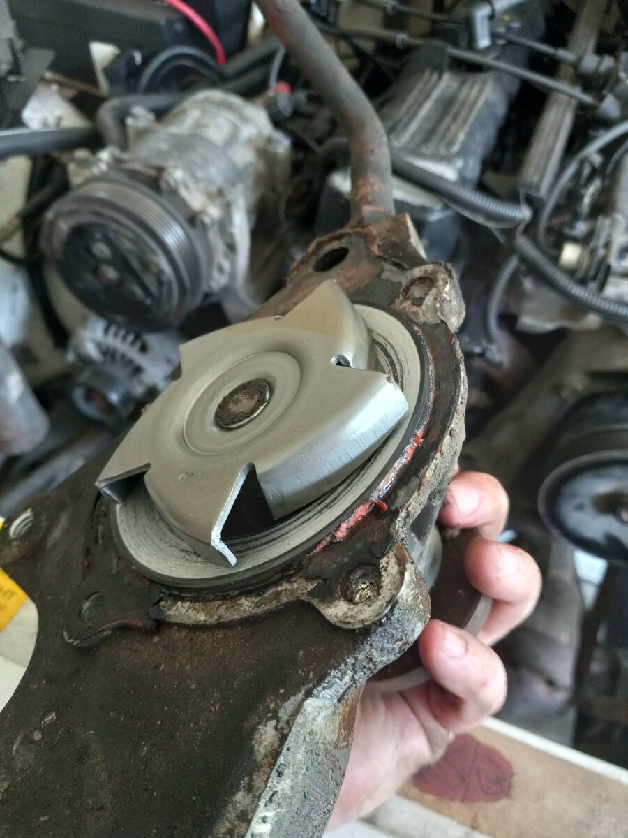

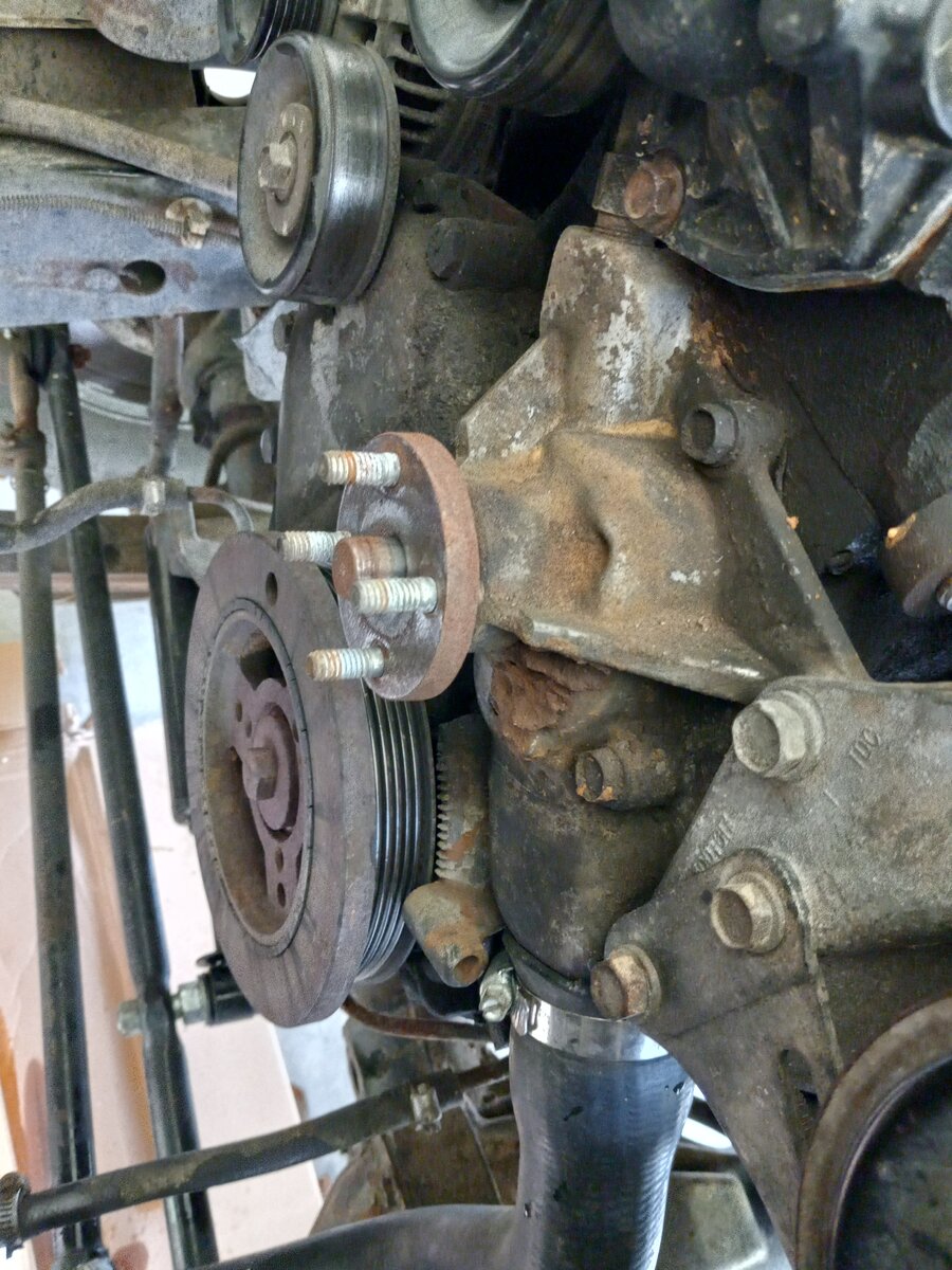

The GMB parts have been decent from my experience. Looks like the old pump was leaking for a while based off the rust traces on it. Just above the lower hose neck (pic #1)looks to be a weird looking accumulation of rusty crud. Cant recall if the weep hole is there for the seal or not indicating a lengthy period of leakage. Also look like the impeller was hitting the backing plate possibly based off some scars on it. If thats really what I see the bearings and seal are wasted. What ever you do clean the block 100% clean at the mating surfaces to make sure you have a good seal.
I noticed the impeller wear against the pump housing too.
The bearings are definitely shot.
I still had the original iron pump with no leaks, but replaced it just because I was there.
