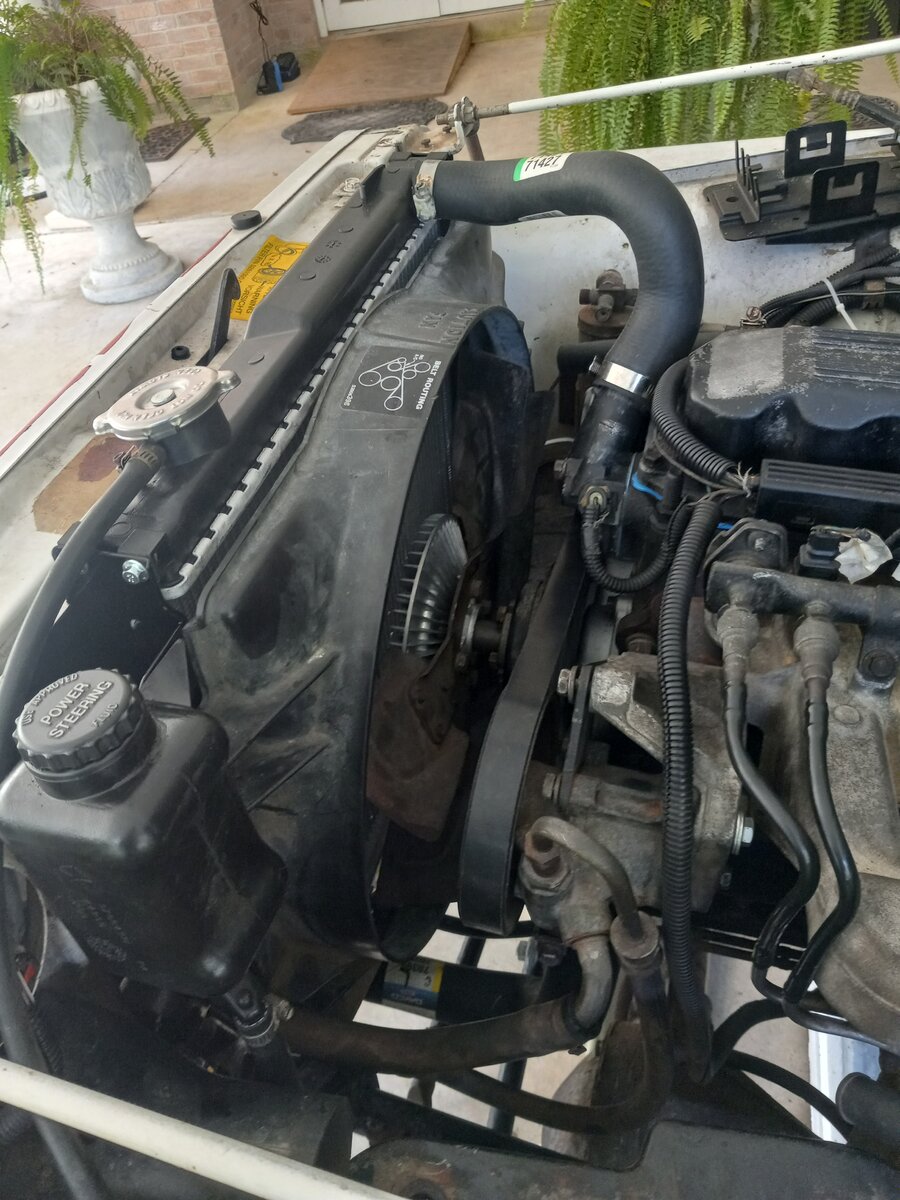

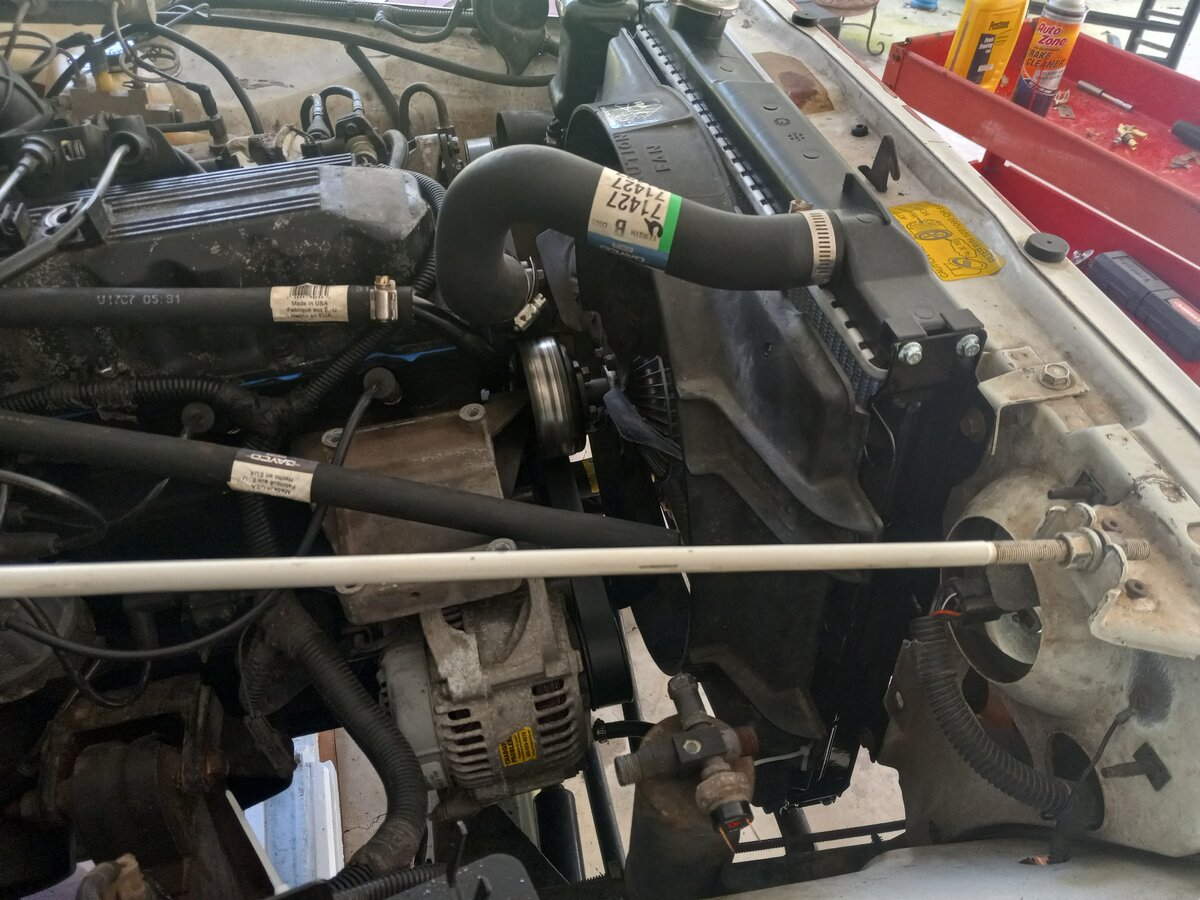

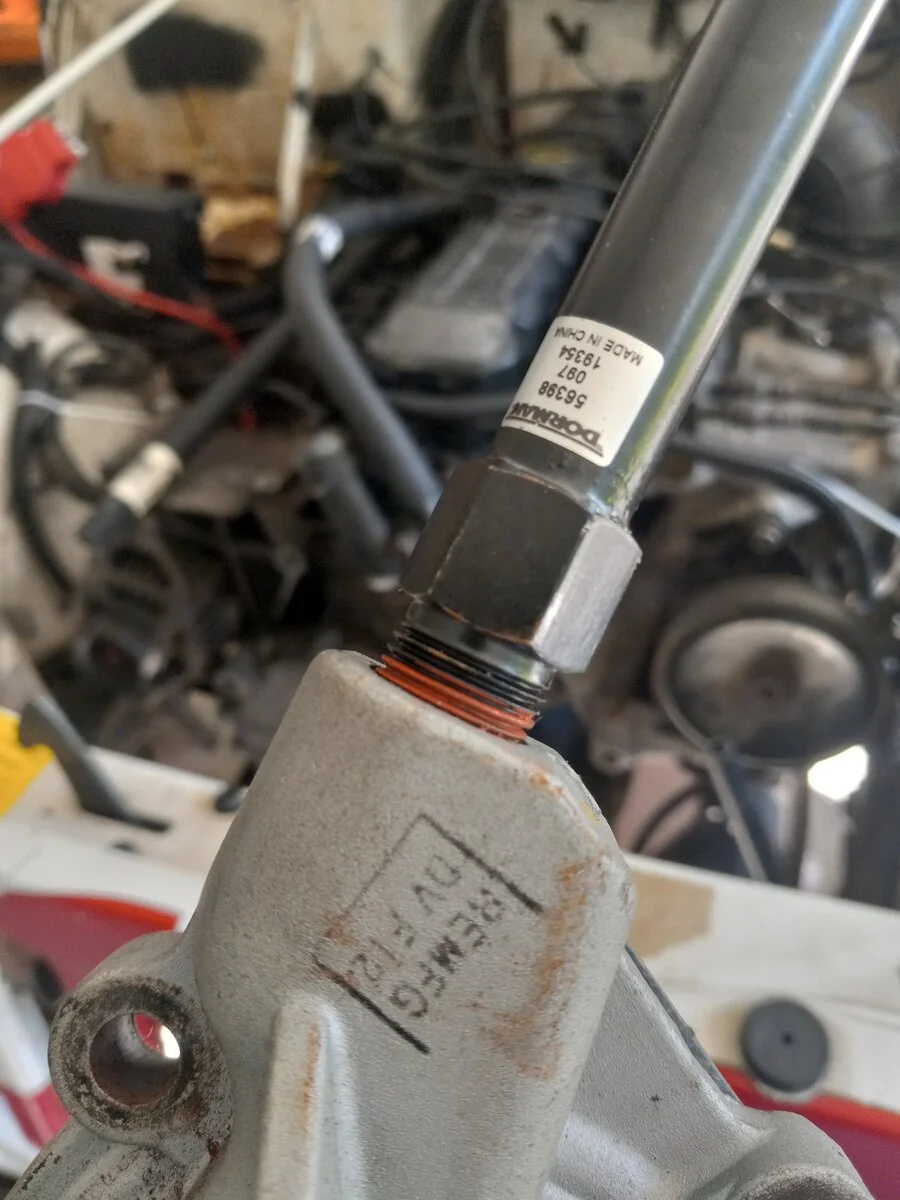

Ha, learned that one a long time ago. Yup. Pain in the ass. Make sure you mock it up on the engine as you go. And only go snug, don’t keep turning it if you can’t make it back around to where it needs to be on the engine. It needs to be tight but not so tight that you can’t make the tube back to its natural position by continuing to tighten.
Reactions: SirDoopYJ
This is already pretty tight. It is hard to put any torque on it to keep it turning. I may need to put it in a vice to give it one more turn?
Geez..is there nothing made in China anymore? If you can get at it once installed you should be able to snug it up or put it in a vise but be gentle so you dont crack the casting.
Vice isnt working. I am just gonna leave it where it is at and see how it does.
What should be the simplest f***ing thing is the most stupidest f***ing thing

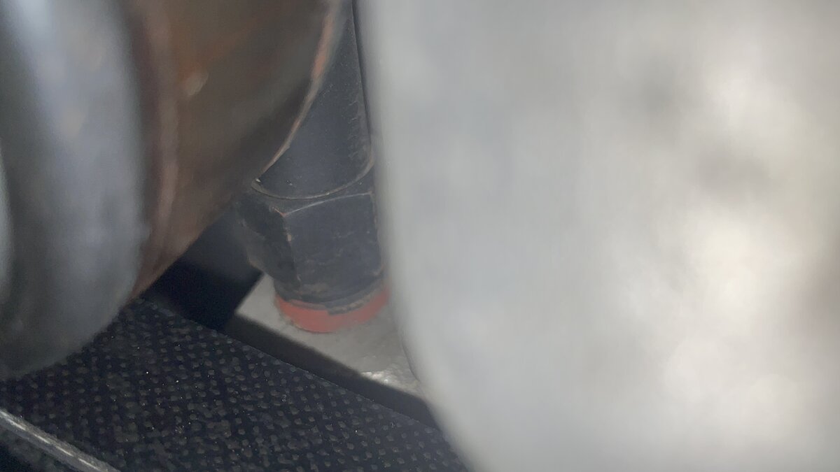

I see nothing wrong, the pipe never goes all the way in or even close, it’s tapered thread like those steering lines if I remember right. Here is how my water pump has been for years

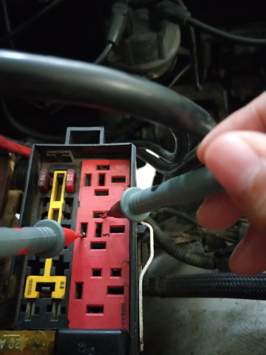

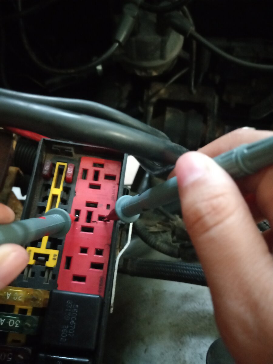

And , dont know if it matters, but I contonuity here while turned off:
When the key is in the ON position, I have continuity between all the holes except the middle one.
Huh, I only had continuity when I tested your second pic, key on or off. So that’s the left and the upper. Never got continuity with any other testing. You’ll never get anything from the middle because there’s not a terminal there, they don’t use that pin for that relay.
But if you felt the relay click, that’s what matters, your pump is getting power. Sounds like you need a new pump unfortunately.
