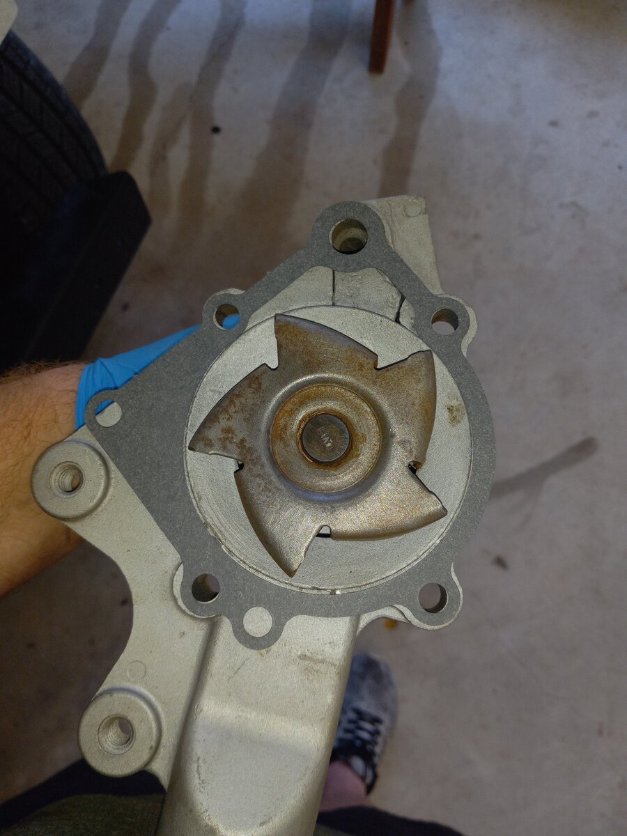

Not yet. I fell behind doing my valve cover gasket on Sunday. I have been getting home late from work with all the traffic this week to have time to do anything.
I get back at it early tomorrow doing some more sludge clean up around the motor. All my new hoses came in today from Rock Auto and I am buying a new water pump inlet at autozone tomorrow.

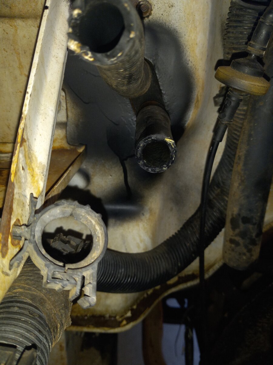

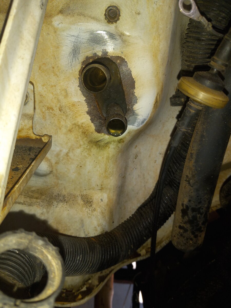

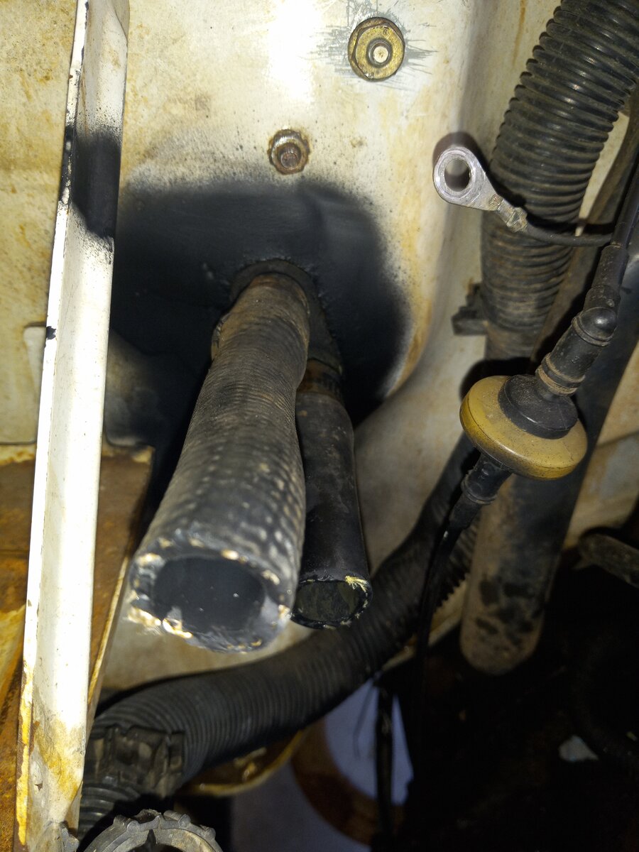

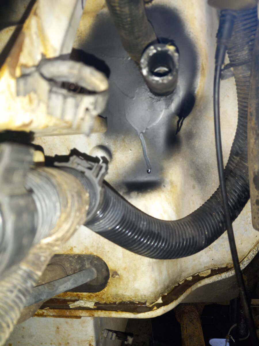

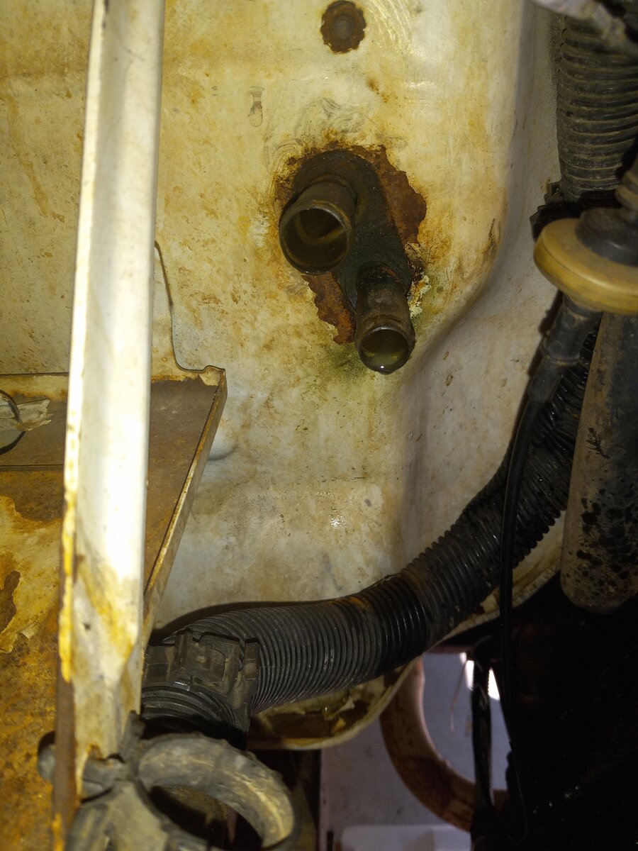

I forgot about the heater core. Should that be replaced?
Yeah, it’s a PITA enough that I would skip it until it causes problems. If/when it ever does, it’s easy enough that you can bypass it until a weekend where you can tackle it. It’s not hard but just an annoying job that I don’t enjoy doing. Having AC out of the way makes it more convenient.
Reactions: jeepjoe43
Just what I would do...

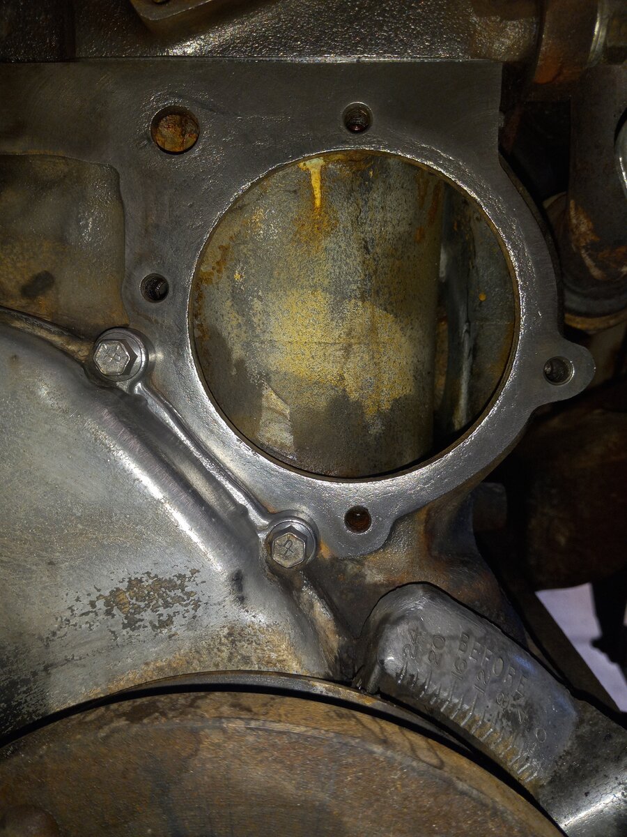

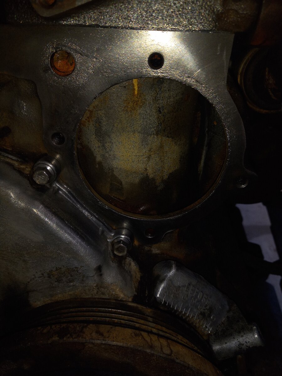

How does it look?
Looks fine to me. It's an old cast iron block, it'll pretty much never be perfect in there. Might want to run some thermocure or prestone once you button it all back up just to do a final clean.

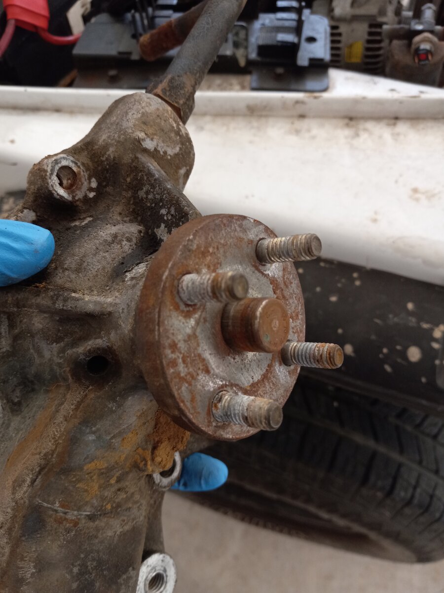

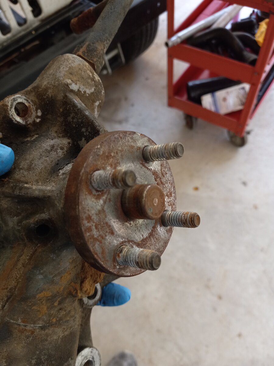

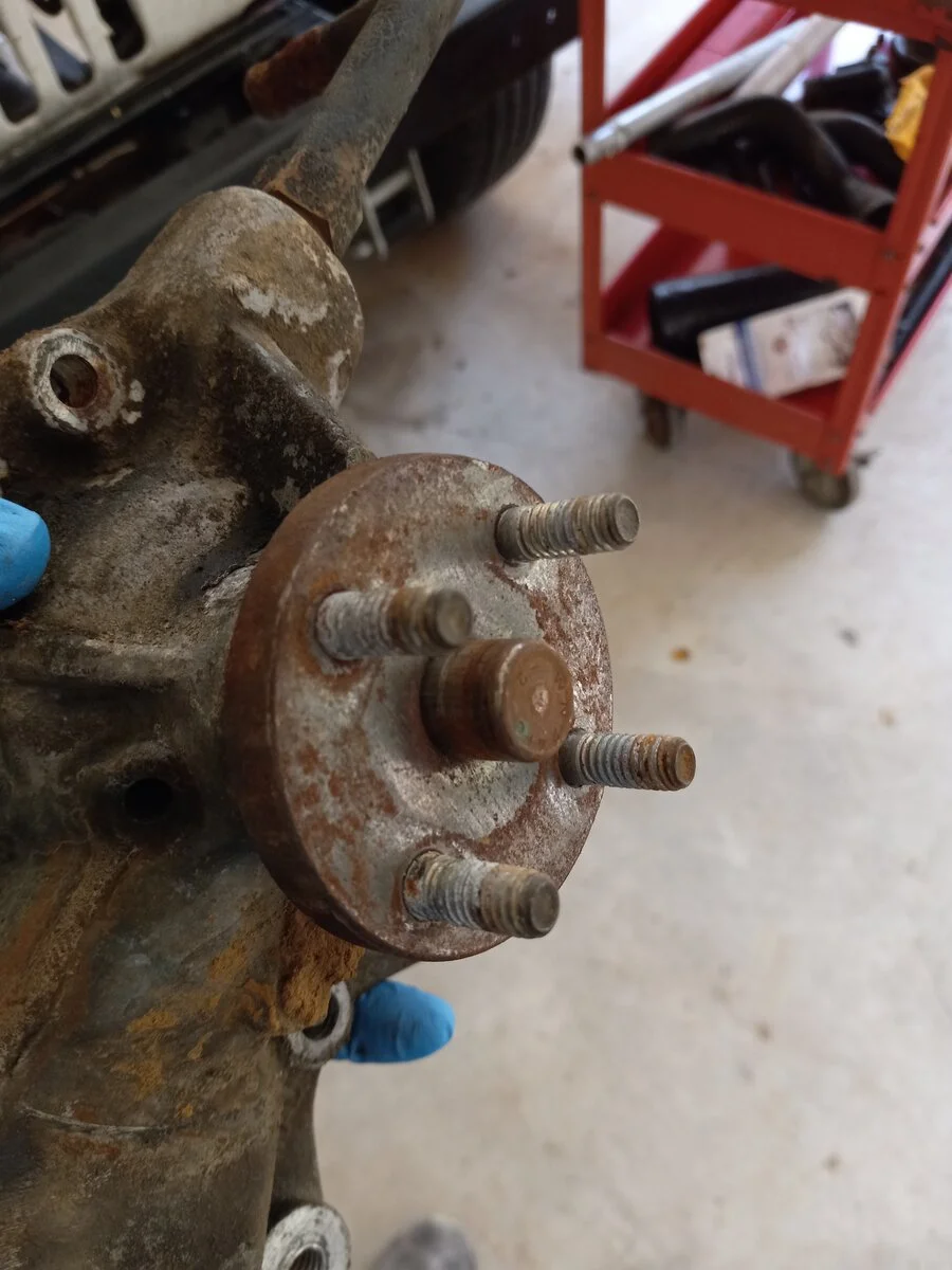

I always double nut them off and then back onto the next pump. Works like a champ. I forget what size though, may have to grab the bolt tester if you have one.
That works, vice grips would probably get you there too, but might booger up threads past the fan clutch thickness.
By the looks of your's I would soak it with some PB Blaster (or any other penetrating oil) overnight.
