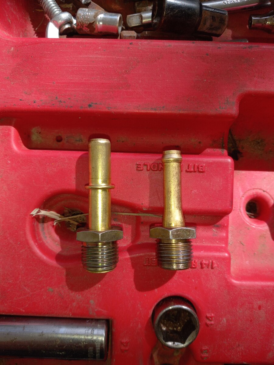

Alright, I think I resolved the transmission line leak. The radiator came with two size nozzles. My old radiator used the ones on the left (bigger nozzle), but I also changed out my hoses and they were not fittinf well on the bigger nozzle. They fit perfectly on the smaller nozzle.
I went ahead and change the leaking side with the bigger nozzle and the new hose I bought went on perfectly because of the oil. So there ya go.
Ill go ahead and change the othet side to the bigger nozzle even though there are no leaks.
As far as the coolant, it may have been my rad cap wasn't on all the way. We'll see. Going for another test ride. It is breezy and 70* F over herr.
