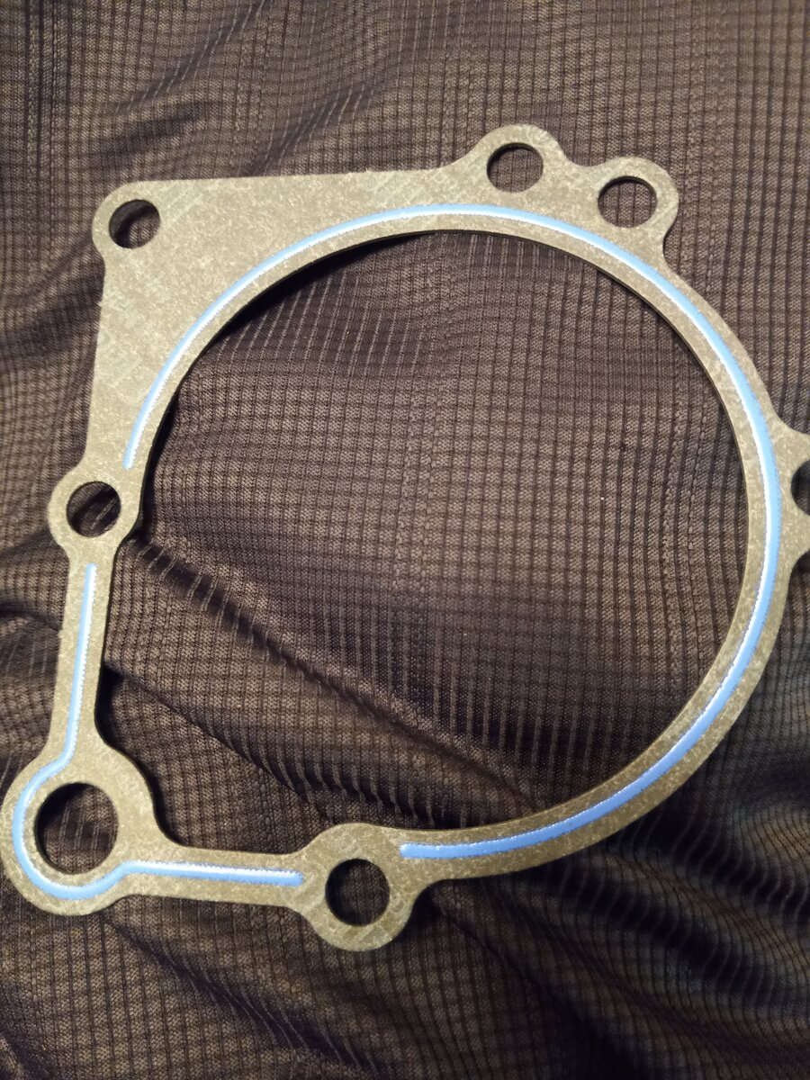

I am assuming the blue striped side goes towards the motor, or am I wrong?
Do i still use a thin layer of gasket maker with the water pump? Do I use thermostat gasket maker or red rtv?
I don't remember what way the stripe goes but it will only work one way, so you'll figure it out.
Don't freakout when you have extra holes. That gasket is a 2-fitment design that fits the 2000+ 4.0 which uses a different water pump and bolt pattern. The gasket was made to be sold as one single part that works for both. You'll figure out what way the gasket goes when you try to put it onto the pump. It will only line up one possible way, and flipping the gasket will screw that up.

Yea, Im getting it. The gasket came with the Mopar one I bought, but I am saving that water pump for another time. My boss gave me an Oreily one he never used for his TJ.
So Ill be fine with just the gasket, no need for any aditional gasket maker?
