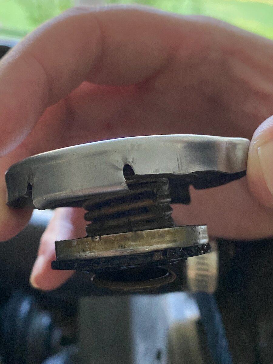

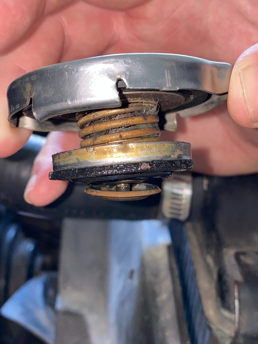

I like the constant tension clamps the best for sure. They will pretty much make sure any leak issue you have is not a hose connection problem. Putting one on the water pump sucks, You need a 55 mm and need to open it all the way, then put the hose on the pump, then pop the tab on the clamp so it springs back into clamped mode. I hate dealing with the locking tab on constant tension clamps.
Check the cap closely. If anybody used some kind of stop leak crap its very possible there is remnants of it under the cap seals. If you look you'll see they work like a check valve of sorts. Gets hot,pushes the spring loaded center up and pushed coolant into the overflow. Cools down and contracts and that little brass center metal disc opens up and lets coolant back into the radiator to keep ant air displaced. Rusty,gunky crud screws gets under the rubber and that metal disc and stops it from doing its job. You certainly have been thru the ringer on the cooling system on yours, were keeping our fingers crossed its just a bad cap or loose clamp. I prefer the screw/worm drive type clamps myself. Some places are just to hard to squeeze the tabs together and get at it. The I can use 3' of extensions with a Universal if needed to tighten or loosen.

I also forgot to mention that inside my reservoir, I had a few spots of dark gunk floating on top of the coolant. It almost had the texture of clumped up hair. I have removed my reservoir twice in the past and cleaned it out with dawn soap, so I don't know where the gunk is coming from.
I will inspect the cap more when I get home and send some pictures.

That might be what left of somebody's mess trying to seal up a leak. I can almost guarantee you thats doing bad things to the caps ability to function correctly. Also even after replacing it you likely will have a reoccurring issue if it goobers up again.
So if they used something to seal a leak, I could have a bigger issue I don't know about if the seal ever goes away? You are talking about they might have used some sort of head gasket sealer?
