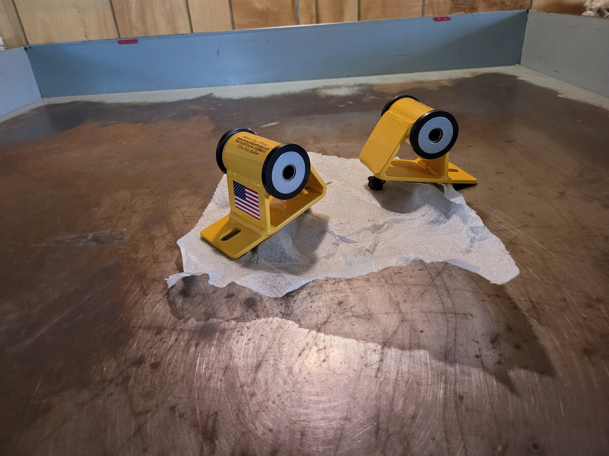

I didn’t really do anything special when I did mine. There’s not much on that job that removing parts gives you access to. Maybe motor mounts if those are in bad shape. If so then I’d do new mopars.
Check out Brown Dog Industries too!
Really?!?! Don't suppose you have the old ones to sell?
I do, they're actually brand new, never been driven on but the engine sat on them for a year or two. I can find them and send some pics when I get home if you're interested.
I've a buddy who's wanting a set. Not sure if the 4.0 is the same for 4.2. We'll do some checking as well.
