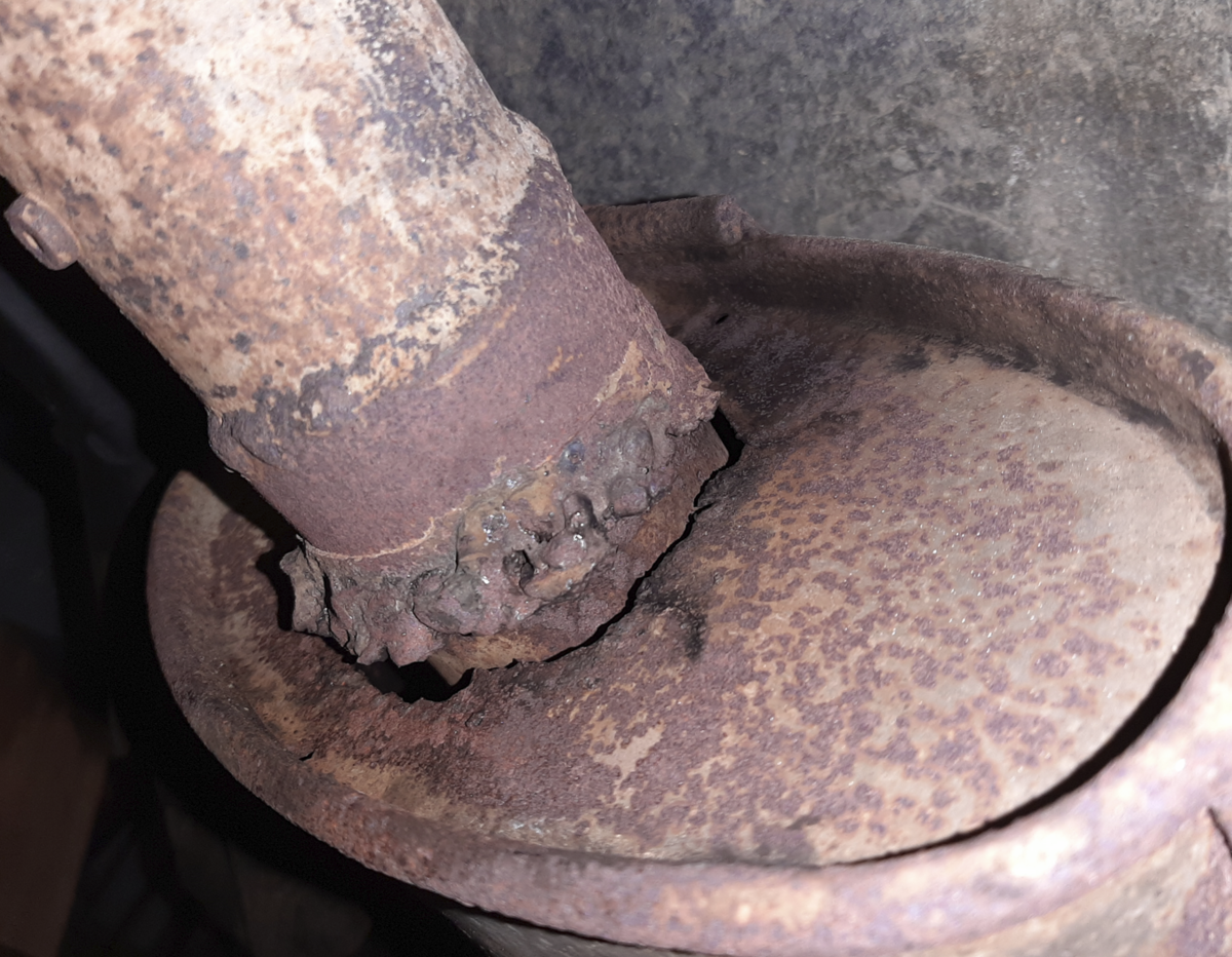

If it's between the engine and catalytic converter I've seen a little black soot in the area. After the CC it's usually cleaner but you can hear a leak once you get away from the engine. A good sealed exhaust system is usually quiet.
The inlet pipe into the muffler seems to be a weak spot. It looked like a previous owner tried to weld mine together without much luck or skill. It was loud.

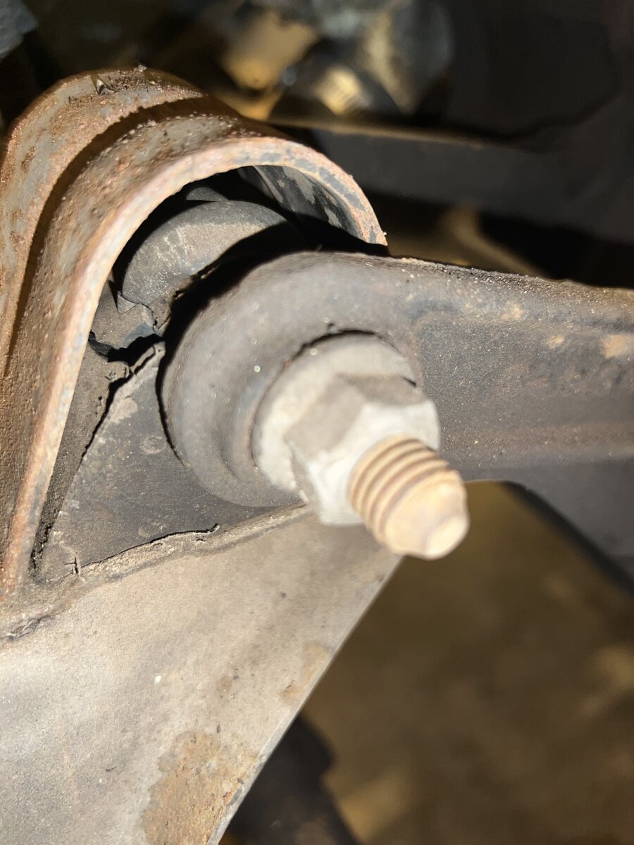

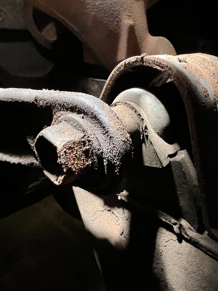

The passenger side is a little thicker. If you’re looking to spend some money for a better upgrade there is brown dog industries. I couldn’t get myself to spend the extra $100 though. I Just got mine from autozone I believe it was a dorman. You will definitely be able to tell if your motor mounts are bad. The thing about any old vehicle or motor cycle is fighting the urge to replace stuff while you’re in there. Here is a phot of how bad my driver side was when I just recently changed it.

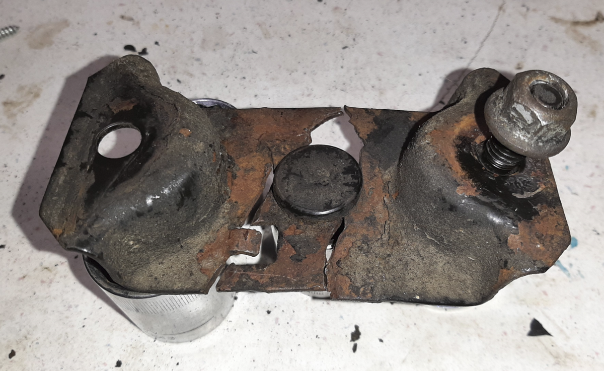

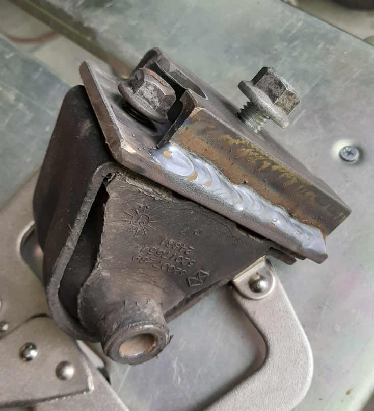

I don't know if all 2.4L are the same but my 92 had this cheesy motor mount lift under the standard mount on the right side. All I can guess is some design engineer had the wrong measurement and added this to correct a problem. Anyhow, it's junk and often cracks, as mine did.
I has the channel and plate materials to replicate the Brown Dog base.
Cheap OEM part
Fabricated lift.
