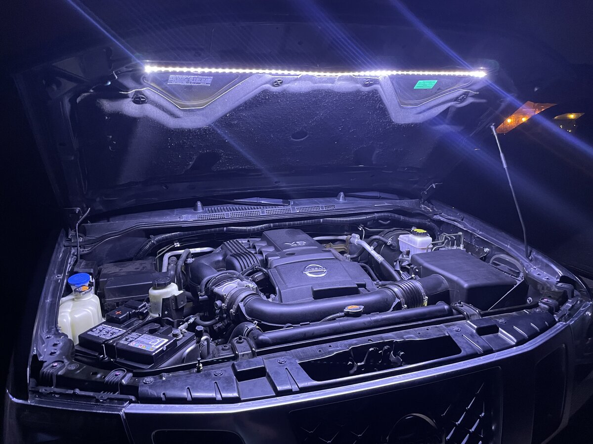

Did an LED strip setup on my Frontier’s hood a few weeks ago. It came with a manual button switch and I tied the ground to a hood pin as well so it’s automatic and can be shut off if needed. It’s already come in handy like 5 times.

That’s awesome . Love it. Looks good.

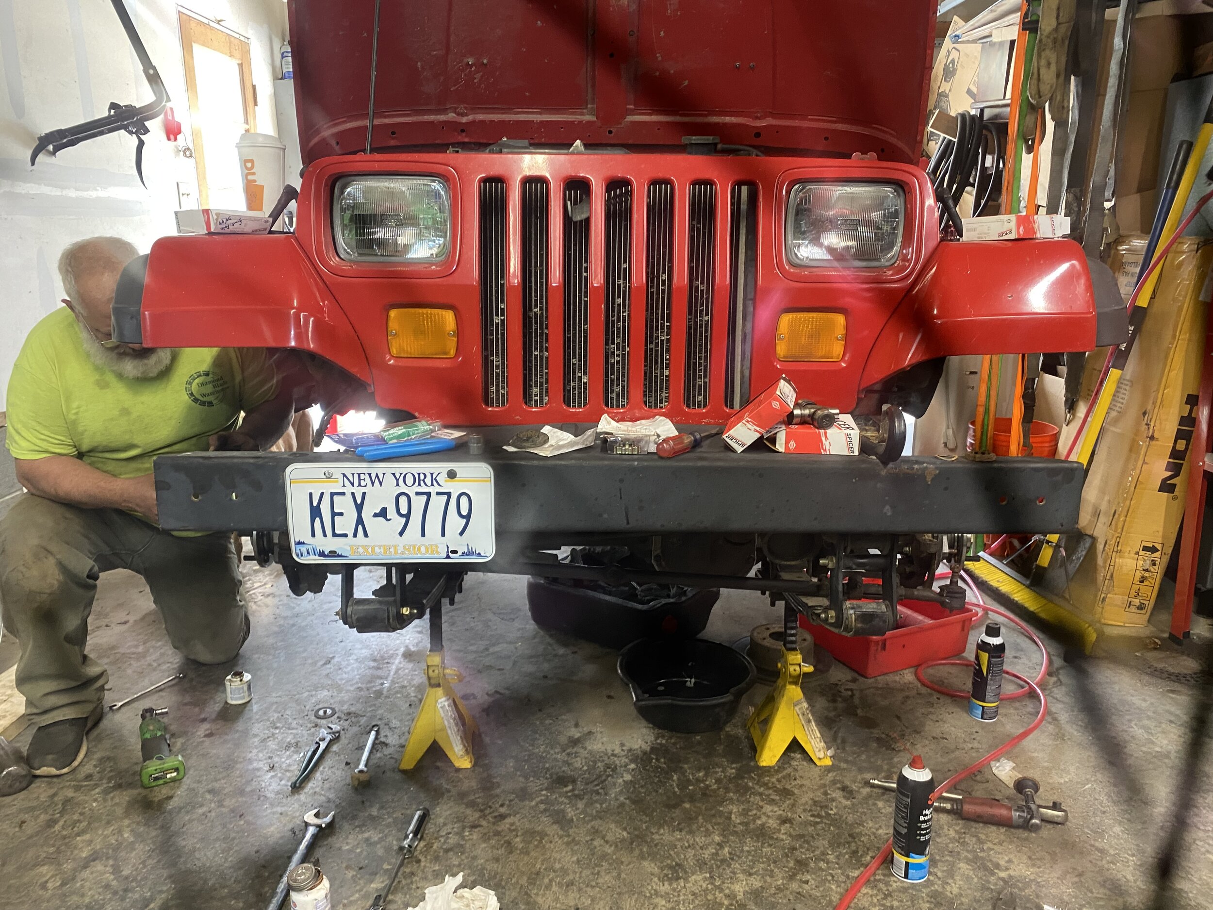

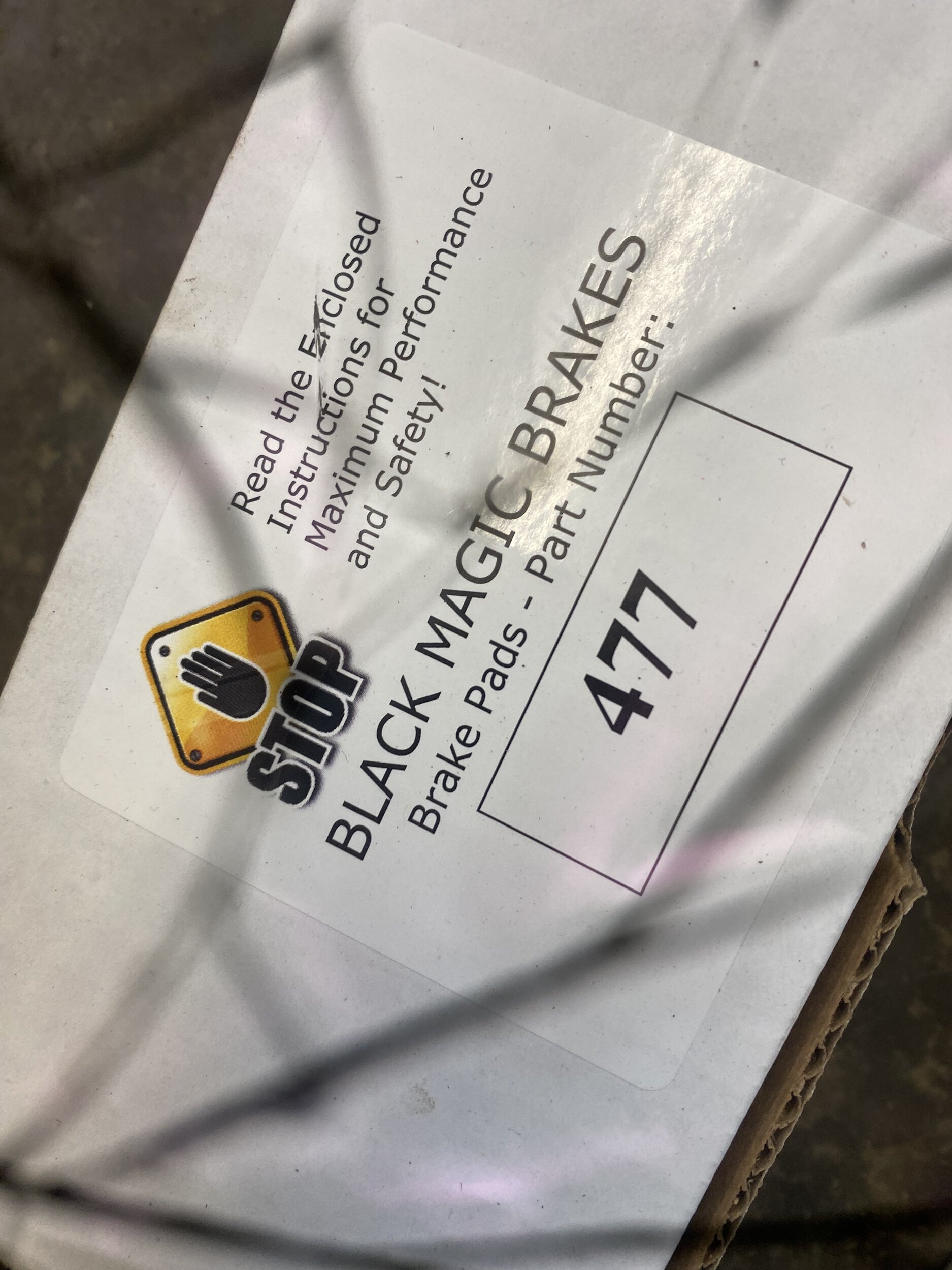

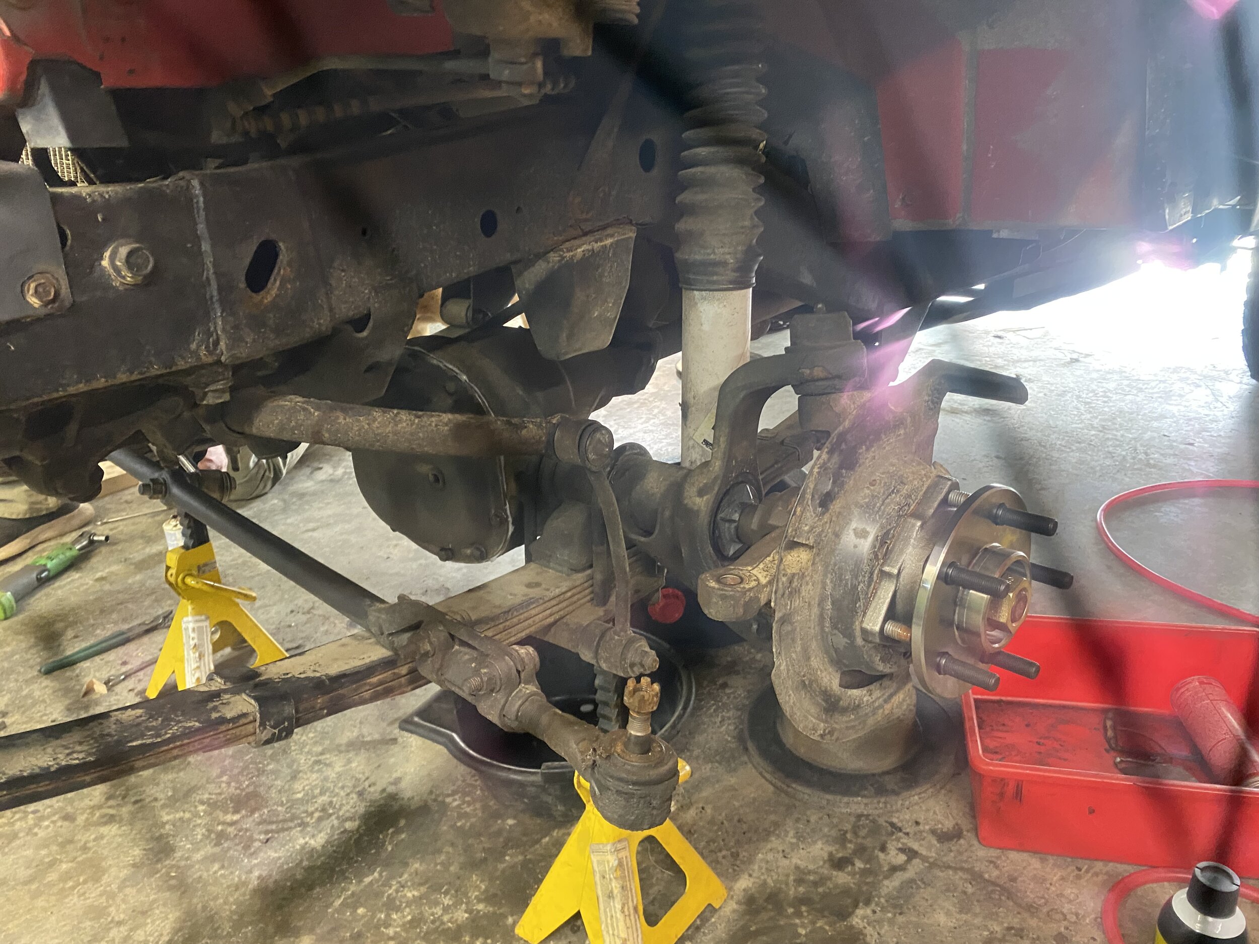

Surprised this thread doesn’t get more use.

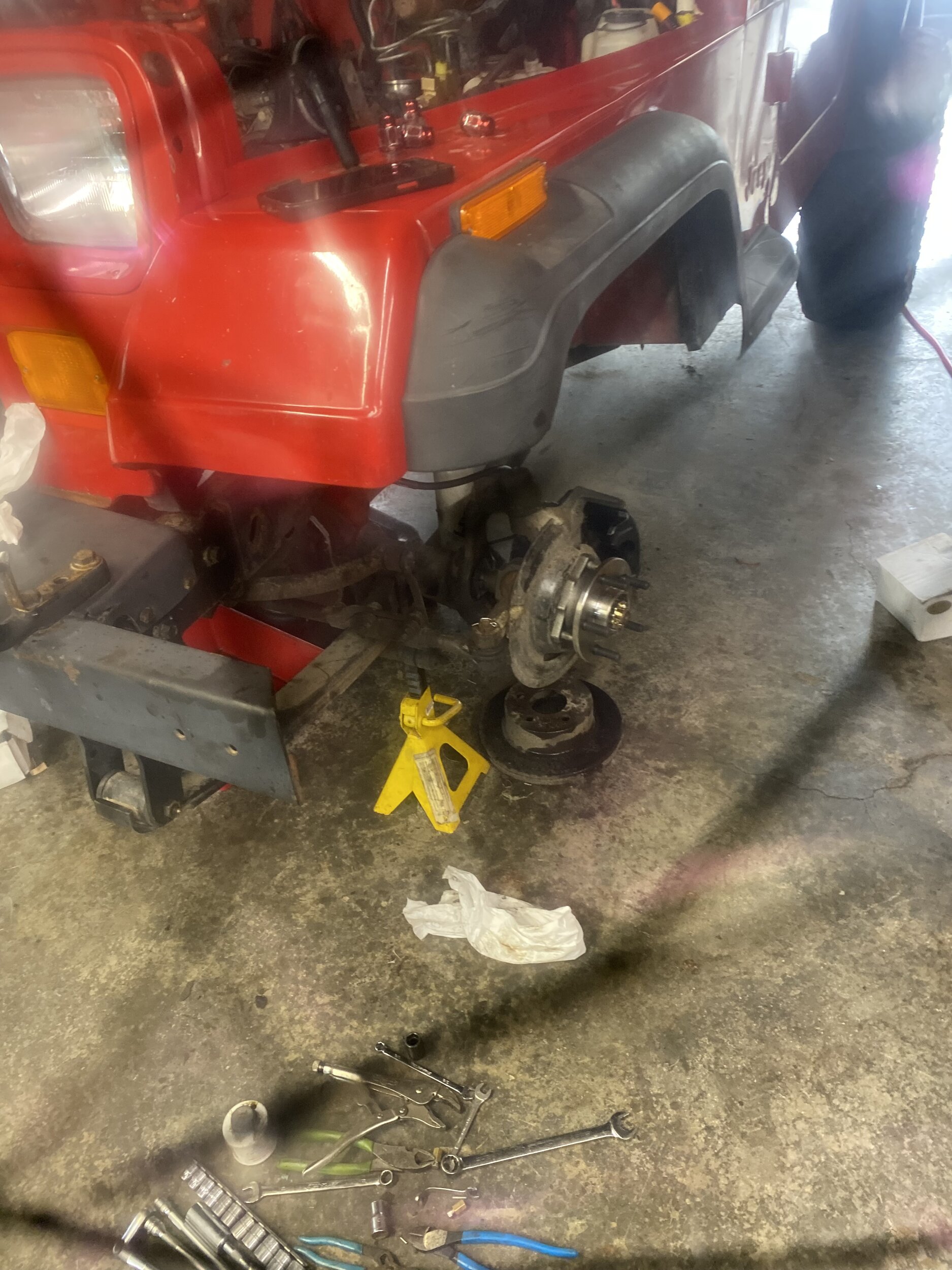

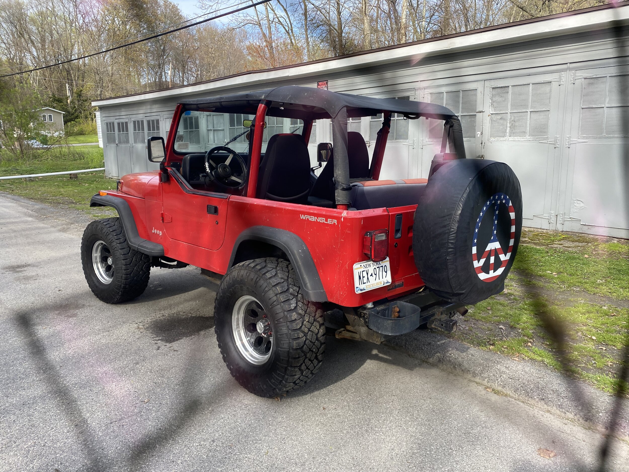

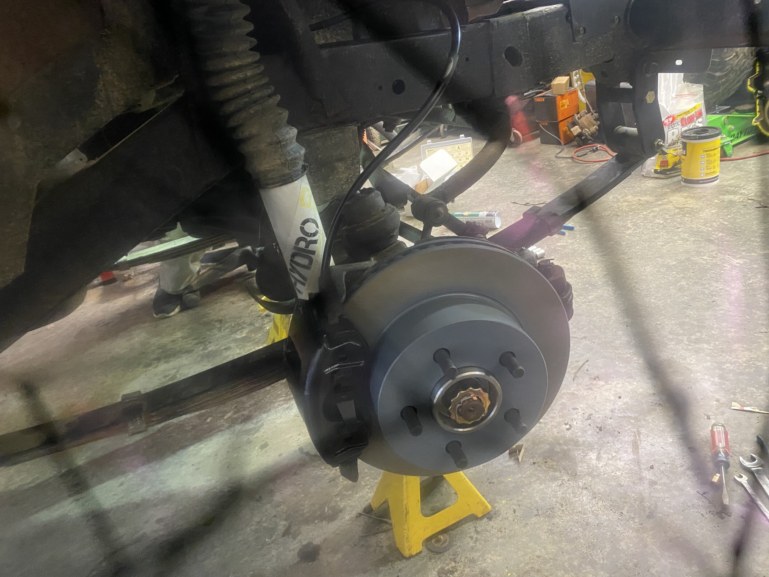

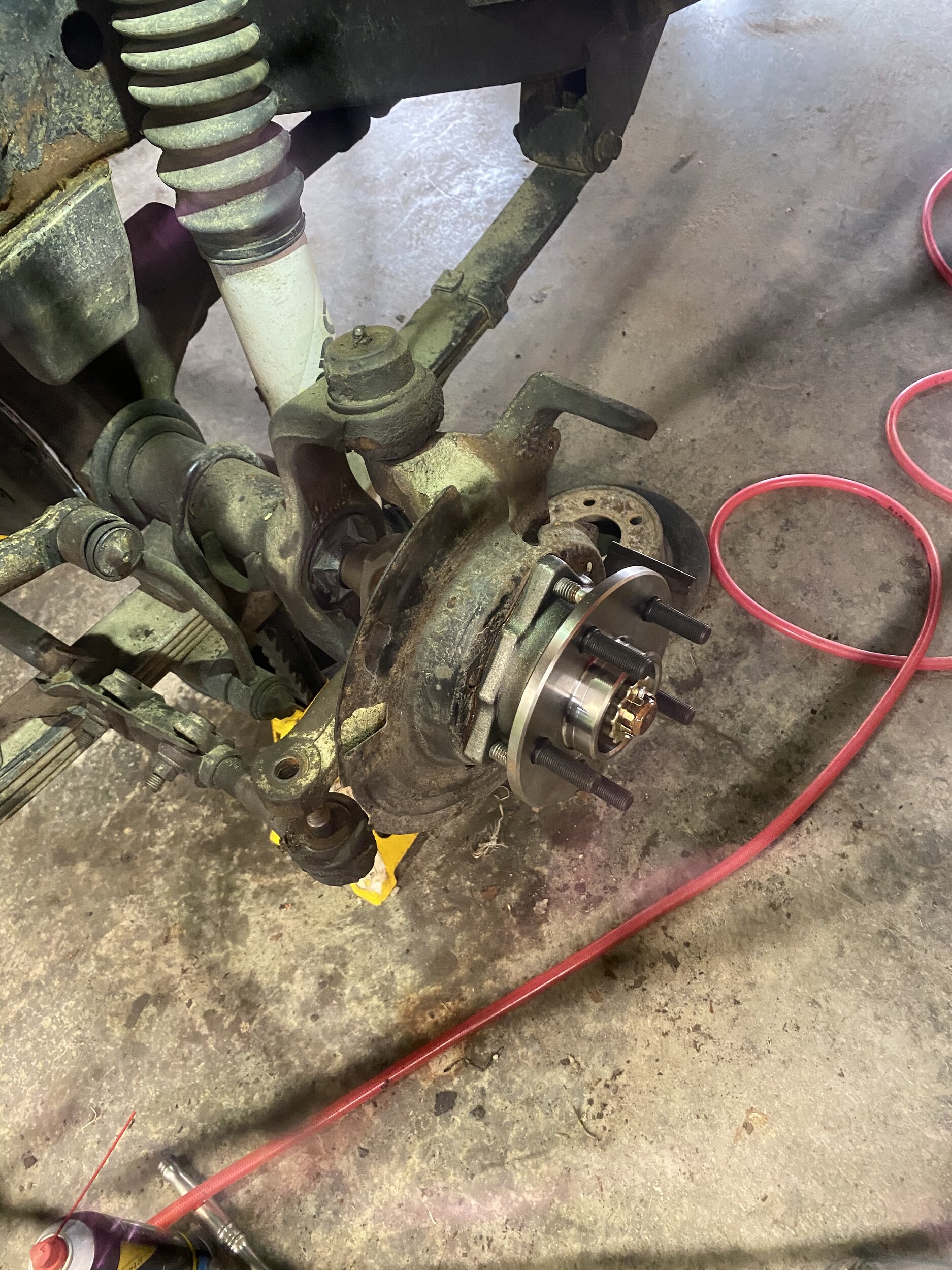

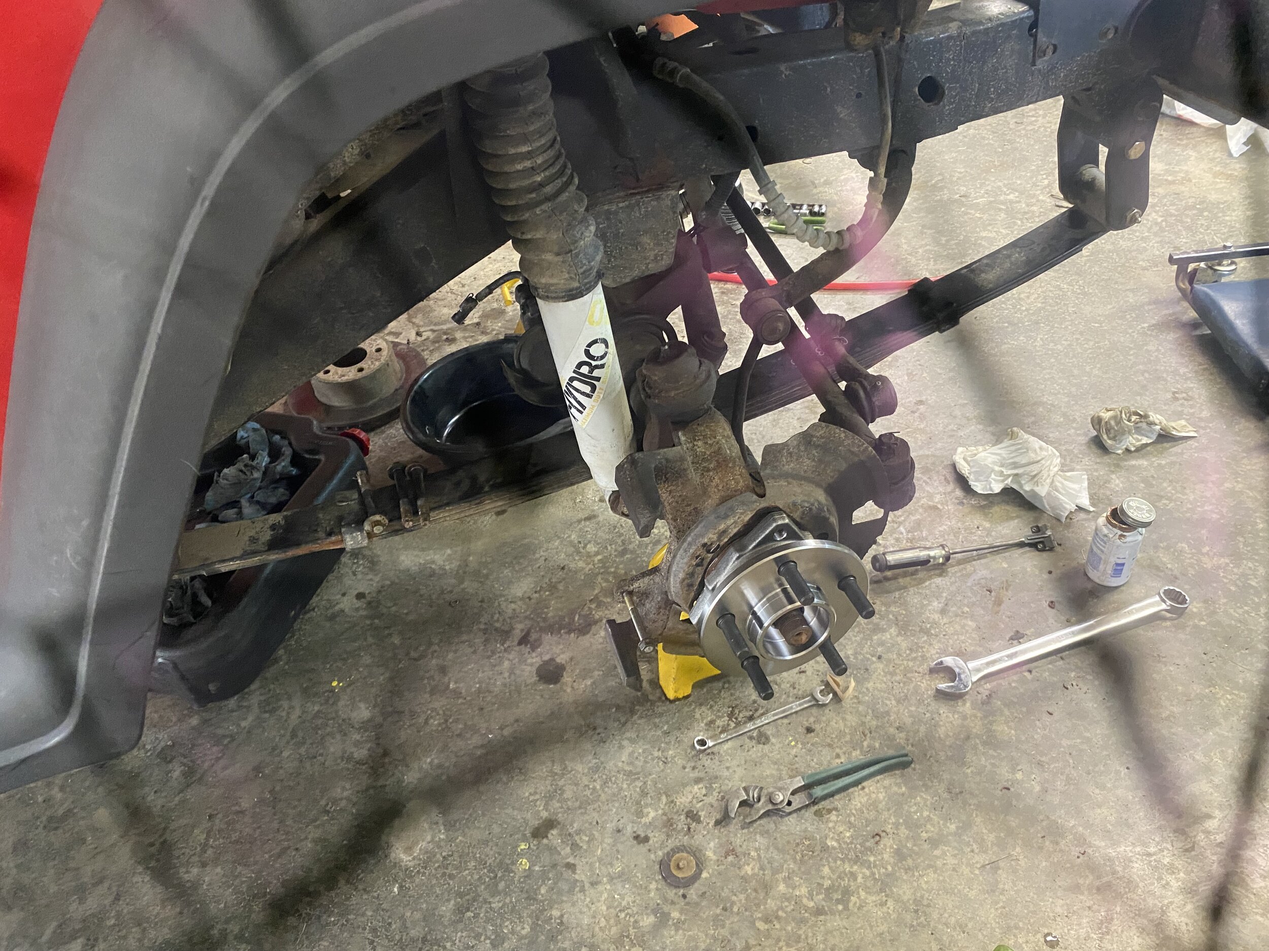

This pst weekend went through the front 30 axle of Luci’s ‘95 2.5.
New seals, hub assemblies, u-joints, Crown Performance extended brake lines,
Black Majic Pads and Rotors(no comparison) and new NAPA E-Coated calipers.
Make sure you properly break in your BMB pads!

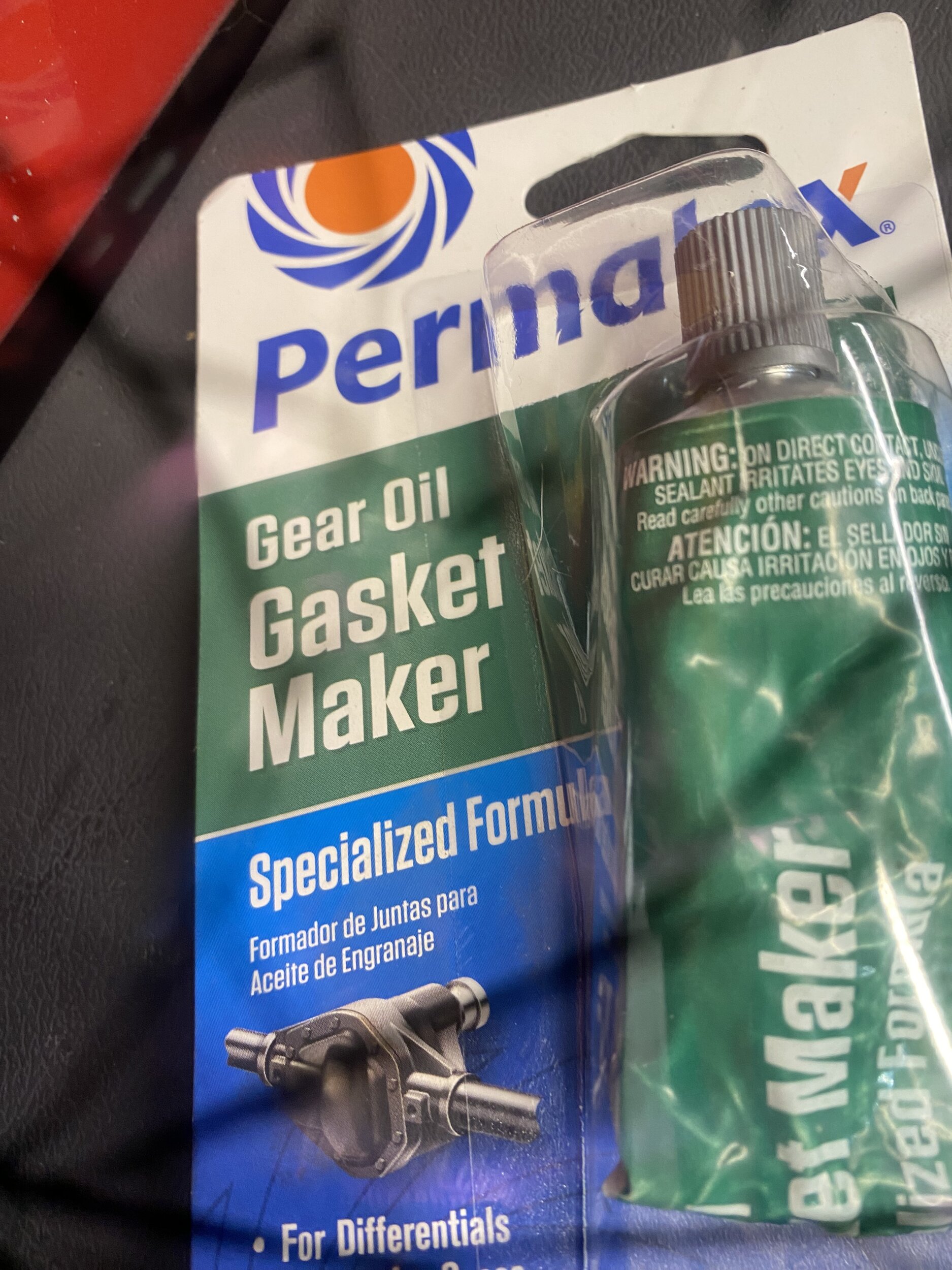

Also drained, cleaned and refilled the rear 35 for general maintenance purposes.
Previously rear axle received all new brakes and extended lines.
The YJ is ready for the nice weather and Luci to come home from college as a graduate and enjoy summer work in the YJ

Looks good. However, I will say, I prefer stock style extended brake lines over Crown. Crown is great quality, but since they are not formed in any way, they like to just hang out and hit whatever unless you find a way to secure them. The stock style lines have the same metal bits as stock, just longer on the metal and then the rubber follows the same path as stock. I personally consider that a better design.
The lines I am referring to are sold by Centric and Raybestos on RockAuto. They make all 3. They are for 4" lift but will fit less lift as well, you can bend the metal portion as needed so that it all works.

As far as the lines I’ve had good luck with these before but Honestly i spent all night last night looking for something “better” for my LJ. Ordered the Russell brand from Quadratec because they were in stock and $100 for all 3.
I will definitely check this out. Share a link if you have.

Pretty simple, just go through the typical rockauto process, get to the Wrangler and choose brakes, brake hose section. Has front left, front right, and rear. Choose the one with 4” raised suspension in the description.
They sell them for the TJ/LJ too. A lot of TJ guys buy the YJ lines because the YJ stock lines are longer, but if you go with the TJ version, it’ll fit better. Makes more sense to get the TJ version for raised suspension instead of YJ lines for a lifted TJ.

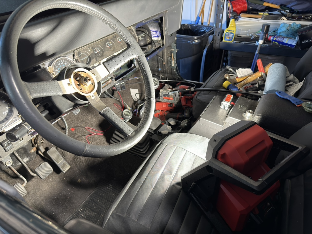

Picked myself up a really nice work light from Milwaukee so I can actually see what I’m doing. Working on putting the dash back together.
Heater control panel is back in. I hate that thing. Heater box itself is up next. Maybe tonight, but probably more like tomorrow. At least I can see what I’m doing now.

The new lines are staying in the YJ they worked out great and actually sit nice. I did find the line you speak of on Rockauto and ordered it up for the LJ. Thanks again

Dash work makes me tired and thirsty
