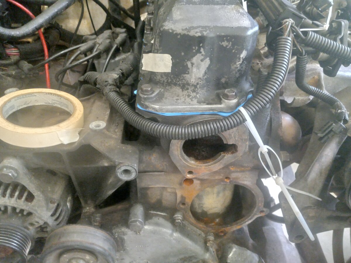

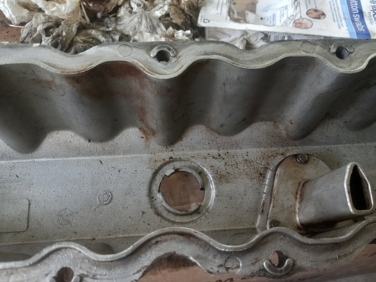

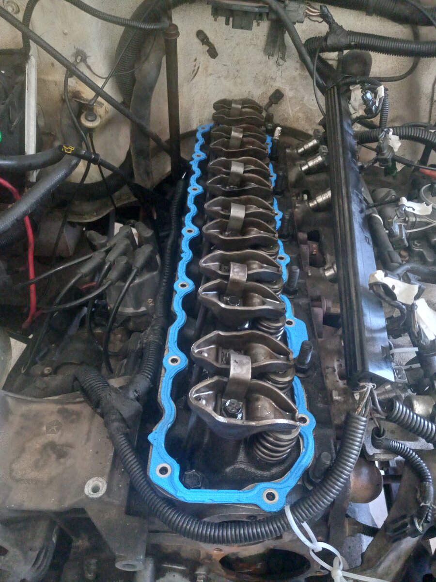

I have been working on getting to my water pump because it decided to start leaking everywhere. While I had eveything out of the way, I figured it was a great time tochange out the valve cover gasket.
It was alot easier to do than what I thought, the hard part was the cleaning. I spent all day today removing gasket that was stuck on inside of the head and valve cover. Oh and this mess:

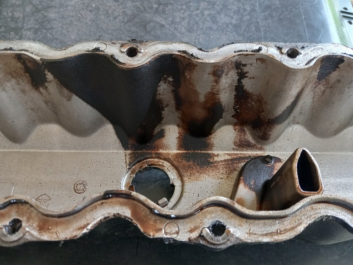

Before
After
I bought a fel pro gasket. It is pretty thick, lined up really well and should help with alot of my leaky oil problems.

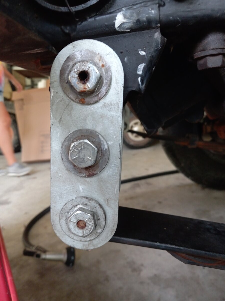

I also learned a little dirt dobber decided to make nests in the grease holes of my shackles..

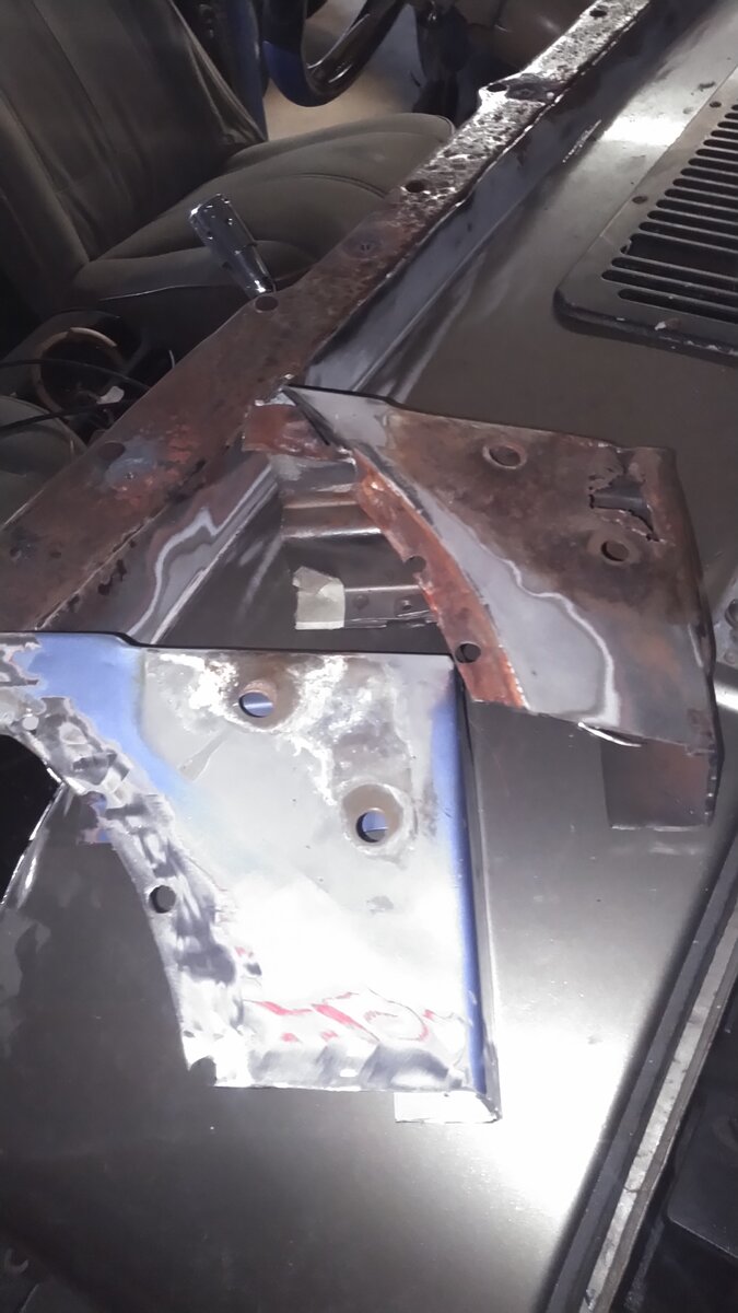

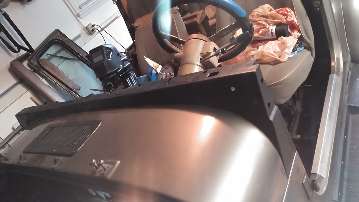

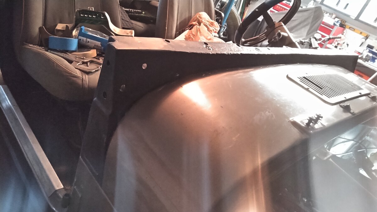

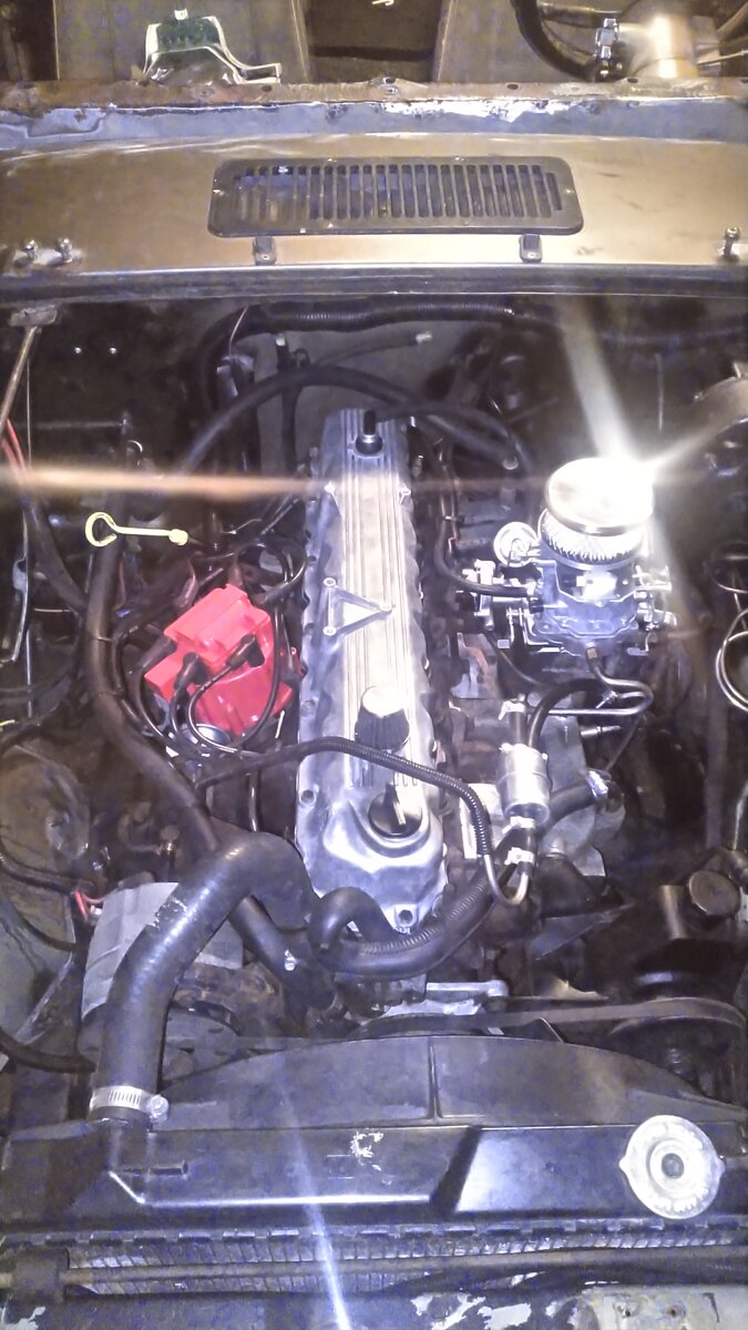

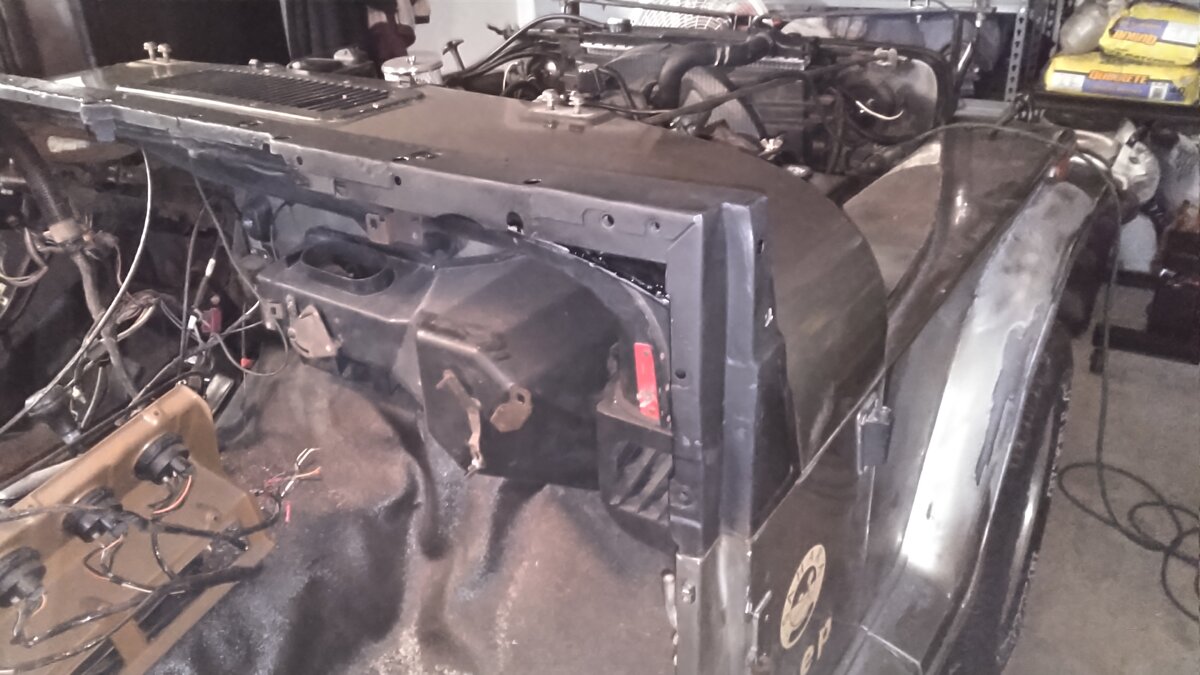

Today I finished up with the engine bay. After removing all the computer stuff and vaccume controls and completely rewiring from the bulkhead connector forward, it's finally finished and running excellent

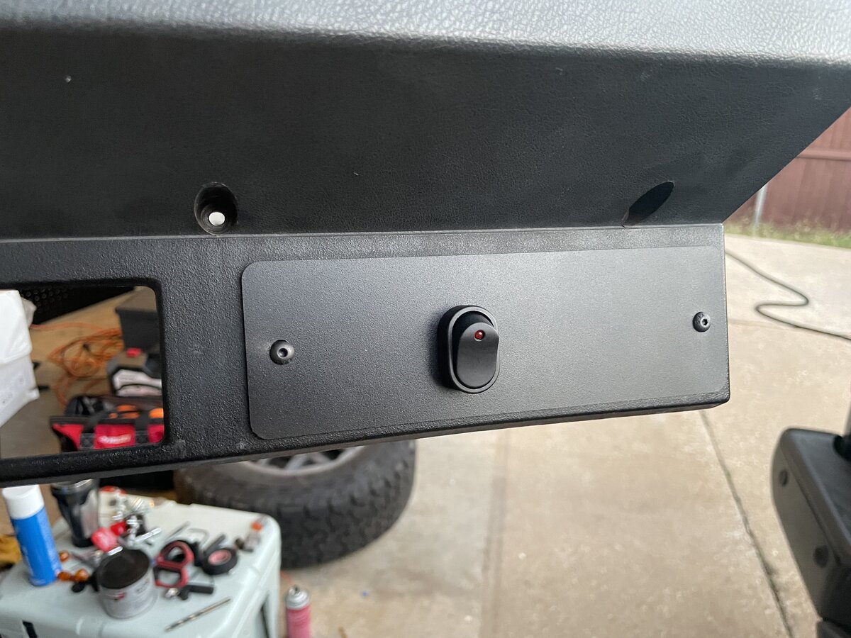

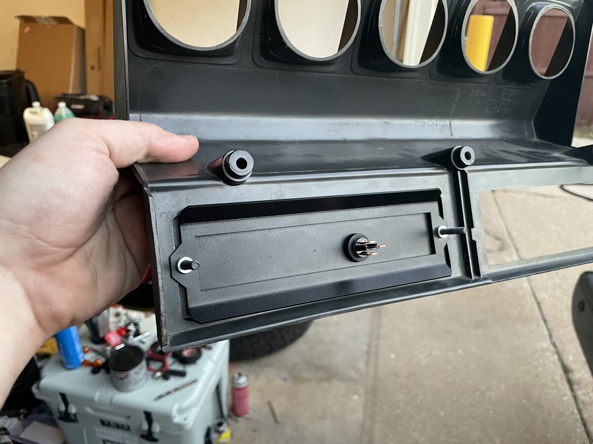

Picked up a simple little on-off switch from AutoZone. I like it because it is an oval shaped rocker but it has a circular base on it, so you just drill a 1/2” hole and then it mounts right on. The only downside to this switch is the LED is way too bright, so I think I’m going to leave the indicator ground disconnected and just operate the switches by feel. Most of them I won’t use regularly anyways.
I do wish I could come up with a good way to label them though. I could have used fancier switches but most of them require rectangle holes and I really don’t trust myself to try to do that. I wanted nearly a year for this Rinky dink panel to come out of back order, so I’m damn sure not going to screw it up.
This is using the 151-01 radio delete panel from tuffy. It’s a universal part, and was too small for YJ dash opening, so I’m using it on the trim panel instead. It works.
Gonna do 4 of these switches, and then to the left of the switches will be a 3/4” USB port for me to plug in my iPhone cable. The cable for that port will run across the dash, down the door panel, across passenger seat and up to my radio in the console. It will go to the USB in the backside of my radio. The front face of the radio has a USB that I probably won’t use very often. Since the radio will be right under my arm on the armrest; I don’t want a bunch of cable mess right there.
Thinking the switches will be as follows:
-backup lights turn on (also automatically turned on by reverse)
-fog lights
-a-pillar lights (KC drivers)
-daytime running light cutoff
I’ll share more when I’m done.
-fog lights
Yeah, they're meant to fit the plastic trim panel, not the dash.
I don't have the panel, but do have the little pocket they offer instead, same story.
Only you you have bolts to hold your's together, the pocket just had the fold over tabs.
No Biggy, not what I was expecting, but it plugged the radio hole.
Noticing the light on the switch is LED and doesn't pull much current you could put a resistor on the ground to cut the brightness.
Having done only rudimentary math, I would guess 1/2 Watt, 100 Ohm, might make it acceptable (resistors are cheap).
Or a maybe even a rheostat like the instrument cluster has...
Just thoughts.
Just thoughts.
Yeah, both the pocket and the panel are universal. They sure made it seem like it goes to the metal dash frame on the TJ they demonstrate it on, so I was expecting it I go in the dash hole, not the trim. Anywho, it works.
Great minds think alike on the led. I actually texted my buddy an hour ago who knows a bit more about electrical than me asking if a resistor on the ground would dim it or not. He hasn’t gotten back to me yet but sounds like you answered it for me, so thanks for that. I’m accustomed to putting resistors on the power to dim things, which is precisely what I did on my side markers to run them dual stage low and high on a single “filament” led bulb. Except in this case, I can’t resist the power side because that is the source for my accessory.
I’ll probably buy a kit of cheap resistors and play around with different ohms and watts to see what I like best. 1W 100ohm worked really well to tone my extremely bright side markers down to perfect calm brightness at night. Worked out well because the bulb brightness by itself is very bright at night and good enough during the day too. I imagine a similar size resistor would do it nicely, but of course will need to play around to fine tune it.
I’ll probably buy a kit of cheap resistors and play spring with different ohms and watts to see what I like best. 1W 100ohm worked really well to tone my extremely bright side markers down to perfect calm brightness at night. Worked out well because the bulb brightness by itself is very bright at night and good enough during the day too. I imagine a similar size resistor would do it nicely, but of course will need to play around I fine tune it.
Good on you!
The wattage can probably be lower, but they don't cost shit until you get into the really high power stuff.
And Yes, the ground is just for that light and, nothing else.
That is where the resistor/rheostat would go, and all of the switches can even share it if properly rated.
If you go rheostat, maybe 1K Ohm so you can dim them out completely if desired.

Good on you!
Cool. Where do you get resistors from? I’ll probably look into del city or waytek, they have lots of good stuff. I’ll probably skip the rheostat only because I don’t know where I’d put it. That would be cool though. But I’ll probably just put a resistor on each switch, all the same size resistors, once I figure out which one I like the brightness of.
