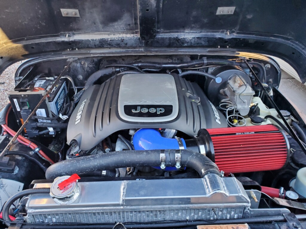

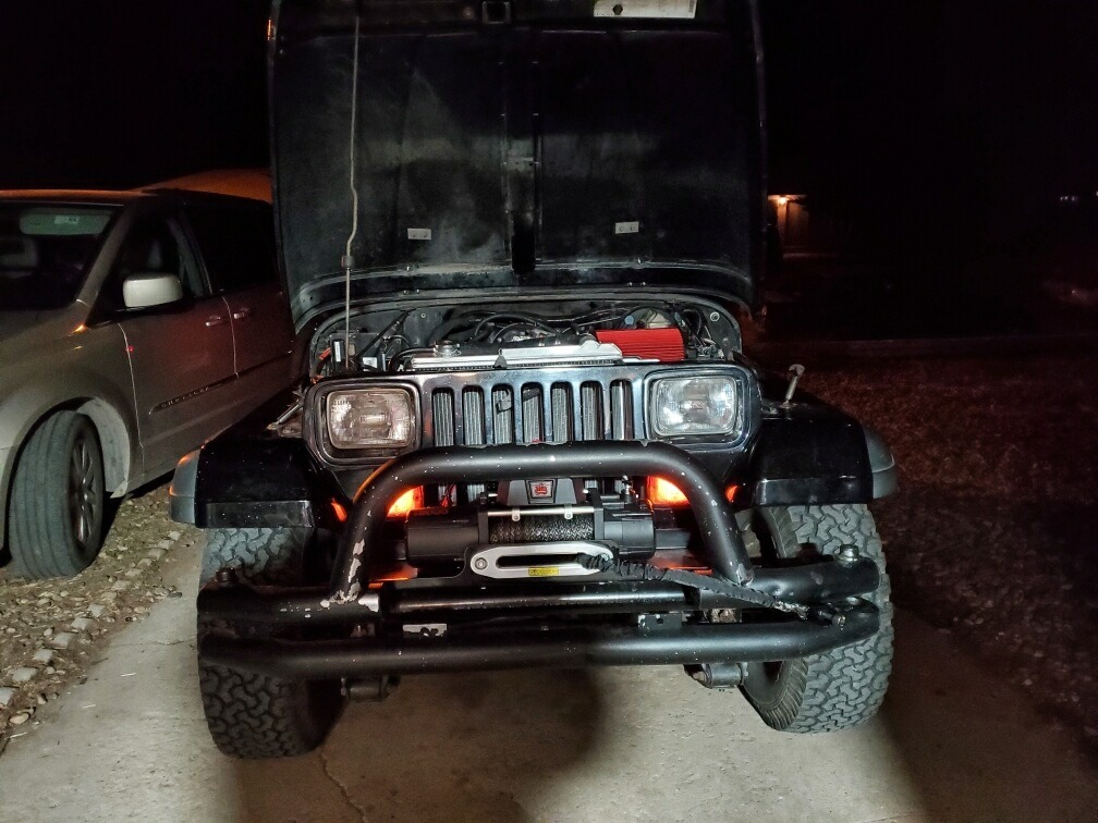

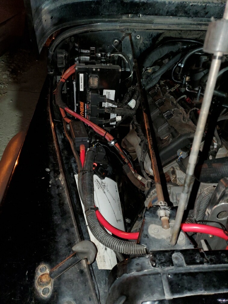

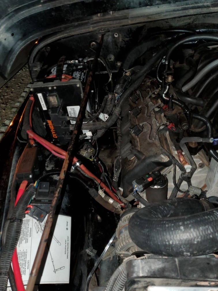

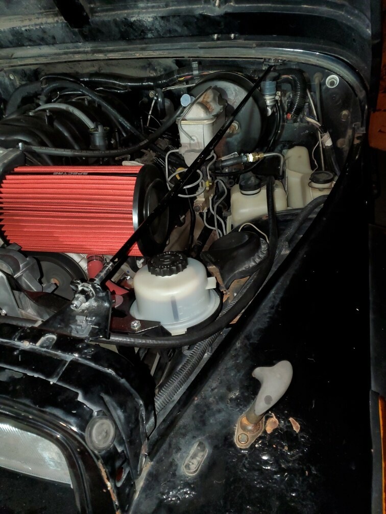

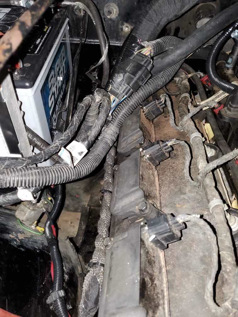

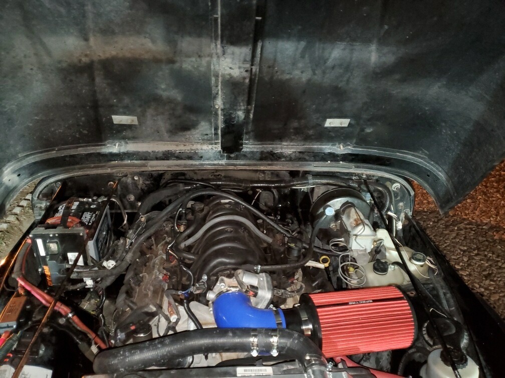

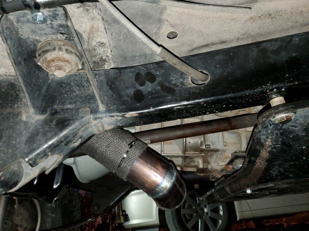

Okay everyone. She is done. Wiring heat shielded. Everything hooked up. And it is way to fast for a YJ. Time to make questionable life choices.

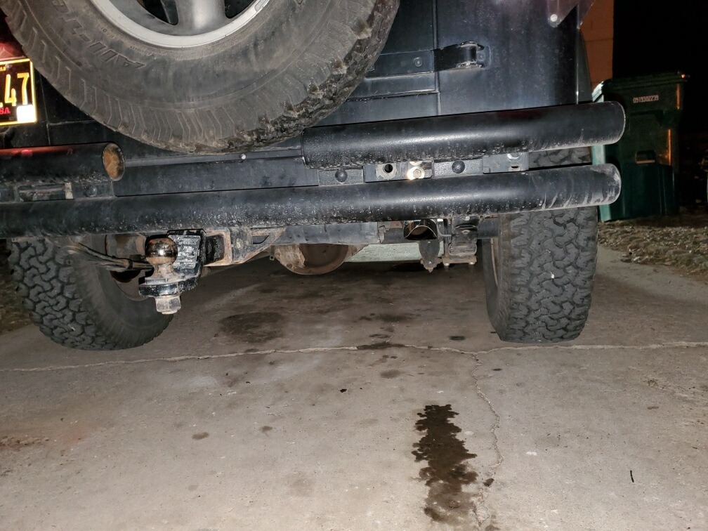

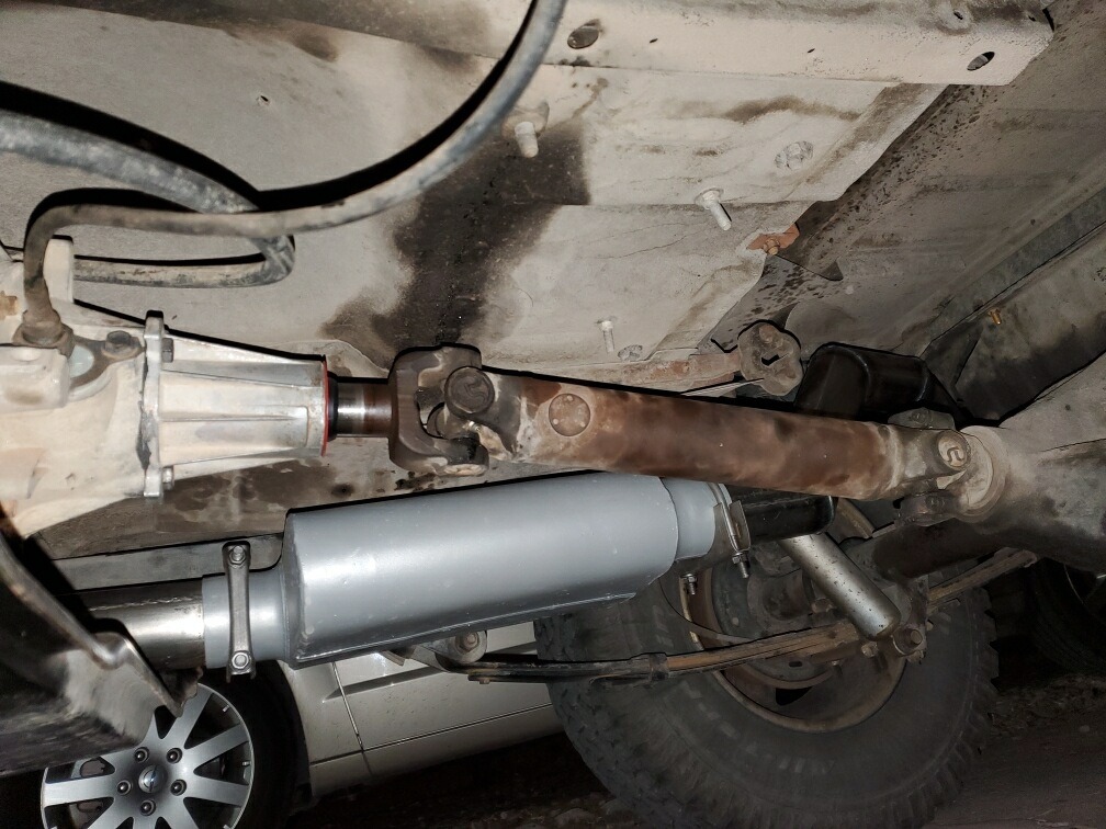

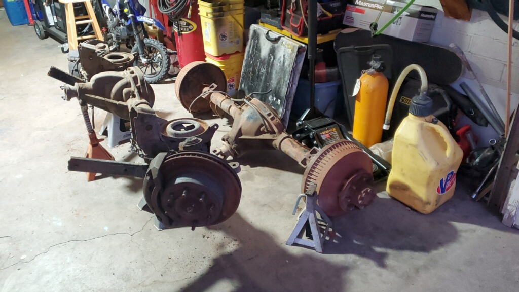

So couple hundred miles in now. Any gear will do. First not needed, second new first, third second first, and 70 mph is the new 55. I am worried about the tiny rear driveline and D35. I need to upgrade before they blow. Salvage some money by selling them.
Okay phase two has begun. Time to reinforce the chassis. I may start a new thread for this but figured I would give a sneak peak. Amazing what you can trade extra parts for here.
It is now officially done. All the hoses hooked up, all the welds painted, and function tested. Thank you everyone for the support and advice. I hope this write up will encourage and help those in the future. Remember, engine swaps are only limited by your imagination and will power. Please reach out to me if you need any help in return.

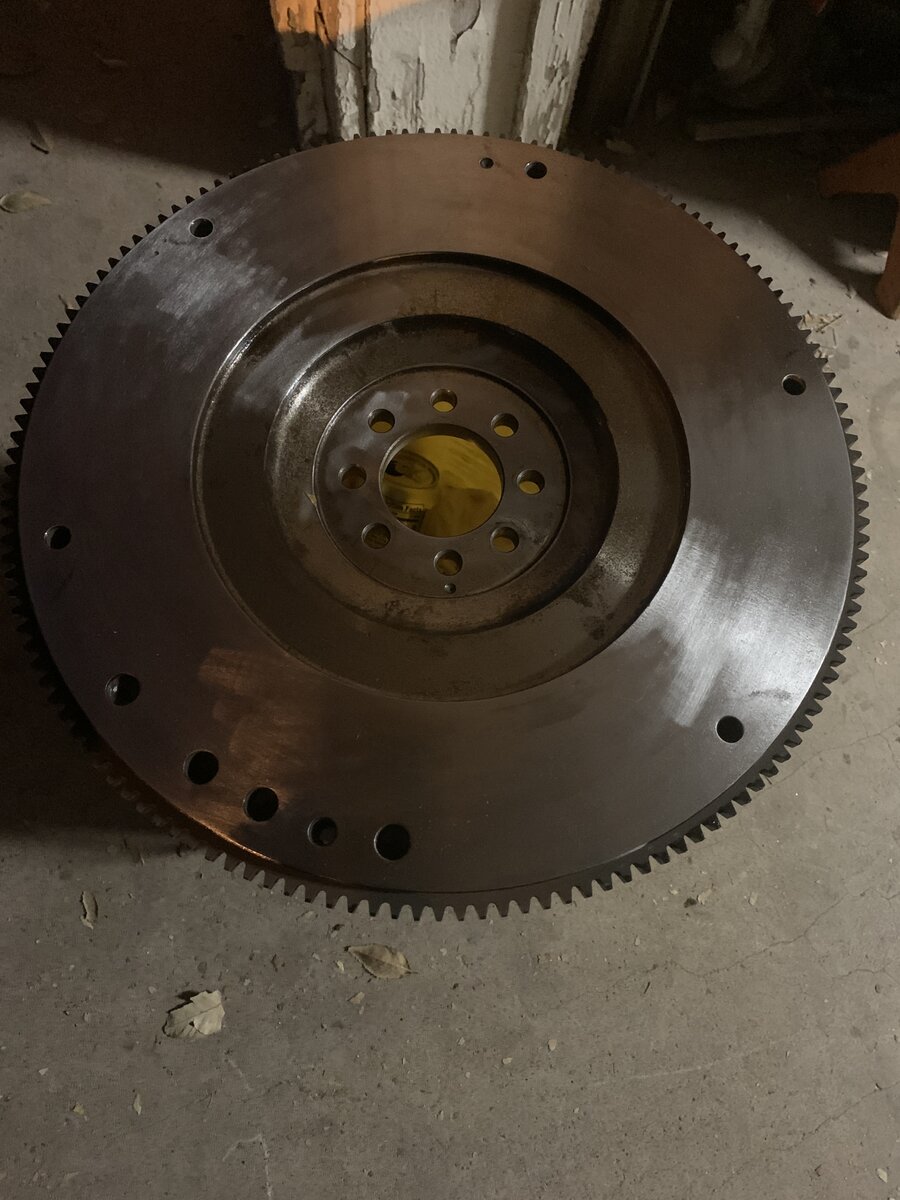

Ok. I need some info from you. Do you have what flywheel to get? And measurements for the motor mounts, so I can weld them in at the right location.
The flywheel was out of a 07ish Dakota 4.7. Any 3.7 4.7 5.7 flywheel should work if its internal balanced 8 hole. I used the holley black heart mounts and they went in exactly as described. I loose set them to verify and they ended up just as described. Holley has the instruction on their website. I used standard Chevy ls rubber inserts but had to grind off the locating tabs.

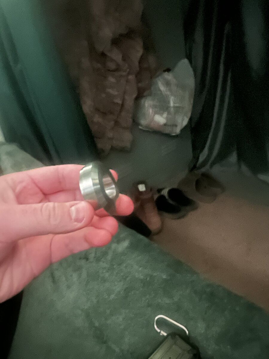

Sweet. Thank you. I got a bellhousing out of a liberty since I saw that it would work, then realized I had to use a 10 3/8” flywheel, and I’m guessing that I may not find the flywheel to mate to the engine. And thanks for your diagram on the pilot bearing, just made one!

The 3.7 flywheel should bolt up that I know of. The 11" Dakota clutch is about what I would say is minimum though. And consider upgrading the traction devices.
