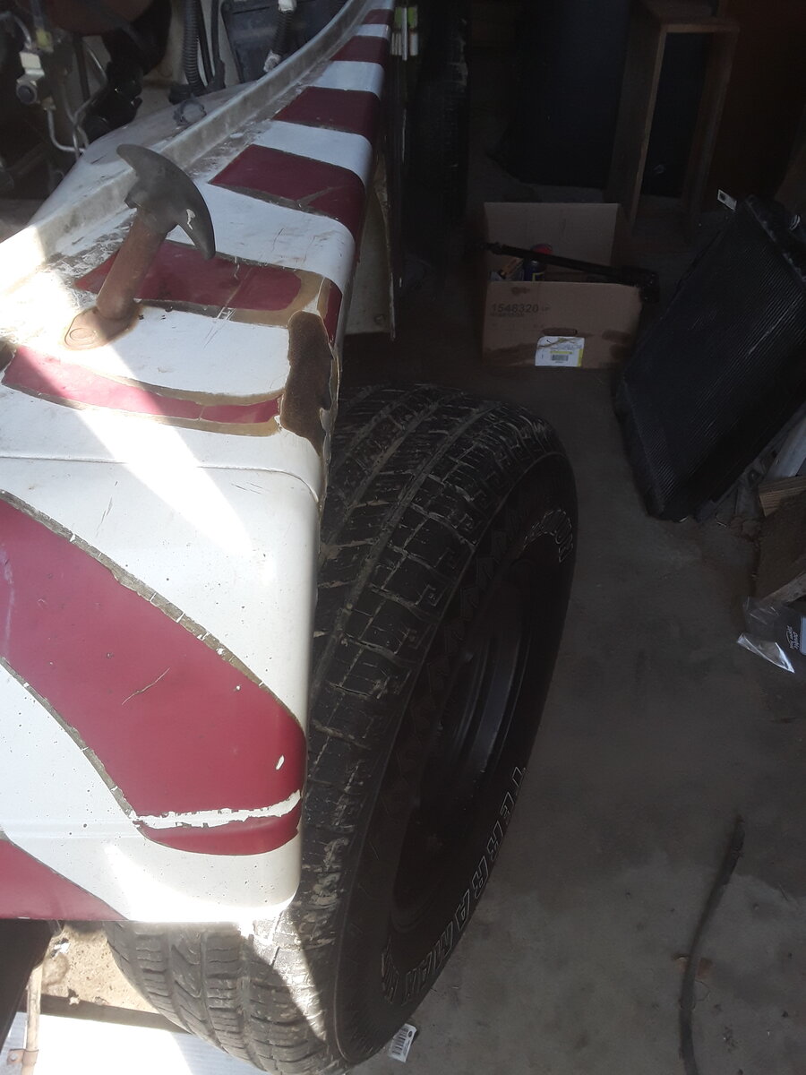

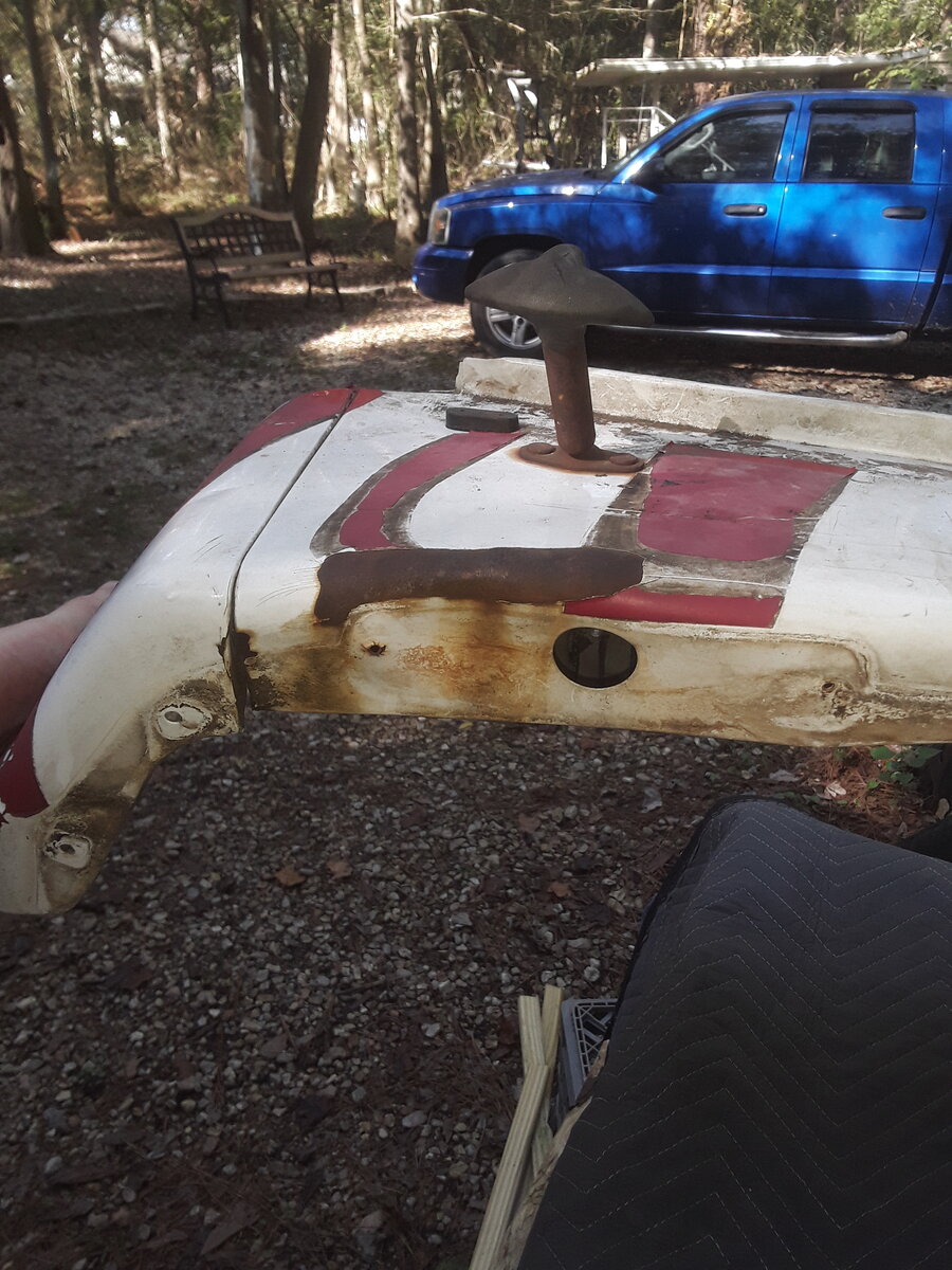

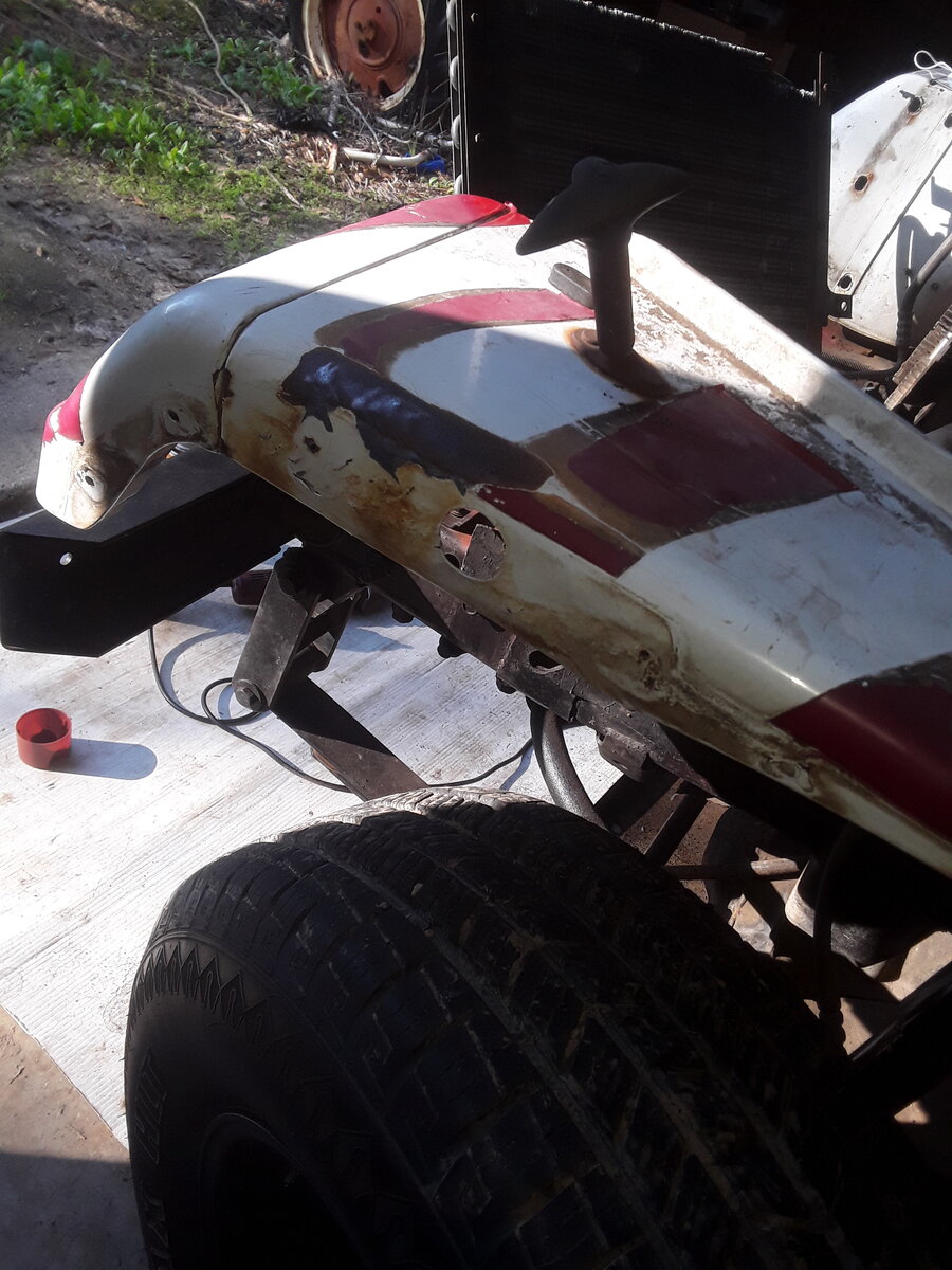

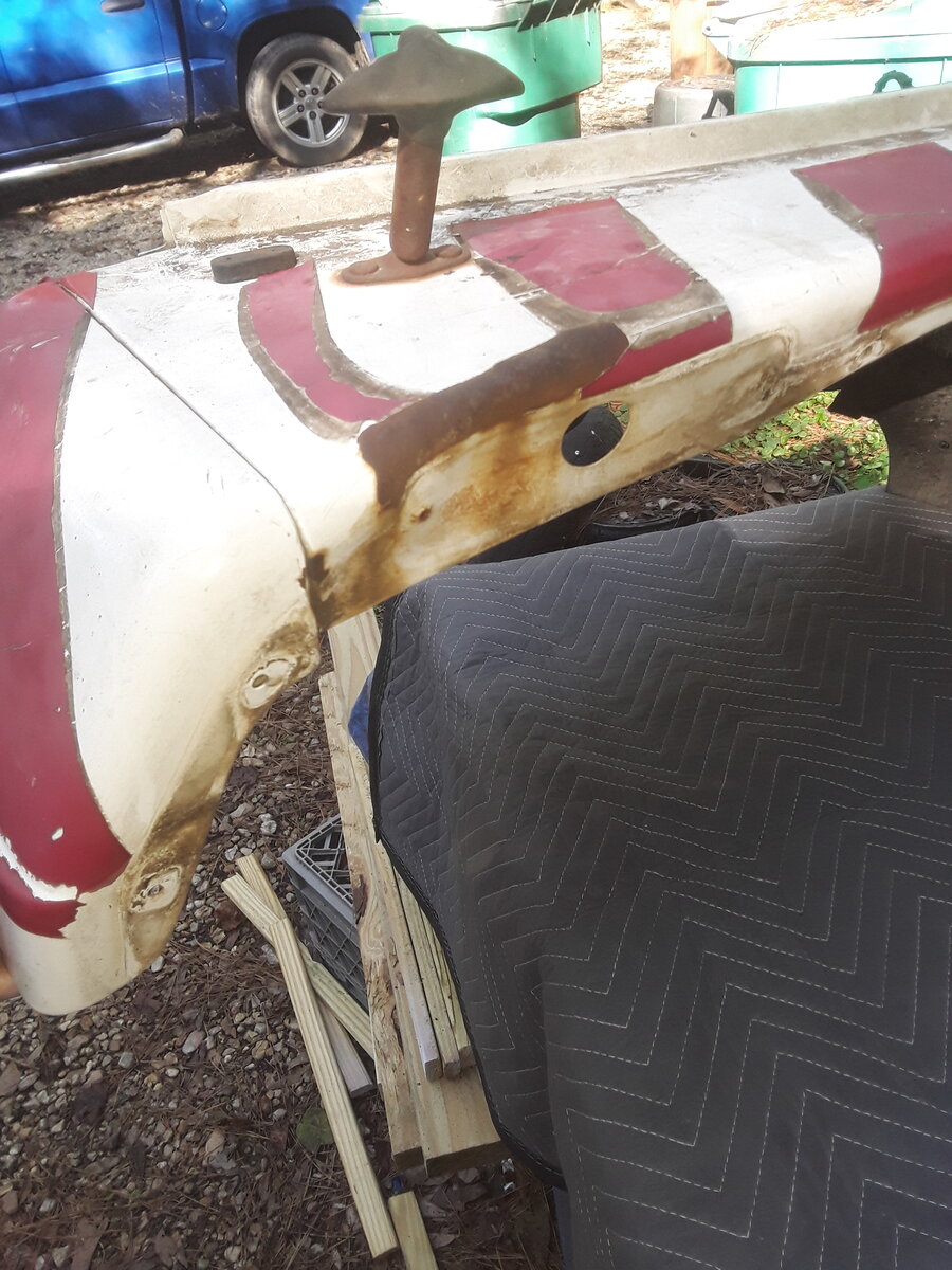

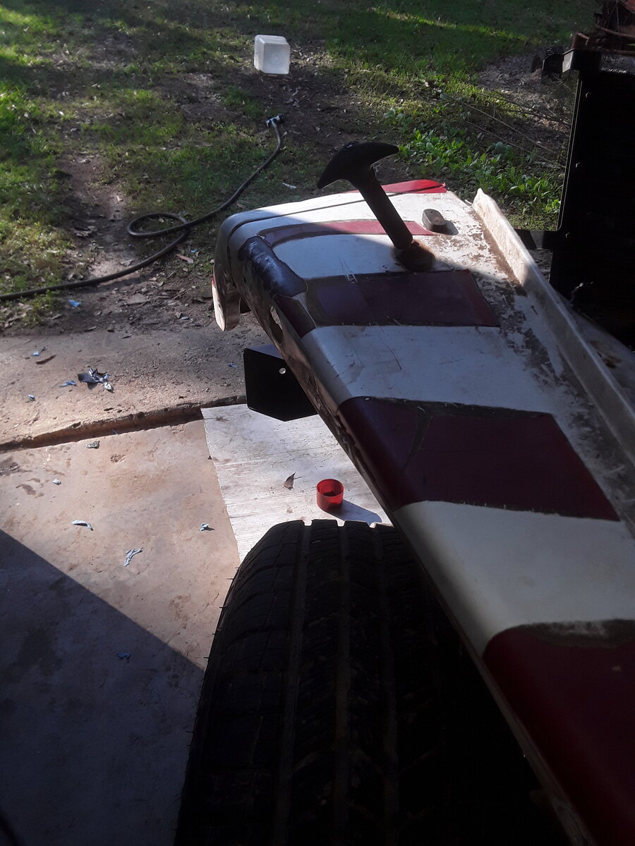

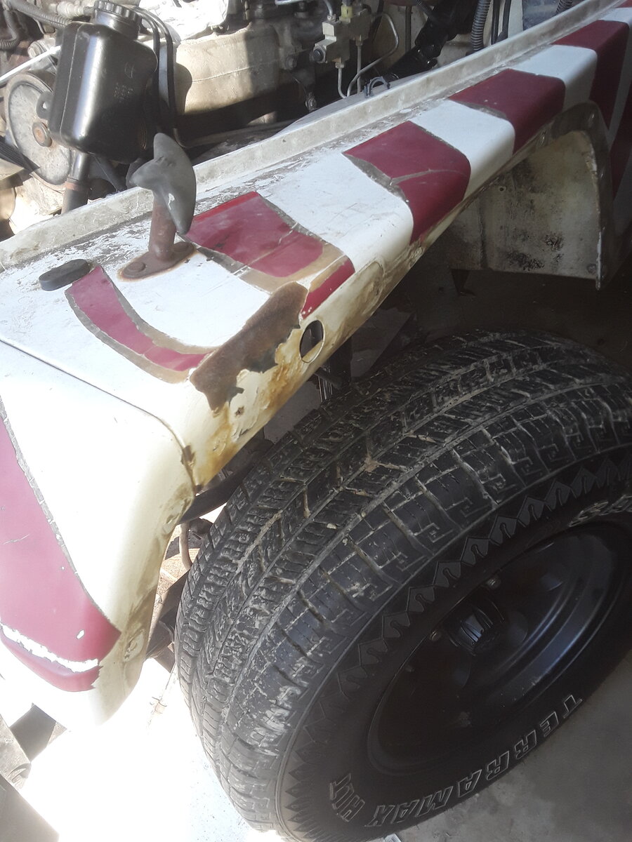

Body work while fender was off and then the after pics with the fender attached back on.

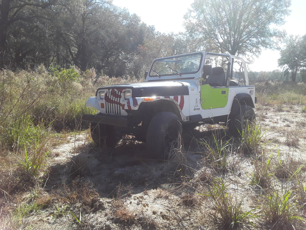

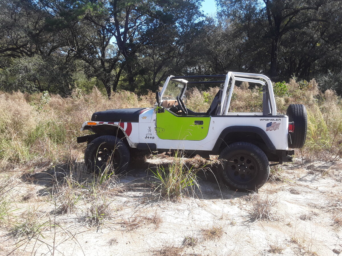

Some riding where there are building up land for subdivisions. Day before my cranking issue. I was also too lazy to put my fender flare back on. It was a B-word to get off in the first place.

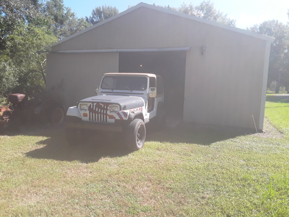

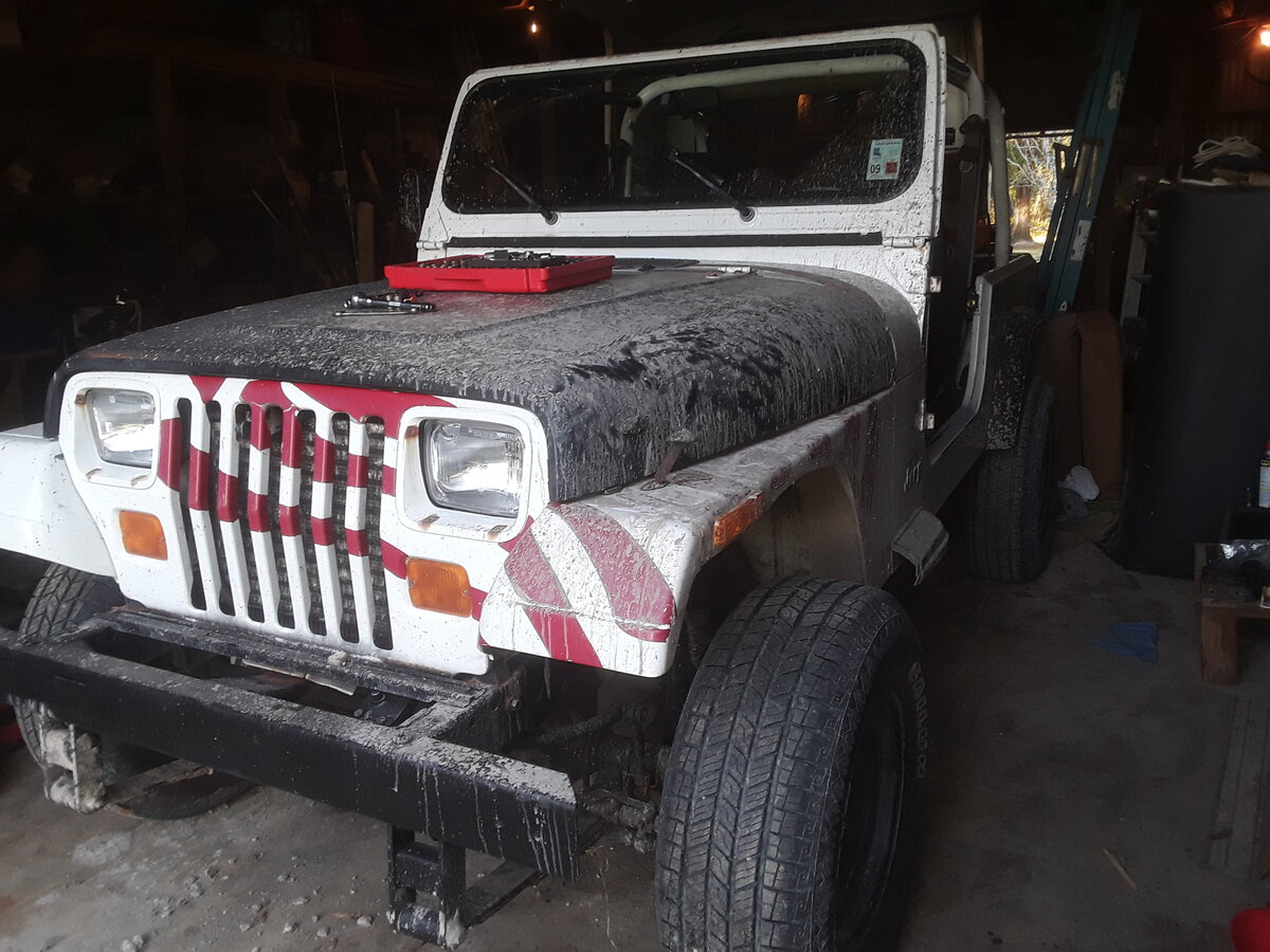

Back in the shop. I have to take a screwdriver to solenoid to get it started in order to move it around the shed. Scares the shit out of me every time whilst banging the back of my head on the front tire.

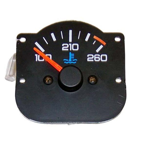

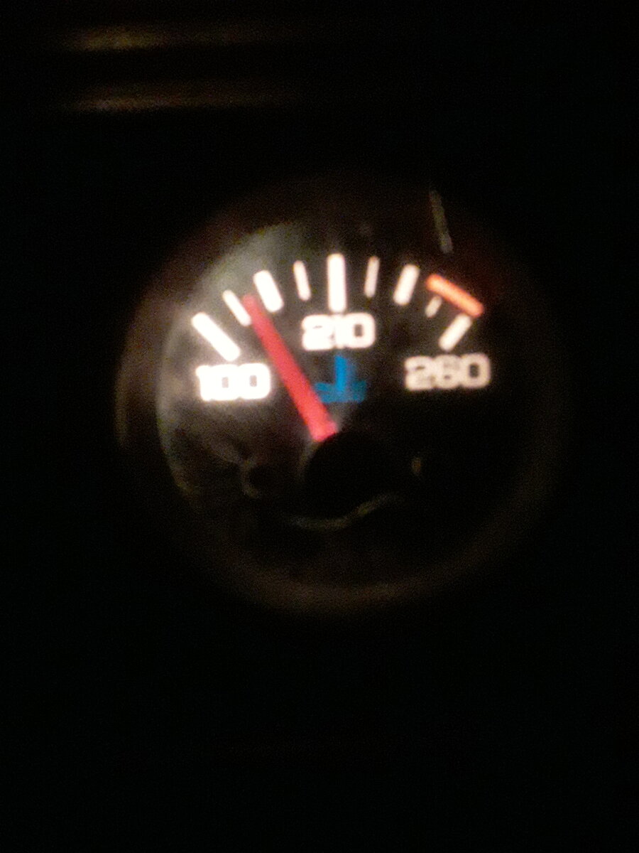

I am not sure if it was burped properly with the 195*F thermos. It was already done before I bought it to bring it home. When I installed my 180*F thermos and got everything back together, and filling in some coolant, I drove it to where I could incline it in order to burp it. It says my Jeep should take 11 qrts, but I think it took in only 8 and that includes the reservoir tank as well.
Right now, my temp reads right below that first big tick halfway between 100 and 210 so 140 150?. It takes awhile for it to get to this temperature sometimes. Before it would read 210 in less than 5 minutes.
Even after driving on the road for a few hours it still sits below the first big tick. Granted, it has been pretty chilly lately in Louisiana.
The only time it went over the tick was when I was riding off road and playing with the 4x4.

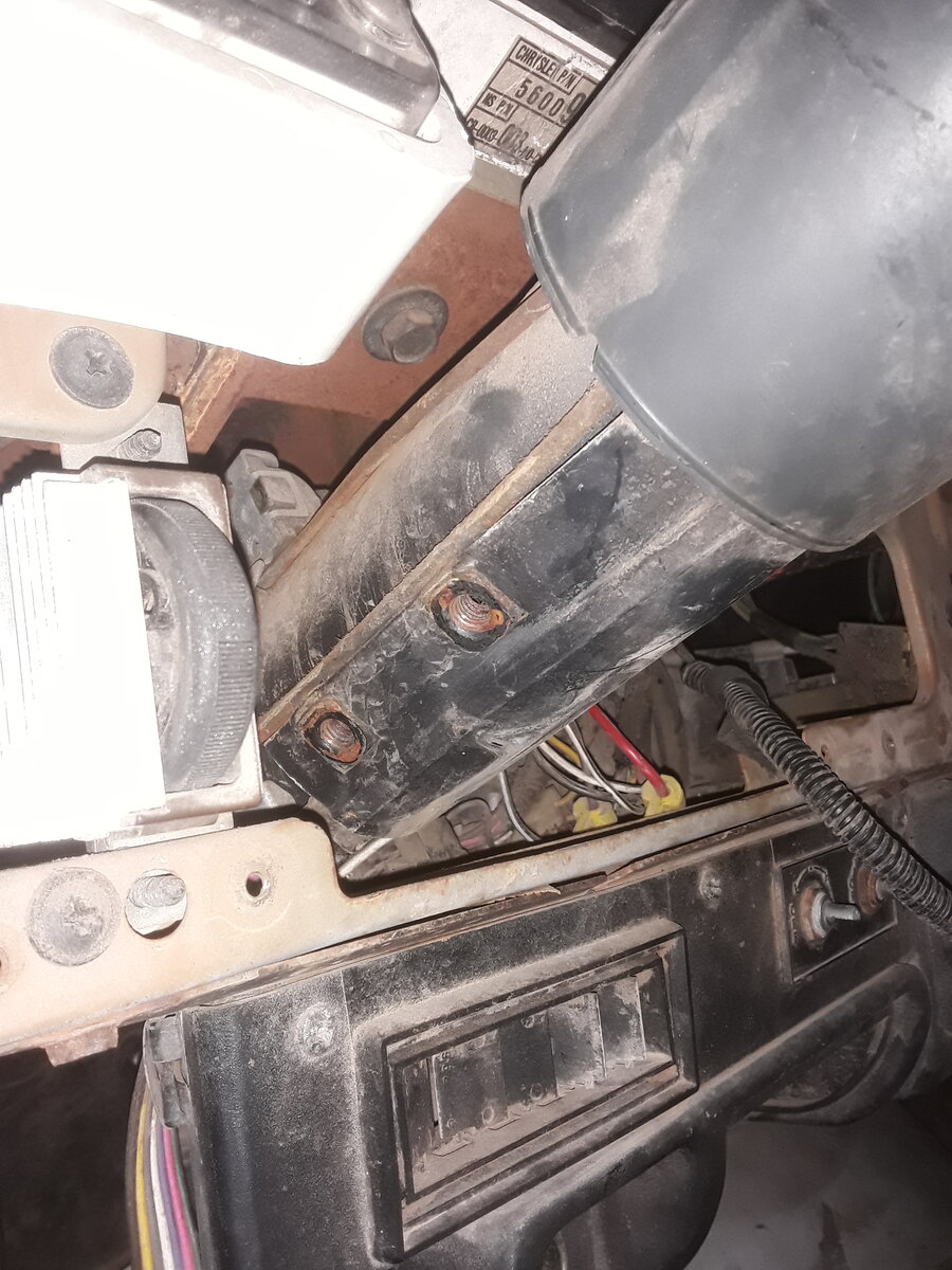

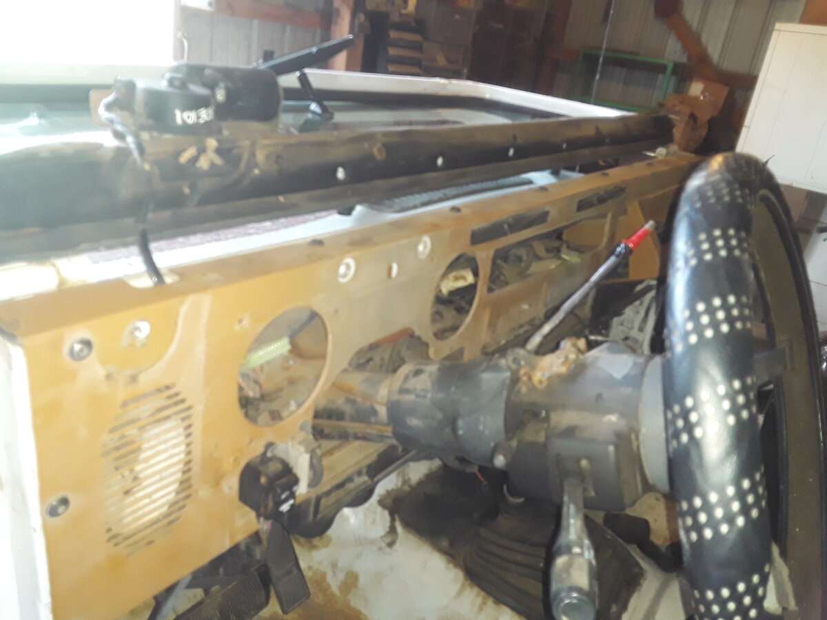

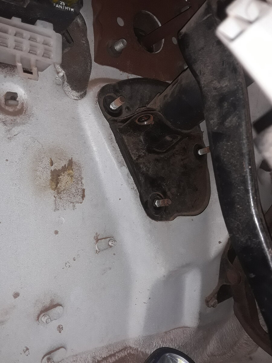

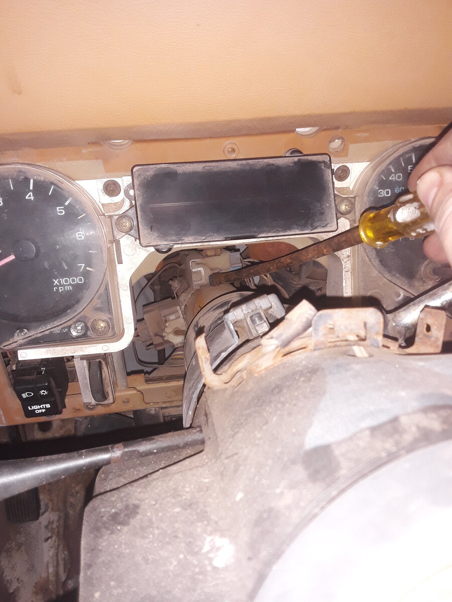

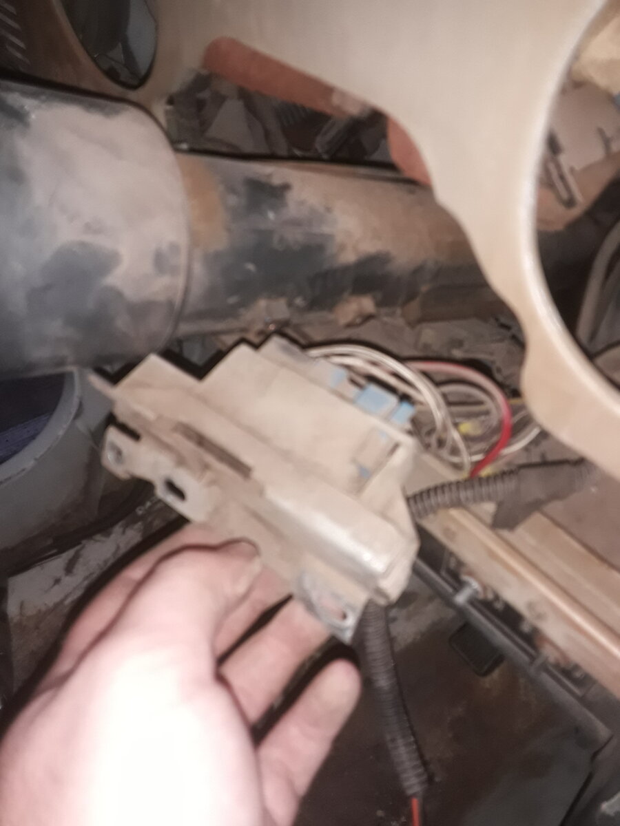

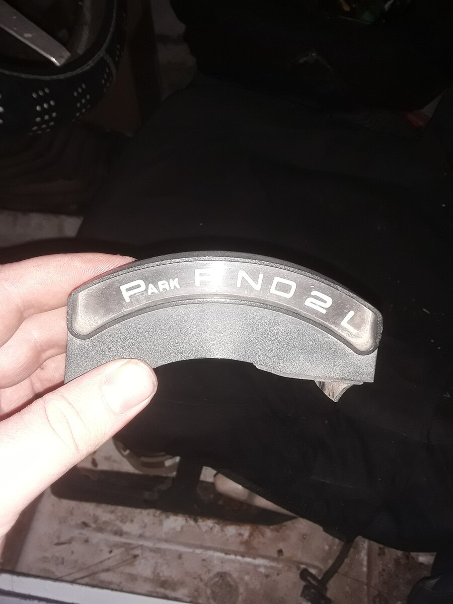

Trying to lower steering column to get to ignition switch. I believe it to be the issue after some help from others. I would also like to try and fix this guy. I my PRND needle is broke.
As stated, thermostat sets the minimum temp, radiator and rest of cooling system sets the maximum temp. The 195° is proper. Mopar thermostats for the YJ aren’t truly from Mopar anymore so my typical default thermostat is the Stant Superstat 195°. I’d recommend going with something similar and of course, not the fail safe version.
As for burping, the system burps itself. A warm up cycle pushes air out as it warms up and when it cools down, the system will suck up coolant back from the reservoir. Keep coolant in the reservoir and do a few warm up-cool down cycles and it’ll naturally purge the air itself. Or, you can speed the process up by using a universal funnel kit and letting the Jeep warm up. The air will bubble out and replace itself with coolant.
Considering how much you flushed it, if you install a proper thermostat and make sure it’s all burped, I think you’ll be ok. 210° is certainly normal and where you want to be. If it goes much past that, maybe look into a fan clutch or a water pump swap.

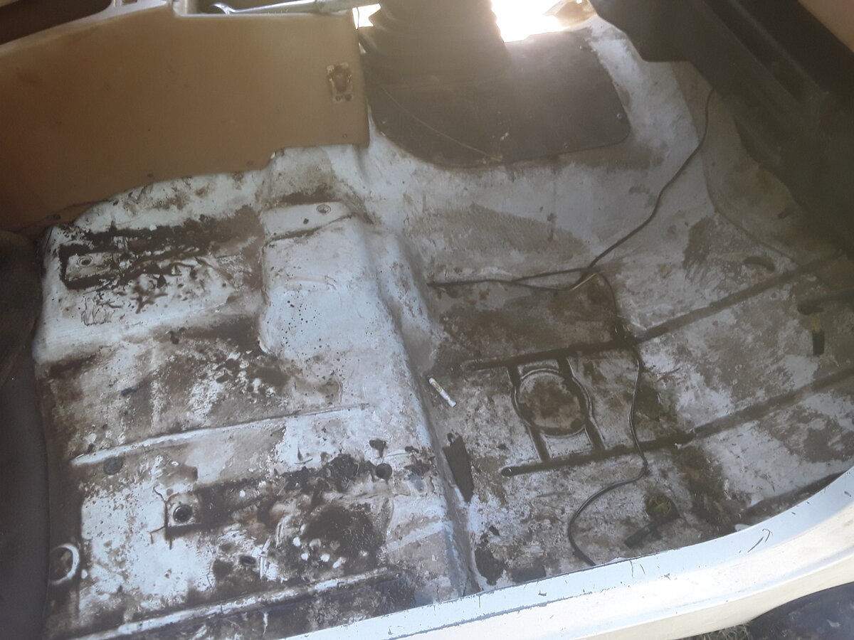

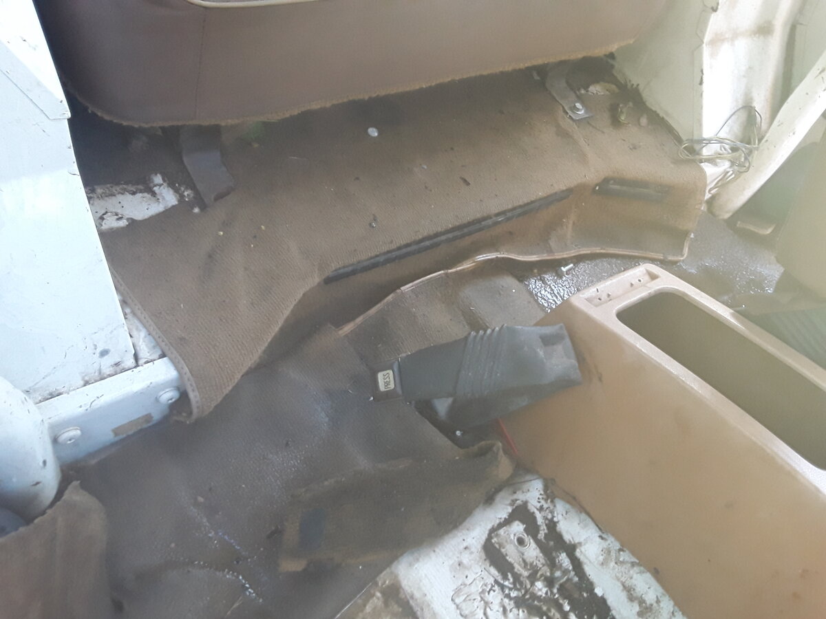

Removed nasty wet carpet, washed and dried out tub.

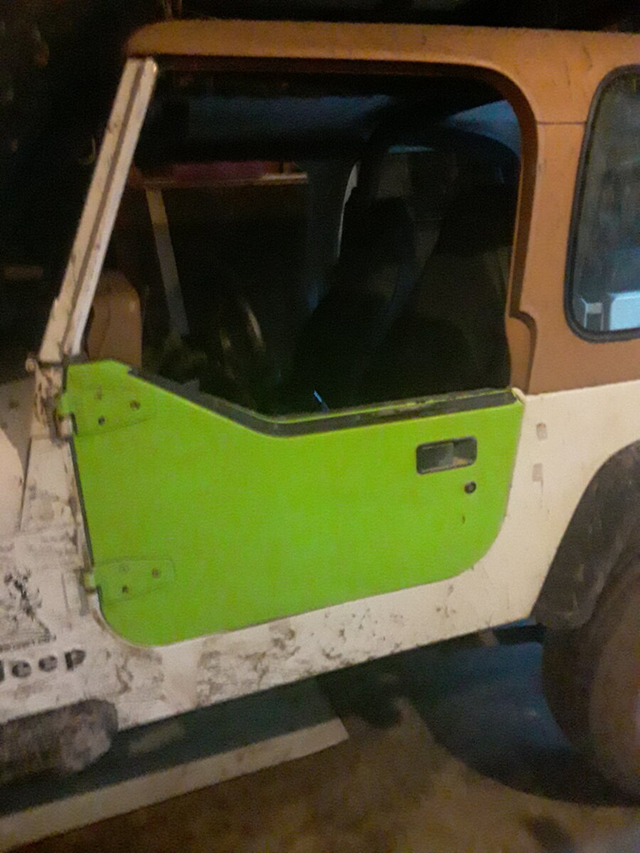

Bought green half doors

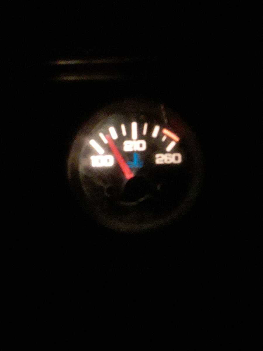

My temps now look like they are reading too low and it seems my thermostat opens up before reaching 180*F. My gauge is new and so is the temp sensor. So idk. I am tired of replacing gaskets. I will add more to this later posts
There's also the sending unit and wire connectors which can be a problem before replacing the sender try pulling off the wire connector and clean up the tab with sandpaper so it gets a good connection.
I had a temp rise off the scale but the engine was relatively cool. I found the connector loose and corroded. Also don't wrap the sending unit with Teflon tape to seal it as it needs to be grounded to the head.
You'll find lots of corrosion on bulbs, connectors and relays as you start digging into it and more often than not cleaning them up first will solve lots of problems.

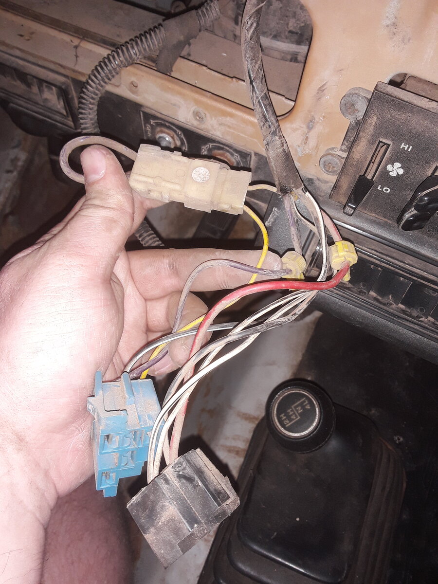

Yea, there is a good bit of clean up to do wiring wise, which was going to be my project this week since I had off, but I am still having the starting issue. Hopefully I will have that figured out tomorrow. I have it narrowed down to neutral safety switch, connection, or solenoid. I don't believe it to be solenoid though.
Reactions: Chris

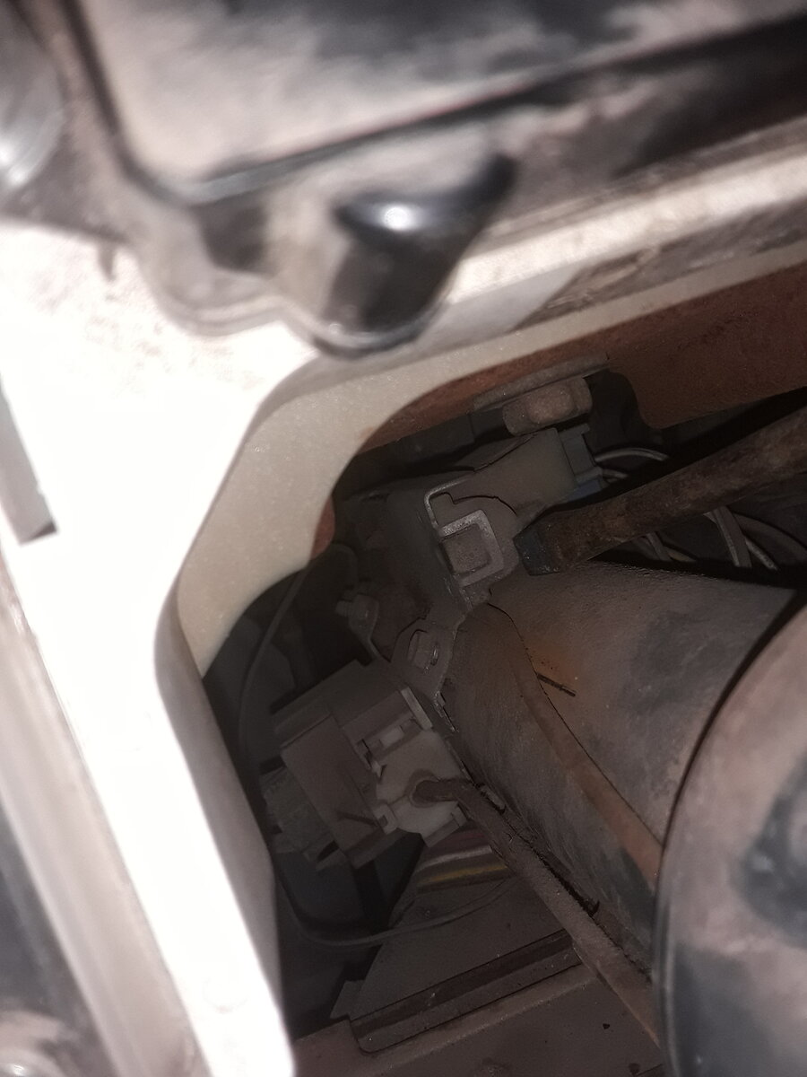

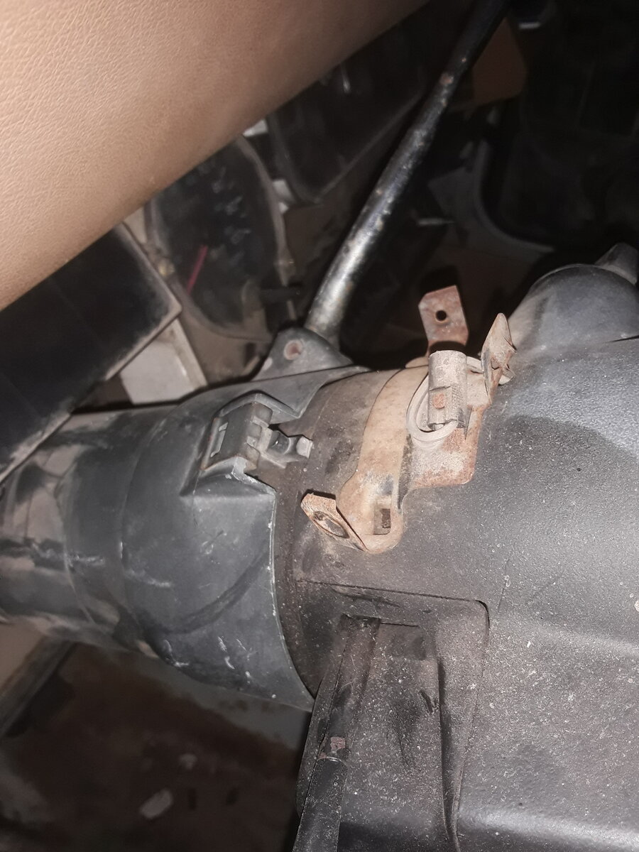

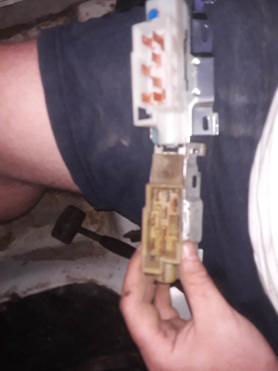

Alright, next update. I got the Jeep starting again Nov. 25. It could have been sooner if I checked the Neutral Safety Switch first! Oh, well. At least now I know how to lower my steering wheel and get to the ignition switch and dimmer switch. Talk about a B-word getting to the bolts underneath on the firewall.

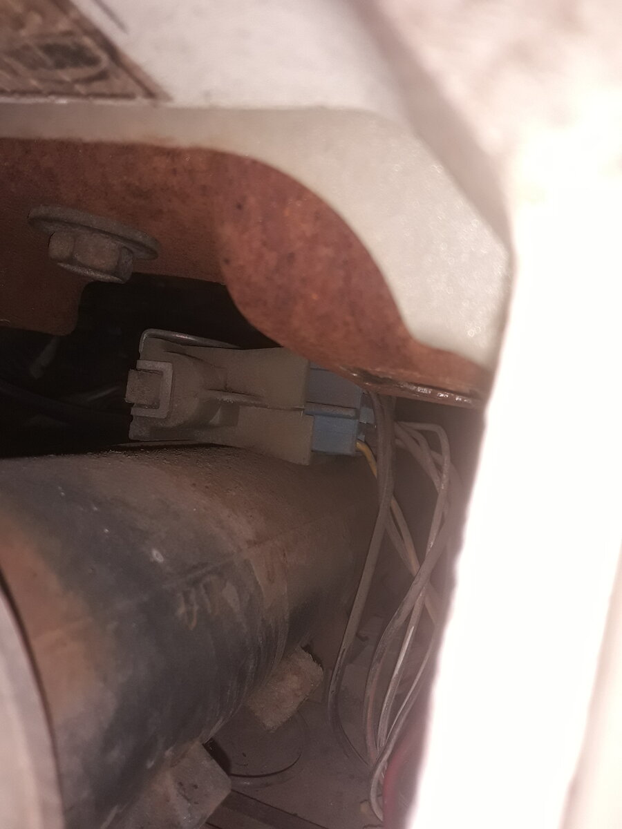

While looking for the Neutral Safety Switch, I couldn't help but laugh when I saw it looking at me. Hey little guy!
After running back and forth to Autozone, on the forums, and diagnosing different things, all it was, was the NSS being unplugged.

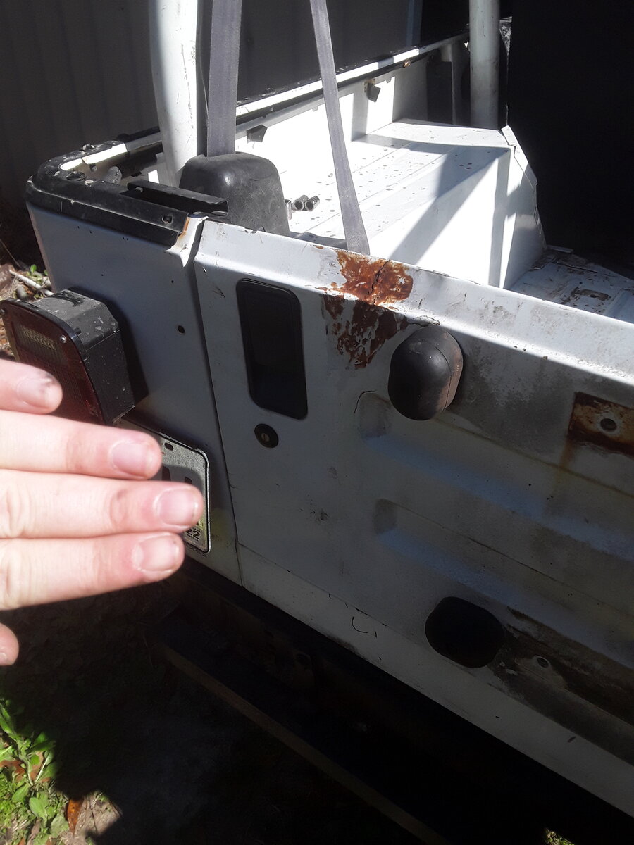

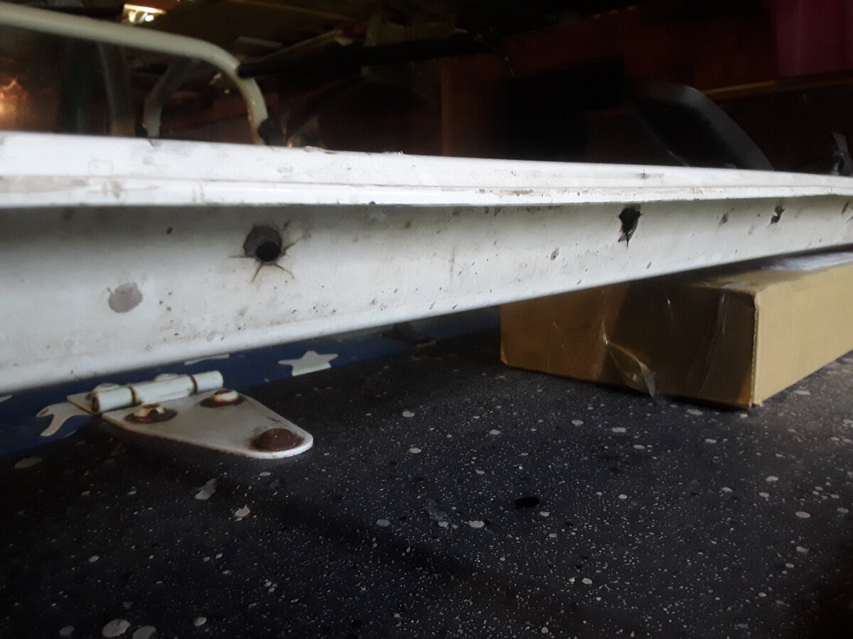

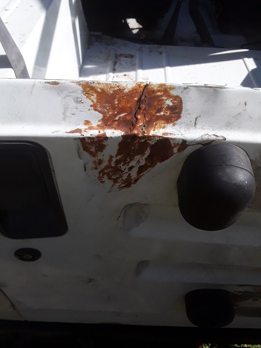

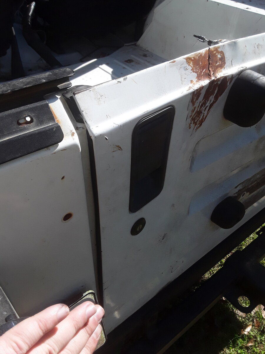

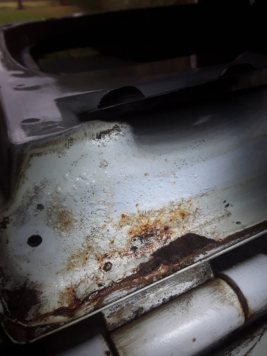

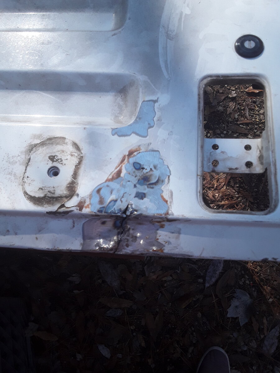

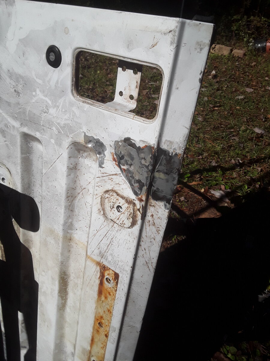

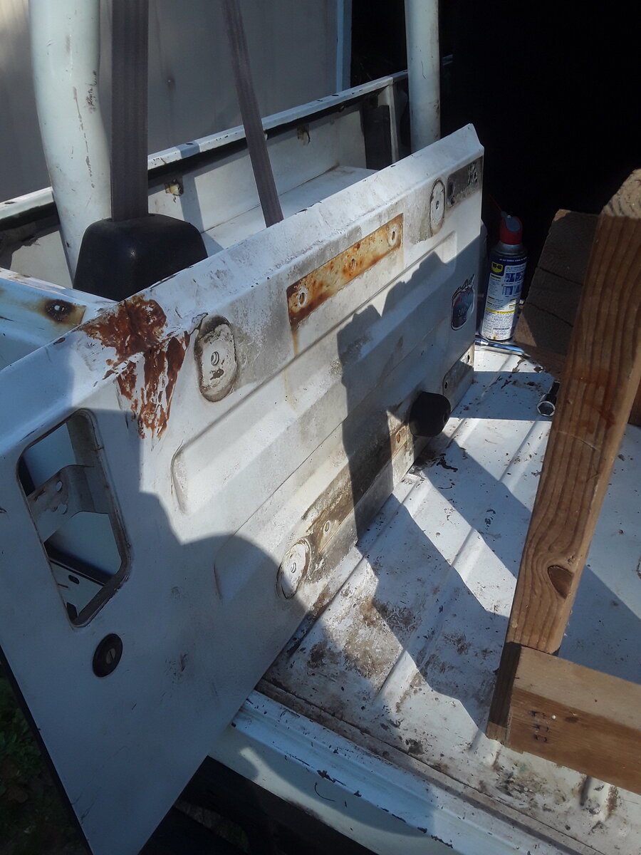

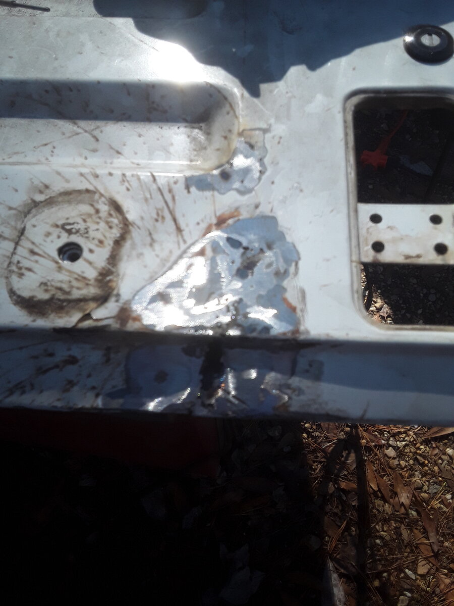

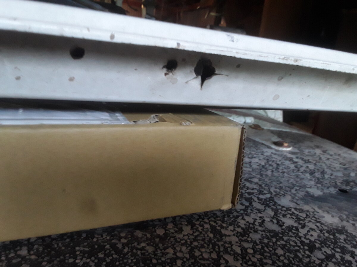

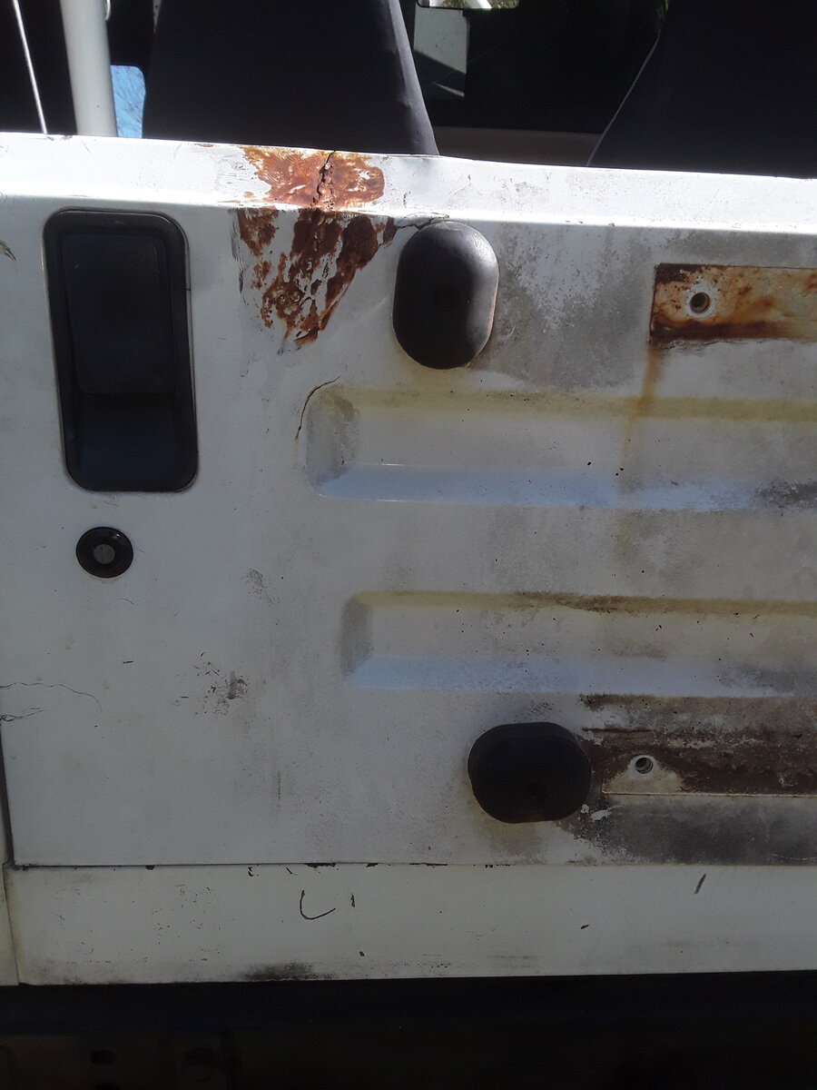

Dad tried to help fix the damage to the tailgate. He sanded it with a grinder and tried using a Mig Welder, but the tailgate metal was so thin, it kept making the hole bigger. He added some stuff to cover the holes that has to activate in the Sun and sanded that down. I will have to double check to what he used. Here are the before pictures:
