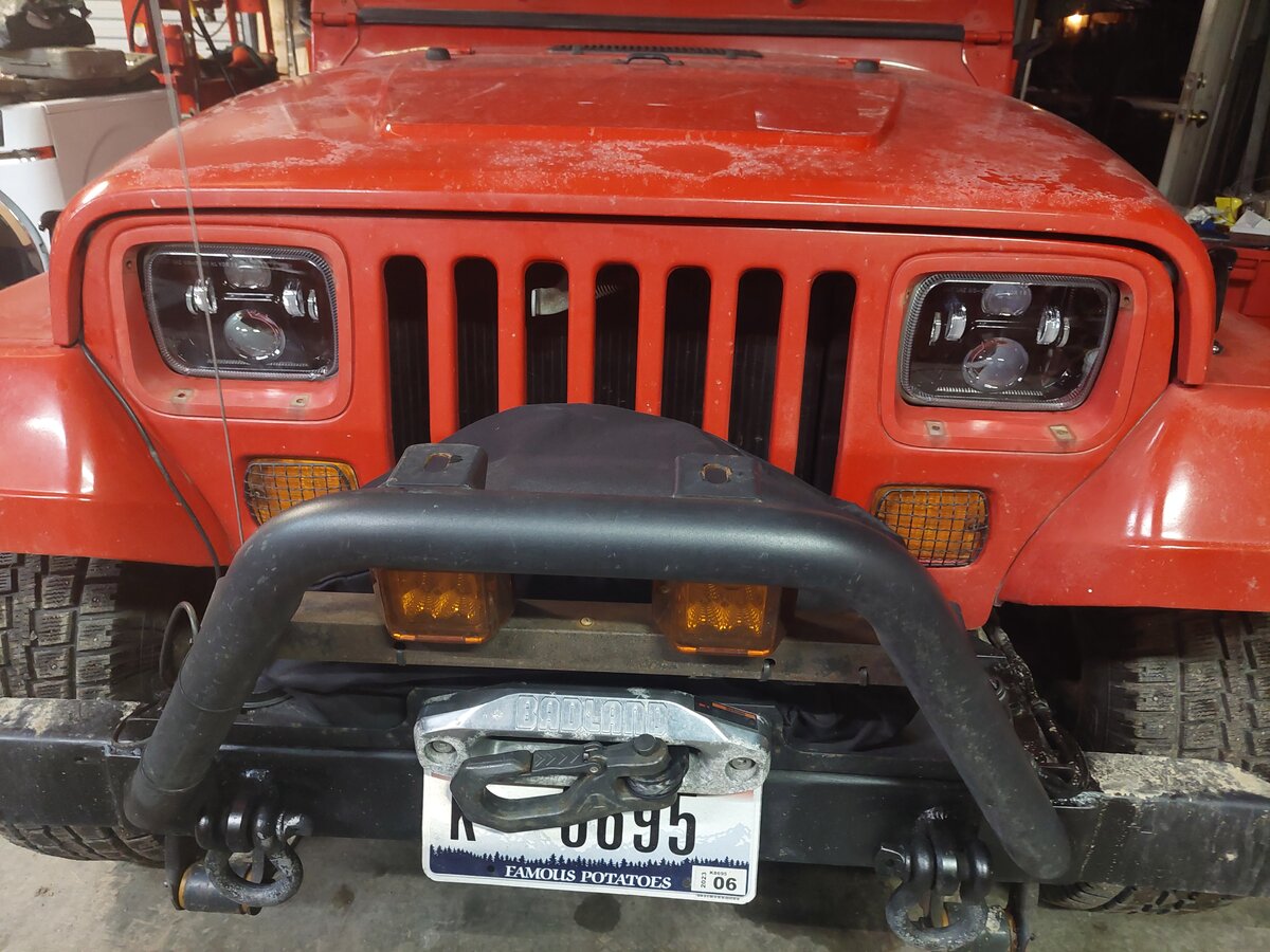

I took a chance and bought some L.E.D. headlights for the jeep. Expectations were not very high for this project and I half expected to send them back and ask for a refund. I WILL NOT drive around blinding oncoming traffic, however the stock headlights were [so bad], I had to try something. ...so I set a budget and started researching. I wanted to stay around ±$100.
My research led me to these lights:
New Osram Chips 110W 5x7 Inch Led Headlights 7x6 Led Sealed Beam Headlamp

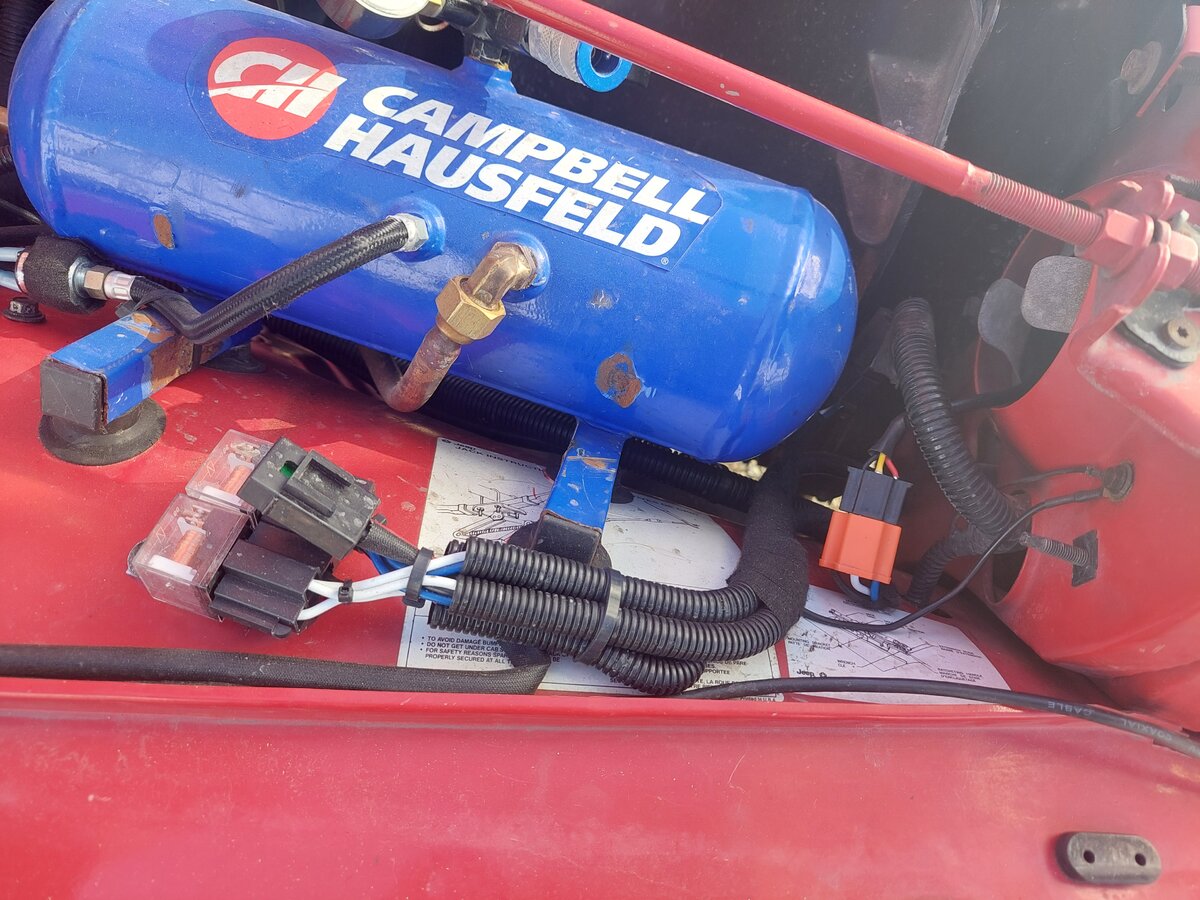

Paired with this low cost relay harness:
RENMAII-LIGHT 1Set 2-Headlight H4 Relay Harness

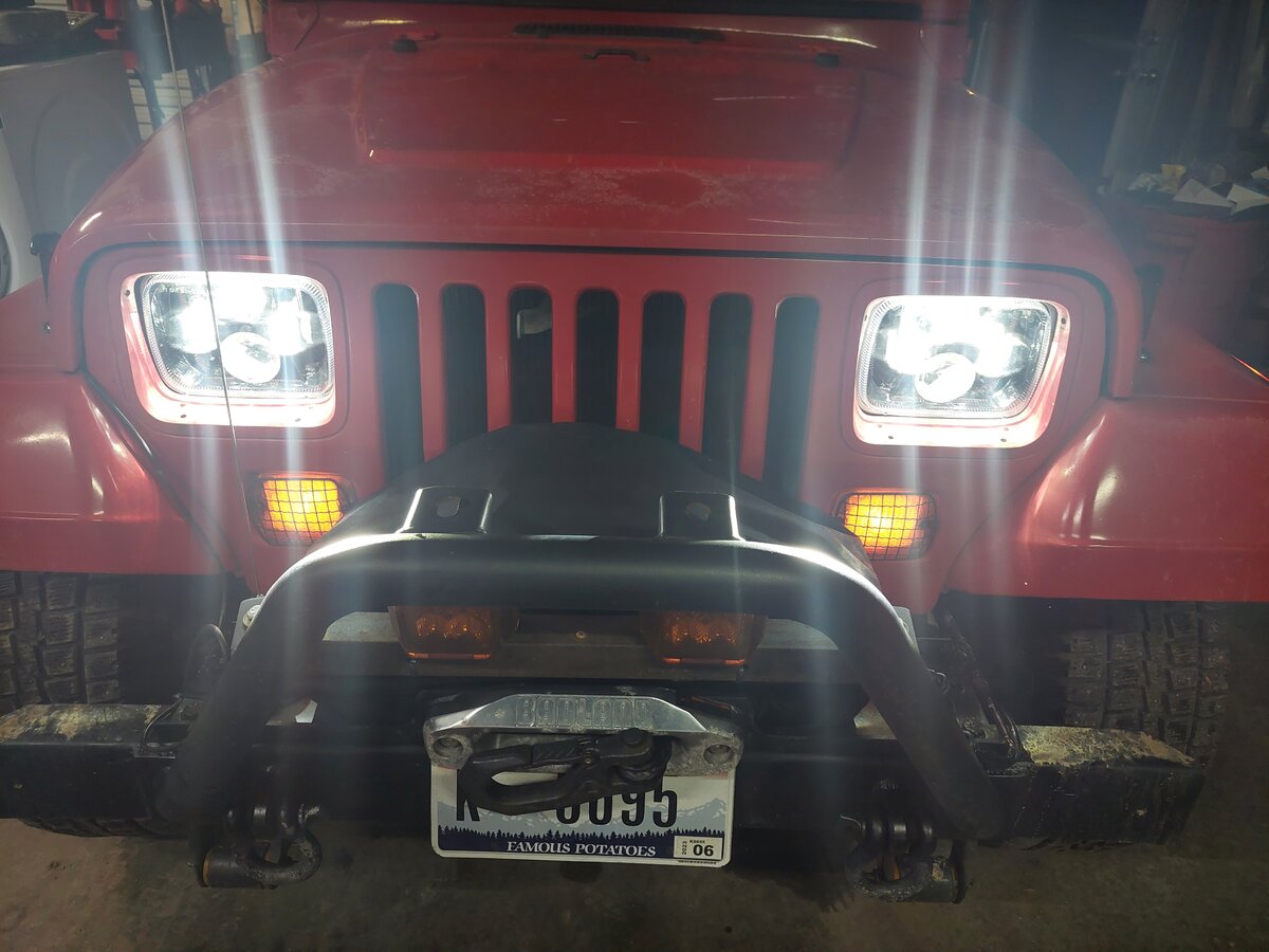

The light output is excellent. The color is a bit whiter than I would prefer but it's not obnoxiously blue, it is on the edge of acceptable.
The beam pattern is decent, it isn't perfectly smooth, there is some banding and a little shadow directly in front of the vehicle, it isn't too bad. After a couple weeks of driving it, I don't even notice it. Kinda like YJ windshield wipers
[ ___ /____ /]
The light spread is very wide and they illuminate the ditch remarkably well.
The most impressive part of these lights is the cutoffs. The light is cut off crisply, you can aim these lights straight ahead and not blind oncoming traffic, it's actually quite impressive. These lights are bright without being dangerous. I am quite happy with them.
Bottom line; I recommend these lights, they are a good upgrade. Longevity is still a big unknown, they've only been installed for two weeks. I will update this thread if they fail prematurely, or later on for a long term review.

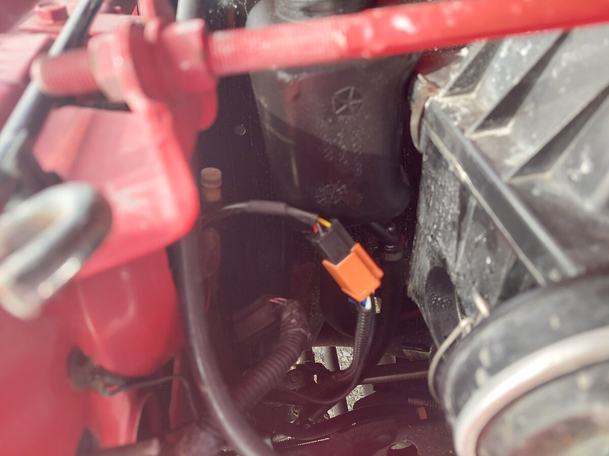

I actually installed the relay harness before the LEDs in an attempt to brighten the halogen lights. The results were unremarkable. I left the harness installed when I switched to LEDs. I have heard that the LED headlights can flicker and dim without a relay harness. Even if they dont flicker, you will get true battery voltage with the relay harness providing better brighter light. Is it necessary? I don't know 😕 but I have one.

Nothing wrong with having the harness in place. The flickering is usually on the JK Jeeps because they have a canbus system that doesn’t like LEDs. They need an adapter harness to overcome that Have never seen an issue in a YJ or TJ. Anywho, you are not wrong that you are now getting battery voltage and before you were probably getting a volt or two less. Usually doesn’t matter on low draw LEDs, but sometimes does and sometimes contributes to early death even if the LED prefers to be over a certain voltage. I’d leave the harness in since you have it already.
