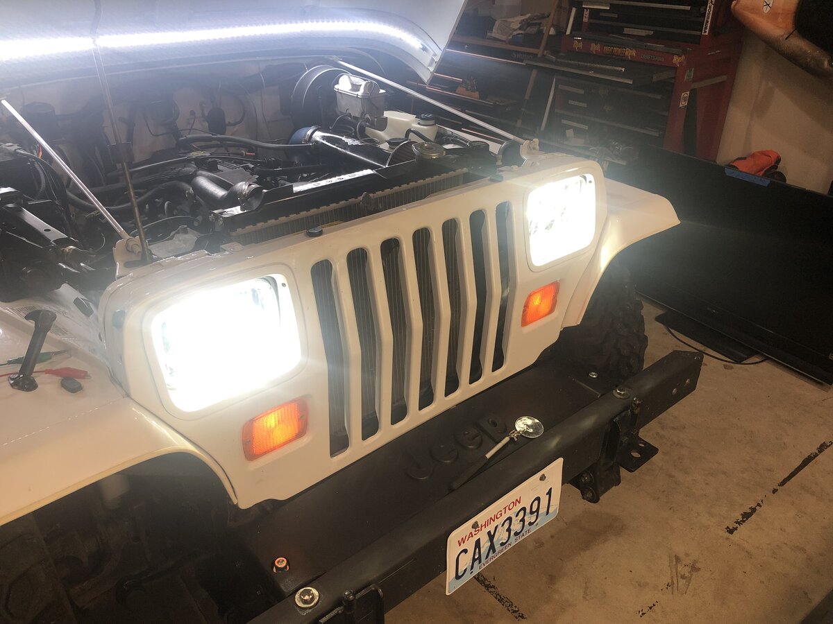

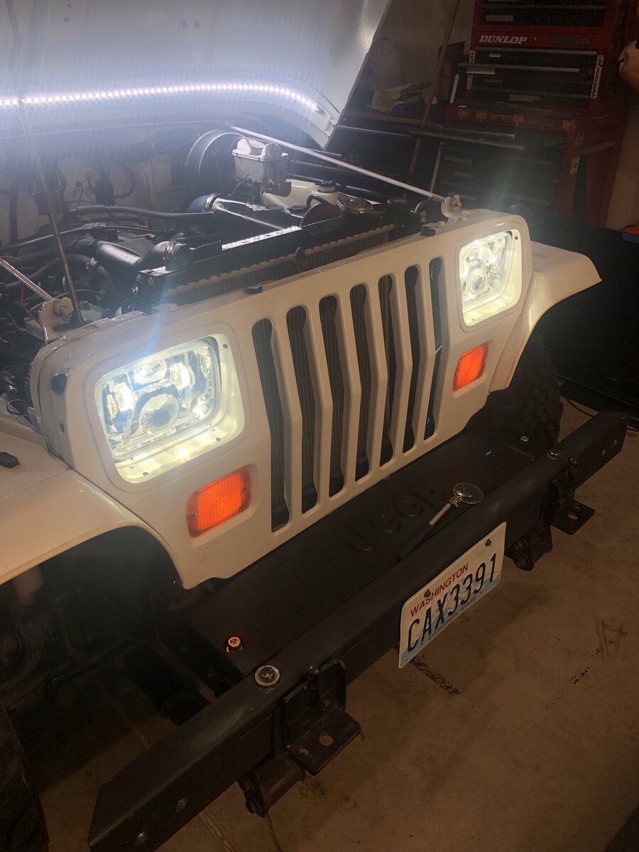

Just for clarification…by “unremarkable “ you mean you were not impressed and the lights did not show positive results right?
Do you think it would be ok NOT to use the harness and just hook directly up to stock headlight connectors? Would they overheat?
You’ll be fine as long as the lights don’t draw much. Stock lights draw 35W each (70W total) on low beam. 130 total on high beam. The stock wiring is pretty poor but you won’t have a problem if it’s in decent shape. Most LEDs will be less draw than stock was, so I’d give it a shot.
The pic where you can see the lights better is where I touched the phone screen during the picture to get the brightness to go down.
I did install the wire harness and try it; however, it seemed to have just a tad of a flicker. Not the best Chinese connections, but I do have the harness if needed.
Yep, going to give it a go. Will check heat on plugs after a short drive. These things are freaking bright. LOL
i imagine you’ll be just fine. Your LEDs should be drawing considerably less than stock. Problems usually come up from many years of the stock lights (or brighter) pulling too much power through the headlight switch. Then the corrosion builds up and adds a bunch of resistance to the circuit. If the LEDs are working ok then I imagine they will live that way forever.
I read somewhere last night that the high beams draw about 35W total. Give or take a smidge. Anyway, no issues so far and I returned the wire harness to Amazon today. No radio interference either. I read some people had that.
