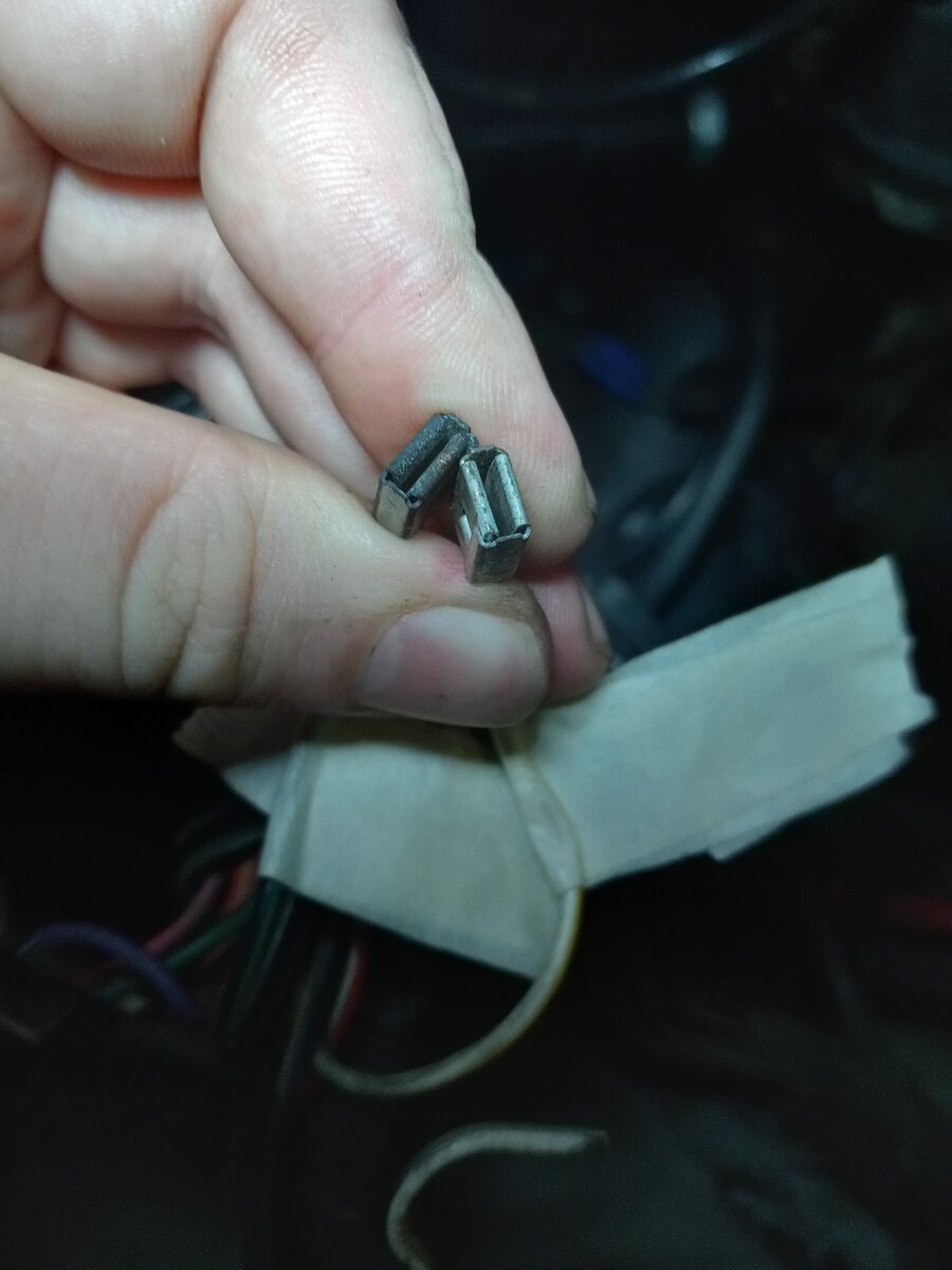

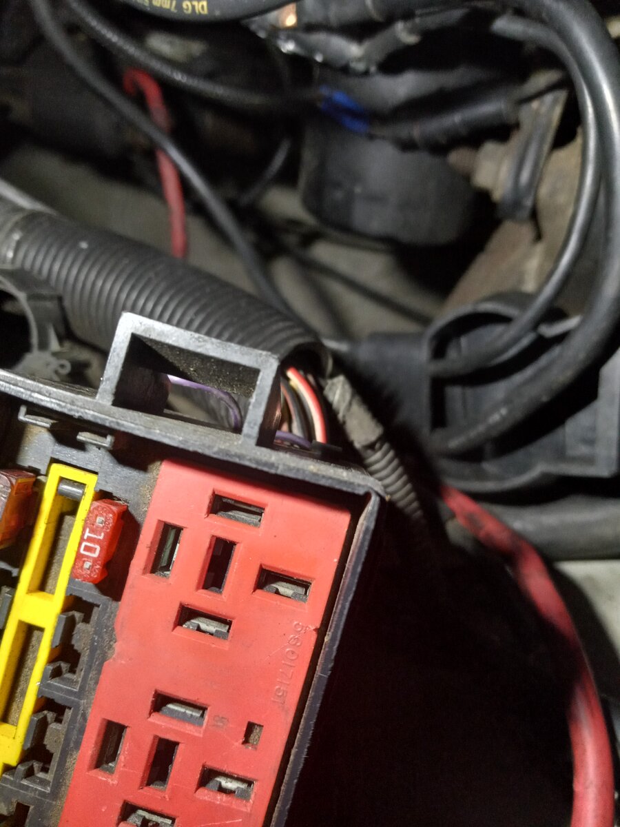

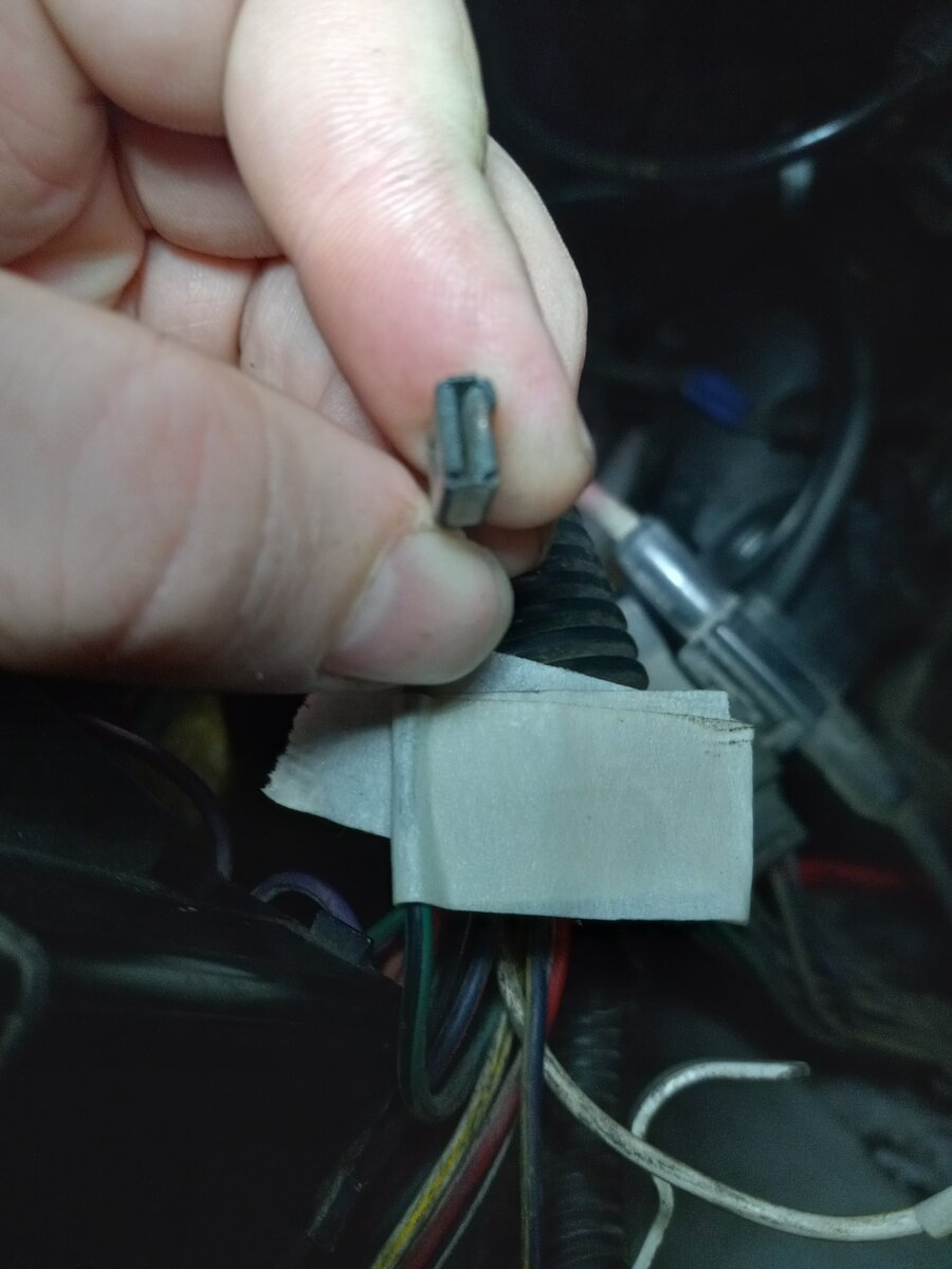

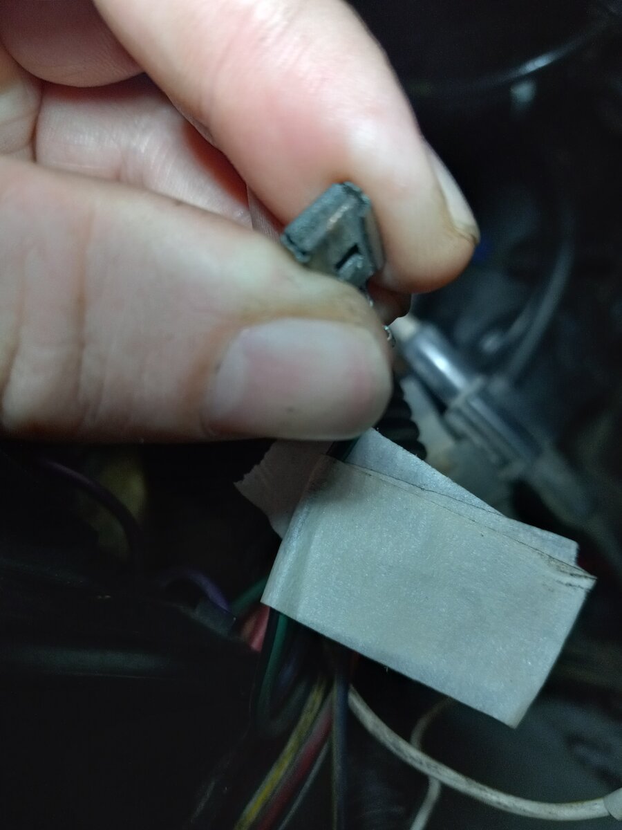

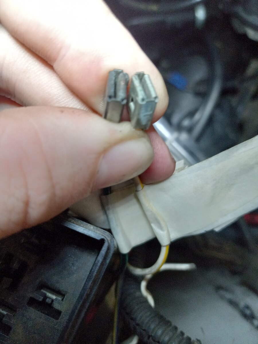

If that is the problem, pull the relay box up off its mount, pull the loose terminal out from below, and pry the locking tabs so that it firmly pops back into the box.
If that isn’t the issue and it’s more like a bad contact with the relay issue, then you may need to get some terminals and crimp one on
None of the terminals were loose. Where can I get terminals like that? Are they the 6.3mm? Nothing appeared on Napa. I may have to order them off amazon.
I don't remember what terminals they are, and I've seen multiple forum people on various forums say YJs use a specific terminal and then another person says they use a different type. So I'm not sure what is actually correct. Anywho, so if the terminals aren't loose, and jumping them worked, then do you just need to put in new relays?

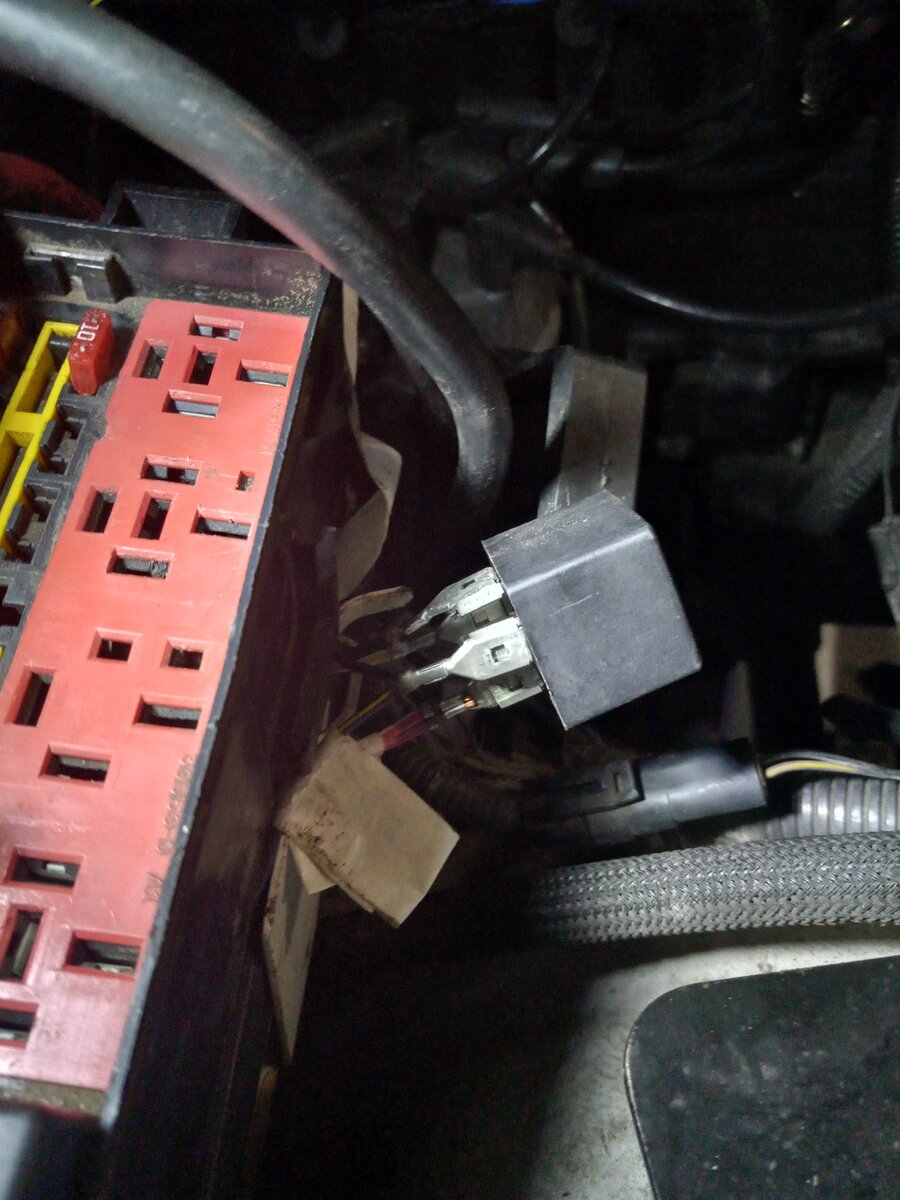

I thought you felt the relay click previously which would indicate the relays are working and that your pump didn't work since it didn't power up at that point. Although, when you turn the key, the ASD relay also triggers. Maybe that is the relay you felt, since it's in close proximity of the fuel pump relay. You may have felt the vibration from one transfer to the box and make it feel like the fuel pump relay clicked when it didn't.
Something else you could do is make sure the horn works with it's relay, then drop it into the fuel pump spot and see what happens.
My horn hasn't worked since day one. I pulled that relay out and it is in a parts box somewhere because I assumed it was broken when testing my fuel pump at another point in time. I did switch around the other relays. My ASD, starter, and I think the ABS are all the same 5 pin relay.
As far as I remember every single relay is all the same part number, which yes happens to be a 5 pin although I believe all of them use them in 4 pin style. Doesn't really matter though.

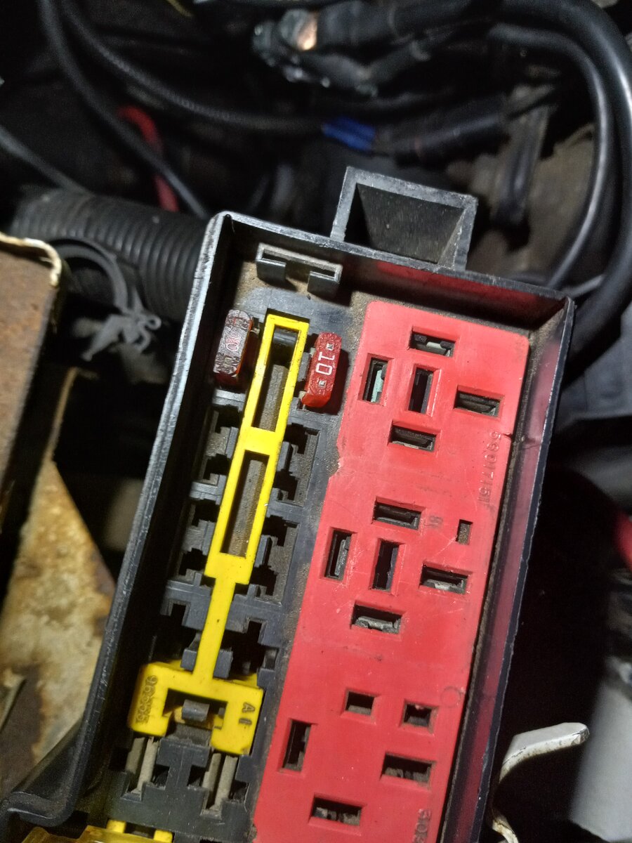

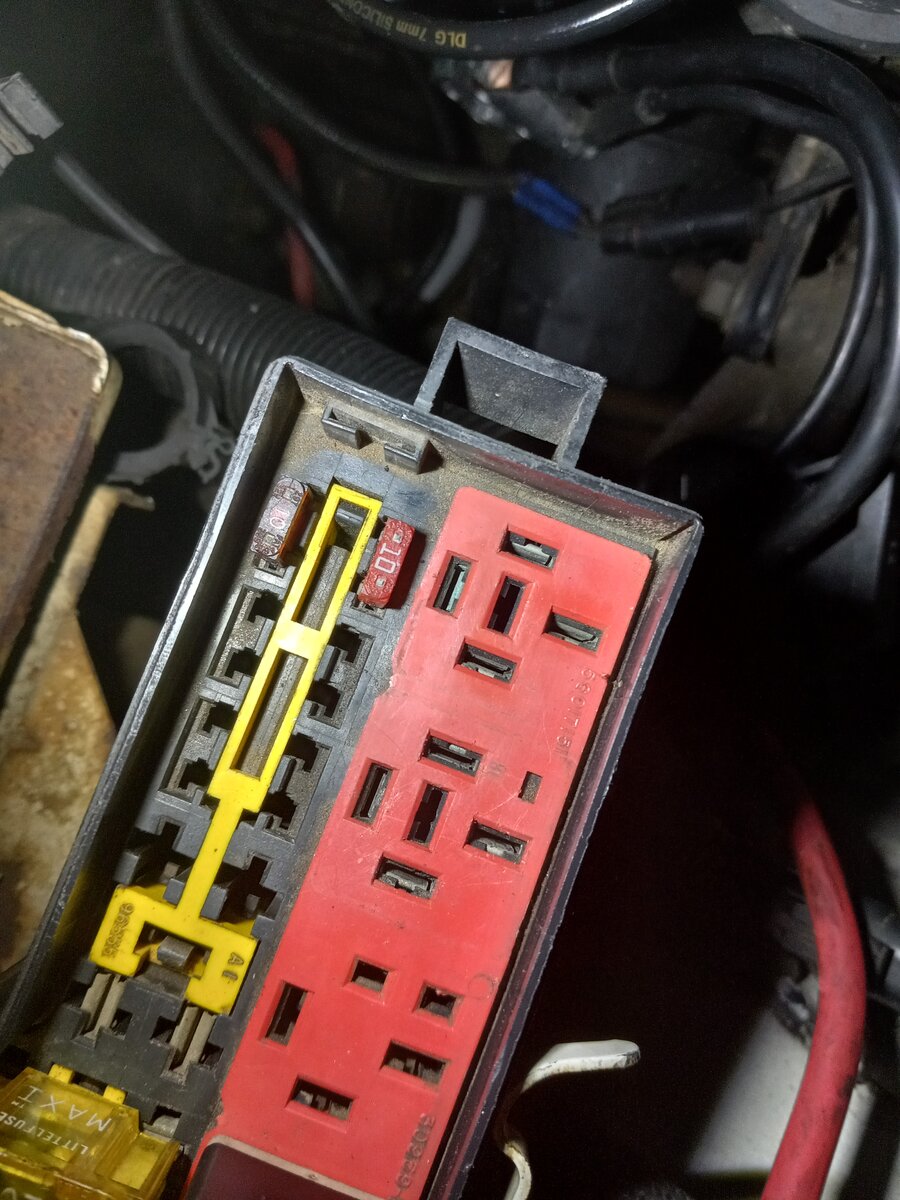

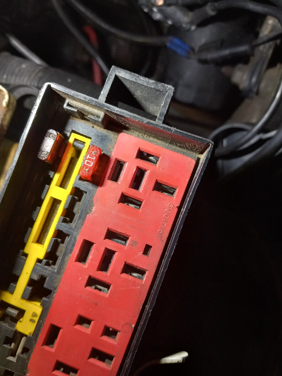

Here is how the contacts look. 2nd socket from the top. Maybe they could use a cleaning?
I can say with certainty that every electrical connection needs cleaning. All my relays were corroded and even the headlight and tail light plugs were bad.
Yep, I am glad it wasn't the fuel pump. I wasn't ready to drop the tank. I am sure the fuel pump could still use a changing though.
