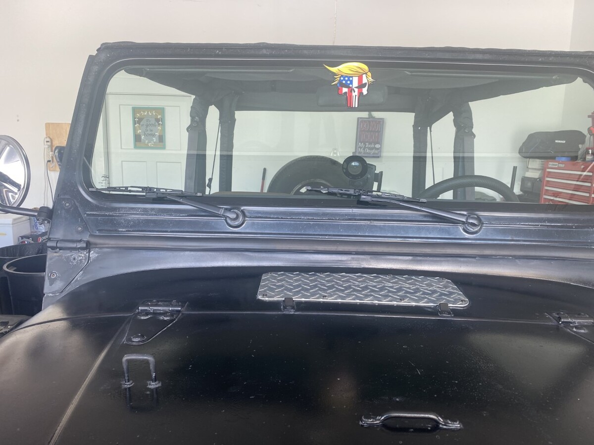

Wiper question

hmm hard to say what’s normal because my solid circle on the right is gone. Does it feel like it works properly if you don’t look at the stalk?
When I have it on the hollow dot the wiper moves every 30seconds or so and does increase im rate as I move the twist knob closer to the shorter printed line

Bought a kit online that stops the arms in the all the way down position........
On mine...........
Well Chit... .The new wiper motor got installed today and same thing. Slow speed only and no return to bottom of windshield when turned off. At this rate between the half working gauges,bad switch i guess??. I will not spend $100 for a new wiper switch, so a 3 way toggle if fine by me. Blue wire is fast, white slow,end of problem. No surprise the Haynes manual wiring diagram is not even close to my wiring colors on the wiper motor or switch.
I dont know where to look regarding the wipers so any input regarding the wiper operation or lack of feel free to speak up, bad relay or, dunno. The blinkers,brights,washer and slow speed all work on the switch, just not the high speed or return feature. Im getting dam frustrated with the electrical gadgets in this thing.
