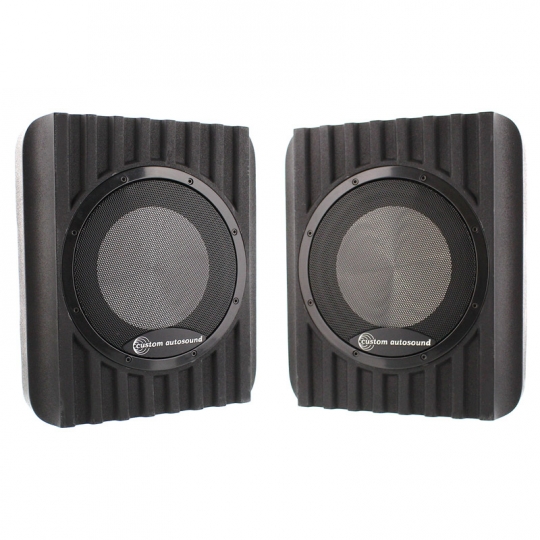

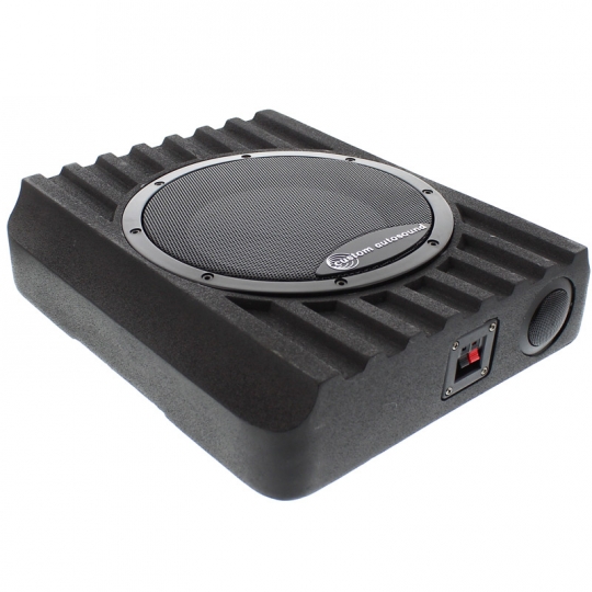

I installed Memphis dash speakers and saw these box ready to go back speakers and RTV'd them to the walls just in front of the tailgate...
Powered by a 55 watt a channel Sony Marine head unit and it will blow you out of the Jeep Top On/Off...Kids in town ask me where I'm hiding the amp.
These speaker have been out in the open all summer rain/dew etc. and they're not effected in the least.

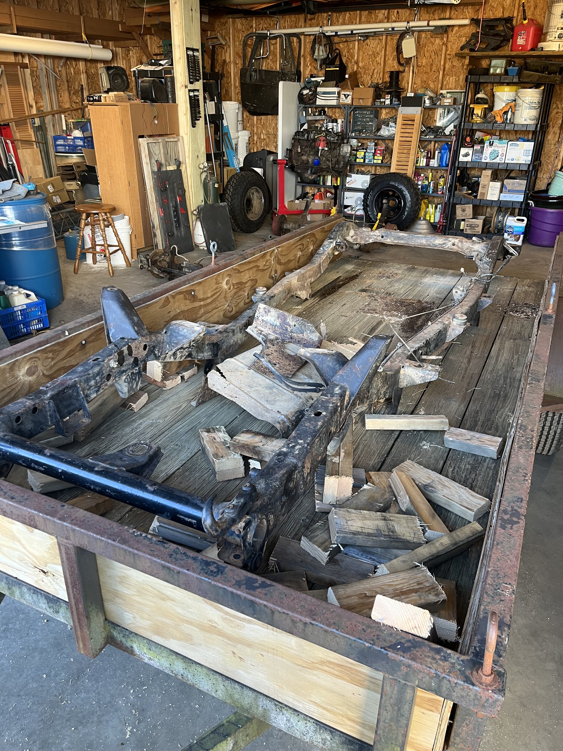

Got old frame stripped down and hauled it away. Really have been needing the room to continue on with this project.

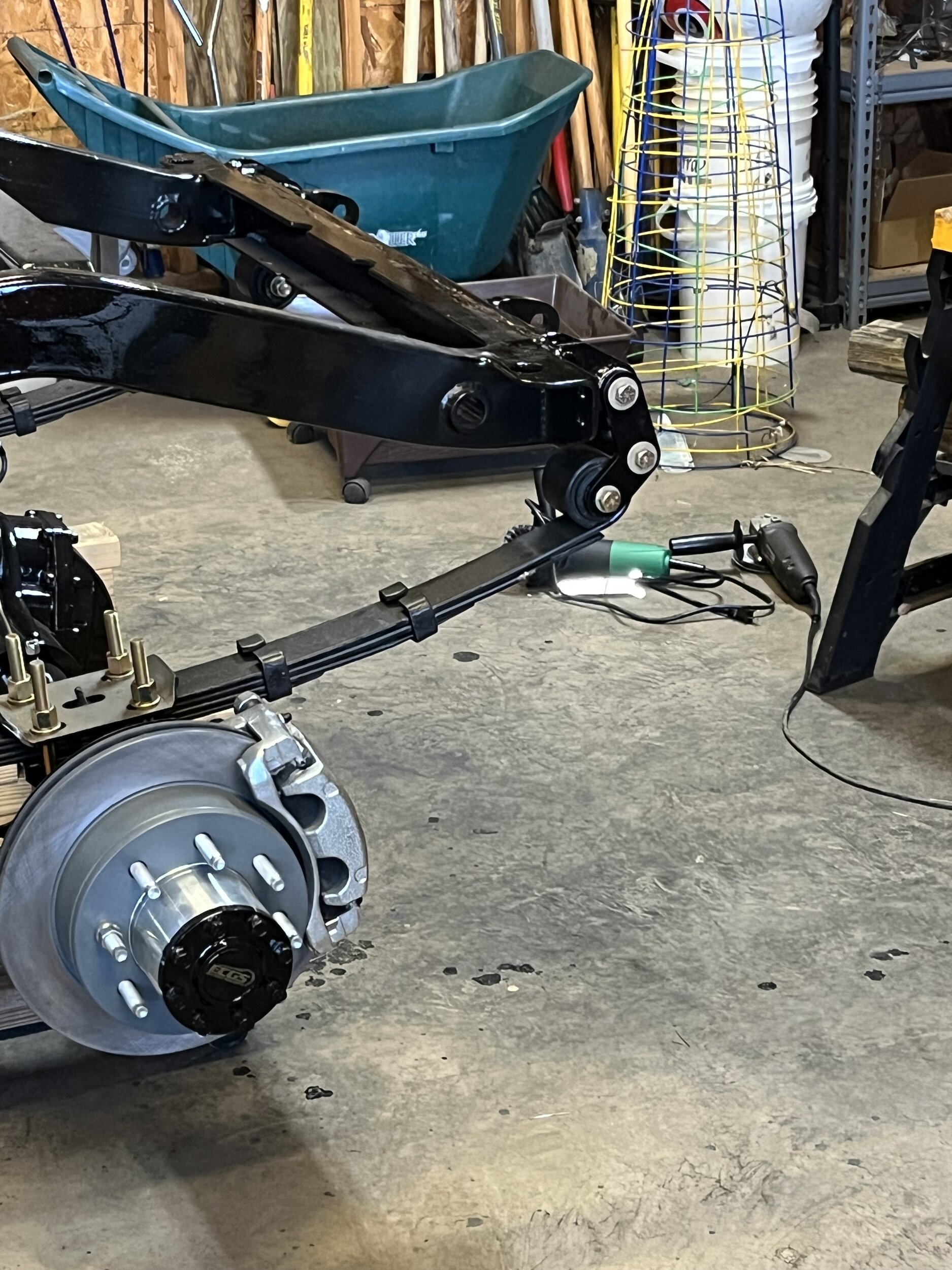

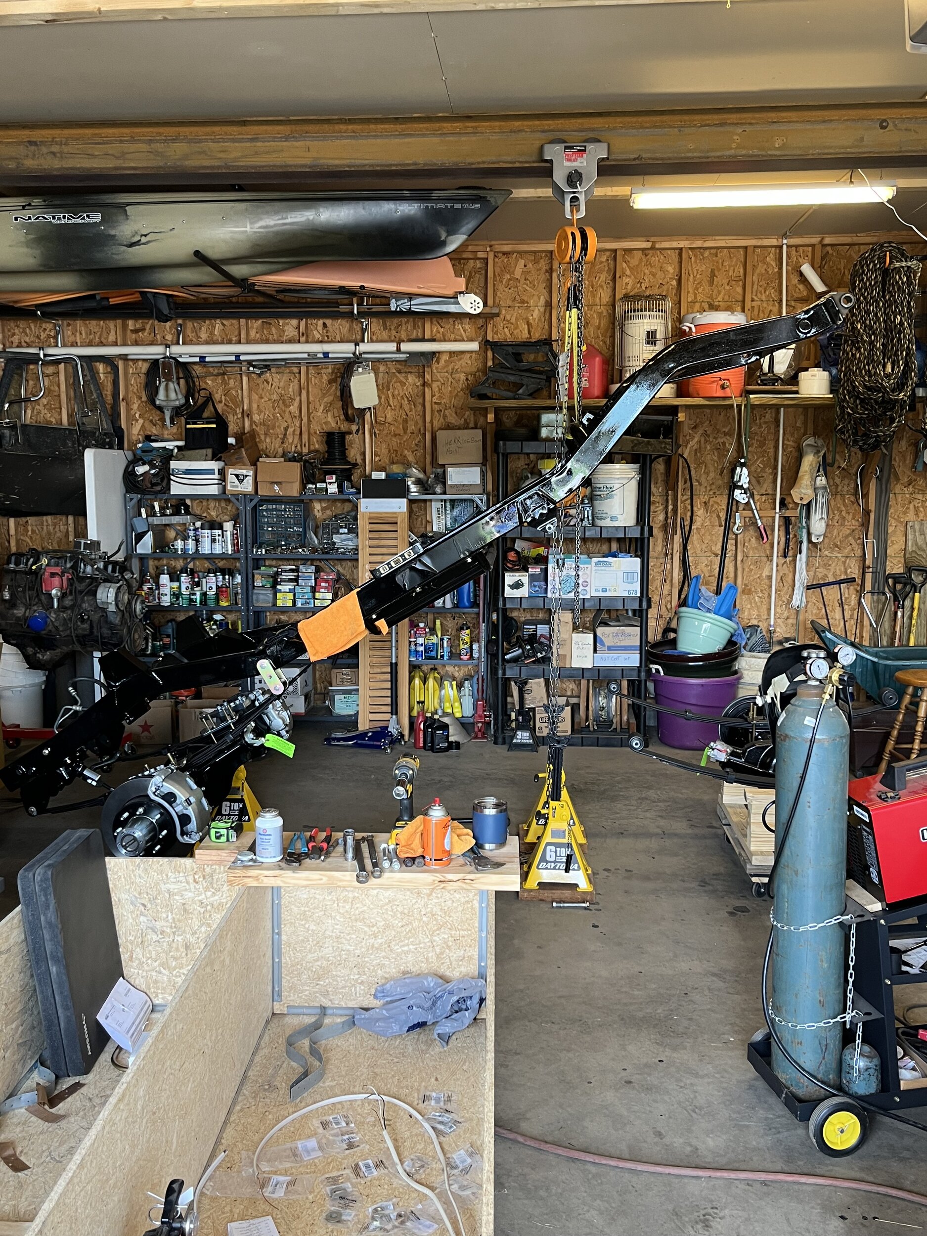

Been busy with the CJ2. Other than some maintenance items with the XJ and YJ most of my focus the last week as been on the CJ2 since I finally got my engine back from the shop.
My welder buddy is working out of town for the next several months so decided to weld the rear wheelbase extension bumper on myself. It’s not as pretty as I would like but then it never is. Shouldn’t fall off though.

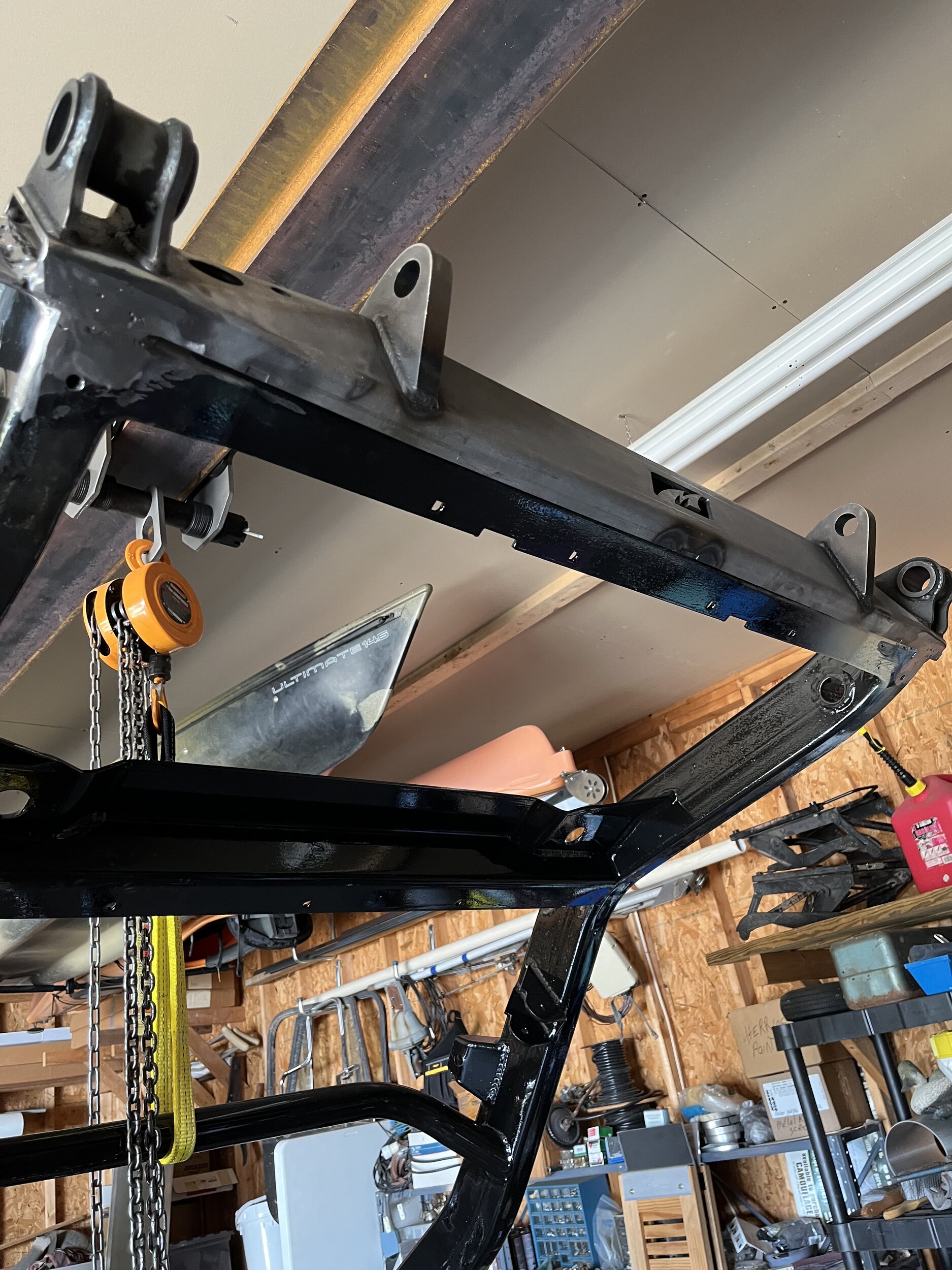

I always have trouble welding overhead, so lifted the rear of the frame as much as I could. That was better but still set my shirt on fire and blistered my arm.
