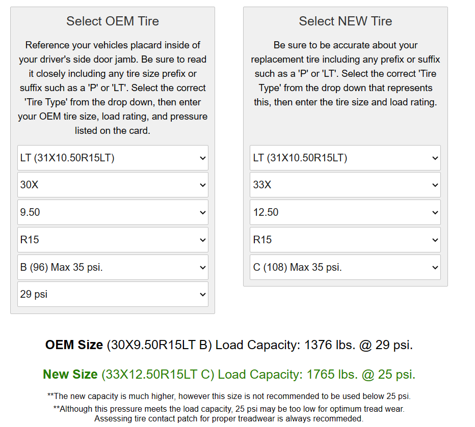

So, start with the "stock" tire on the left:
LT (bottom option)
30X
9.50
R15
B (96)
29 PSI
Now select the new tire:
33X
12.50
R15
C (108)
You can see the tire calculator recommends 25 PSI, because LT thigh flotation tires (inch size) are only rated to a minimum 25PSI. However, this tire at it's minimum pressure still has extra capacity over stock by 389 lbs per tire. That's an added 1,556 lbs total to the carrying capacity of the Jeep, which is excessive.

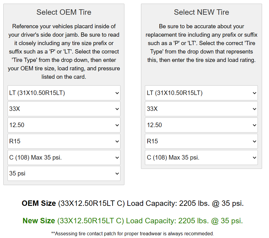

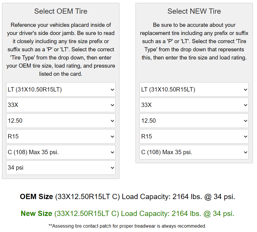

So, I would want to lower the pressure even more. How I figure out where I would want to put it, is I play with the calculator some more. I now enter the 33x12.5 info in the left side and change the PSI so I can watch how much the load carrying capacity changes with 1psi.
Changing from 35 PSI to 34 PSI, you can see the load capacity changed by 41 lbs.
This means that for every 1 PSI, the tire carrying capacity drops by 41 lbs. So take the 1765, subtract the 1376, you get that 389 lb number I referenced earlier. 389/41 = 9.48, so 9. You'd want to actually run 16 PSI to support the load like stock.
