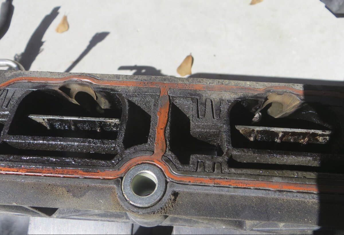

This started with a CEL associated with an intake air leak/possible throttle body air leak. I can't recall which code it was. I sprayed intake cleaner around the the injectors which caused the engine to stumble and also around the intake manifold to head gasket and it too had leaks.
Long story short the, the injector O-rings were brittle and an intake manifold support bracket lost a supporting bolt which allowed vibration of the manifold and wear and warping around the edges of the by the intake gasket. The manifold gasket to the head was one dry crispy critter.

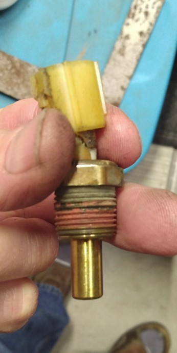

I replaced the plastic intake manifold and throttle body since that usually the most common problem along with new injector O-rings. It was one of those "Since I'm in here I might as well" replace the sensors, some of which are more difficult to get to. That's when the sensor issues started. While unplugging the oil temp sensor the guts came out of the housing as I pulled off the plug. Turns out the sensor still worked and I guess I could have JB Welded it back in place but I went with the OEM after the cheap ones failed.

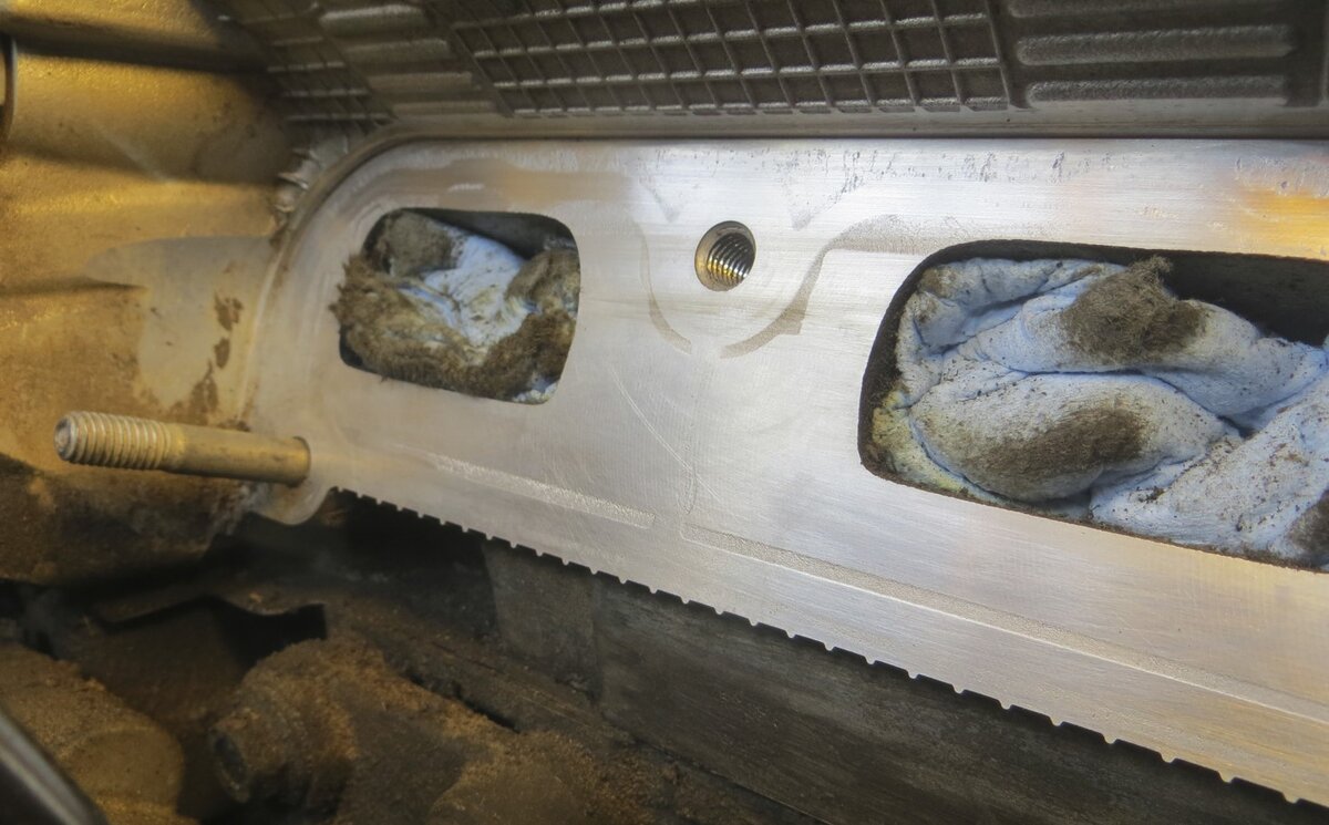

just did my 08 wrangler 3.8L for the same reason, intake off, never use JB weld, epoxy does not belong here. ever. this hot.

I can't speak for a more modern Jeep but the "OEM sensors are your best bet" thought process applies to most older Jeeps as well. The dealer still carries a some of our old sensors but if you can find NTK/NGK sensors on RockAuto they are who made most of the older 90s era Jeep sensors so you can kind of go OEM without actually having a Chryco logo stamped on it.
