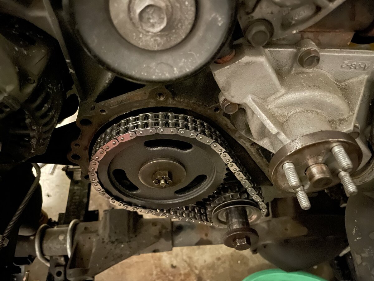

After a few days, I've made some more decent progress! I received all the parts except the harmonic balancer on Wednesday, so I've been doing bit by bit after work since. Wednesday I got the Cloyes double roller chain installed, as well as the new Mopar timing cover. It just so happens that the Mopar timing cover now includes a built in spacer for the AC idler pulley, so I don't even need the 1/4" spacer anymore! The pulley now lines up with the other pulleys on it's own perfectly. I don't have AC but eventually when I add it back, that will be handy.

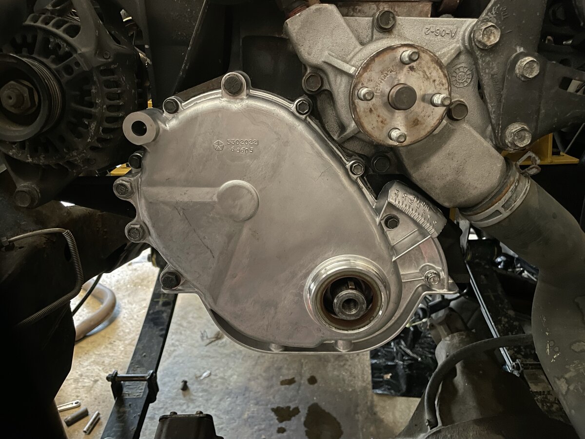

Fancy new Cloyes double roller chain...
Mopar timing cover installed!

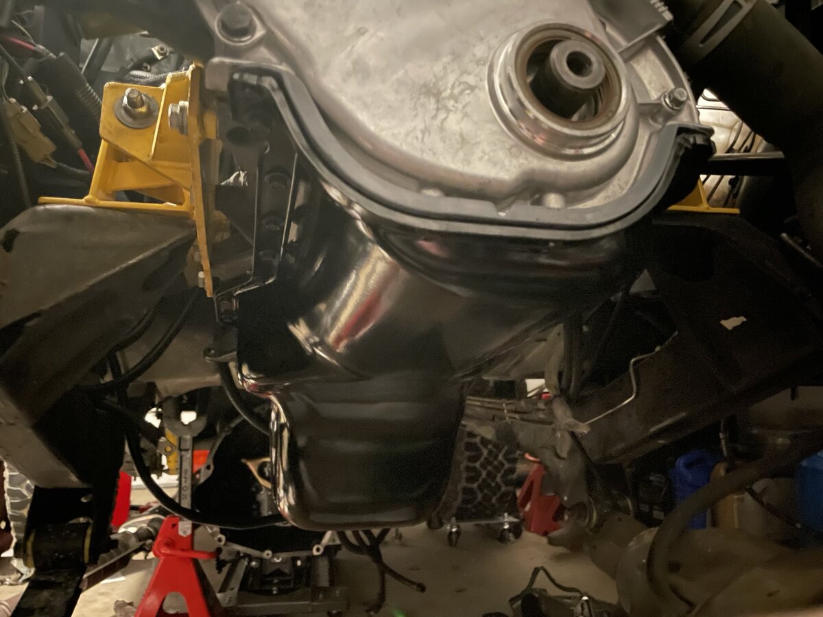

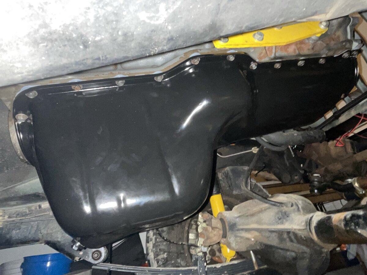

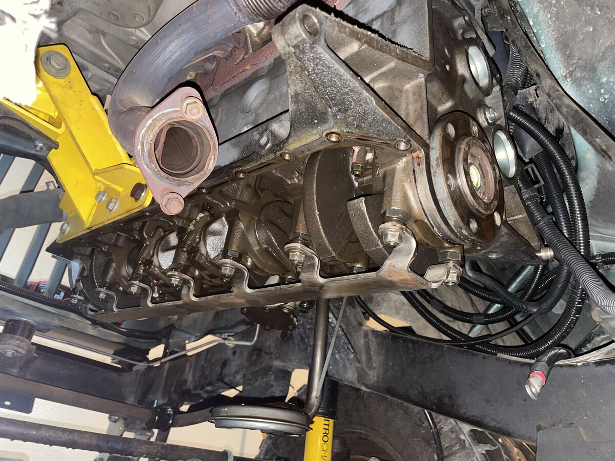

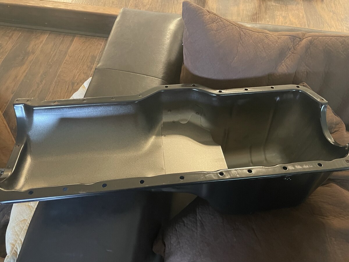

Last night, I cleaned up the oil pan bolts in the sink, as well as got the oil pan gasket surface at the bottom of the engine sparkly clean. I installed the later model girdle onto the studs and then the oil pan and gasket. The pan and gasket were a pain to do by myself, but I got it done quick enough. Everything went up without a hitch.
Girdle in place....oil pan surface was NOT clean yet.
Nice new oil pan...fit perfectly.
Oil pan in place! Looks a lot better than the nasty oil-covered gray one I had previously.

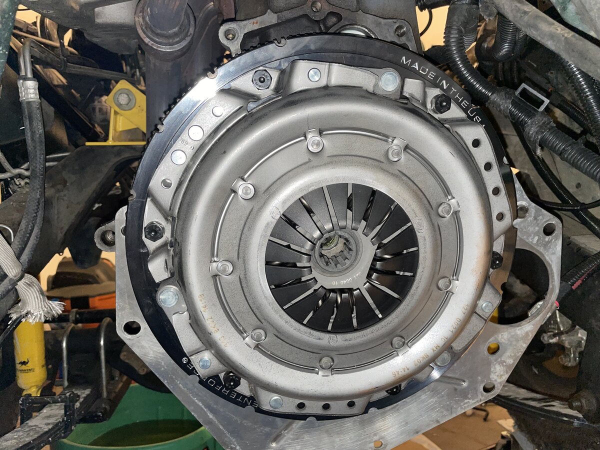

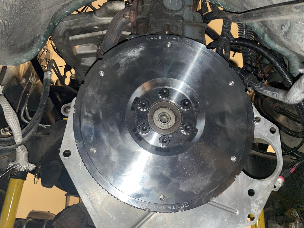

After finishing up the oil stuff, I hung the Centerforce flywheel late last night. For those unaware, a 40 lb flywheel is a BITCH to install by yourself! Heavy, wants to fall off the crank before you get the bolts in, and due to the bolt holes being unevenly spaced (on purpose), you have to figure out the proper flywheel to crank alignment of the bolt holes before you can actually bolt it down. This makes for up to 6 trial-and-error attempts to get it aligned properly. The worst part is that the flywheel cover plate has to go on the crank first, and it does not want to stay up on the engine while you install the flywheel. It's best to just have a helper, but I did make do without, albeit it took a bit longer and more tries.
The flywheel comes coated in oil, so I will clean it with some simple green or brake cleaner before bolting the clutch to it. The bolts are ARP 146-2801. They are 12 point and come with an assembly lube. Dab them in the lube and install. Torque to 105 ft lbs in a star pattern like you would a 6-lug wheel. Use a flywheel holder tool to hold the flywheel still, or have someone put a breaker bar on the harmonic balancer bolt to hold the crank still while you torque it.
Tonight, I will hang the clutch, stab the transmission, and start buttoning 'er up. There is some good peace of mind knowing how much time I spent making sure everything was wiped clean and detailed out. This engine was filthy after the RMS and oil pan leaking for a few years. Feels good to have it clean again, and hopefully it stays clean for a while. I attribute much of the leaking to me not driving it for 4 years now. Thankfully that will change soon.

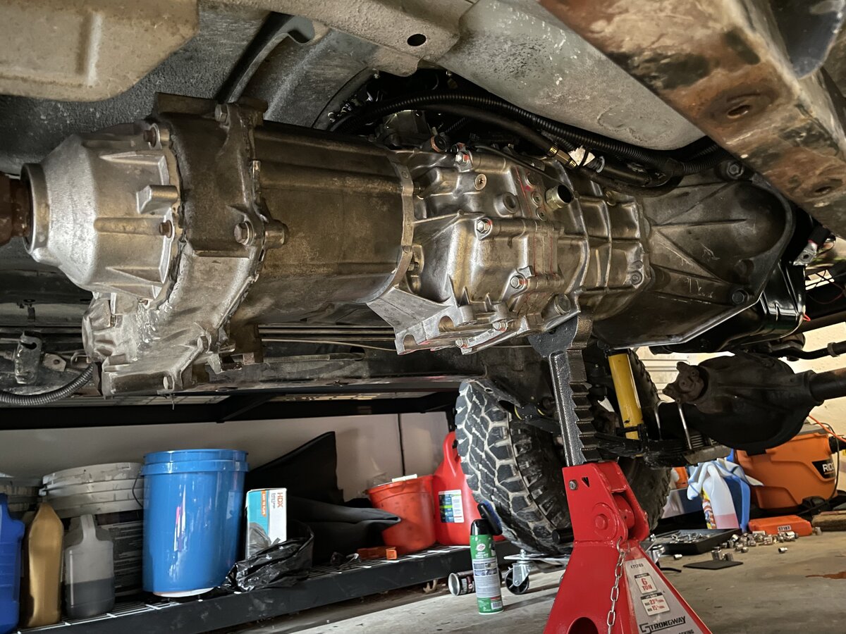

Clutch, Flywheel, Timing Chain, & Rear Main Seal (Part III)

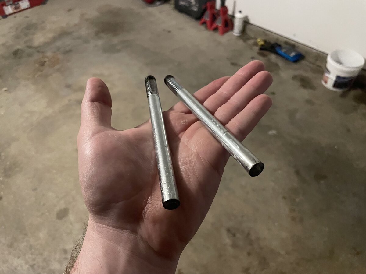

Well the clutch is done! After a small bit of struggling yesterday, I got the transmission reinstalled. I decided to use the good ole make-your-own dowel pin trick. I bought some 6" long bolts, 7/16-14 thread, chopped the heads off, and installed them into the 9:00 and 3:00 positions of the engine block. The rest was just a matter of getting the bell housing up to the bolts, popping them into the holes, and pushing the transmission slowly forward. Worked like a champ.
Earlier in the morning, I really struggled with the transmission on my transmission jack, as it wasn't letting me angle it perfectly to go in. The bolt dowels were a much better choice. Definitely choose partially threaded bolts, so that the bell housing can slide smoothly. If these bolts were fully threaded the entire way, that would have been a nightmare to try to slide the bellhousing on, and probably would have filed away metal from the bell housing holes. Not good.
I got the exhaust hung back up, and I'm leaving the transmission sitting on a jack stand for the next few weeks. I am going to be pulling the transfer case back off for my rebuild, as well as pulling the rear axle for the Arizona trip. When I get back from those, my steering, braking, axle and transfer case will all finally be done. The rest from that point is cosmetic interior stuff, like wiring a few switches, carpet, JW Speaker headlights, etc.
I hopped into the Jeep and sat in the driver's seat to test the clutch pedal feel. It is slightly more firm than the standard Luk clutch felt, but honestly in a good way. I'm really excited to go for a drive soon and see how it does on the road. The pedal requires a small bit of extra force but it is not difficult at all. It feels perfect as far as I can tell, and from the reviews, I expect it to engage super smoothly, especially with the new heavy flywheel.
I am glad to be done with this project.
Used the dowel pin trick many times.
I also cut a slot in the ends for a screwdriver to ease removal afterwards.
it sure did work well. I considered doing the slot as well but I was too anxious to get the transmission up in place, that I lazed out on the slot. Ended up getting both removed just fine with some initial twists using pliers, then spun them out by hand. Worked perfectly fine. I'm keeping these for the next time I do a clutch, probably 10 years from now, and will probably improve them with a slot sometime between now and then lol.

I've got about 3 or 4 different size sets in my toolbox, I just do the slot bc sometimes they bind.
But understand wanting to get the job Done!
Mine were definitely binding at first, until I tightened the two upper bolts and took some pressure off the jack. At that point they were in a pretty neutral state and the pliers weren't even really needed.
Reactions: jeepjoe43
Old tricks are the best tricks, eh?
Indeed! I’ve never used the dowel pin method before actually. I’ve pulled my YJ’s transmission 3 times now. In the past we always used a regular floor jack and just balanced it. That was always a pain, although we honestly never struggled too badly with it that way. Still a pain and always a risk to drop and damage the transmission though. I bought a trans jack two years ago, knowing that I would need it for this YJ project eventually. Sadly the AX15 really doesn’t like to sit on it, so that’s why I struggled by myself to install the transmission this time. However, the flat plate is enough that it holds the transmission for me while I manipulate it on the dowels, so overall it all worked out and I can install a transmission by myself this way.

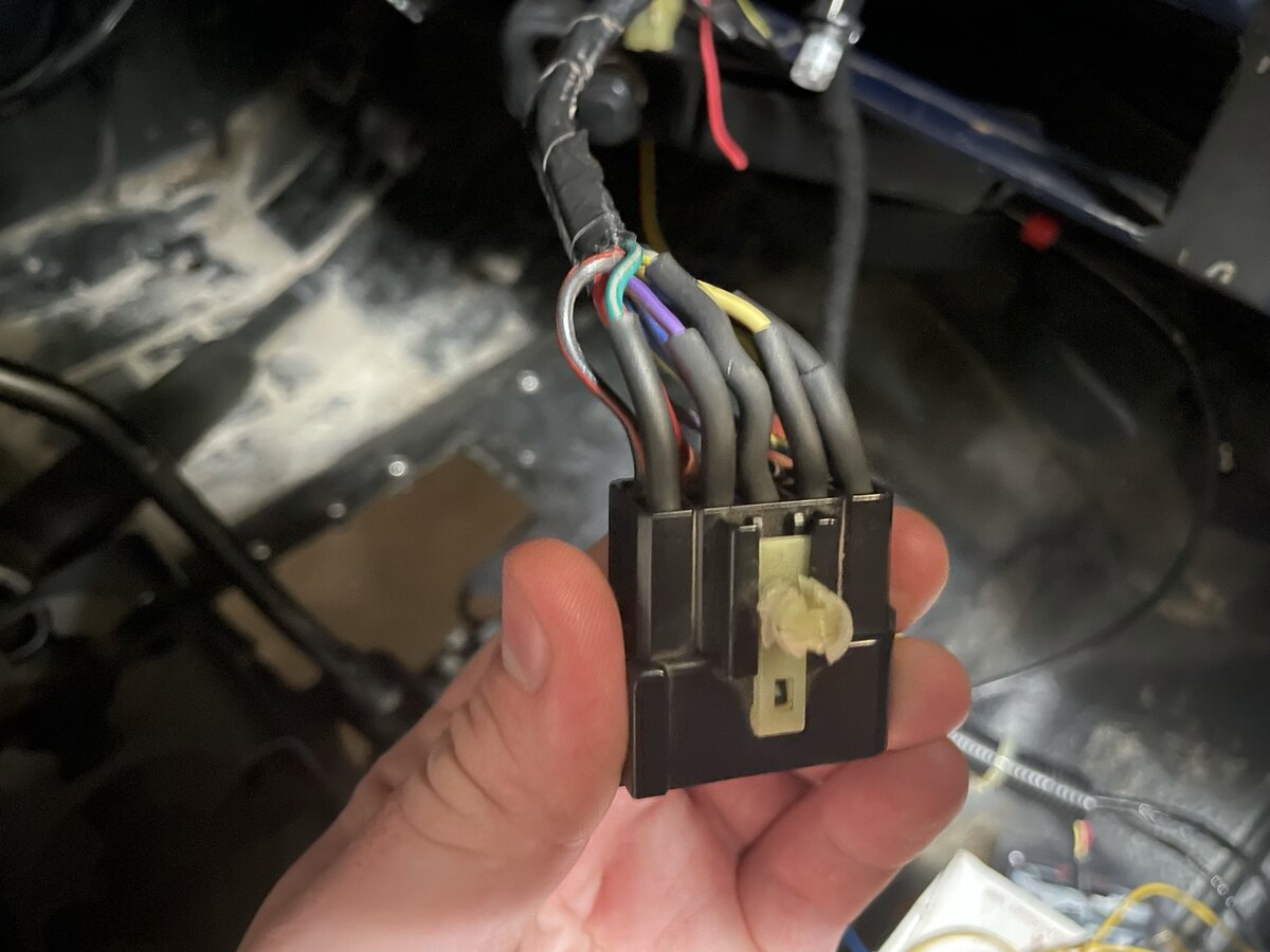

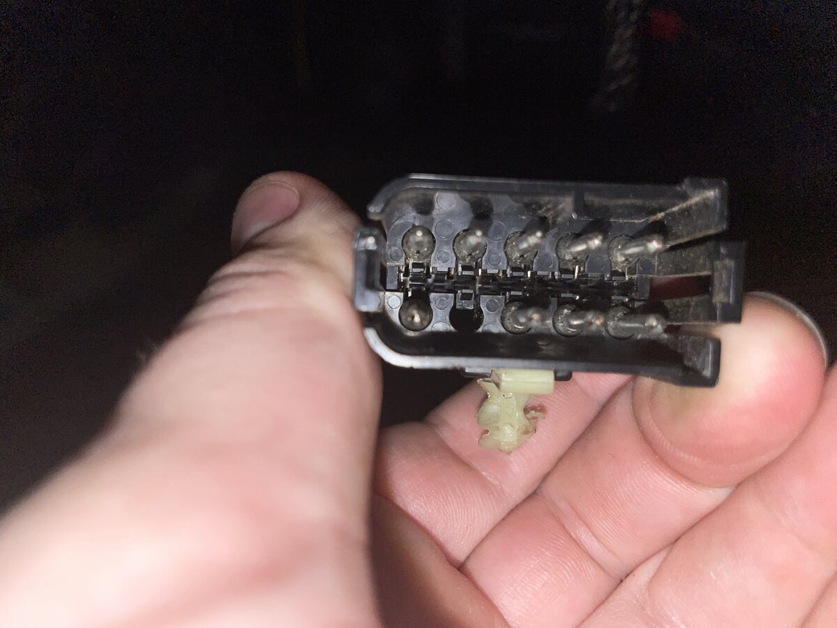

Fixing Connectors...

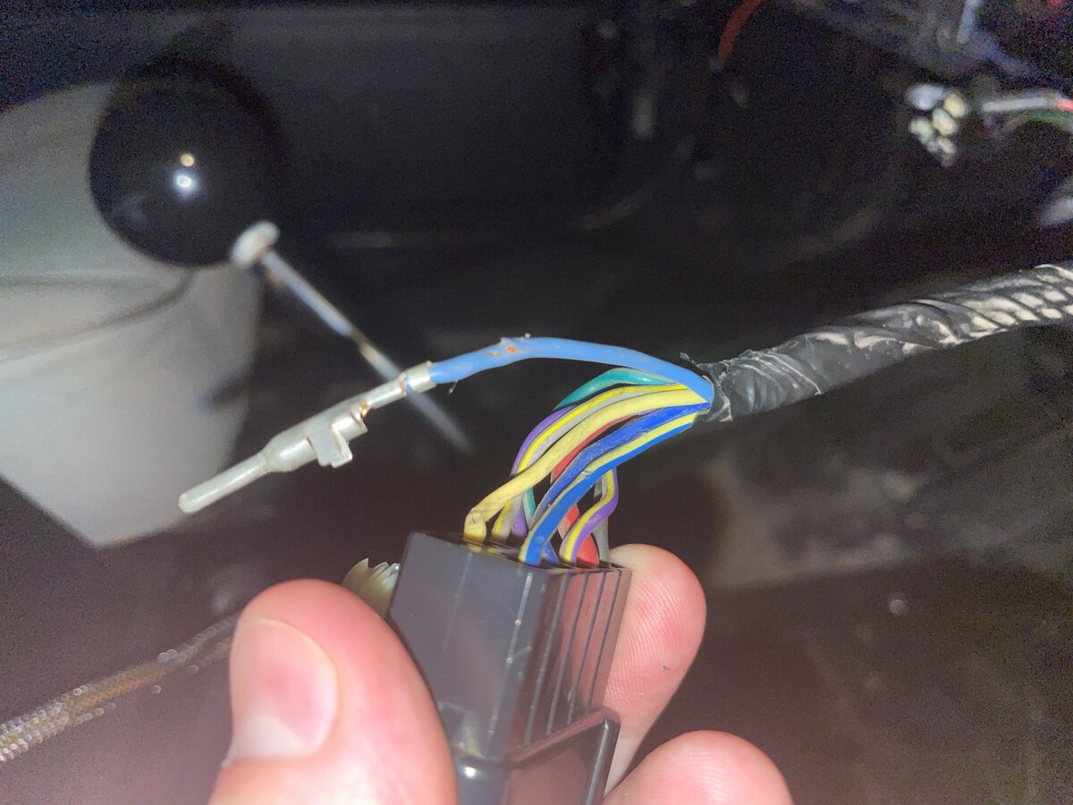

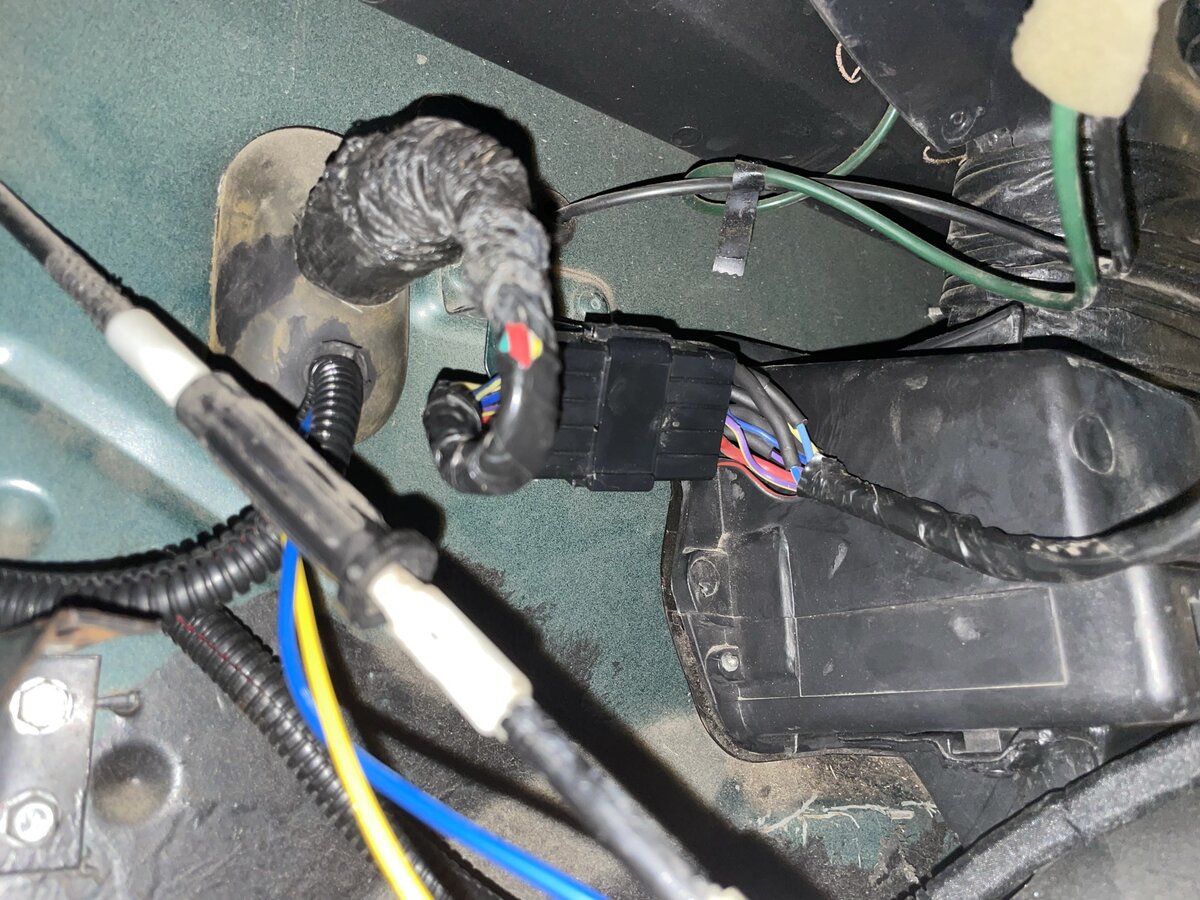

Nothing too crazy exciting today. A few weeks ago I noticed my 10-pin central firewall connector had some wire damage on the dash side of the connection. This is the one where the engine harness delivers fuel level, 4WD indicator, oil pressure, and coolant temp readings to the gauges, as well as provides power to operate the factory AC hookup. Obviously it is a pretty vital connector, so I knew I needed to fix it. The blue and yellow wires were the worst ones but I saw enough damage to fix 6 of the 10.
Not sure how these got messed up, but it wasn't due to age, something had to have hit them. The other side of the plug (coming from the hood) was flawless as are most of my other plugs in the Jeep overall. My guess is last time I reinstalled my heater box, I probably bumped the lip of the box up against the wires and scraped them. Who knows, but it needed to be fixed.

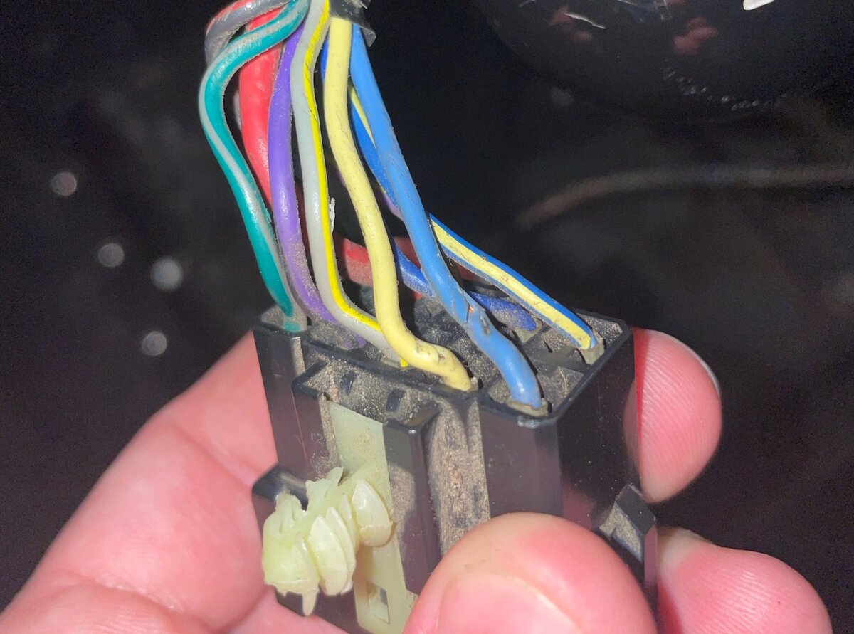

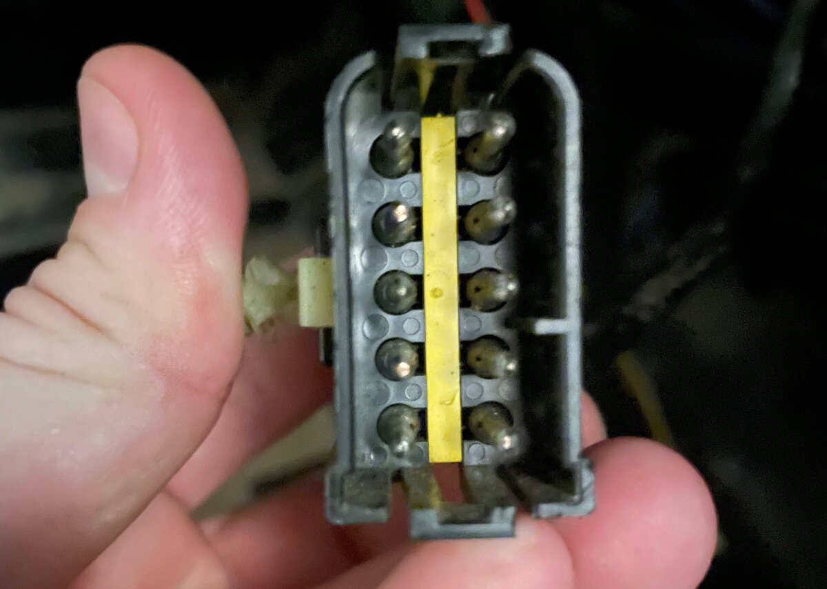

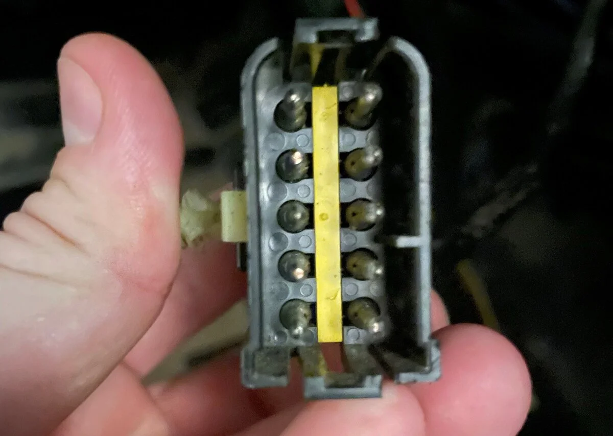

The repair was pretty simple. Most factory connectors like this can easily be de-pinned, by pulling the little wedge piece (skinny yellow piece) in the middle, then you can bend the little tabs to unlock the pins, then you can pull on the wires to pull them each out of the plug, one at a time. You need a very small flat blade screwdriver to undo the locking tabs.
Damaged blue wire pulled...
After heat shrinking, pop the wires back into place, reinsert the yellow wedge, then you're free to install after each wire is done. Took me maybe an hour to fix this one, working very slowly.
Boom, peace of mind on that connector now. I'll have to keep an eye on it next time I mess with the heater box.
