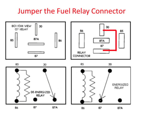

Do this at your own risk. Here is a diagram I saved for jumping the fuel pump relay when I'll drain the fuel tank or in your case test the pump. This should be what you see on your YJ.

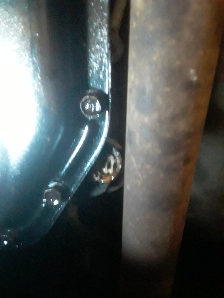

When the connection for the NSS was ready to say hello while looking for it. I couldn't help but laugh when I saw this. Looks like this may be the problem.
Sigh...
Yea. Must have pulled off when I got stuck in the mud or a stick. I put it back on, and the Jeep starts now. It doesn't take much to unplug it though
