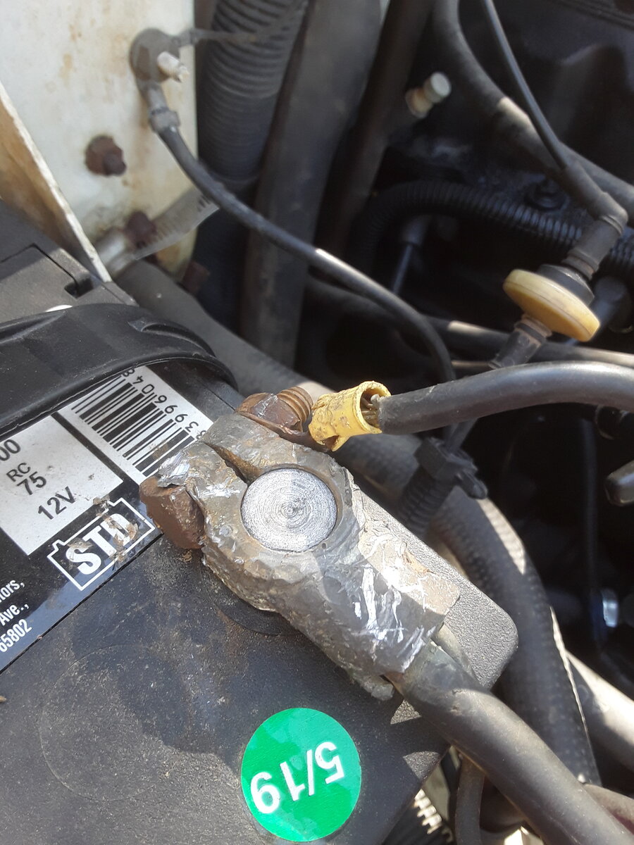

Battery read 12.3V, but it was not under load. Battery is just a year old, so right now it is not the suspect.
The positive terminal on solenoid read 12.3V.
I had someone come and work the ignition while I checked the other two terminals. I checked while key was in on position and then checked while key was turned to crank position. I did not get any reads for the ignition terminal and the the other terminal with the short wire that goes into starter.
As of right now, I am going to go ahead and replace the ignition switch on steering column. There is one in stock for 30 bucks at an Autozone near me. I have the bolts all undone to lower the column, but I couldn't get the plate with the foam on firewall to come off before lowering it. I was tired at this point, and post poned the rest until tomorrow.
