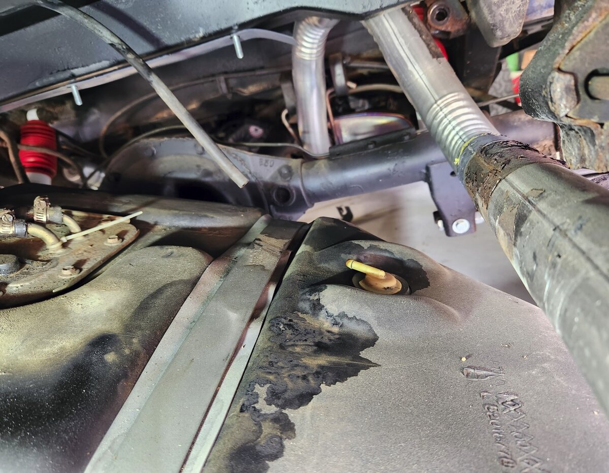

Maybe it's the ground, maybe it's the pump, maybe I should have taken everyone's advice and cut out the pump's easy access panel in back. Now I need to drop the tank and do a little more work.

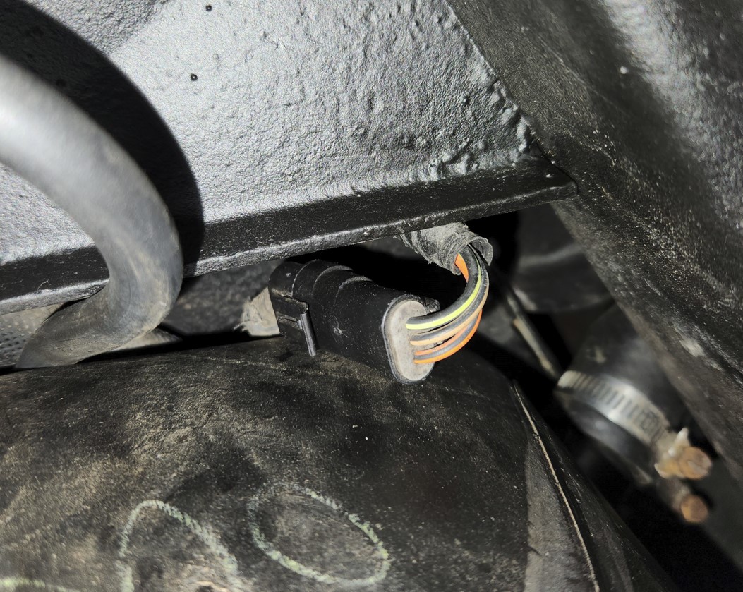

Check the connector first. You should be able to reach it or inspect it from the drivers side in the gap between the frame and body.

Just checked it and the plug was locked tight together but when I bypassed the pump relay again it all worked ok. I'll pull the plug apart and clean the terminals again, Hopefully it's not the ground on the pump. I verified that was clean and secure last week.

When I had the pump out last week that short hose looked good. The vent hoses on top were a little brittle and one had disconnected from the vent valve. I bought two new vent valves and a longer length of fuel vent hose as the old one barely reached between the two vents. This time I used hose clamps to keep them attached in place.

Well I did track the problem down to that pump three wire connector but didn't fix the problem. I cleaned and sprayed a corrosion inhibitor in both side of the plug but found there must be a loose connection somewhere in or around the plug. By jumping the relay I can hear the pump running but if I lightly tap the connector the pump will momentarily cut out or stop all together. The two halves are a tight fit with no wiggle room so it might be where the wire go into the plug and it could be on either side. I don't think it's up or down stream from the plug. There's little to no slack going towards the pump and no change if I pull that end of the harness so I believe the ground connection and the tank is still holding tight.
I'll check it closer with a multi meter and maybe need to change the connector.
Ok, I think I have it fixed for now. I did a continuity check to a known ground and got the tone and then low resistance on both sides of the connector. So I'm guessing after 31 years of vibration one of the pins has a miniscule gap to the female end causing an open circuit when connected together.
I ever so gently made a slight bend in each of the three pins hoping the curve would create a better connection and so far it's working. I can now tap, twist and tug on the connector and the pump continues to run.
