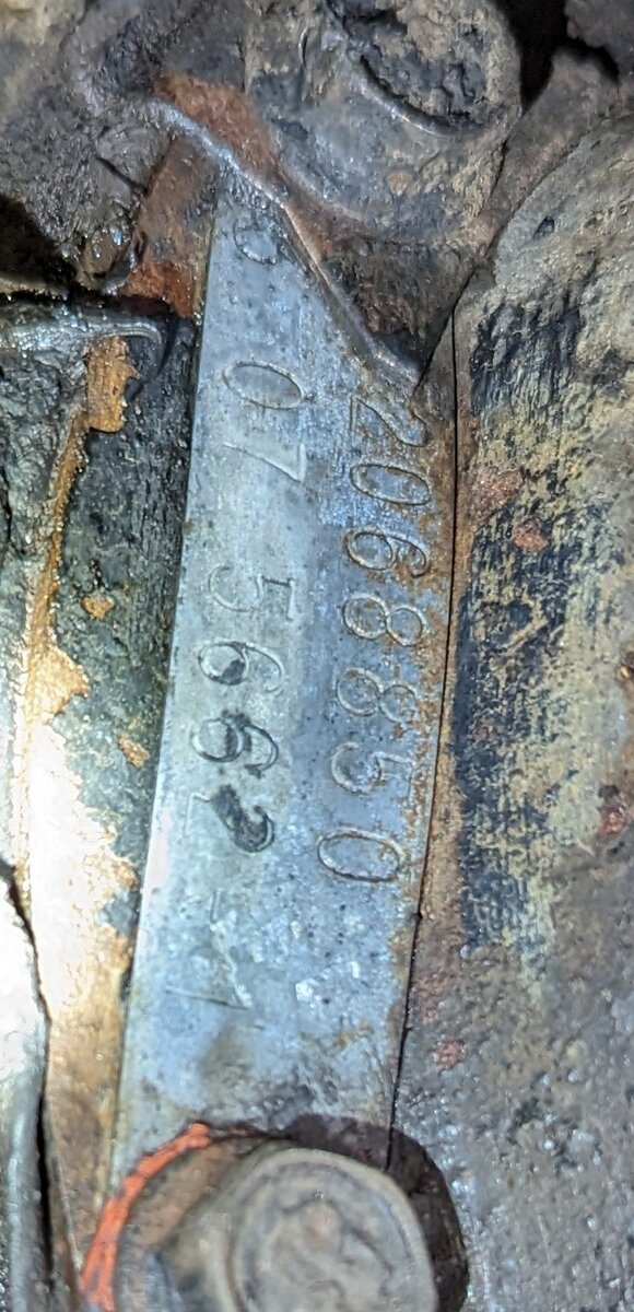

Okay.... I'm trying to discover exactly what my gear ratio is. I've got a stock 95 Sahara edition. I checked the tag on the flange of the rear diff and it's got a sequence of numbers that don't seem to mean anything (to me anyway):
2068850
07 5662-1
Can anyone make any sense of that mess?
Thanks!
You probably over looked the 3 in front of 07 for 3.07. Usually difficult to read and possibly covered up by gunk/rust.
Well look at that.... It looks like the bottom bit of a 3 under that mount corner!
THANKS a ton!
3.07 seems really high.... And I just bought 33" tires to put on once I get my lift kit and get it installed.... Now to figure out what my new ratio should be.....
