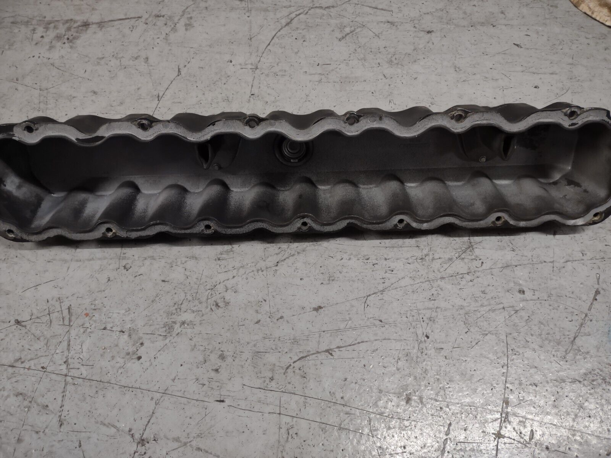

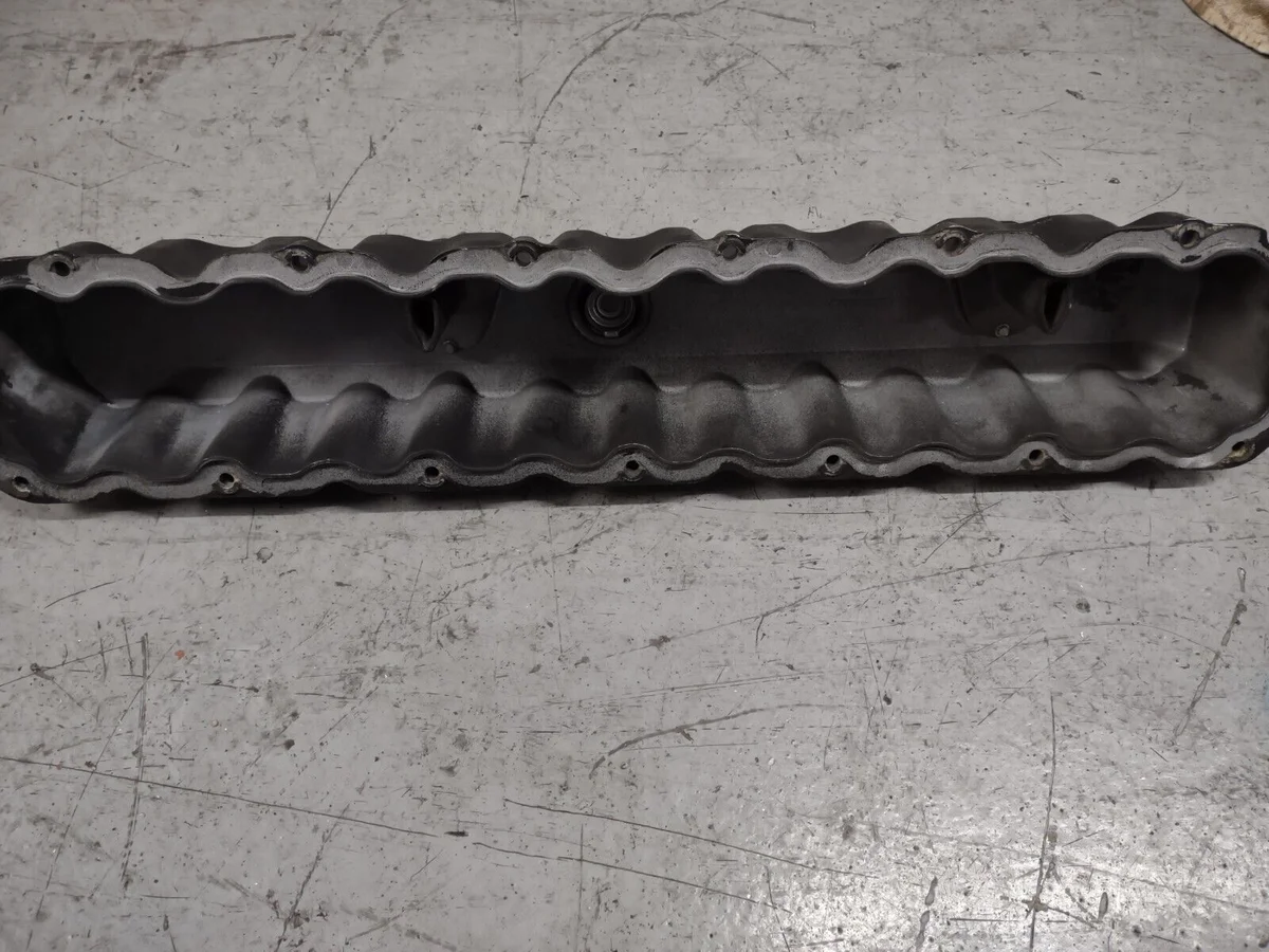

By "towers", I am referring to pieces on the underside of the valve cover directly beneath the elbows holes. They are tubes that reach down close to the surface of the cylinder head so that oil is not flung up from the rockers onto the bottoms of the elbows. I'll post a pic below.

Here is an example of the valve cover - you can see the two "towers", one by the oil fil cap and one by the rear of the valve cover. turns out they are removable as @Flyer58 said. I didn't recall mine being that way but like I said it's been a while. Those are what need to be cleaned out most likely, and you need to get the correct elbows installed.
You will still need to remove the valve cover to clean up any of this. If you try to clean from above, you're just going to push the gunk down onto the top of the cylinder head, which could get that stuff into the oil, valve springs, etc which you don't want. I'd just find some time soon and pull the valve cover. I can remove mine in about 30 minutes, so it's not that big of a deal.
