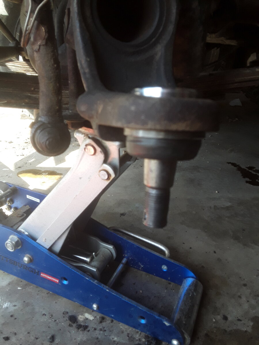

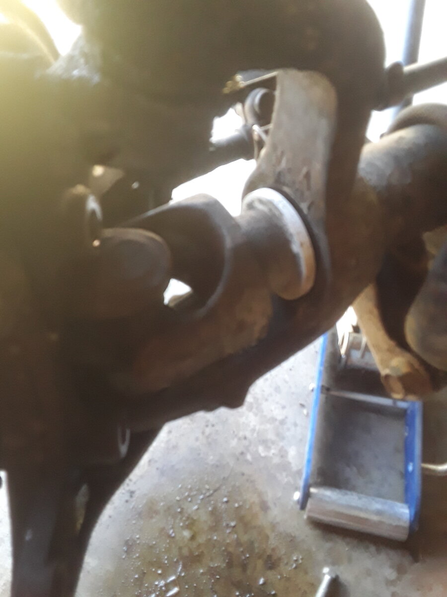

It's a slight press fit into the knuckle. Some go in easier than others, but they almost always require using the bolts to pull it all in. Depends on how much rust was there to begin with, that adds to the press fit and makes it even more snug. I figure you probably got it done by now though.

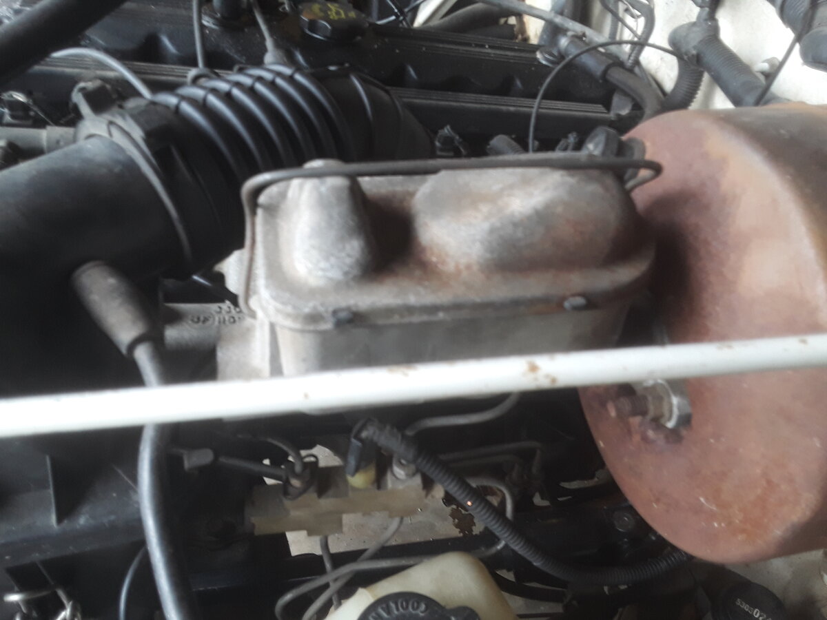

One concerning issue with the brakes. As I was removing the bolts for the caliper, the brake line was in the way for my wrench to get to. I moved the line just a tad out the way to remove the bolt. I noticed that when I had it hanging on a strap out of the way, it was dripping when the line starts at the bolt on the caliper. It may have dripped 5+ times before I noticed. I moved the line back the opposite way to tighten it back up. I may have to torque the bolt some, but the leak stopped. Will this create an air bubble in the braking system to where it is not as effective in braking?

For the brakes, I’d do a quick gravity bleeding of that caliper. The leaking lime probably let some air into the caliper itself. I’d mount the caliper, crack the bleeder screw, open the master cylinder cap, and let the fluid run through it for a minute or two. Close the bleeder, put back the master cylinder cap, and it should be fine. Sounds like whoever worked on brakes previously didn’t tighten the bolt enough, because it should never leak like that.

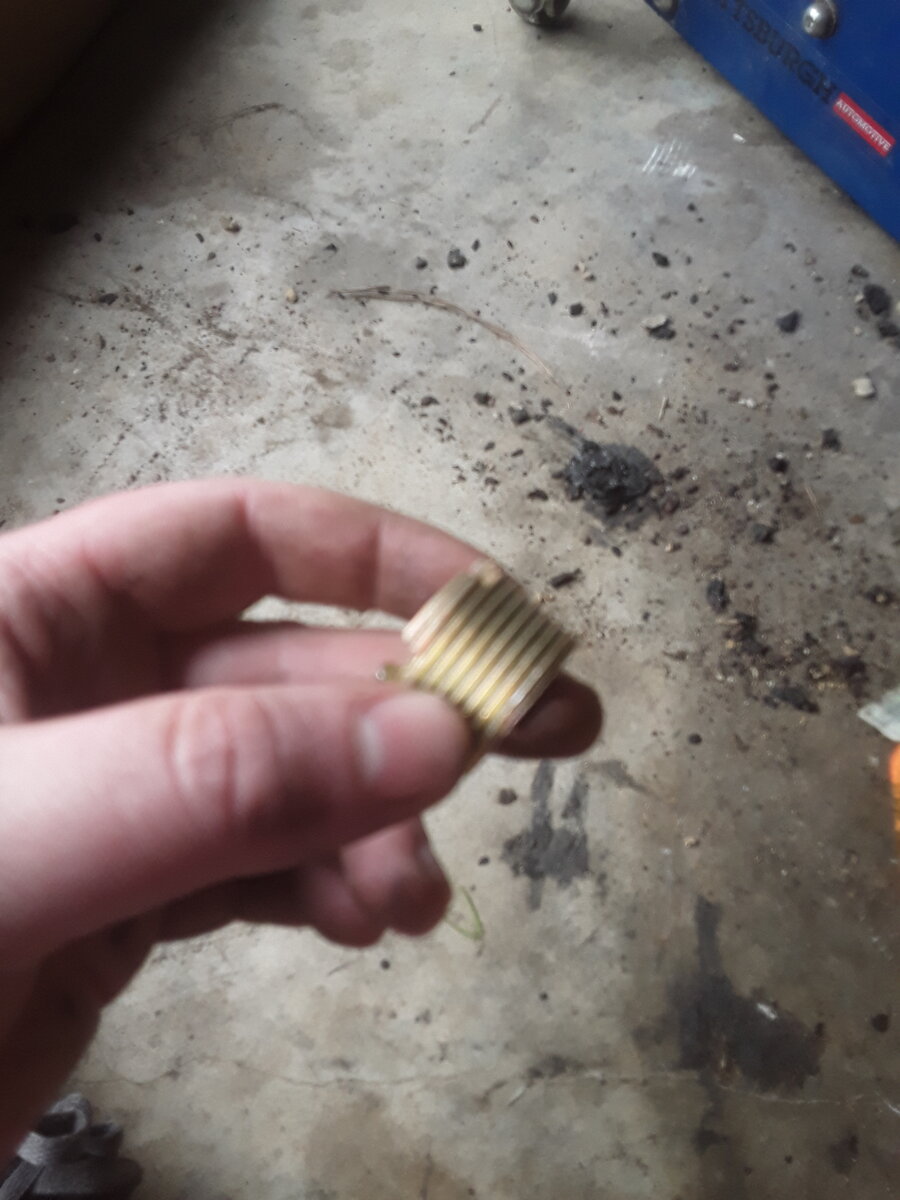

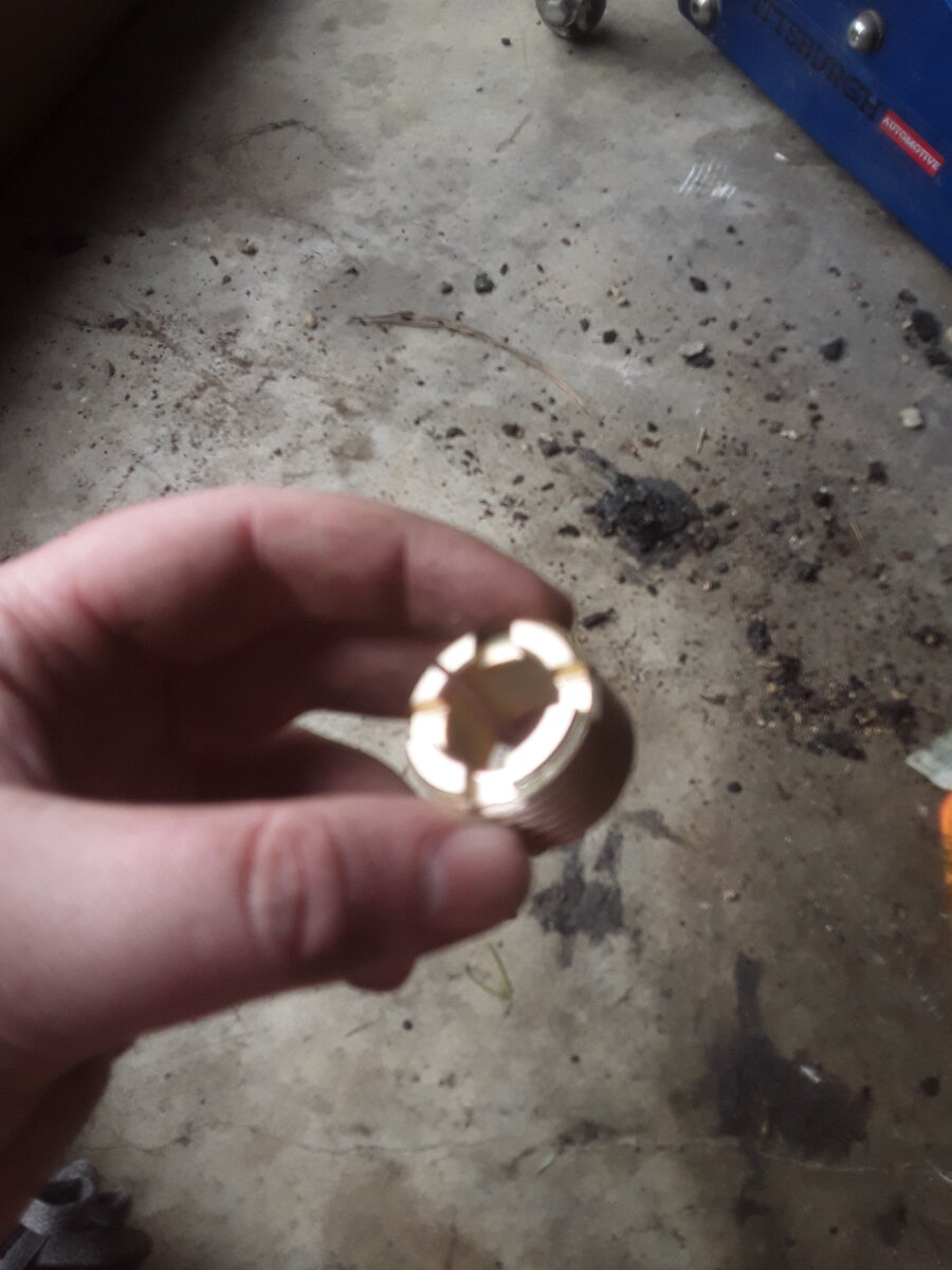

And what are these for? Came with the ball joints.
Preload spacers for the knuckle on a 1990 and prior. You can toss them, you have no need and will never have a need for those. They only include them to make the part fit more applications.

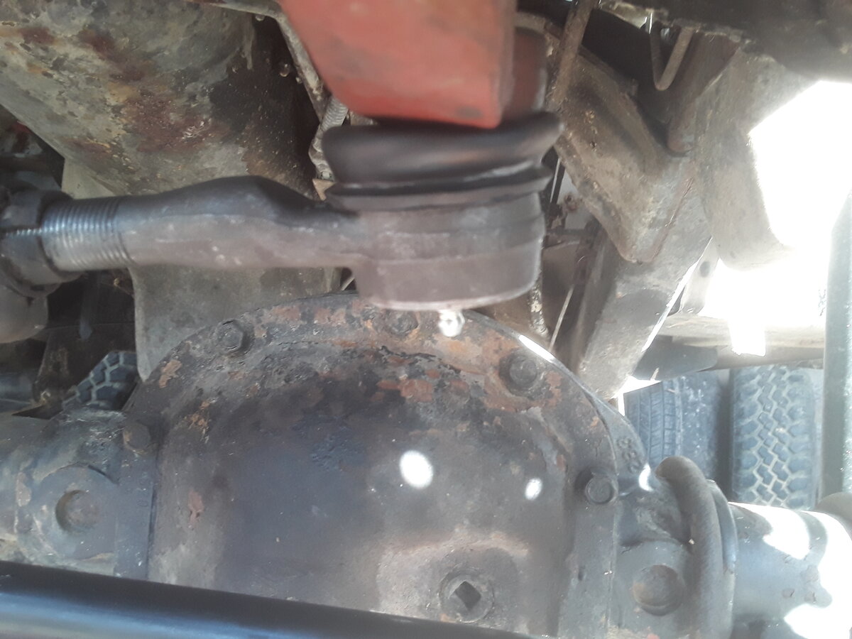

Pitman arm tie end connection suppose to look like this? It was the only way I could get it one even though all my measurementa from the previous were the same
