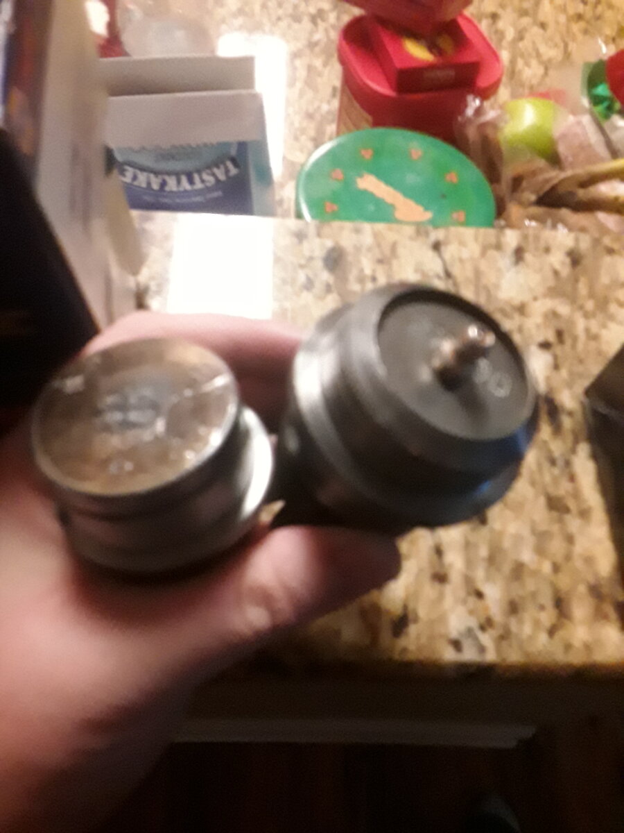

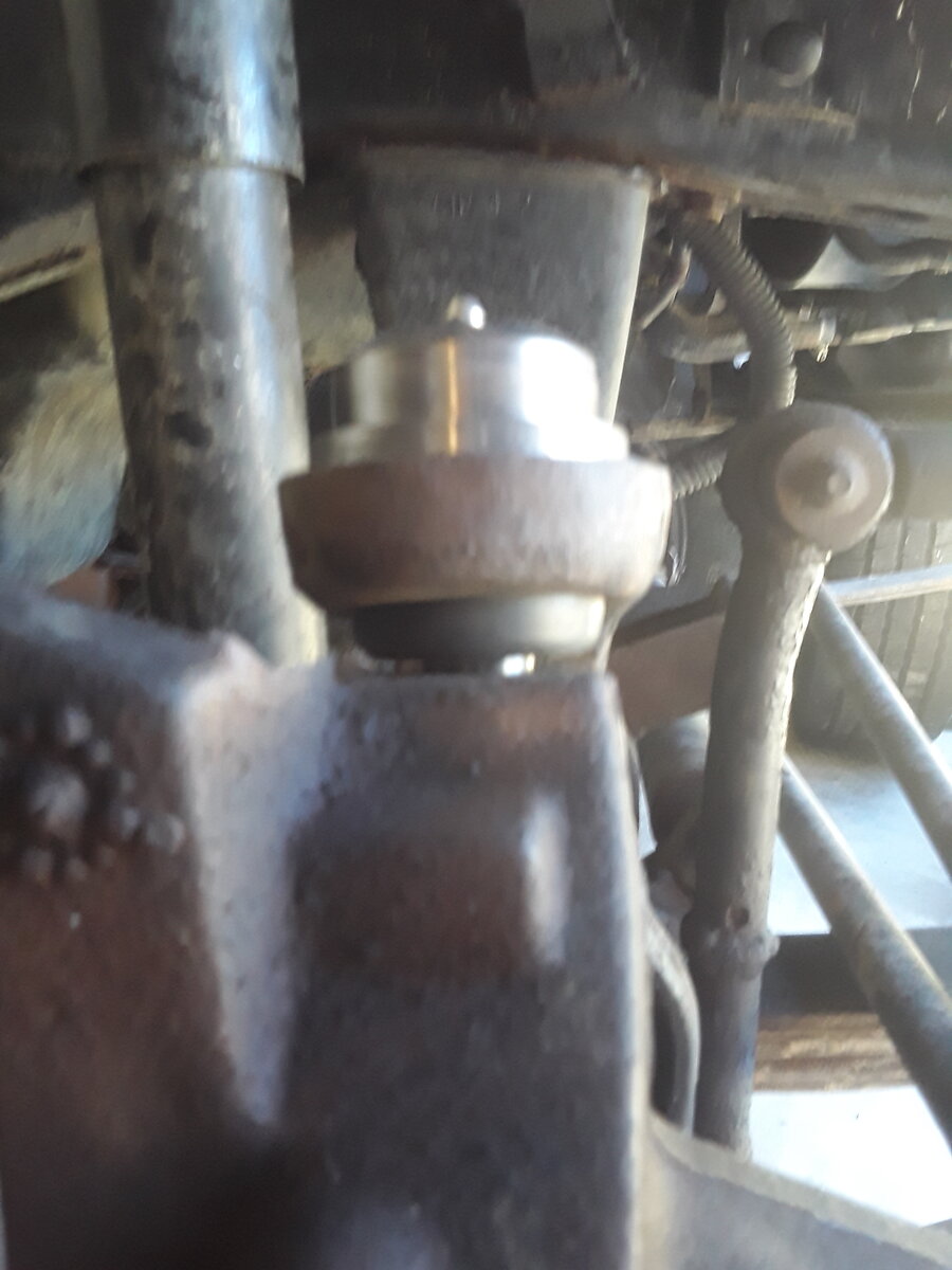

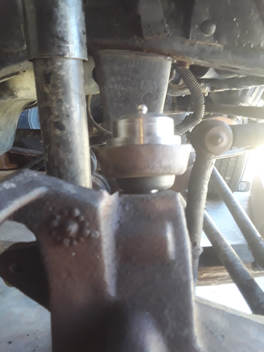

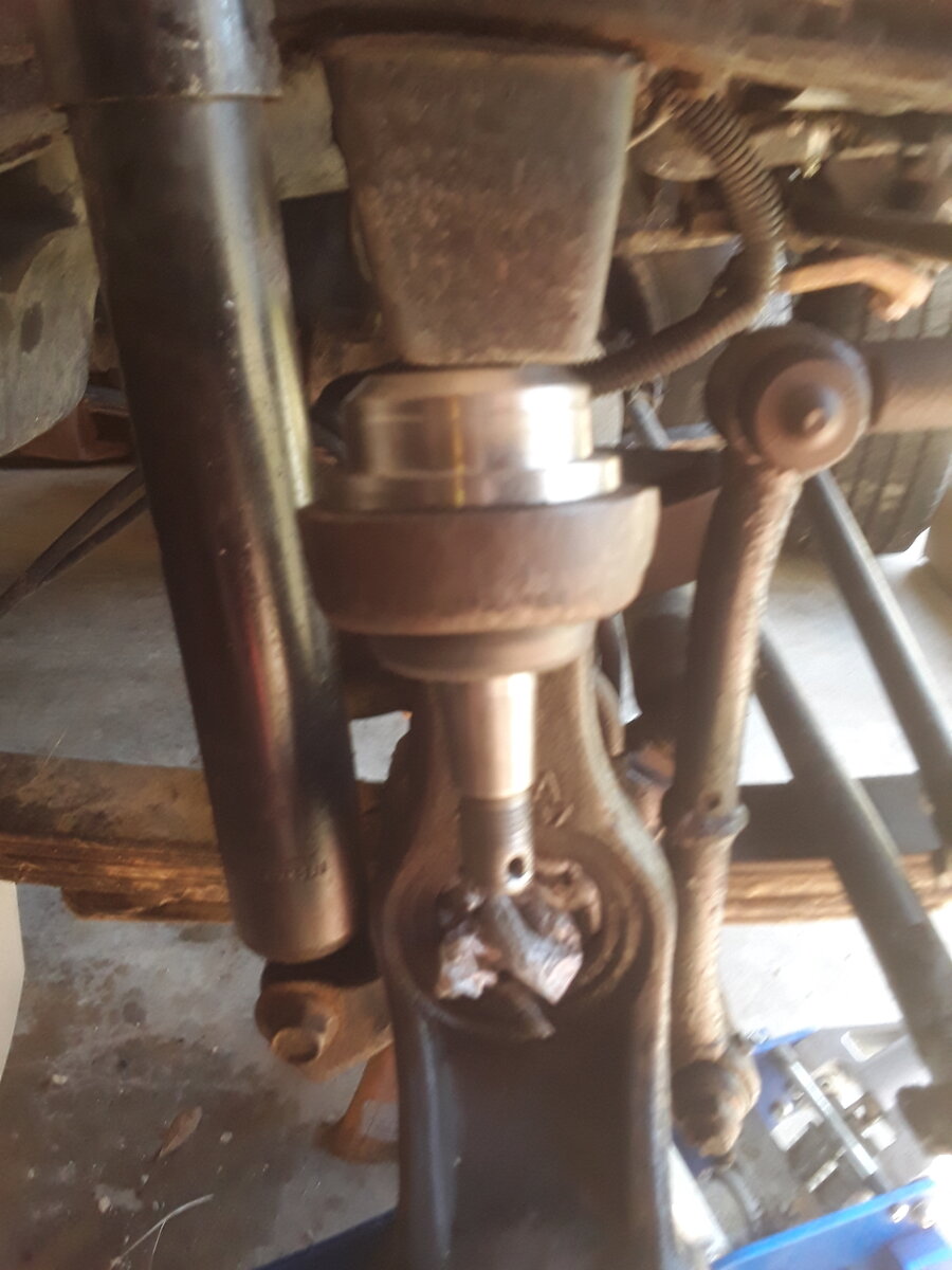

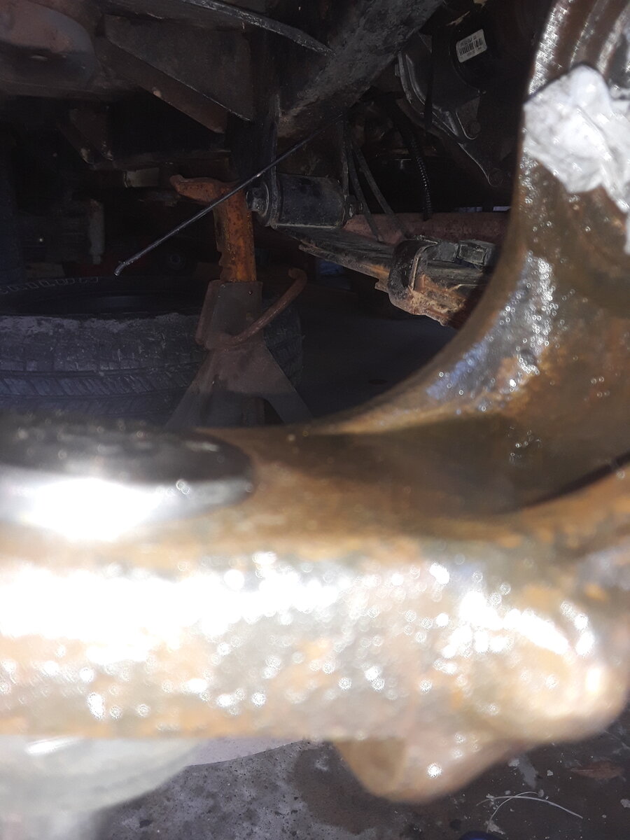

For the Spicer ball joints, how do you know which is bottom/top. There is also no grease fitting on one of them
The one with the grease fitting goes on top. The factory didn’t have a fitting on the lower one just like those don’t. It’s packed with a precise amount of grease internally and doesn’t ever need to be messed with.

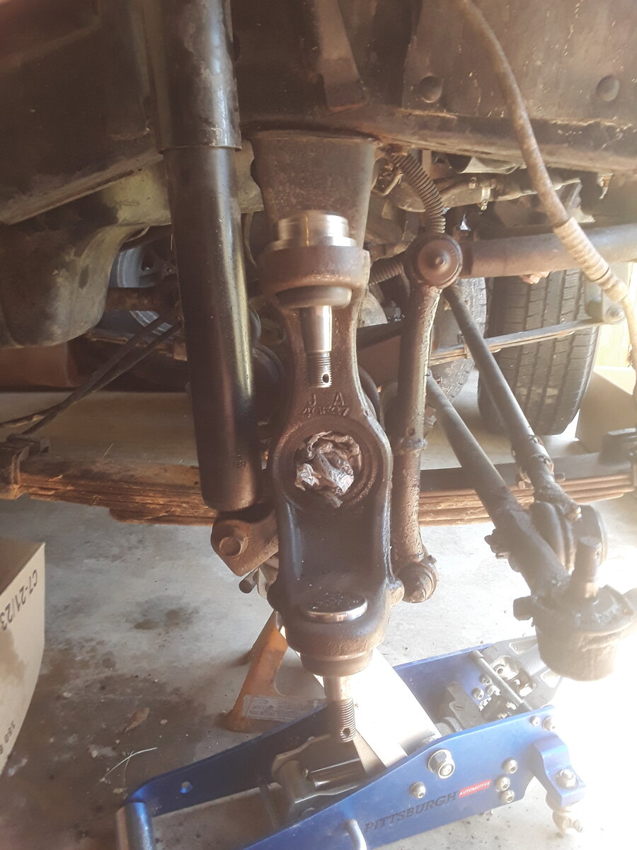

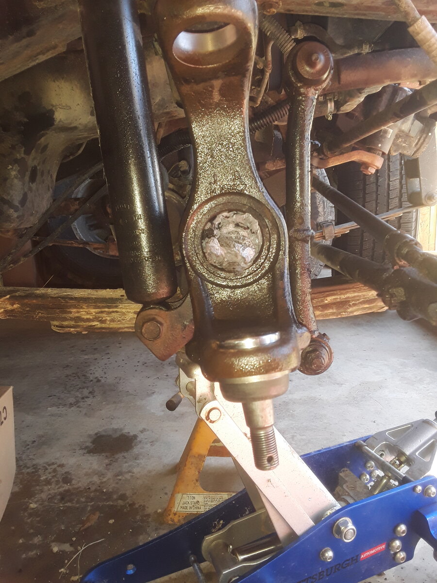

Trying to get to ball joints first.

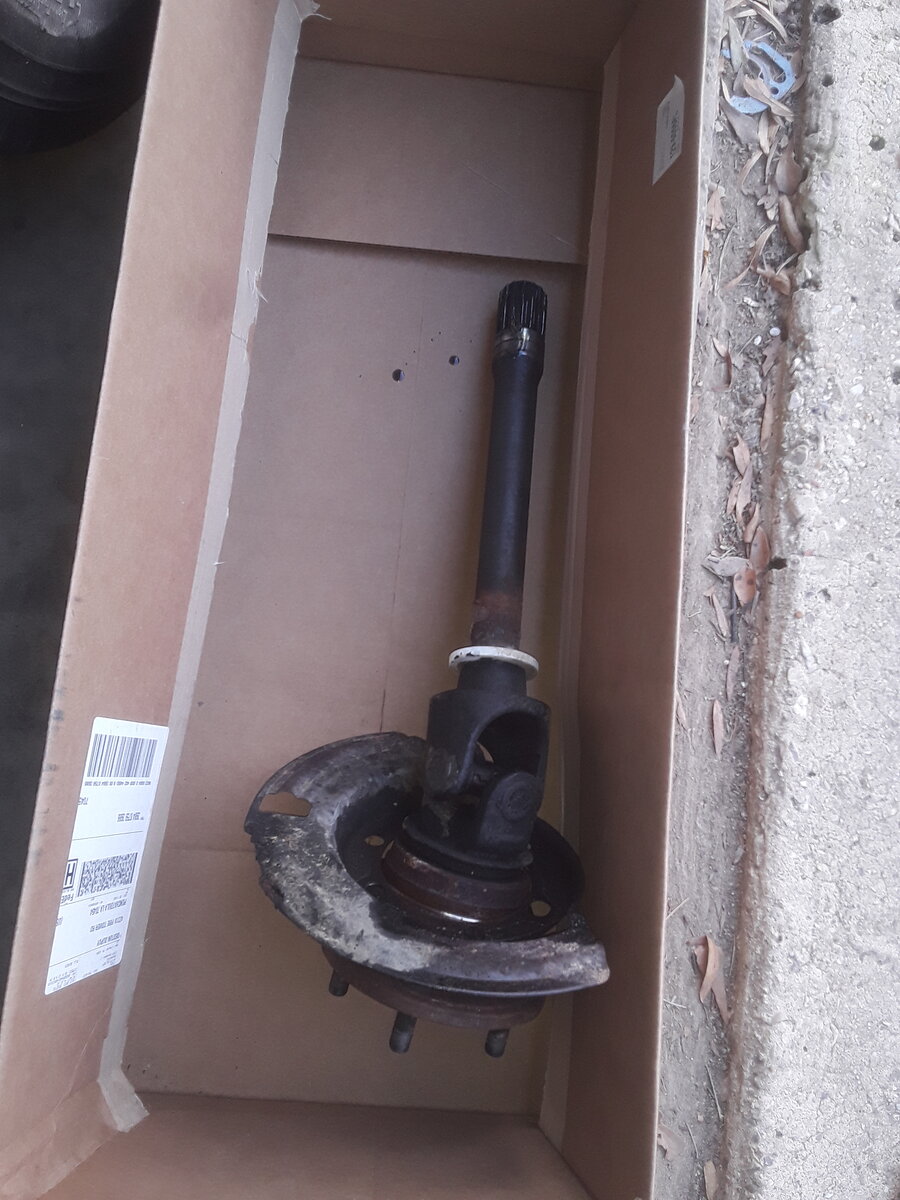

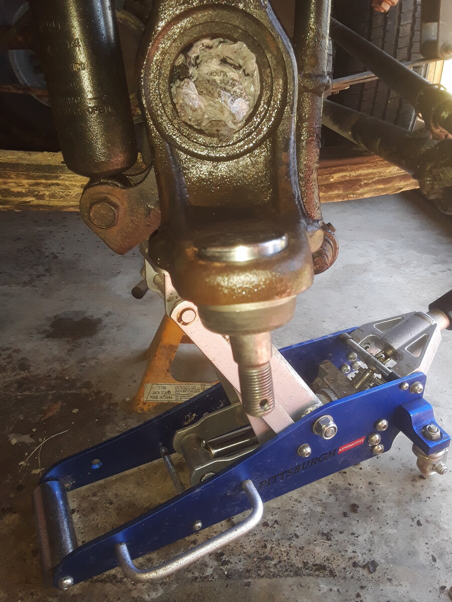

I am having trouble removing the hub and inner axle shaft. It seems to be sealed with rust. Where is it safe to bang to get it loose.I have the 3 bolts out no problem and have the tie rod end off.

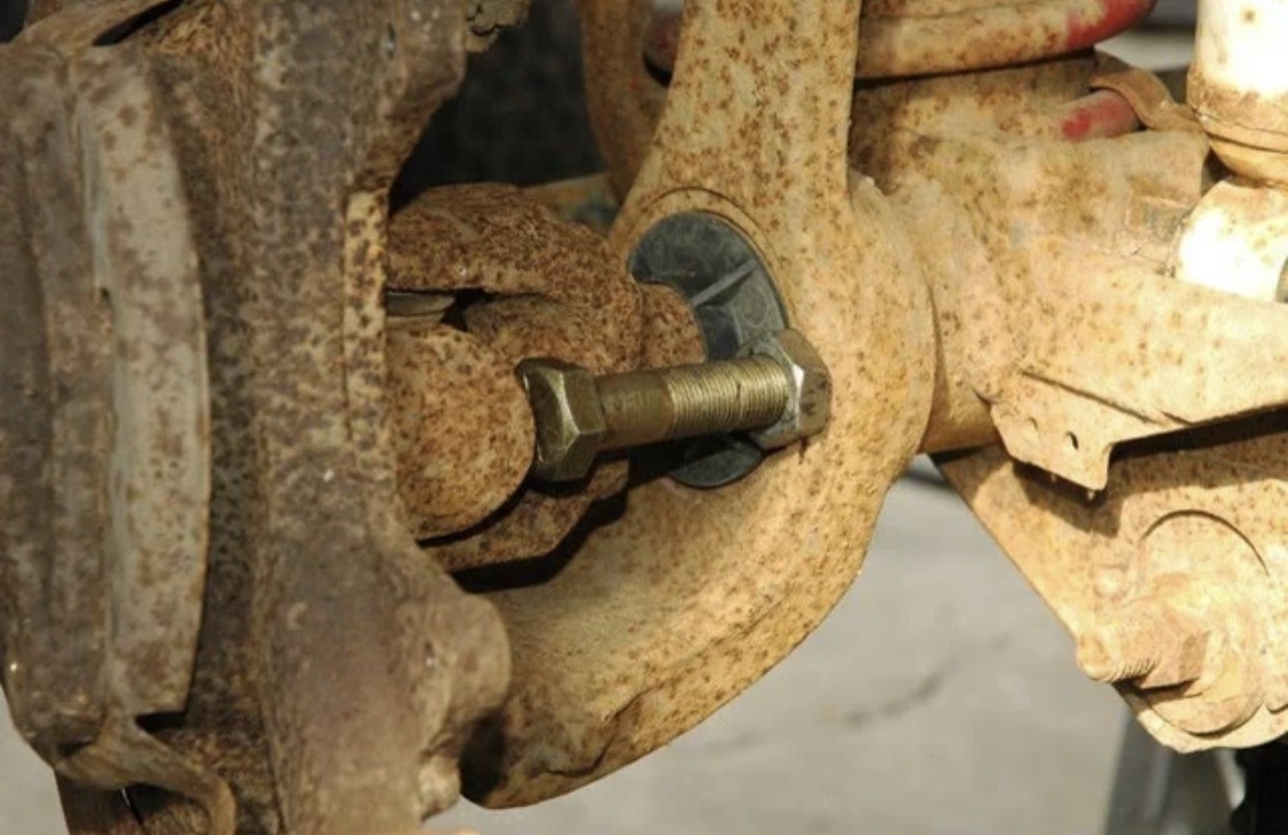

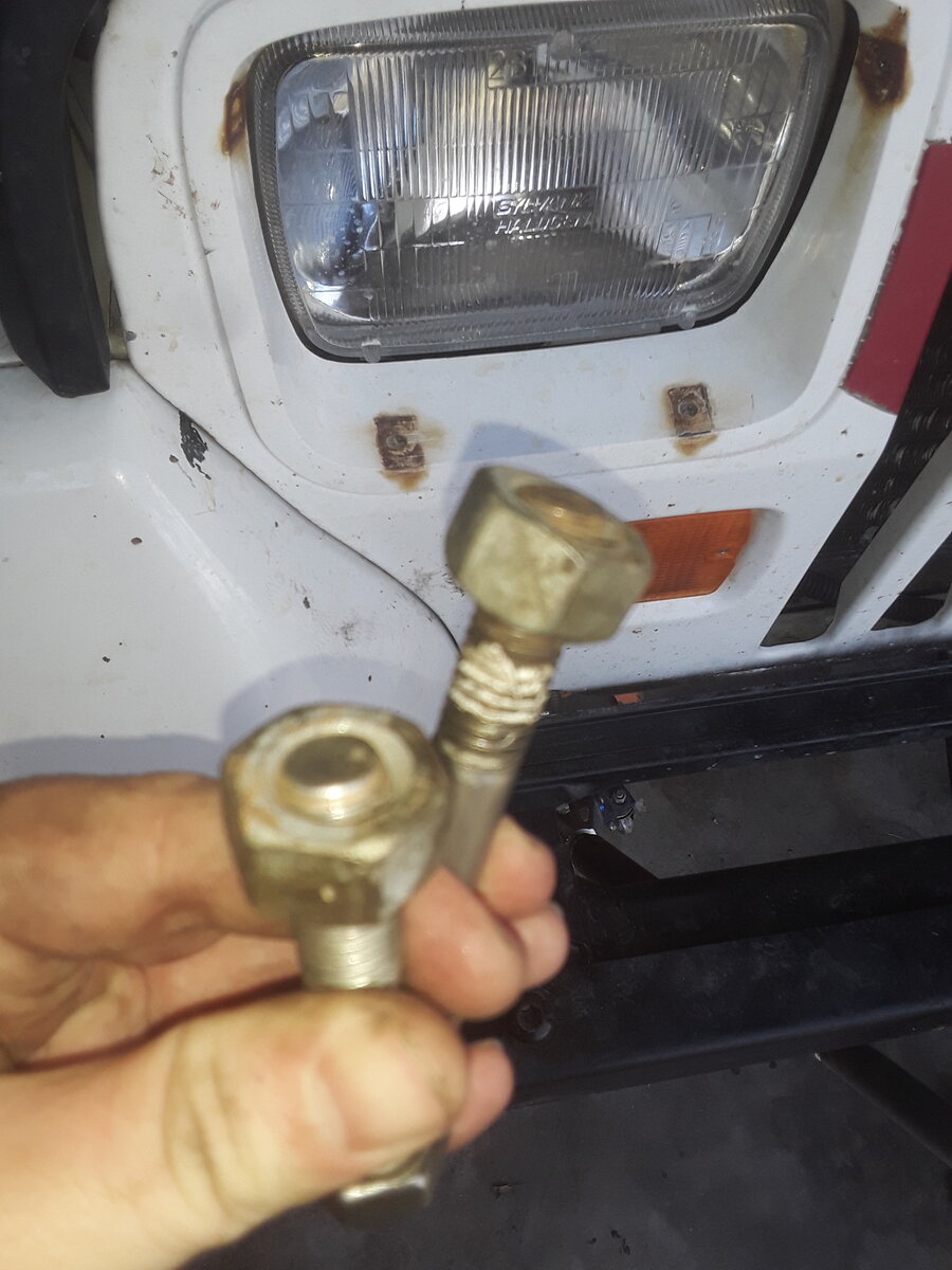

Put a bolt like this and turn the steering. It always works, the leverage is too high against the unit bearing for it to not work.

100% normal. That's built in to allow slight differences in knuckle tolerances to allow any knuckle to mate to any ball joint.

Basically I am having trouble getting the hub flush flat with the knuckle or getting it in the hole, but now that I am tightening the bolts it seems to be going in now
