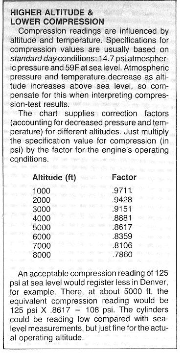

it's old, things happen. the readings are also based on altitude. 3% loss per 1000feet.
par is 120 to 180 psi. sea level. the high number is from vast posters on line reporting, i'd say 150 is par.
the chart that is used by all private pilots is here for the corrections.
done warm, or hot, throttle WOT, (just open some) and sparks plugs all out , battery charged, this is the benchmark.
let the needle peak, okay?
equal is best. 10% variance is a goal (less best)
