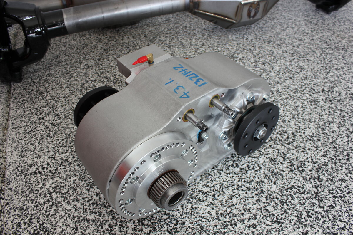

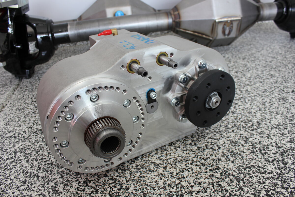

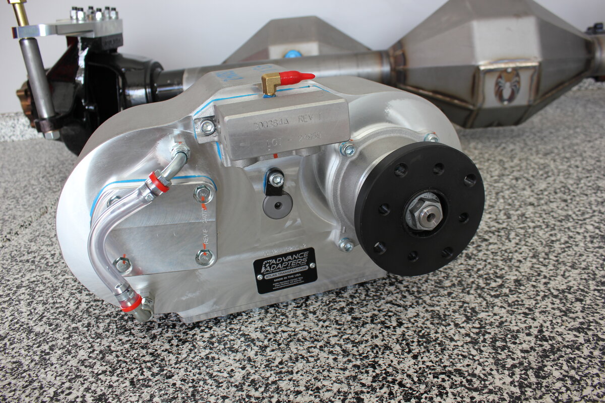

The Atlas has been unpacked and looks amazing.
4.3:1 and driver side drop. Short rear output.
Having the transfercase was the final piece in the puzzle for starting the power train swap.

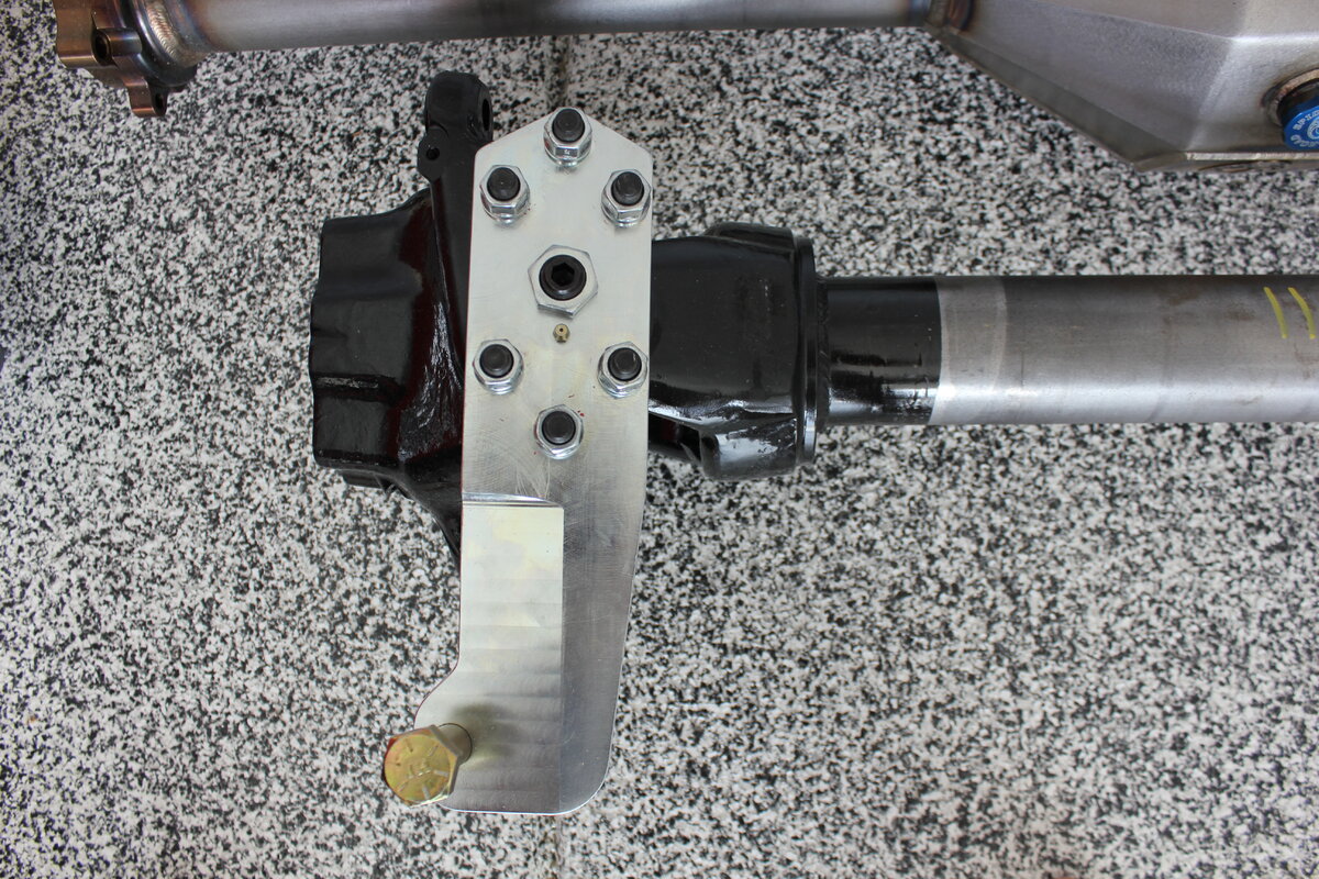

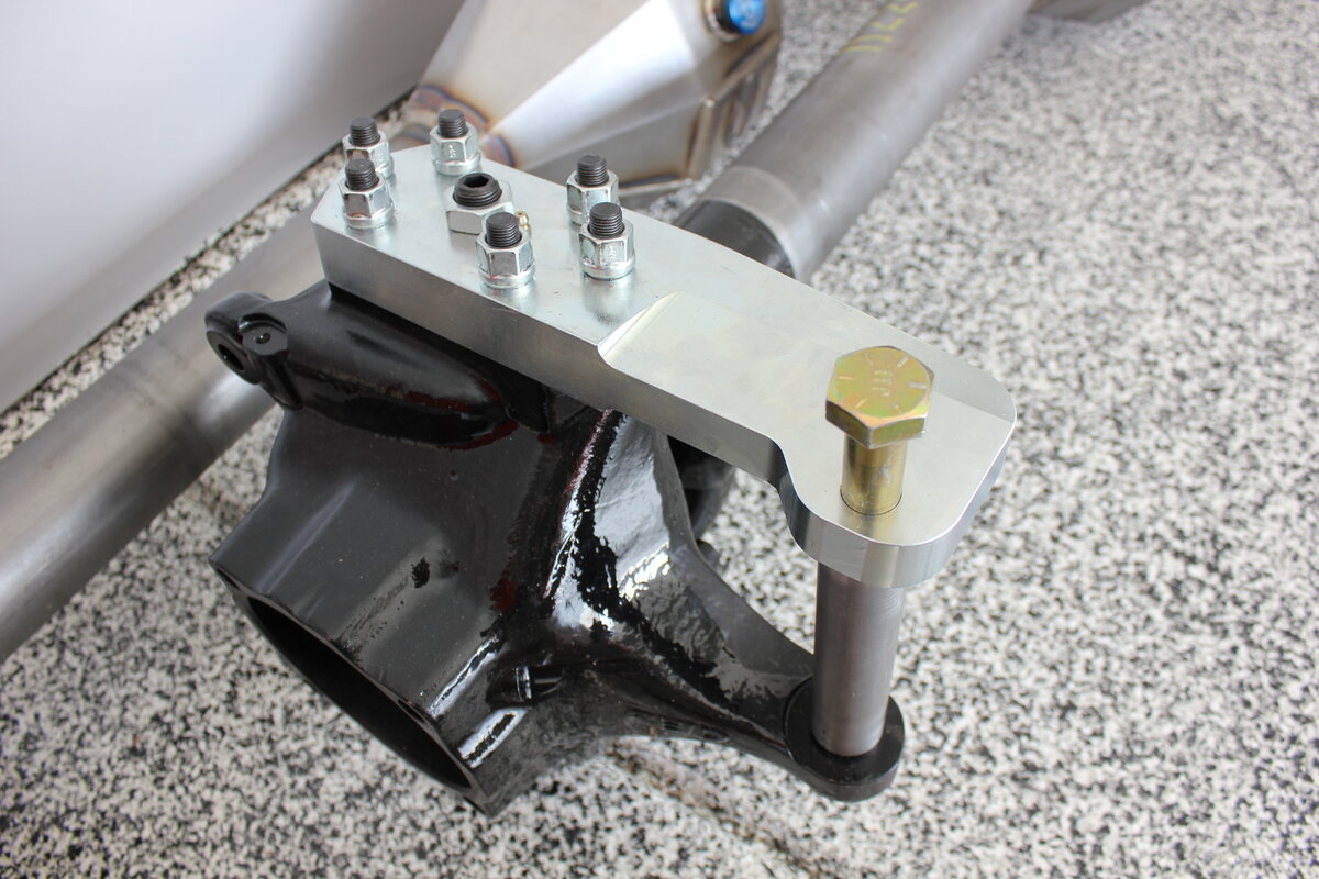

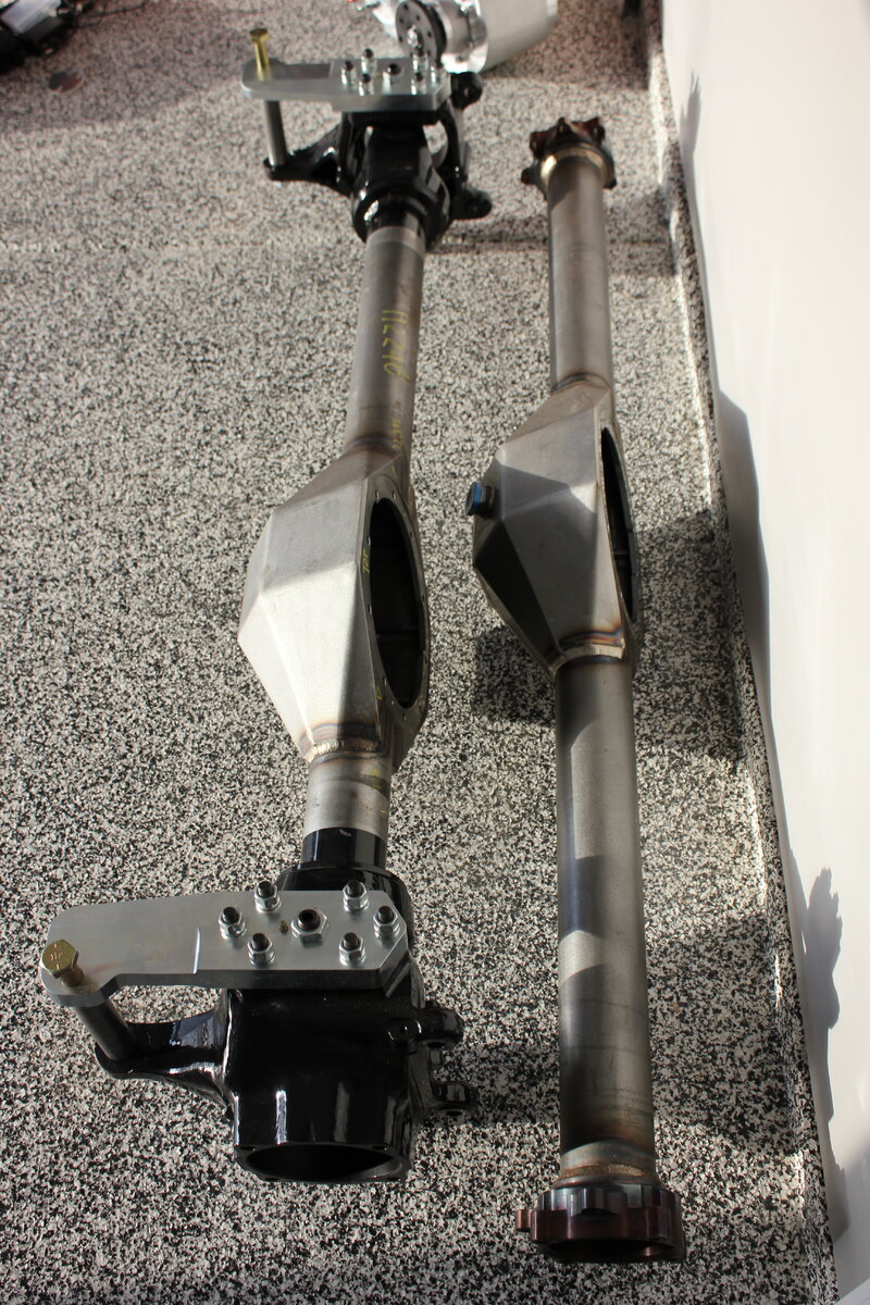

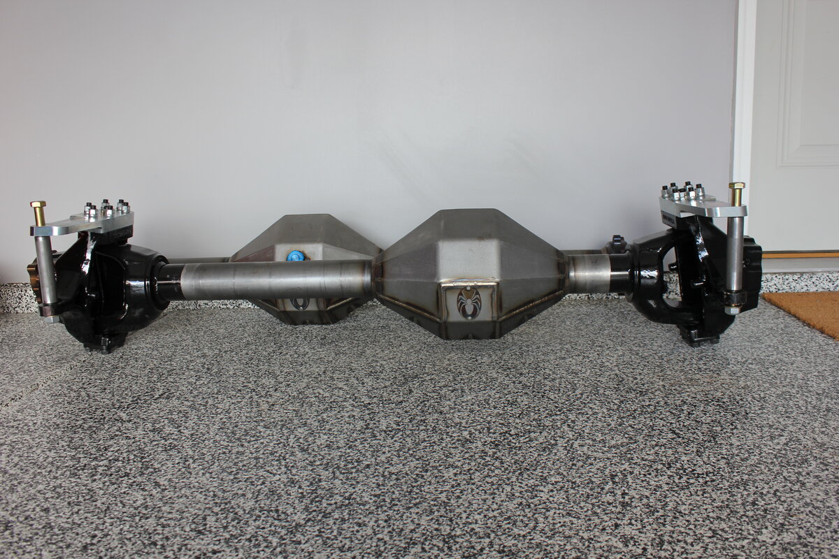

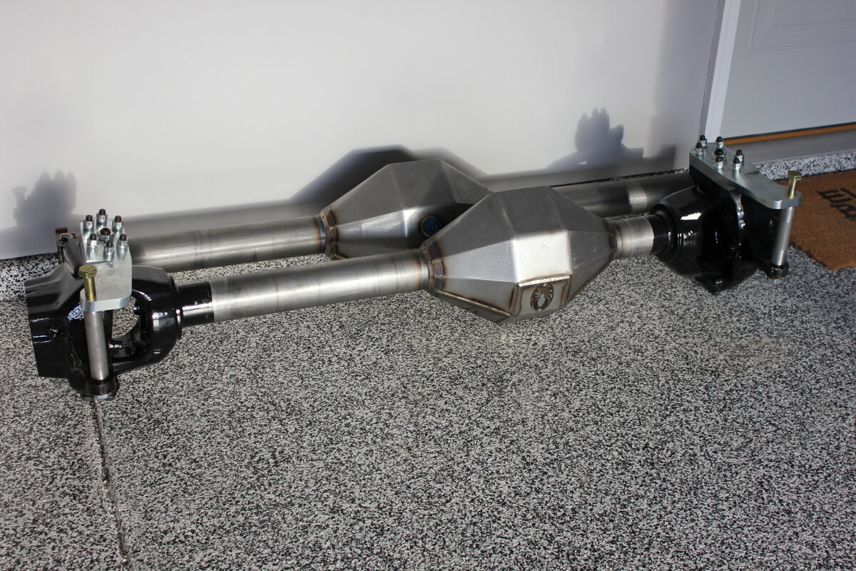

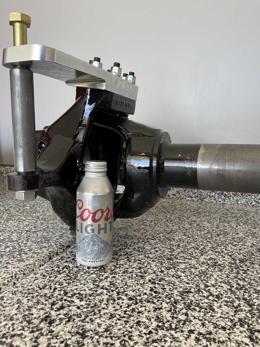

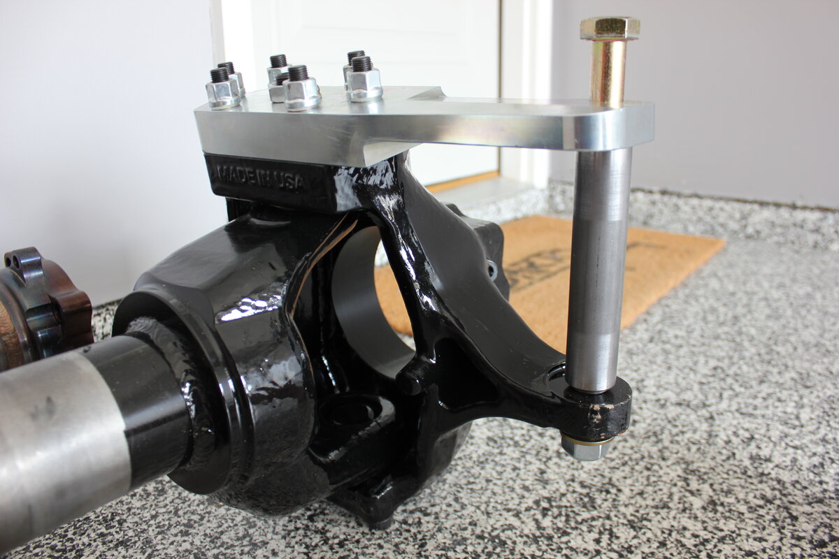

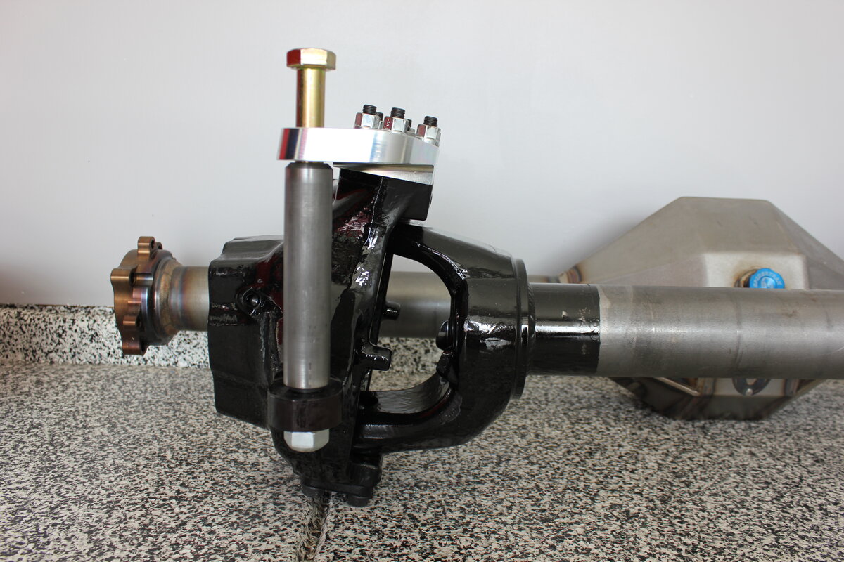

Got the front axle finally done and back in the garage.
- Spidertrax pro series 4130 chromoly 3.5” housing
- Reid Racing 3.5” Super Kingpin Inner knuckles (C’s)
- Reid Racing Super Kingpin outer knuckles
- Driver drop
- 69.5” WMS
- 79 Ford Dana 60 Specs
Couldnt stand the orange paint that Reid’s come with, so painted them black.
Will utilize 05-12 factory Ford Superduty brake calipers and rotors, 8x6.5 unit bearings, locking hub, and a 1480 or 1550 u-joint.
