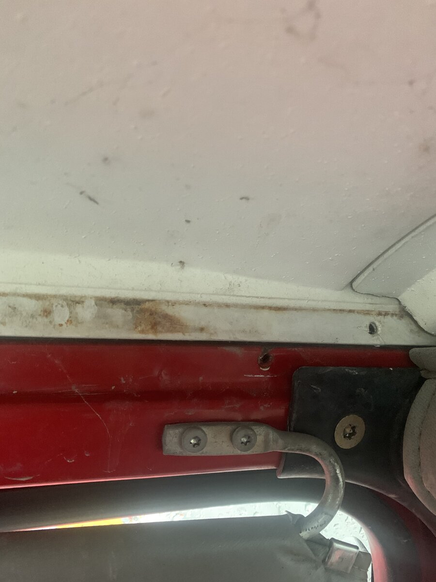

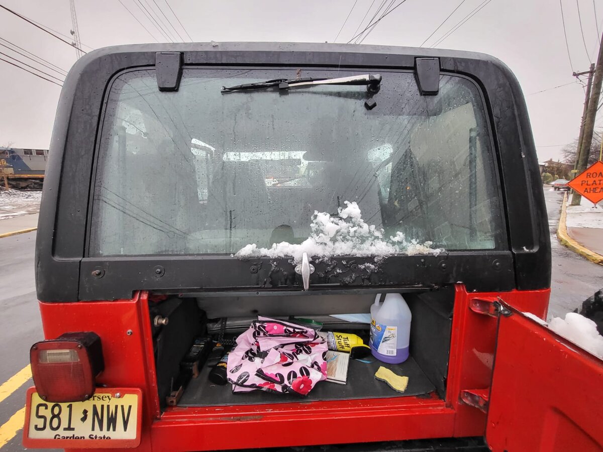

Post pics of it. Hard to offer any advice without pics. Any top from a CJ or YJ should fit your YJ, so I'm unsure why you are having fitment problems. The tubs are all the same dimensions.

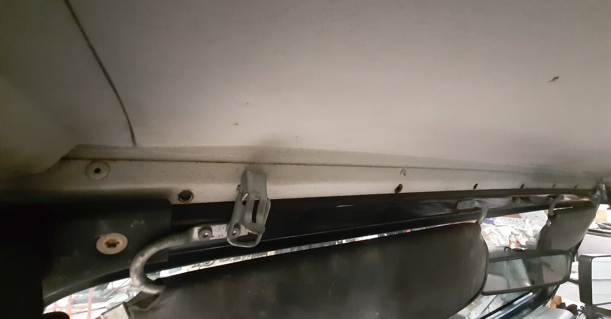

Looks like a YJ top to me...as far as the glass latch, it appears to be oriented in the wrong position, I believe the handle should be horizontal when the glass is latched so that the tail gate closes properly...
It looks like the front could line up if you loosen up the side sport bars where they connect to the windshield frame and then push the frame forward and allow the top to fall into place. FYI, unless you put weatherstripping along the top of the windshield frame, it will leak every time it rains. Once the frame falls in place, tighten up the frame and install the bolts through the hardtop into the windshield frame. If the jeep has never had a softop installed before, you might need to drill holes in the windshield frame. Also yes, the rear glass latch should be horizontal when closed.
