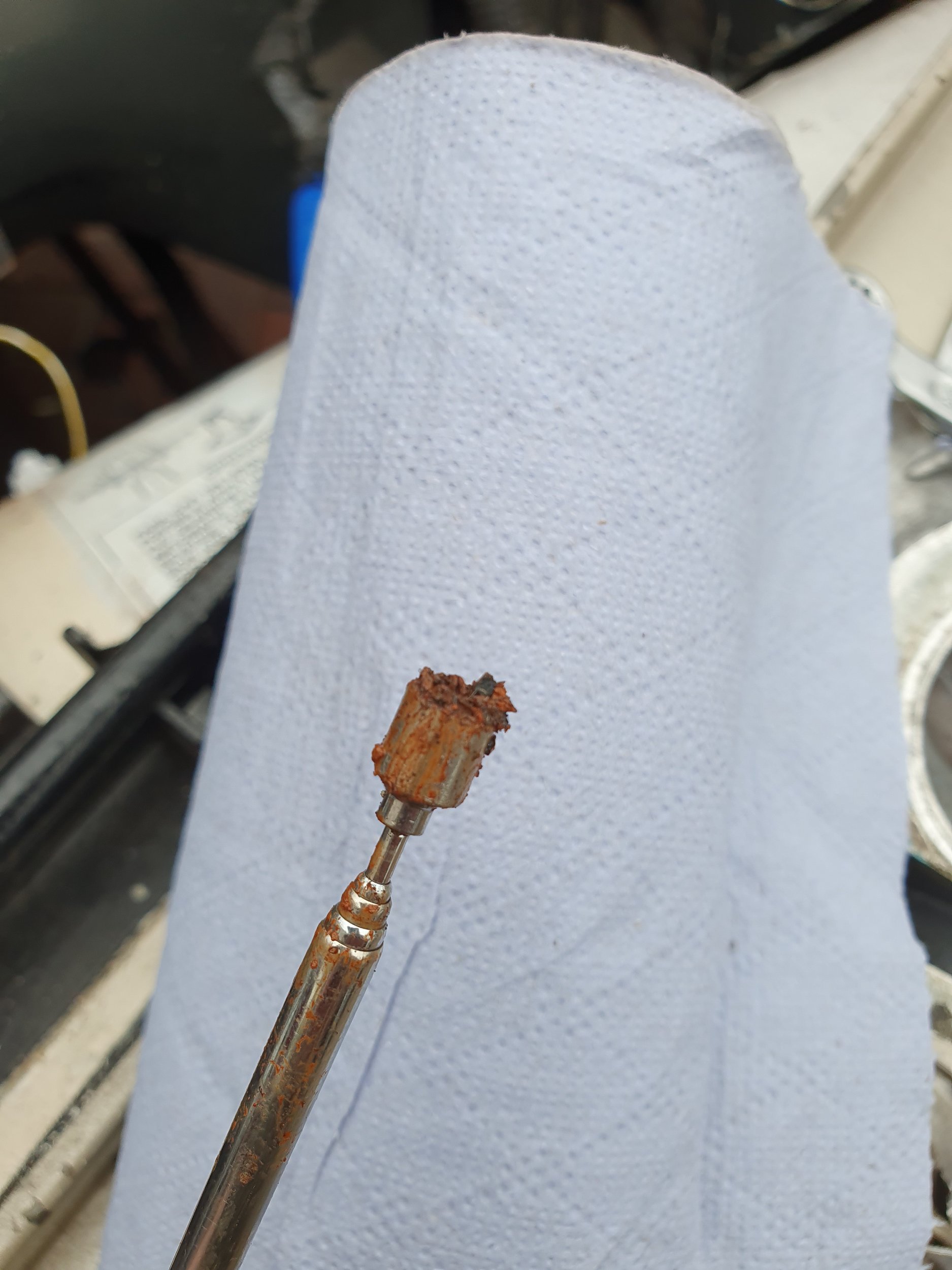

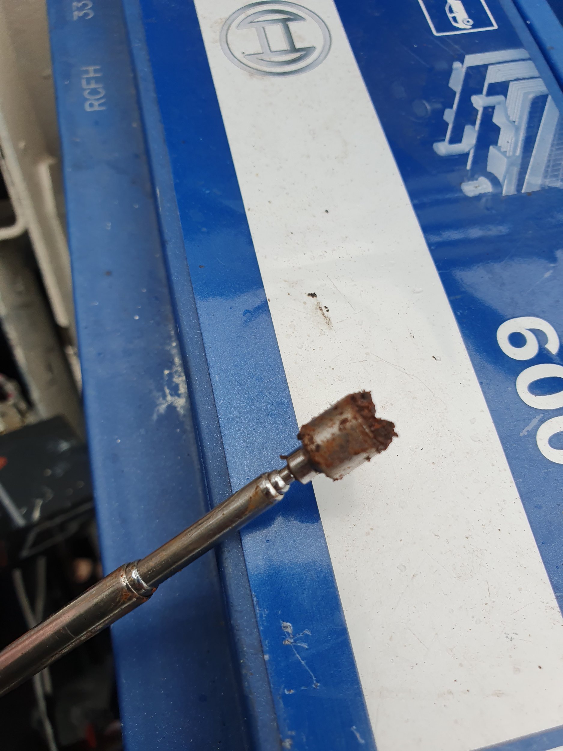

That's coincidental, i was literally searching for anything on a leak from my lower bolt on my thermo housing. Been fine for months, then started a tiny leak out the lower bolt, tried three different gaskets, two new housings and no joy. Maybe it needs thread sealer on the lower bolt of my 2.5l. I'll try that.
I also noticed that when I put a magnetic stick in the thermo hole it comes out with a lot of rusty bits on the end. I spent 30 mins poking and scraping and kept pulling out loads of tiny metal sludge and a few crushable lumps like in the pic.
