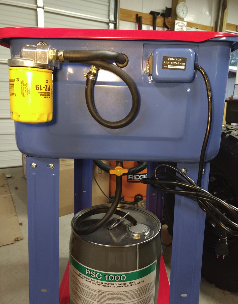

The water based cleaner didn't work for me either. I use PSC 1000 solvent from Tractor supply now and drain the tub each time back into the can. The pump they use is a water fountain pump and I found that draining the solvent out helps. The pump has lasted for several years without failing. Also water based cleaner instantly clogs the filter.
Nice rig!, The best and cheapest parts cleaner for anything.....Ether based Starting Fluid, Yep that starting fluid....I will cut ANYTHING petroleum based even dreaded fifth-wheel grease out of clothing. Doesn't have the nasty carcinogens that brake cleaner has, And evaporates without any residue...Just make sure you're well ventilated and no flames or sparks nearby...
