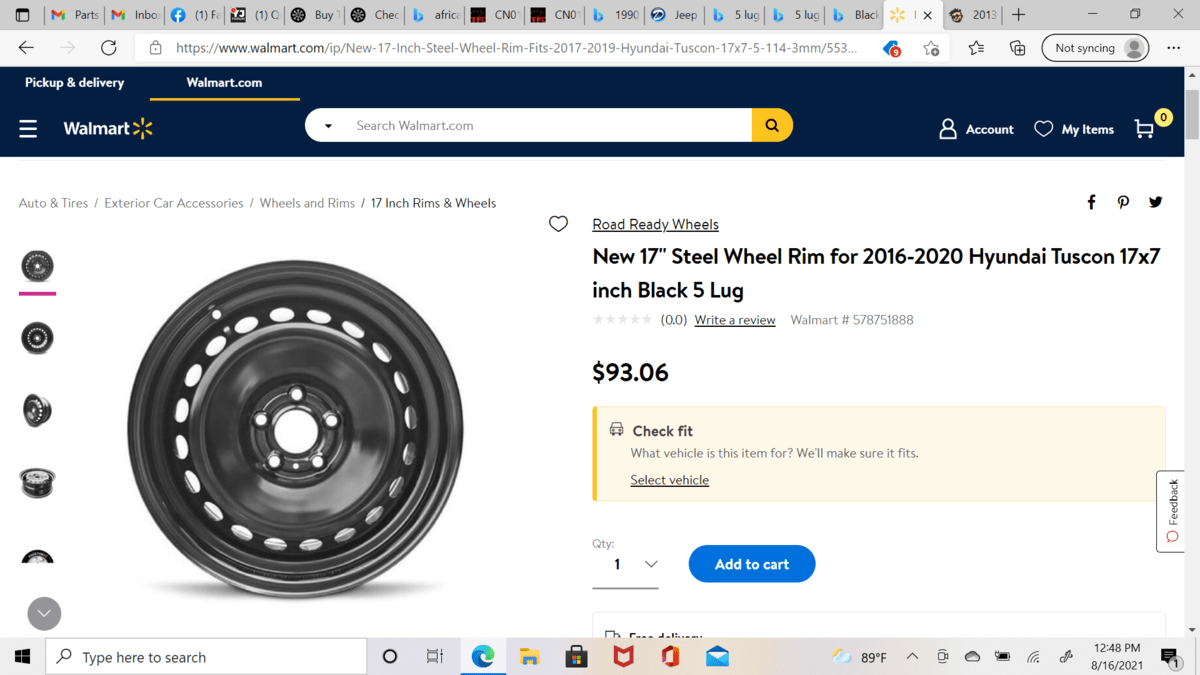

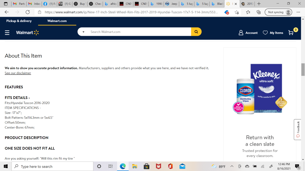

Here are some 17's that are 7". 5 lug 4.5 pattern. I prefer no surrounding holes like the above picture where its all one piece with no cutouts.
You’ll find something. Keep in mind the backspacing/offset. Those ones listed above are 6” backspacing. They’ll put the wheel closer to the frame than stock, and with nearly 32” tires, will definitely rub. Would probably want 1-1.5” wheel spacers.
