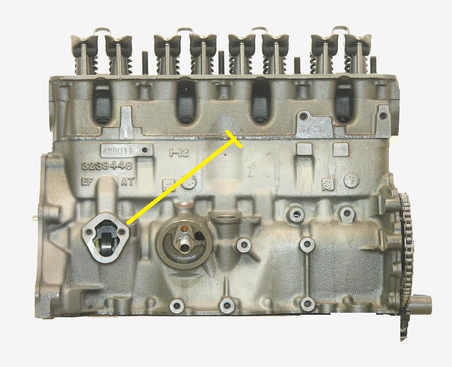

the push rods have a oil path, inside them that feeds oil to the rod/rocker contact point and we make sure all rockers so signs of top end oil to those points
or it will make noise and then fail hard,(wear fast dry)
the engine block oil gallery feeds each actual HLA with full oil pressure (40psi is par) then then pump up and noise ends until they are gummed up or SHOT
Shot means worn to death EOL, end of life this. RIP it.
