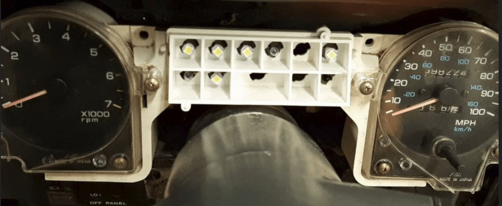

I'm finding the warning lights are 74, T5 bulbs and the gauge lights are 194, T10
Has anyone installed these? I'm reading some flicker. Any recommendations?

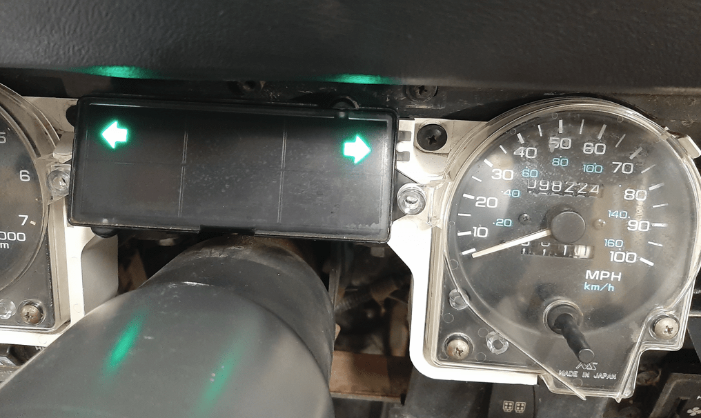

Oh yeah, much better. $6 for qty. of 10 through Amazon and they arrived the next morning at 9:30am. Now you won't see me driving down the road like an old man with my blinker flashing. These are now easily daylight readable over the original incandescent.
I didn't change the seatbelt and "Up arrow" time to shift lights so they'll stay dim.

I changed only 5 of the warning lights because I didn't care about the seatbelt or the little arrow telling me when to shift. The arrow is wrong anyhow when using bigger tires. The gauge cluster uses a different size bulb and I was going to wait to see how I liked the warning light before going ahead with the gauge lights. I think it's only one light for each gauge.

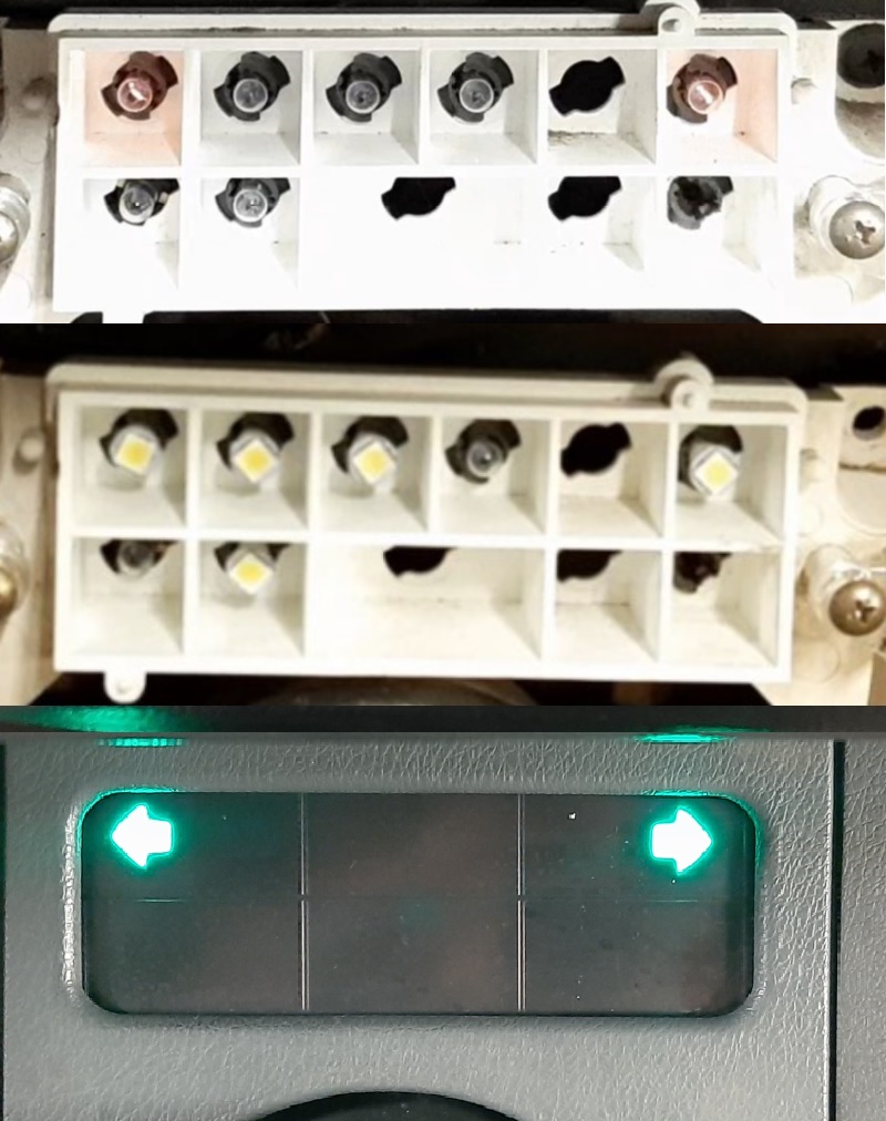

On the flip side - I 100% recommend LEDs in the idiot lights. The stock bulbs there are way too dim, especially the turn signals when the top is off and sun is out. can’t see them at all. I run colored ones behind each lens which produces an incredibly nice looking color tone and brightness on each. I need to put a small ohm value resistor on the CEL so it will quit staying dimly lit when the key is on.

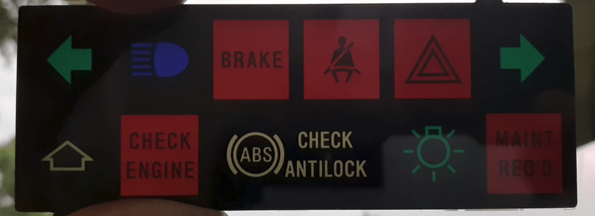

Hah, the idiot lights are the ones above the column. Turn signals, high beam, check engine, park brake and seat belt. Those are #74. I deleted the seat belt buzzer and light, so I needed two reds (parking brake & CEL), one blue (high beam), and two greens (turn signals). For some weird reason the PCM outputs a small amount of voltage on the check engine circuit when the the key is on. It’s not enough for a bulb to light up but an LED will light up dimly so a small ohm rating resistor can be used to waste that energy to keep the led off.

Quick question, how do you remove the cover off the lights? And do you know what all the lights are for/icons. My shift arrow is staying on all the time and I checked for codes and nothing so I believe the light is missing and need to check it.

That shift arrow is a vacuum switch hidden somewhere and is usually wrong with bigger tires. I'd just remove the bulb and drive on.
