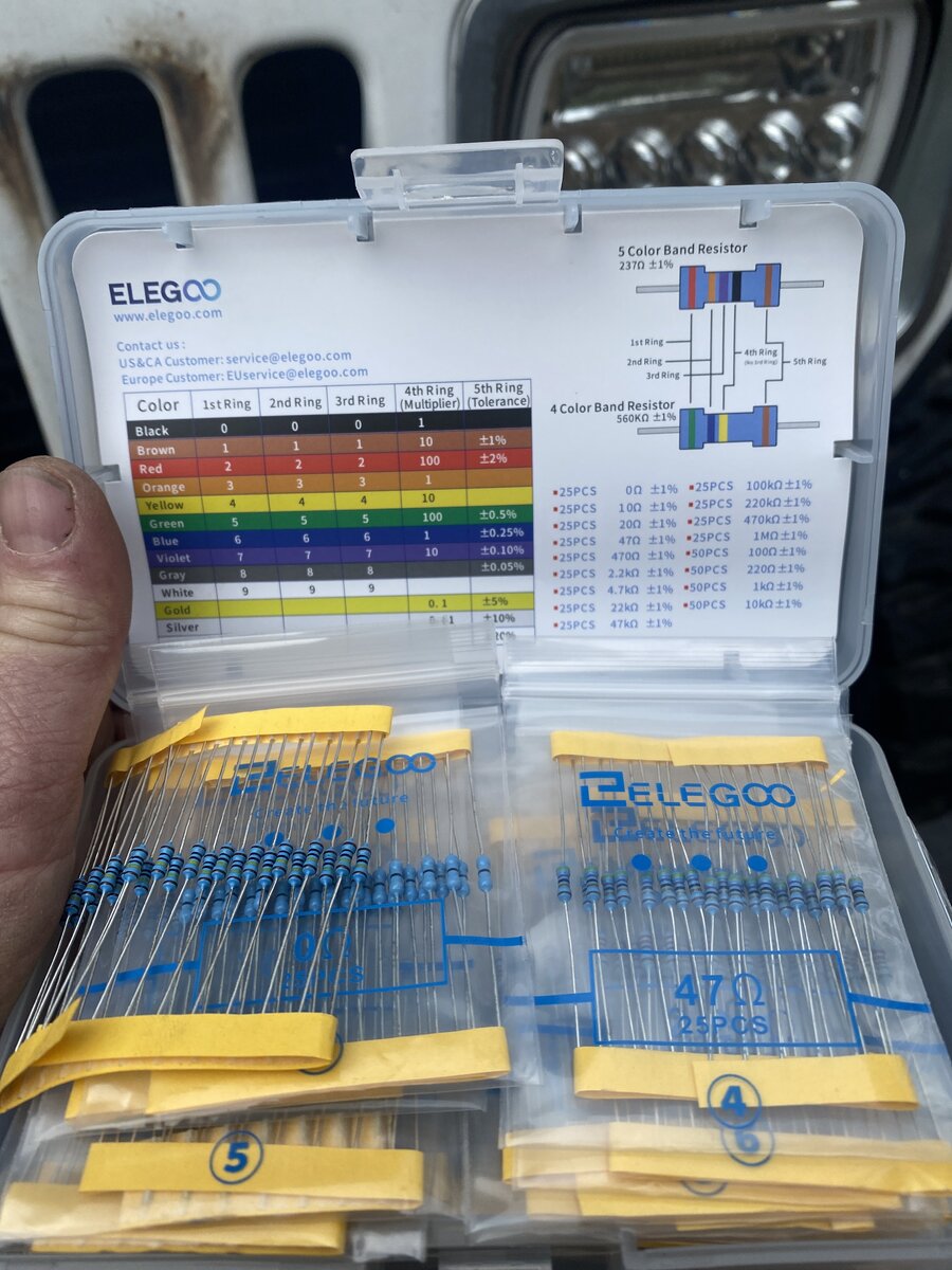

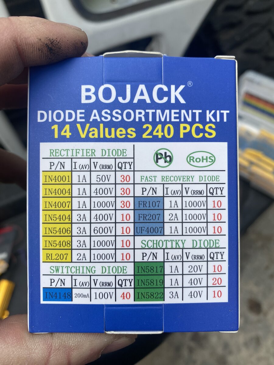

What resistor and diodes did you buy? I wonder if they’re blocking the current the light needs. That’s a bigger light than most people use for a turn signal. I use bulbs in stock housings personally.

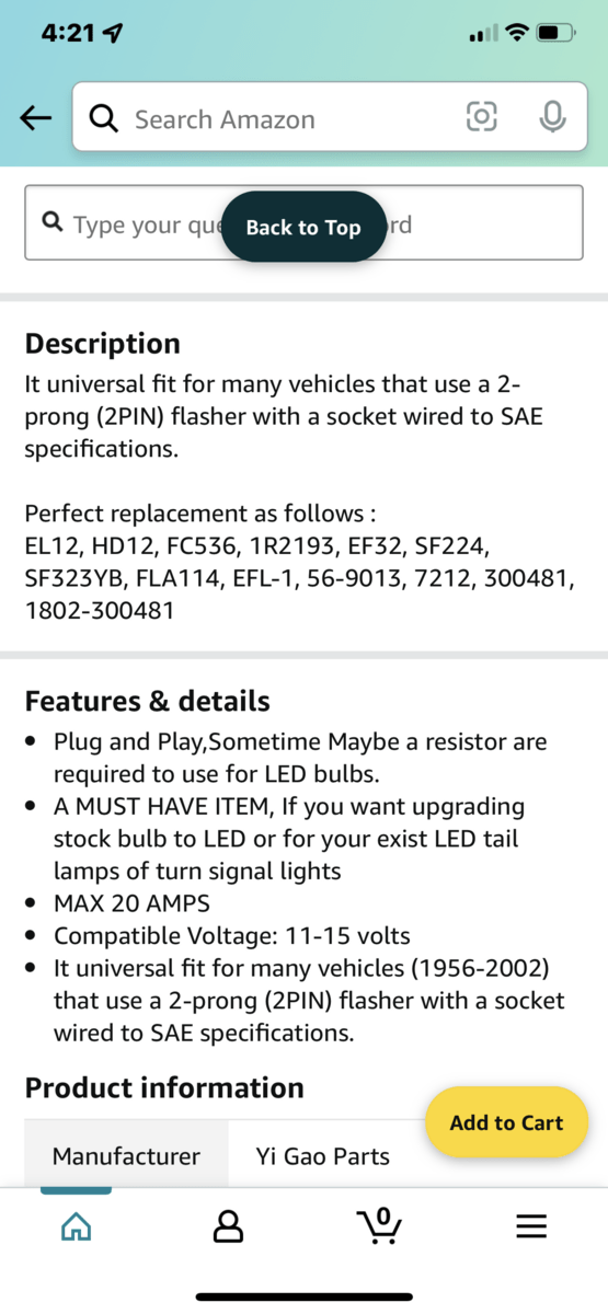

Go with the EF32RL from Amazon. Ground the wire. Buy two of them, one for hazards and one for turn signal. I am not familiar with the one you posted and it might be a cheap junk part that doesn't work right. Some of them also only support a few LEDs and need you to still have some glass bulbs in the circuit to work right. The EF32 is fully electric and doesn't need any bulbs to operate properly.
