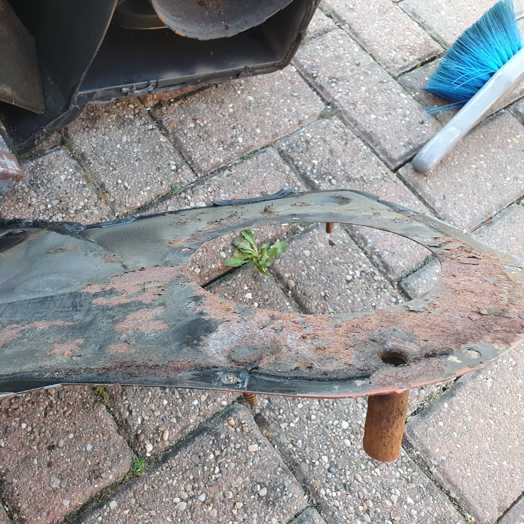

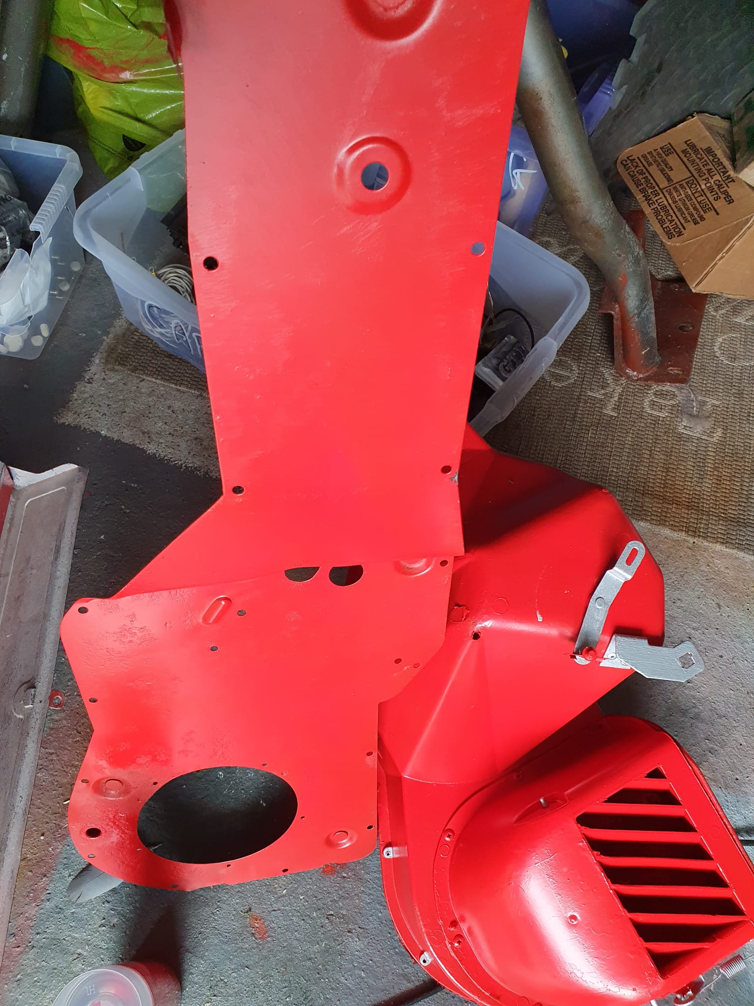

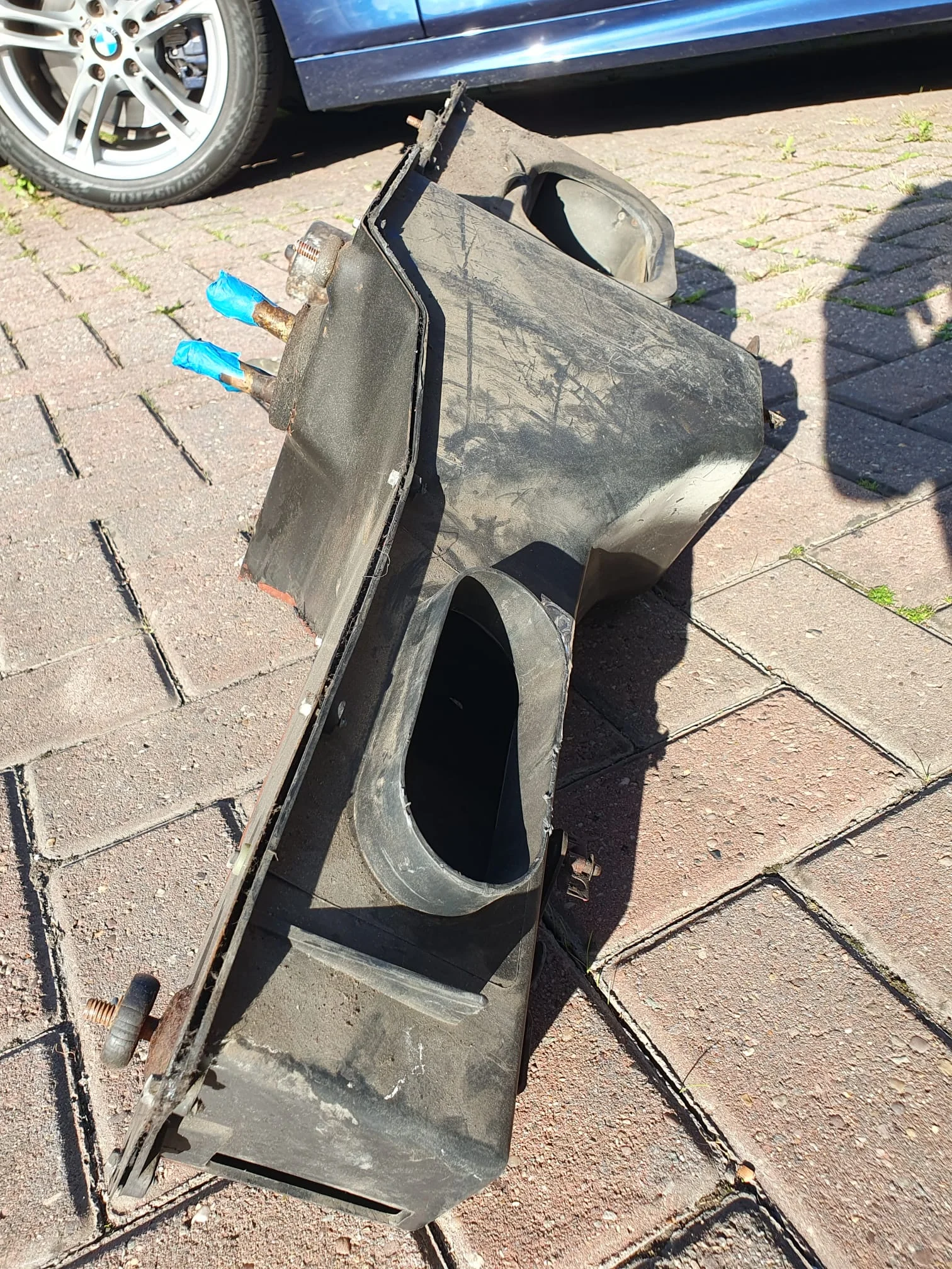

I installed a new core exchange in the heating box and totally cleaned up the whole box and reinstalled it.
It does blow 'warm' air and the levers and flaps are all working properly, but it never gets 'proper' hot air.

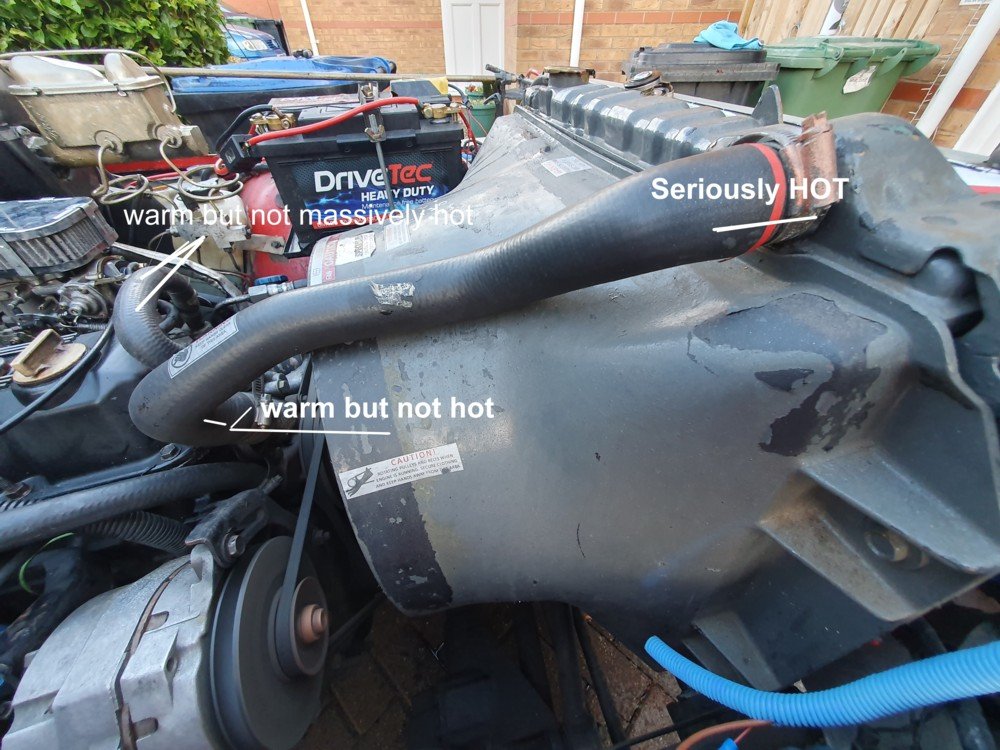

The pipes into the exchange are piping hot, but the ones coming out are not so hot.
I also noticed I'm constantly topping up the reservoir tank. I burped the car on a slope and there's no bubbles coming out.
I squeeze the top rad hose and near the rad end it's almost too hot to touch after a good run. But the other end that goes down to (or from?) the thermostat is much lower in temp.

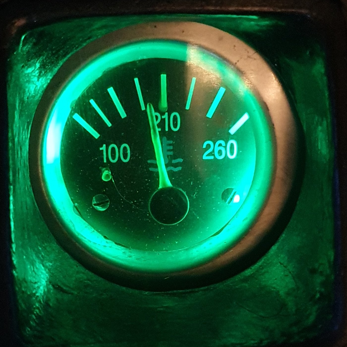

10 mile spirited drive in 4th to get it fully warmed up:
Engine running gives;
Block reads 195
Airvent in cab reads 30
Top hose at rad end reads 120
Top hose at stat end reads 105
Inlets read 170
Rad cap 102
Temp gauge reads below 210
Exhaust at block reads 358
Are these decent temps?

What temps do you get on the lower radiator hose? I wonder if you have the wrong water pump installed or one with a backwards impeller.
The upper radiator hose is where coolant comes into be cooled, so to be cooler at the thermostat end than the rad end sounds backwards and like maybe the wrong water pump is sending things the wrong direction, and as such, the heater is not getting correct coolant flow.
not sure what all the numbers should read, temp gauge 210 look good. back in Oct you were having a problem with heater, bled the air out and you started getting good heat. with all the clean up work you done recently i wondering if you got air in there again? what degree stat are you using? it just my wild guess but the inlet reading of 170 just coming out of motor seems a bit low?

Nuclear? Haha. I wish. Nah. Mine is warm but not super hot. I did do a decent flush when I reconditioned the housing and put a new core in. Totally flushed the system every which way and a crap load of sludge and pink chalky stuff came out. Maybe something got left behind and is now blocking the system a bit. I'll do a reflush and start again today.

The heater should get hot regardless of thermostat status. And when cooling properly, Lower radiator hose should be warm but not really hot because the radiator should have removed much of the heat.
