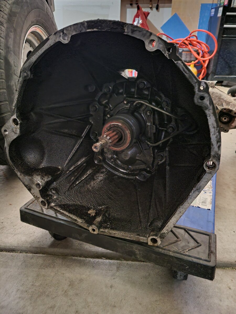

Doing a clutch replacement in my 90 YJ and the transmission is as dirty as a $3 lady of the night! Oil and grease everywhere. My biggest concern is that inside the bellhousing, all around the throw-out bearing and inside walls is a large amount of wet oil. When I pulled the bottom (driver side if it matters) bolt from the engine to the trans I actually got a couple of drips that came out. I would say it seemed more like a gear oil than engine oil, but who knows, its an old girl I just picked up and this is project 1.
Thoughts on where this is coming from? I dont want to throw a new clutch in it if its just going to get oiled up. Is this normal?

That's a mess!
Definitely not normal and you are right to be concerned for a new new clutch.
I'm not too familiar with the AX15 or where it might leak like that, given you think it's more like gear oil.
What does the back of the motor look like behind the flywheel?
Any or all of the three fluids in that area, Engine oil, Transmission oil, and clutch fluid.
Look at the forward side of the flywheel to see if it's wet. That would be the rear main engine seal. Not too bad to change if it's a 4.0L.
When you change the clutch slave cylinder (You will change it now right??) see if you can find a leak on the forward seal of the transmission. Also easy to change and might be worth the few bucks to do it now.
Other seals on the transfer case are easy too.
I think you would know if the clutch fluid is getting low over time to be leaking that much fluid.
A little oil goes a very long way with everything spinning around inside the bell housing.

I vote for transmission input shaft seal. Slave cylinder has brake fluid, that’s a light hydraulic fluid, engine oil you would know the viscosity of when you saw it. Originally the manual trans would have had gear oil.

I'm leaning toward the rear main seal, if the input shaft seal was leaking the splines would also be oily.
Reactions: Flyer58 and ytradio

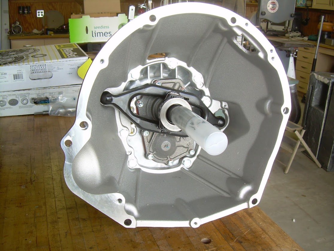

Is that what a 4.0 bell housing looks like? Much different shape than the AX-5 on a 2.5L. I'm surprised there's that big a difference.

Yes, 2.5 has a GM bellhousing pattern which has the flat top with bolts at 11:30 and 12:30 vs 12:00. 4.0 has the old AMC bolt pattern which is rounded. The 2.5 starter also bolts to the engine whereas on the 4.0 it bolts to the bellhousing. Everyone always says the 2.5 is basically a 4.0 with two cylinders chopped off and while that is true for a lot of the engine, the rear end of both engines are very different from one another.

Did a '94 4.0 AX-15 swap from a '95 2.5 with a AX-5.....Really don't recall a huge difference between the bell housings other than how the starters were mounted....And the shifter port is brought back a couple of inches......

Somewhat subtle but it is there.
2.5/AX5
4.0/AX15
The clutch release components (slave, fork, fork pivot and retaining spring, TOB) are the same, although the engines use different flywheels & clutches. The RMS is different on each (1 piece on 2.5, 2 piece 4.0) and pilot bearing is installed into the crank on the 4.0 and into the flywheel on 2.5. Nothing groundbreaking, but the differences are there.
