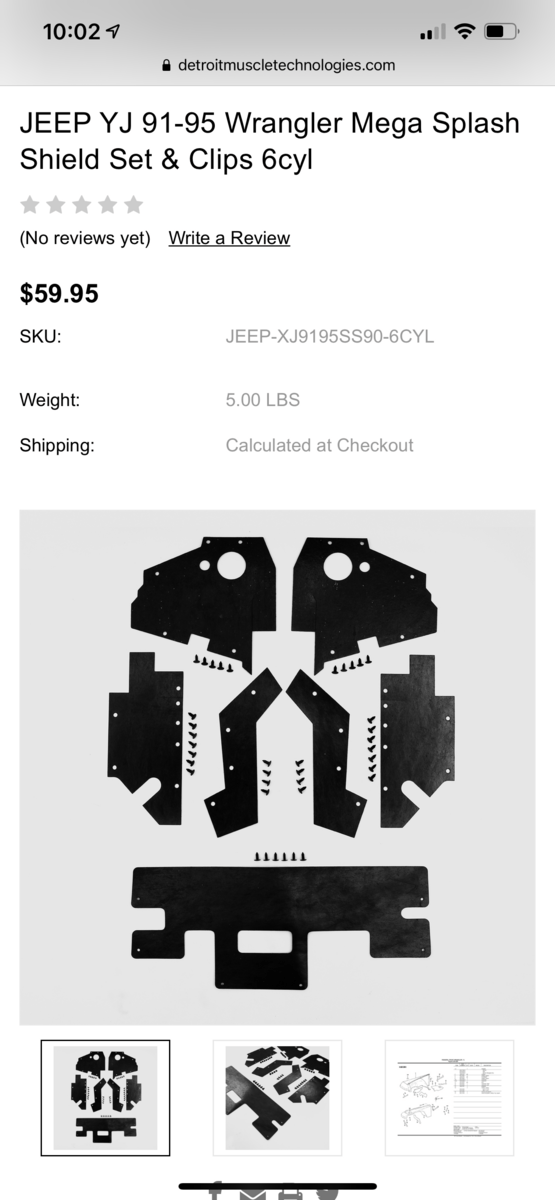

I’m doing the same with my 92 YJ. I personally like having the liners in the front to keep stuff from flying into the engine compartment. If your looking to replace the front splash shields I found this set. The website is www.detroitmuscletechnologies.com
Reactions: ytradio and Flyer58
I ordered some of those a while ago actually. they are decent, but mostly useless if you have a body lift. I have a 1.25" body lift and I couldn't hardly make any of it work. Especially not the ones under the engine. Unfortunate. Be cool if they made a body lift version which gave you slightly taller liners.
Reactions: Justin Schuring
Oh wow I didn’t know that. Thanks for the info/reply.
Sure. Don't get me wrong, very nice products from Detroit Muscle Tech. they replicated stock completely. They just didn't really fit right anymore with the body lift I have. They still clip to the fenders fine, but when they hang down they don't cover the fender to frame gap as much. Also, with the one under the crank to the radiator, with my motor mount lift it cleared the motor fine, but my radiator went up with the body lift which was pulling on the liner too much and pulled it up into my crankshaft pulley. So overall that one didn't work at all. Great products, just not really applicable to a body lift setup. If you have no body lift I am pretty certain they would be perfect.
