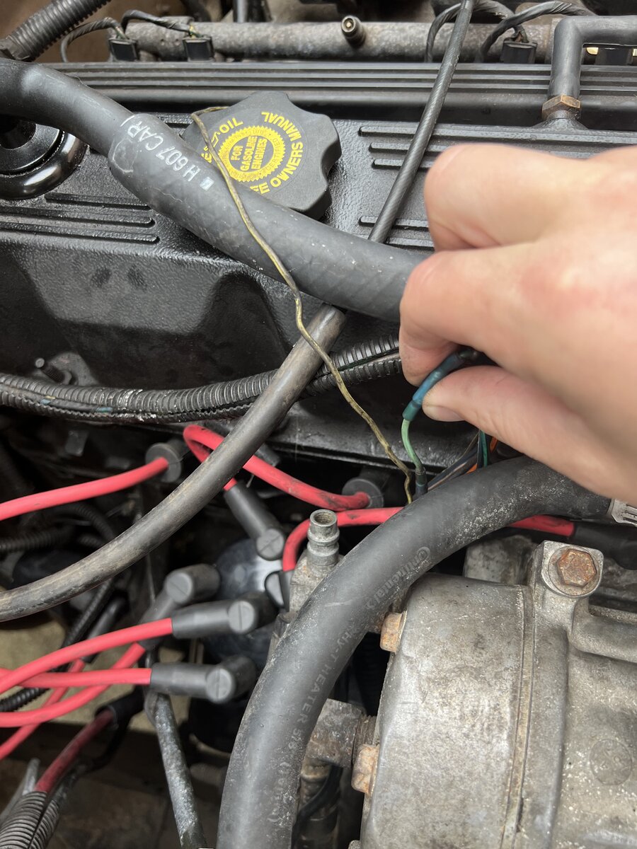

@HDSlowride i ended up fixing mine. Same issues and was throwing the same parts at it. Ended up repairing a wire to the alternator that ran from the engine valve cover side loom down to the alternator. Looked like a factory splice that may have gave up after so many years.
