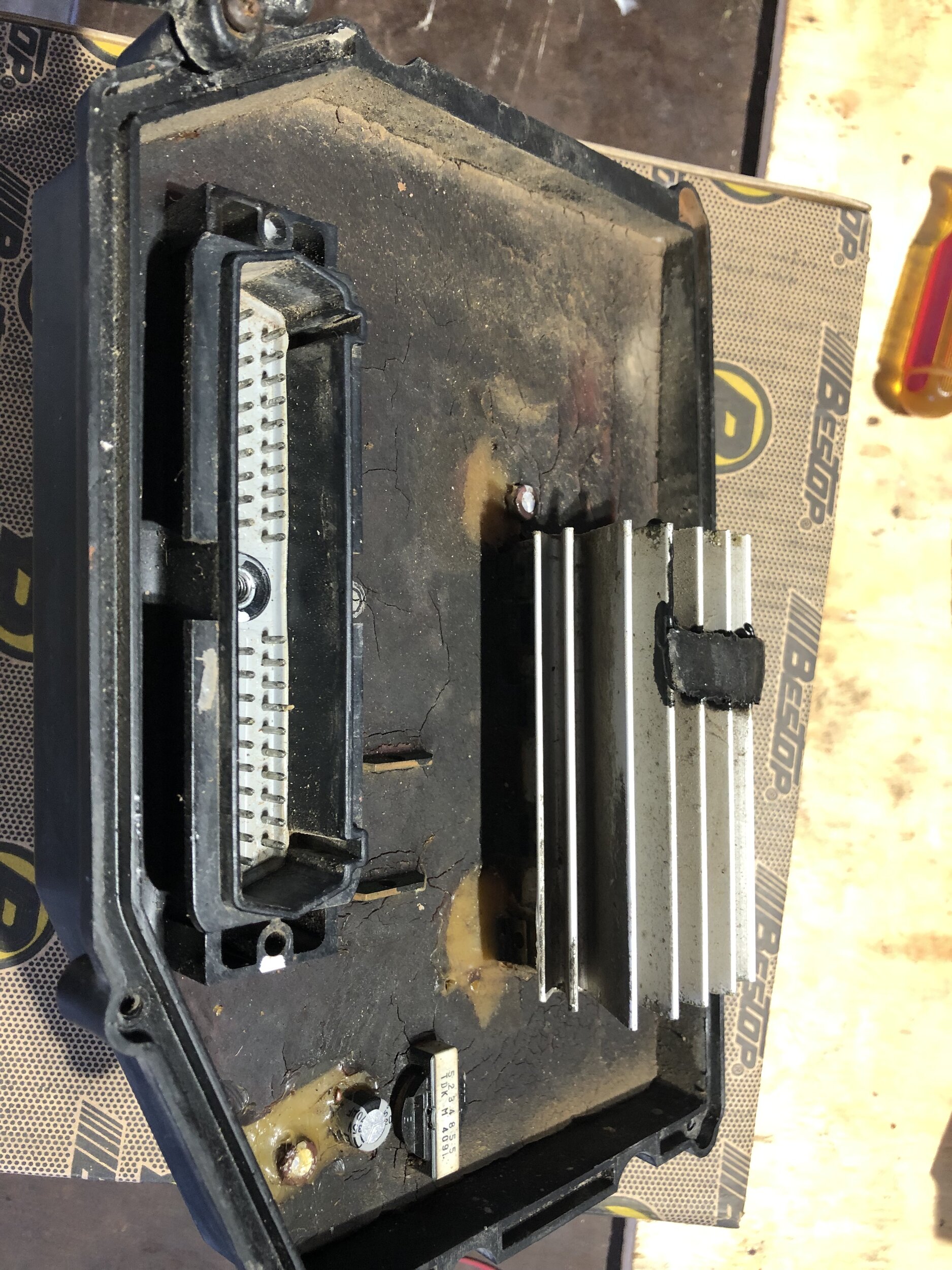

I’m suspicious of the PCM. I know a key on with no check engine light is a clue. I’ve taken the PCM out and inspected it. I had to replaced over ten years ago when the jeep developed a crank and no start issue. Opened the PCM and noticed the capacitors were replaced at some point and next to the aluminum fin things another area was also worked on.
