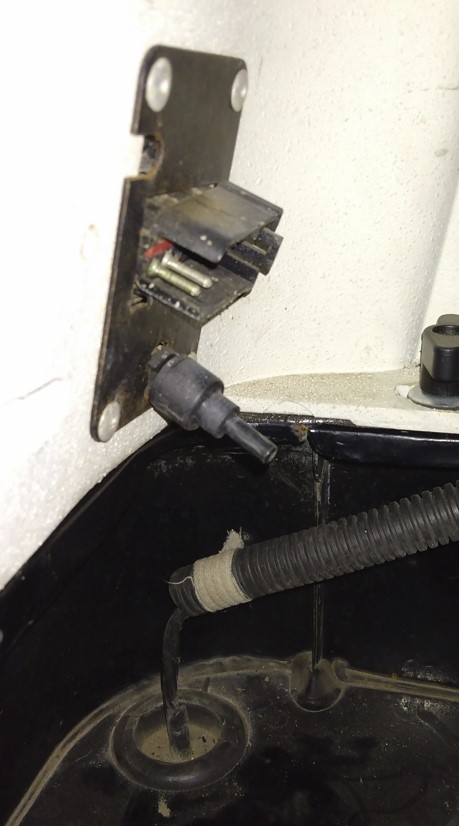

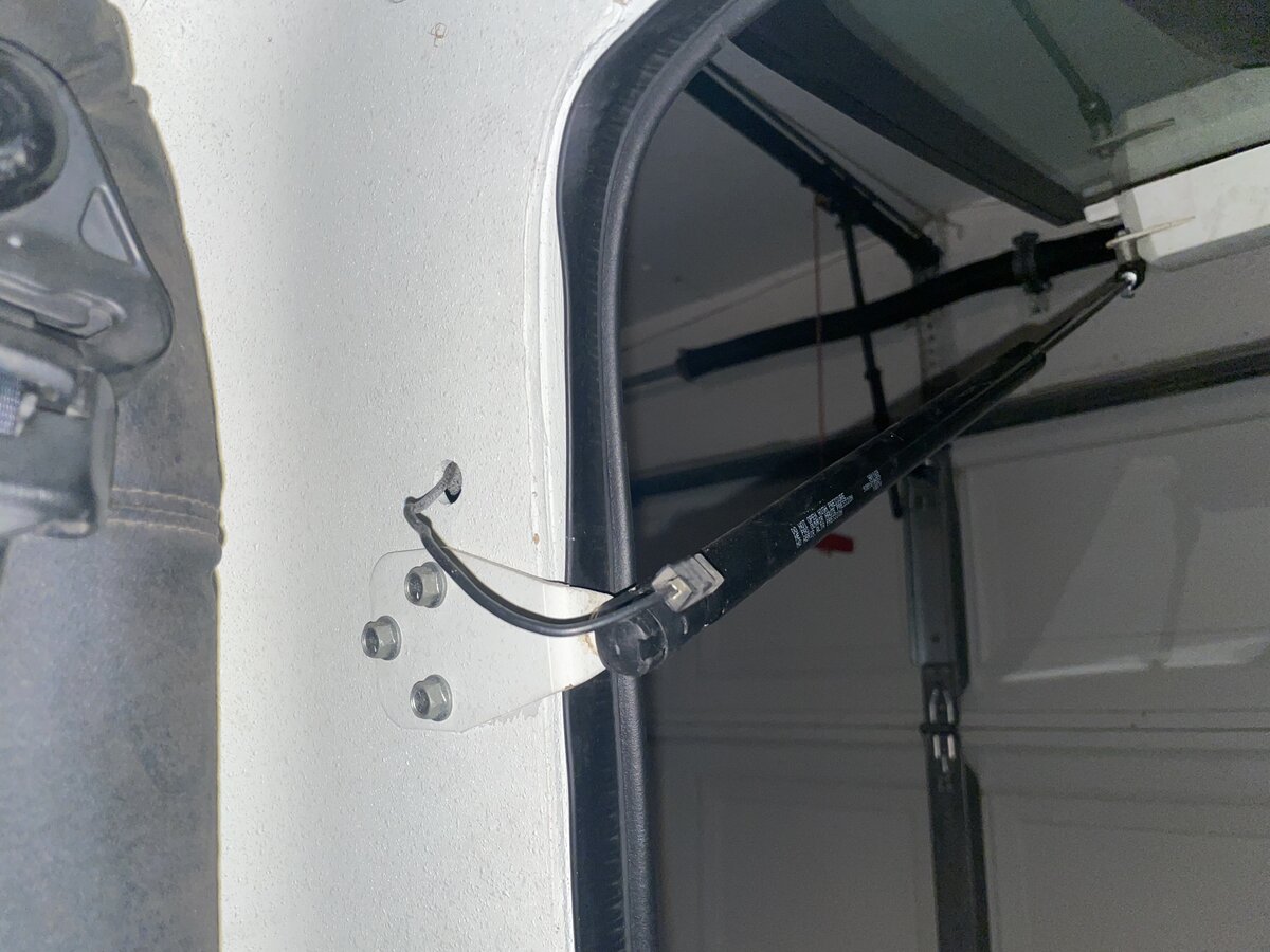

Above the lift gate mounts are some little holes, covered by black plastic caps. I pulled off the caps and started on the passenger side. Sure enough I saw a black wire in there and fished it out with a screwdriver. Crazy enough, it was the unused ground wire for a hardtop defroster.
I went to the other side and did not see the wire. I pulled off the dome light so I could grab the wiring harness from above and pull on it some. It’s pretty loose in the hardtop and moved easily. After pulling a few inches, the brown defroster power showed itself in the hole I uncovered. I pulled it out. Sweet, my top can easily be converted to defrost!

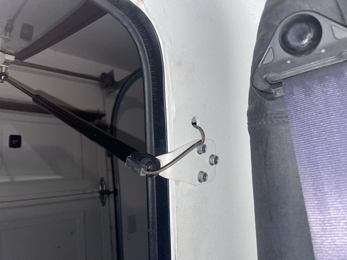

The way the defroster activates is the defrost tops have special liftgate struts with metal tabs on them. The wires come out of the top near the liftgate strut mount, and clip to the top of
the liftgate strut. The liftgate struts provide continuity down to the bottom of the struts where there is another tab on each. The wires from the glass connect to the strut tabs at the bottom.
Note: for this to actually work, you need a rear liftgate glass with the heater built in (the black lines), you need the factory switch to go on the dash, and you need the factory defrost harness with the red timer relay. I am buying the harness off of eBay and I will buy a piece of PPR heated glass later.

Passenger Side Wire
Driver Side Wire

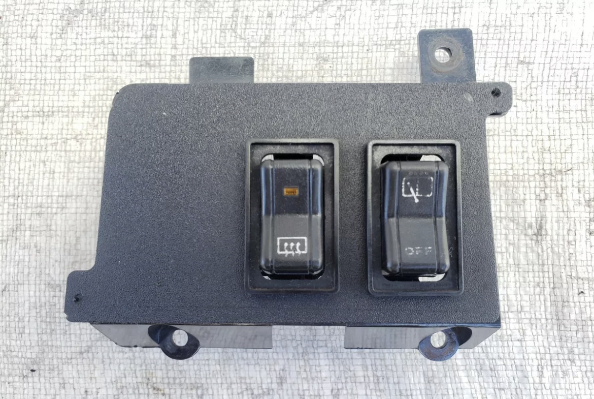

Switch Panel with Defrost Added - I Will have the stock fog light switch in there too

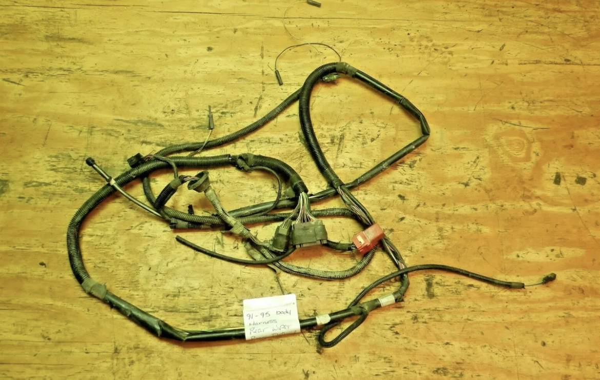

Picture of the harness needed - can get from eBay. This harness runs from the dash, alongside the driver side, down to the driver tail light, across/above the gas tank and to the passenger tail light. I don’t feel like running all of that, so I bought this and will just remove the heated aspects of it and integrate them to my stock harness.

Passenger Side Wire
Driver Side Wire

I changed out the struts for the back windows not long ago and didn't notice any wire connection tabs but since I don't have the heated window it makes sense not to have them.

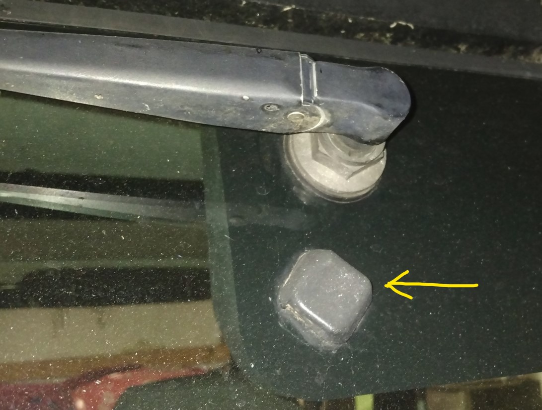

Just ran out and checked the old struts and no connector tabs. I see the window does have a squirter built in just below the wiper motor drive and there is a hose connection next to the wire harness connector in the back right corner.

As for the struts, yeah I actually didn’t know about those either. When I got my YJ in 2013 the stock struts were dead. I pulled the hardtop and didn’t run it for many years so I never changed them. Randomly one day I was buying something at RockAuto and added some struts to the cart. It didn’t say defrost or anything in the description, yet they were just on there. So I kind of just lucked out that I got the heater ones. My originals had no tab.

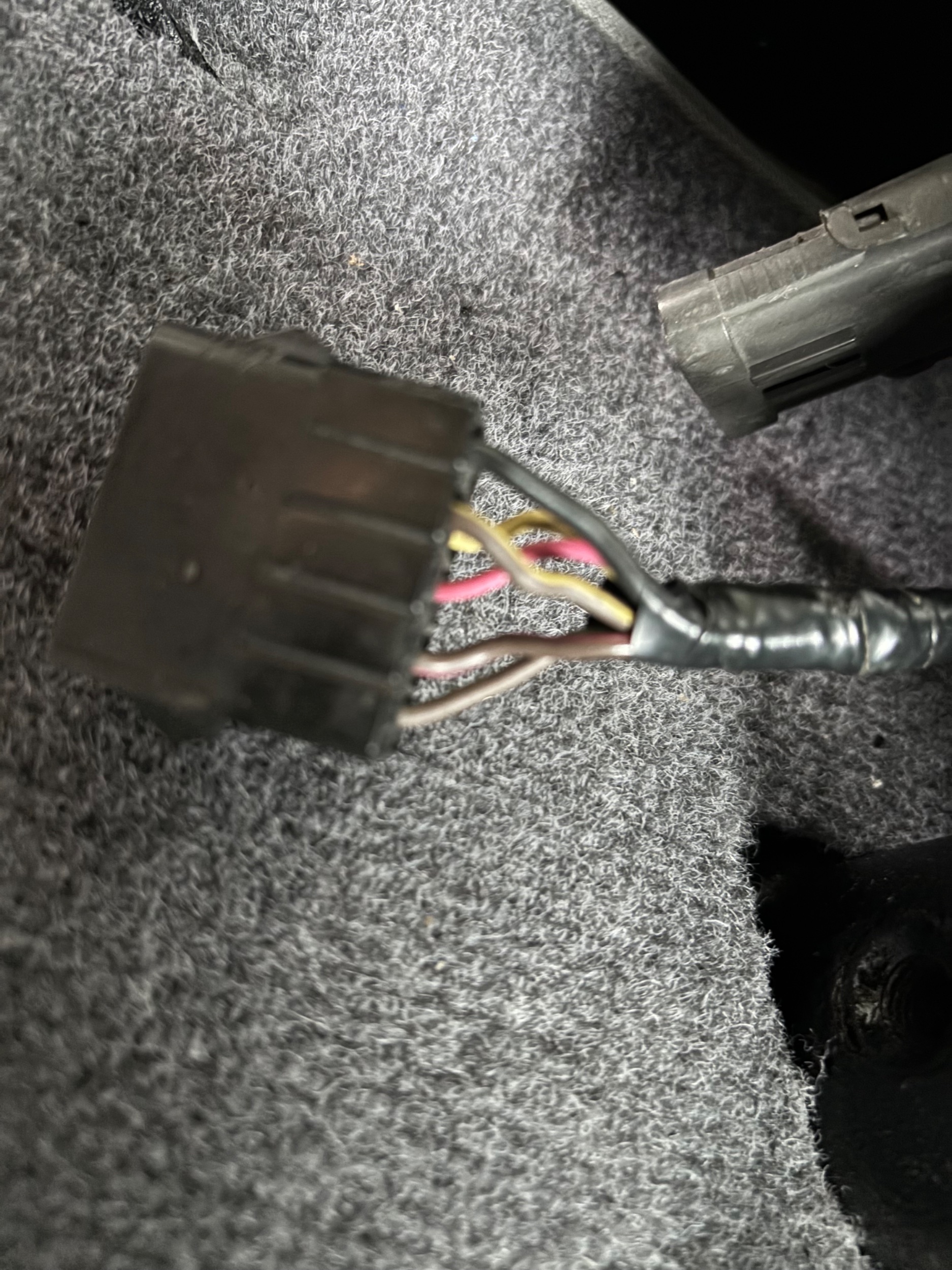

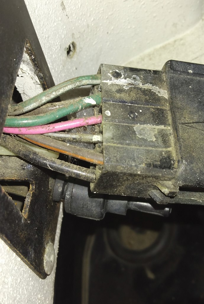

I pulled the connector and found 7 wires occupying 6 connectors, one is shared.
I didn't bother cleaning them to check the colors. I also located the big plug by the E-Brake for all wires going back but didn't dig around for the others. I bet they are there.
Your hardtop wiring looks a bit different than mine color wise although you do have the two heater wires. Whenever you want to dive in down the road we can compare what we’ve got to make sure yours will all work. Mine is occupying 7 spots if I’m remembering right, although I definitely have two wires spliced into one, so I thought that meant I have 8 wires. I’ll have to look again.

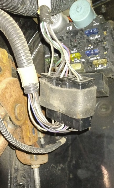

Ok so you found that big black plug, there should be a gray one up there, unless Jeep skimped on the dash harness for soft top Jeeps…in that case then yeah you would need another dash harness because you’d be missing the switch connectors. But maybe you’ll find the gray plug taped up up there when you dig more. Hopefully so. If not, then yeah getting the top working will be a bit more expensive because it’s another harness you need. They are available at least. If you spend some extra you could even get the fancy Sahara/renegade dash harness that supports fog lights. Granted your front lighting harness would need to be changed to match that to support them. And you’d need a fog switch.
But, good news is there are plenty of heated hardtop, wiper/washer hardtop dash harnesses that do NOT support fogs so if you don’t care about that, you should be able to find something 92-95 easy.

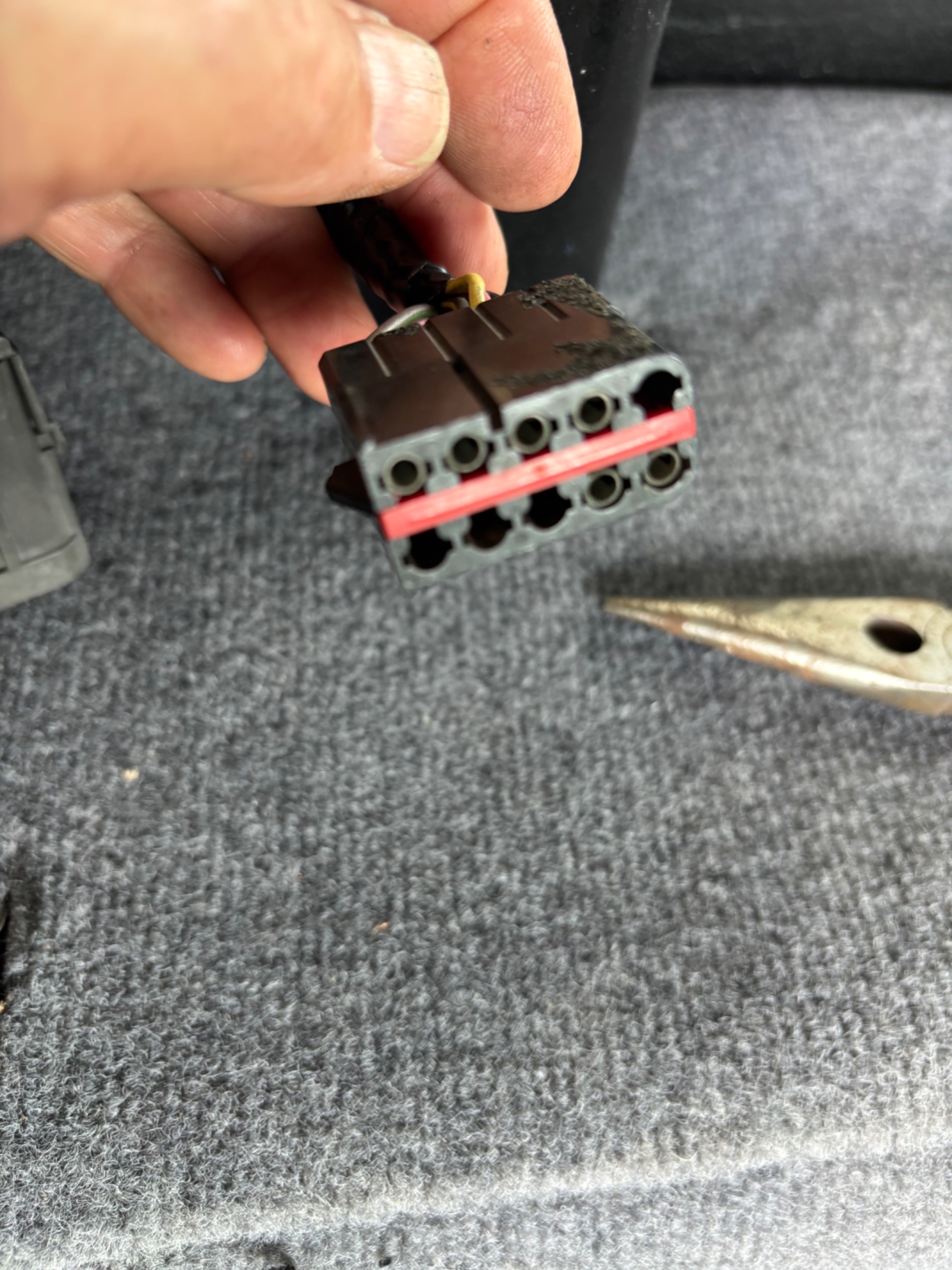

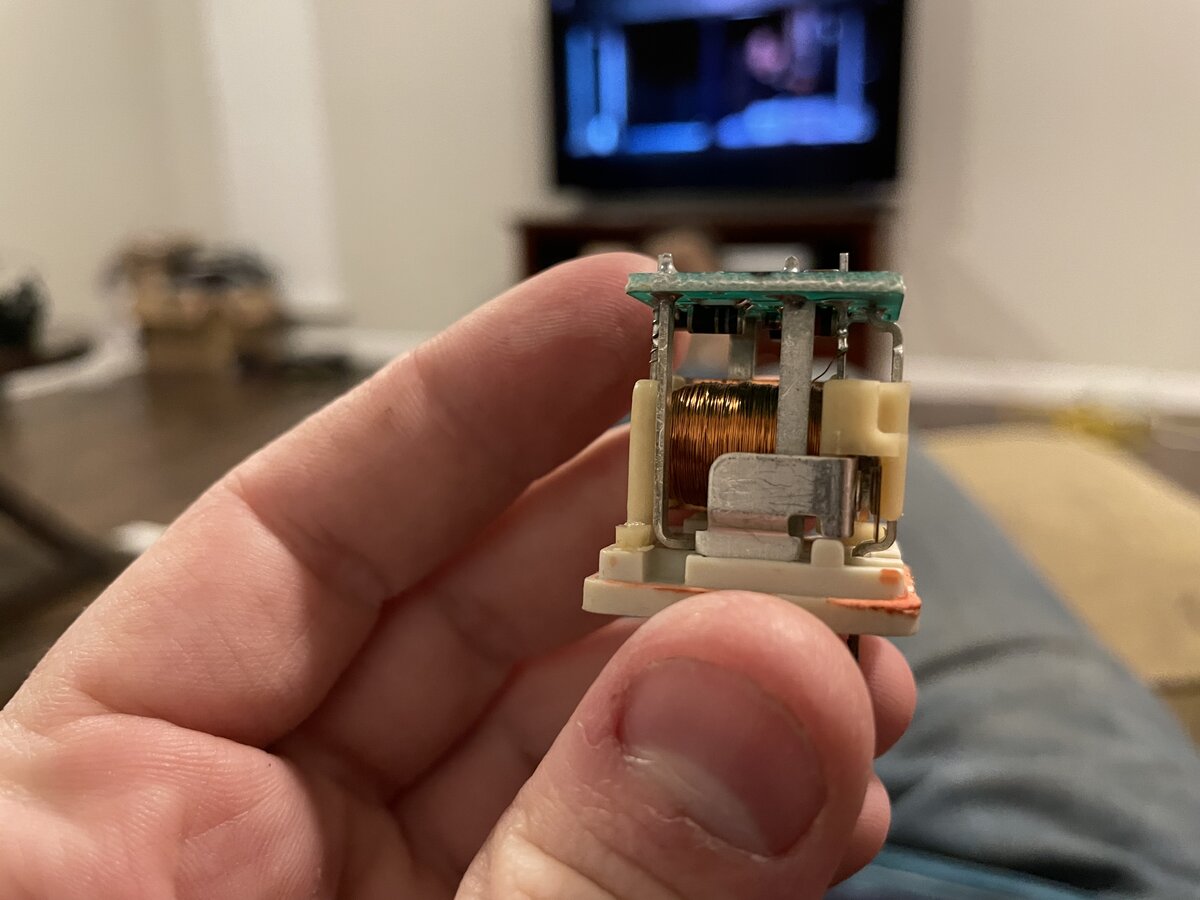

Bought a factory defroster harness which was in pretty nasty shape but included the special red relay I needed, and the wires and their appropriate terminals to install in my own factory connectors. It was pretty simple to do, just took some time. I now have 12V at the defroster wire when I trigger the defrosted with my factory eBay switch :cool:
The harness says it came out of a 1994, but man it was a mess. It DID come out of a 1994-1995, because the wiring for 3rd brake light was there. All the connectors were there just fine, but the wiring colors were all screwed up. Some solid colors, some colors were factory for positive but were put in the grounds, etc. it was a mess. It was definitely factory though, not tinkered with. It’s like Jeep ran out of wire that day and went to the parts store and bought a roll of every color lol. It made it a nightmare to get wired up, I had to triple check every wire function to figure out what goes where.
I wish I took pics but in the moment I was working through it and didn’t really. All I can say is that the conversion is quite easy if one desires to do it! Now I just need the heated glass, assemble it and I will officially have the factory hardtop heater option.
The relay I received was not working. It triggered on and off properly and the timer worked, but I was not getting continuity from battery power out to the defroster itself. It was an easy fix. Opened the relay and saw the armature was not contacting the output terminal when triggered. It was bent slightly out of shape, so I just bent it back. In the bottom right you can see the two contacts, when relay triggers those are supposed to touch. They weren’t. After bending the arm it works perfectly now. I had purchased another relay from eBay, which worked as it came. So now I have a spare!
Good deal and great repair. I wonder why they bent to begin with. Sounds like a Lucas electric product.
Yeah I’m not sure how/why the armature was not making contact. It did not look damaged. Funny enough it looks damaged now that I deliberately bent it. But at least it works.
I wanted to take apart the working relay and see what it’s like but they don’t close back up as well once you open them. So I’m leaving it alone. As long as the one I fixed works, then I don’t really care. Not sure who makes the relay actually.

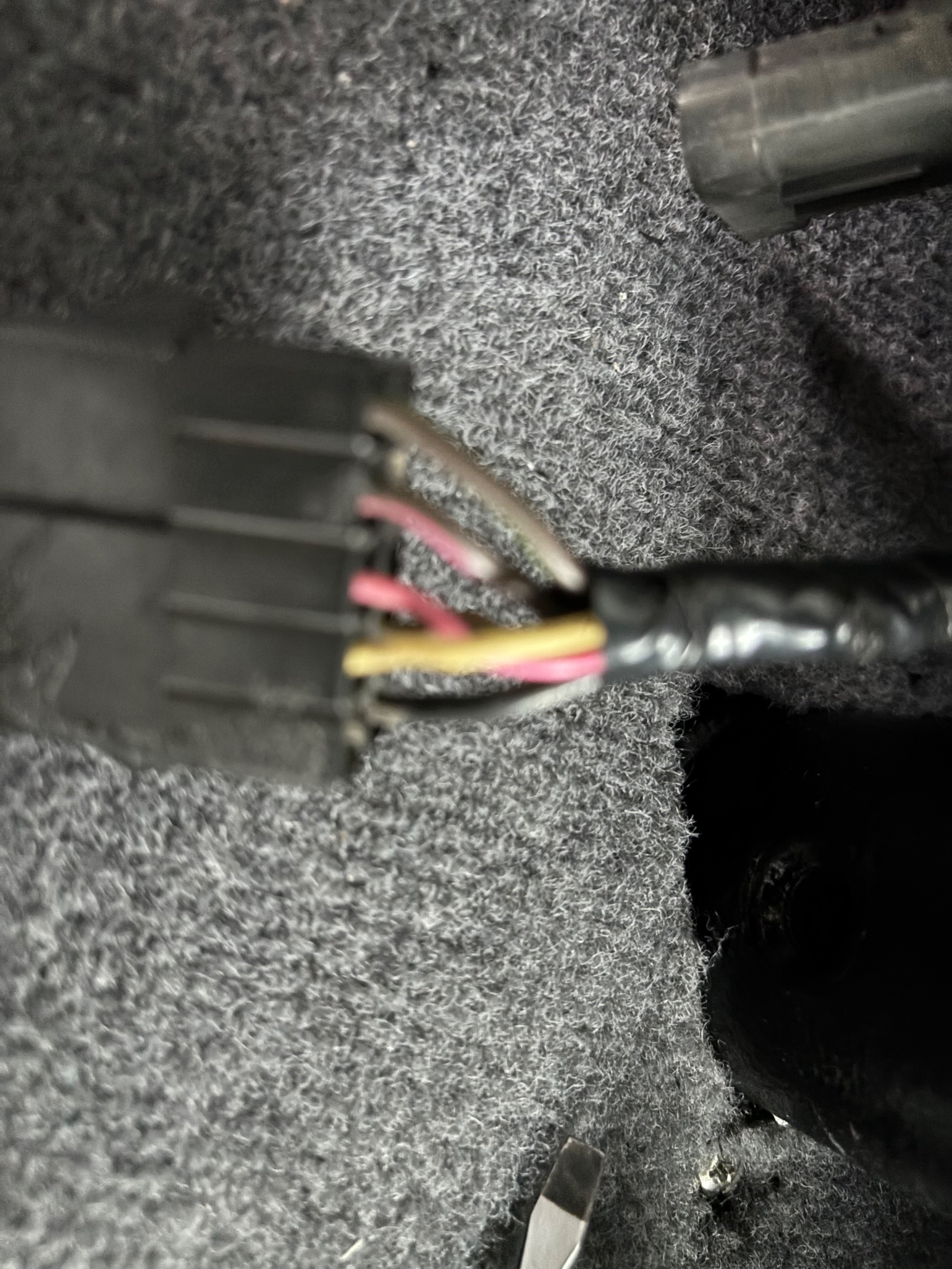

I have been working on a 1992 Jeep YJ for my grandson. He turned 16 in March, I was supposed to be finished by now but cancer came calling last year and I had to take about 6 months or so off for treatment. Cancer is in remission! Anyway I am putting a factory hardtop on a soft top! And as many have mentioned, there are a lot of different parts that have to be replaced or added, and some items are there but you have to “find” them. I have the Jeep repainted and the used Top also. Putting things together and having trouble locating the “red” relay, didn’t come with my used harness. Need the hardtop connection that was not on my used top. But I have found a replacement, my issue is I can’t find or figure out what wire does what?
And of course the two connections have different color wires. So I am hoping that someone else has done this or has a top, and can provide me with some details, i.e.,
What the correct colors are for each connector and what their function is:
I will post a few pictures of my connectors and what I believe is their function, if I am wrong please let me know. Any advice or suggestions or recommendations would greatly be appreciated. Thanks for your input. And by the way, this forum has been of the GREATEST value for my journey in restoring the Jeep. So thanks again
