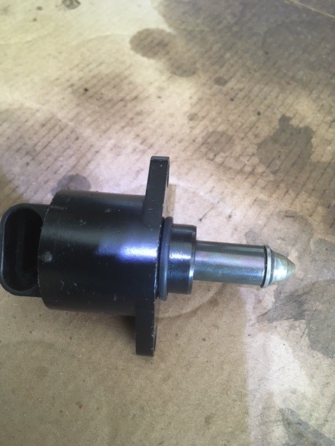

I like that green YJ. Anyway, here is a pic of my cleaned up IACV at rest the plunger is extended - my thought was just to put in a new one, but I want the one that will operate smoothly. Your O'Reilly's story gives me a scare. My confidence in the cleaned up IACV here is about 50%...

it is a stepper motor driven IAC (spins) not the common Solenoid type. (FSM chapter 14)
clean the IAC with plastic safe cleaners only.
CRC brand sells some.
make sure it is the right IAC for this car and exact year.
95YJ, 2.5L is.
