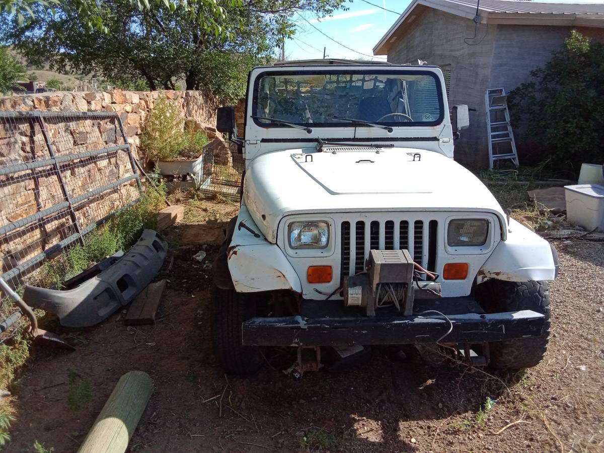

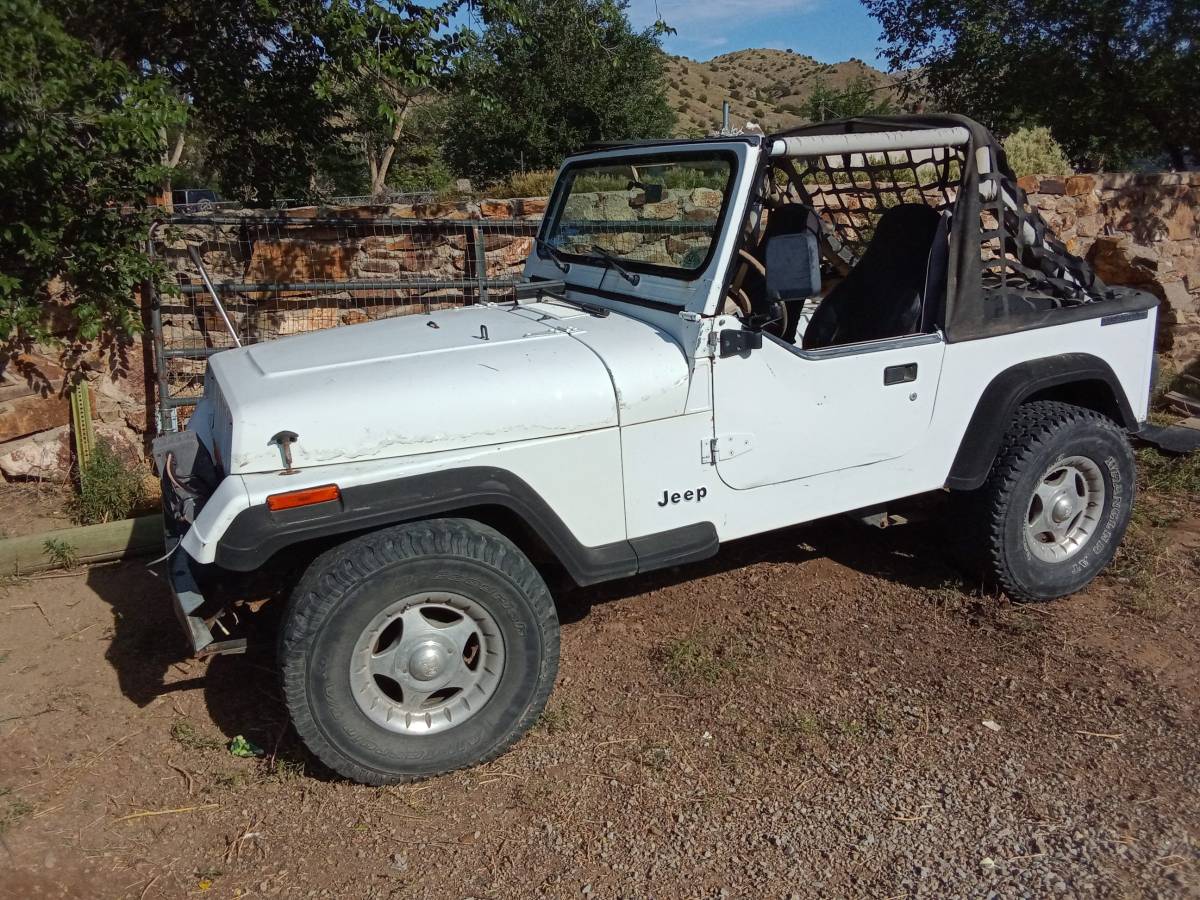

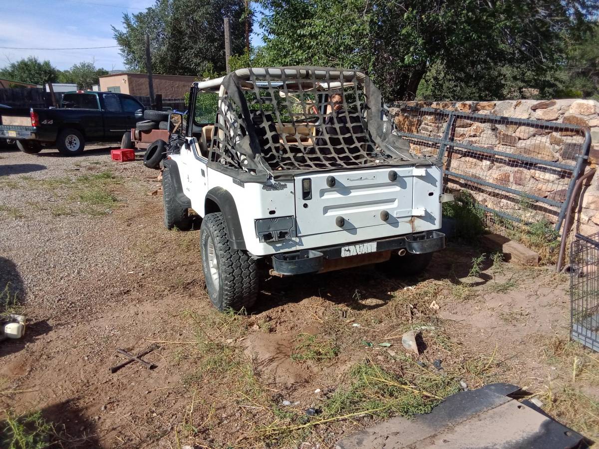

I'm buying a 1990 YJ, it's got the 4.2 L AMC 258 I6.
Guy says the engine doesn't work, but I'm confident me and my dad can fix most any problems, short of a cracked block.
I've never owned a Jeep Wrangler before however. So, not sure what I should be expecting.
Any advice?
Welcome to the Jeep owners club. Looks like an unmolested start for a build.
Fist off fill out your profile with info on your YJ. Specifics help us in diagnosing issues. What do you mean by it does not run? Basics are fuel, compression and spark. You need to find out witch of the 3 are not working. Fortunately the 4.2 is a simple engine to work on. Many here willing to help.
Tell us what's he is asking if you will. Next rust, rust and rust is the biggest killer of jeeps. Body mount, between the belly pan and frame, in the frame, Cracked frames from abuse and crappy repairs is a concern. Cobbled up wiring systems. I cant recall if that will have TB injection which is pretty limited on parts availability and weren't great compared to the later style. Don't run? like in engine is spent or just a bad fuel system? 258's are pretty basic engines but Id assume the worst. I've told myself more than once base of a sellers good word and found a pile of issues far beyond what was said to be the case. Depending on how long it's been sitting consider clutch hydraulics, brake system problems. You can't hear it run, nor can you drive it so it's open to every part of the running gear being compromised, remind the seller of that regardless of his promise it's a one owner little lady's jeep who only drove it to the market.
I agree with Gilaguy...the mechanicals are the easy part, rust is a killer...check all of the body mounts and the rear frame in the area where the rear leaf spring aft mount bolts are located. Also pay attention to the area where the transmission skid plate mounts to the frame as it's prone to severe corrosion. I've seen rust so bad there that the frame has actually cracked. Just judging from the condition of the fuel tank skid plate I'd say there's a strong possibility of significant corrosion, especially if it's been parked over dirt. So, if you plan on a body lift be prepared for broken body mount bolts or stripped captive nuts, those are a bear to fix...The 4.2 is a great motor and the 1990 models were carburated which makes them pretty reliable and easy to work on. However, expect problems if the vacuum system has been gutted. A lot of folks do what's called a nutter bypass and end up with engines that don't run right if at all. You can do a Google search on that for a description...finally, buy with your head, not your heart so that you can make a sound decision. At the end of the day though, if you and your dad have the chops to do the work the time spent wrenching together is where the reward is...best wishes with it...
