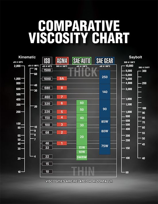

But in this case engine oil in the 10w40...ish range has roughly the same viscosity as 80w90 gear oil. You won't have some of the additives that makes gear oil gear oil but these transmissions return good service with engine oil in them vs gear oil.
Diffs need the EP additives because of the "sliding" action between the hypoid gears. There seems to be less need for a constant mesh transmission to have the same properties in it's oil.
This is from an AMSOIL blog post. 15w40 or a 20w50 would probably be closer to right than 10w40.Something must have changed over the years, because I remember the viscosity of the two being nowhere ne’er the same.
That’s interesting to see. I used to run Valvoline 50 weight racing oil in a couple of worn out truck engines and I was sure at least at that time that it was much thinner than the 90 weight that I was constantly adding to the leaking diff. I have learned something.This is from an AMSOIL blog post. 15w40 or a 20w50 would probably be closer to right than 10w40.
