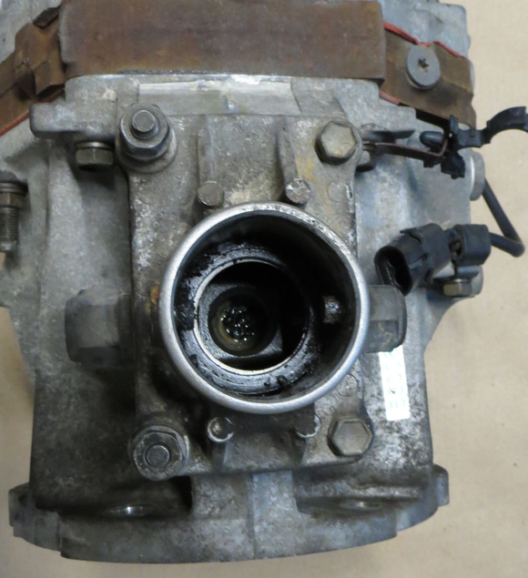

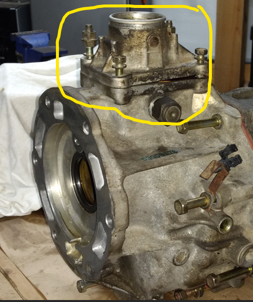

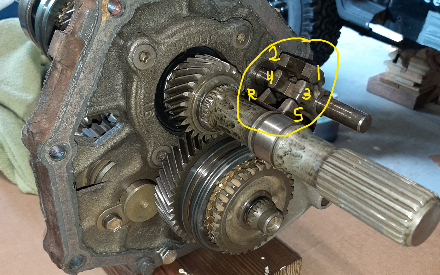

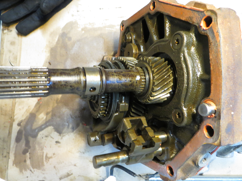

There's also a reverse lock-out pin which prevents you from going into reverse from 5th gear. My guess is the 5th gear fork is stuck in the engaged position and preventing you from selecting reverse.

Is there any way to troubleshoot/ fix this by going in through the shifter vs dropping the transmission?
